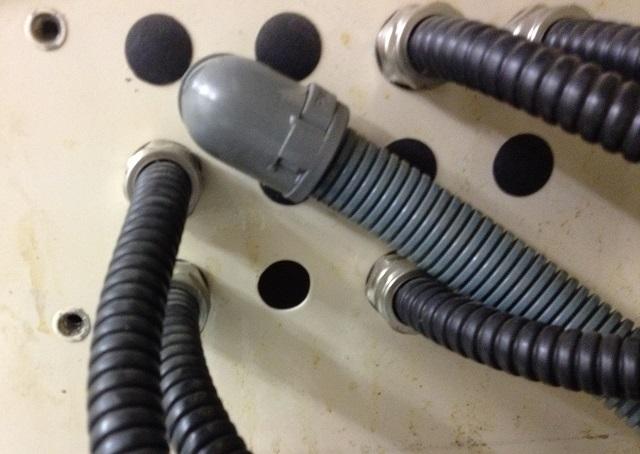

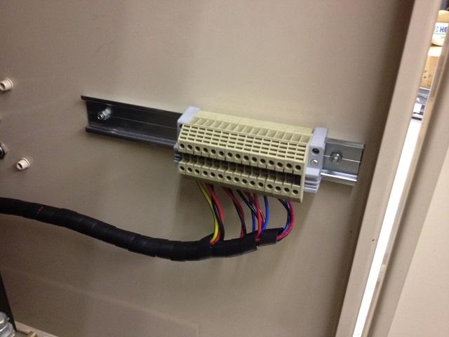

Having traversed the front of the machine the 20 mm flexible conduits terminate, along with many others, in the wall of the electrical cabinet.
From there for now they stop on a DIN rail mounted terminal strip, from whence they will be wired to the rest of the machine. Exceptions being the Heidenhain encoder, that goes directly to the TNC355 controller in it's rather special 4 pair twisted screened cable, and also the tachometer output which goes directly to the Bosch servo card in screened twisted pair

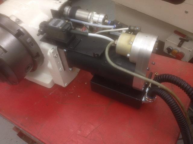

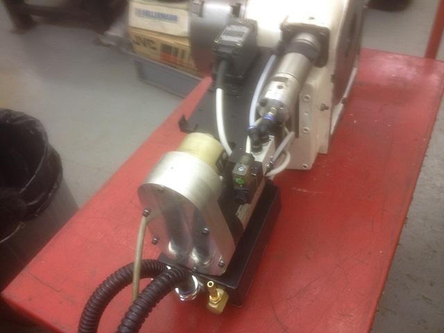

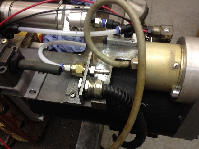

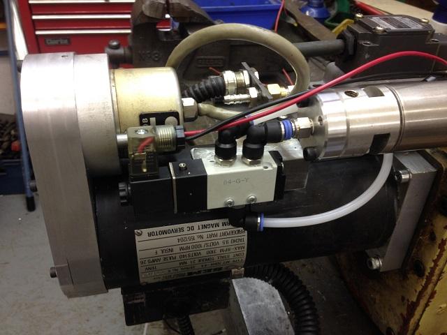

At long last the pneumatic valve has arrived allowing me to make up a bracket and mount it. I'm glad to say that the brake works very well. In the relaxed state the cylinder is releasing the brake, and when powered it is applied

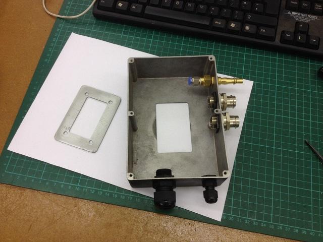

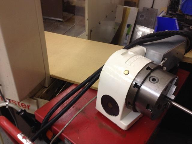

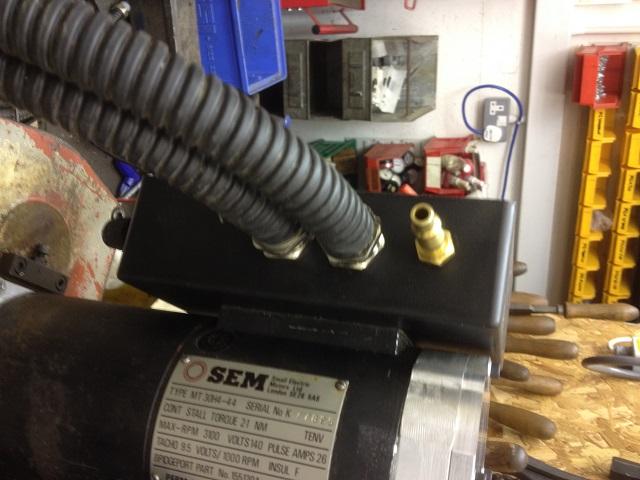

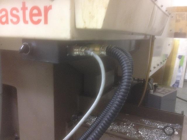

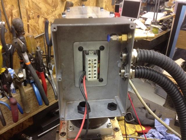

I then could start planning how to physically fix the ends of the umbilical flexible conduits that lead from the 4th Axis to the termination box.
I decided that the easiest thing was to replace the SEM servo motor termination box with a much larger one that could take the Adaptaflex fittings, and also the air fitting, so went too and made a new box:
« Last Edit: February 09, 2014, 07:42:26 AM by awemawson »
  • Posts: 9051
Re: Servo Driven 4th Axis for CNC Mill
« Reply #103 on: February 09, 2014, 07:16:31 AM »
Now that all went very well, I was pleased with the result . . . until I realised that due to the minimum bend radius of the flexible conduit the 4th Axis could not be layed down in 'rotary table' mode  :bang:
Now I'm unlikely to want to use it as a rotary table, but will want it sat that way for initially mounting chucks and the like, so a re-think was needed. I could have brought the cables out on the rear of the box on the narrower side, but that would have made the 4th Axis too long and the cables would foul on the enclosure door.
I fell back to using the original SEM termination box with the cable emerging 'backwards'  so that the curve could be accommodated, and making up a bracket for the second conduit which I had to reduce to 16mm to clear the body of the motor
« Last Edit: February 09, 2014, 07:50:33 AM by awemawson »

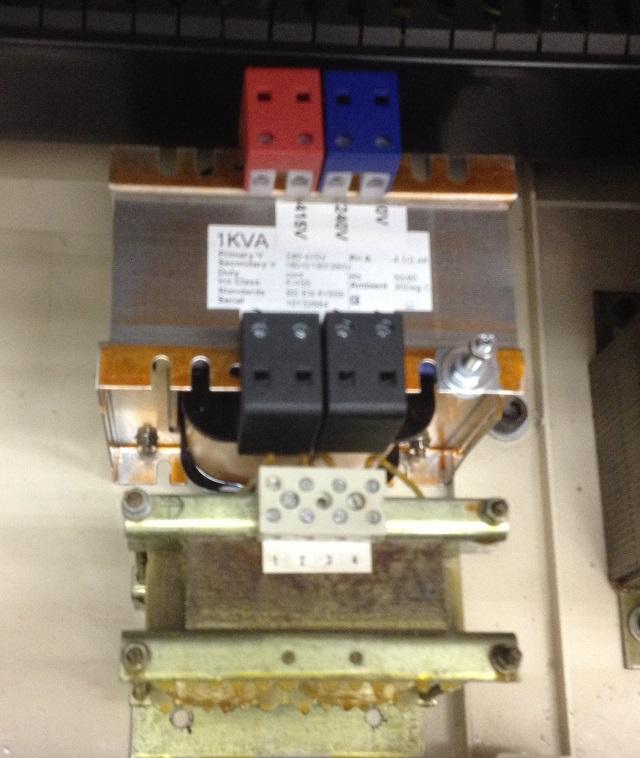

The transformer to drive the Servo motor and card has arrived, and this and that 'wandering choke' will now be mounted alonside the original transformers on the base of the electrical enclosure

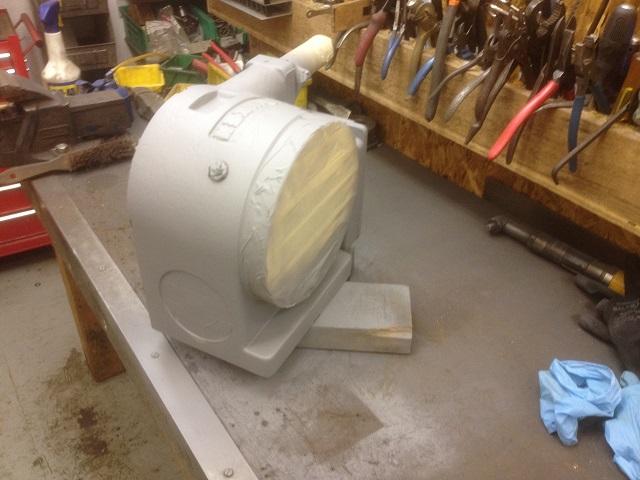

I'm pleased to say there has now been lots of progress on the 4th Axis.

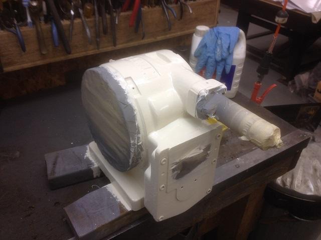

I decided that the side exiting wiring was a no-no, and that the use of the original SEM termination box was messy, so I re-made the motor box with rear exiting cables that have to emerge 'upwards' to avoid fouling other things. I also gave the mechanics a lick of paint, that no doubt will all be removed in use !

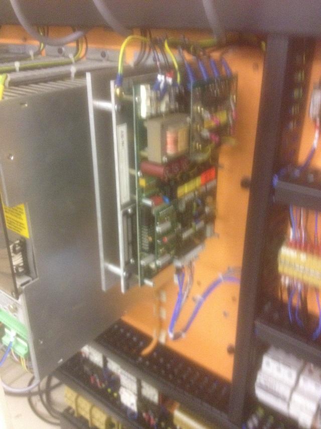

I then wired up the various relays needed:
a/ 4th Axis enable
b/ 4th Axis brake
c/ 4th Axis ESTOP
Wired up the servo card and finished off the external termination box
« Last Edit: March 09, 2014, 09:13:02 AM by awemawson »
  • Posts: 9051
« Reply #114 on: March 09, 2014, 08:43:44 AM »

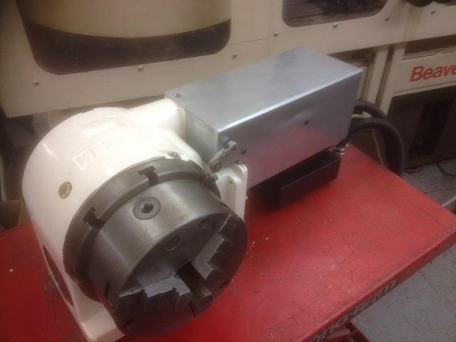

At this stage I was then able to start testing. The system worked, amazingly, but I couldn't get a decent speed out of it without generating 'Gross Positioning Errors' Fairly obviously the servo card needed tuning, and some parameters tweaking in the control. However the good bit was that the gearing and encoder interface was working correctly to give me 360 degrees for a full turn as it should.
I went through the Bosch manual MANY times following their procedure, and try as I might couldn't get the main servo motor spinning more than about 700 rpm without errors - it's max speed is 3100 rpm and I'd initially set it up to max on the servo at 2000 to be on the conservative side.
Many people offered help, both from this forum and others and I thank them profusely, but the break through came the other day, when by chance I was put in touch with a local chap who had installed this type of servo card many years ago.

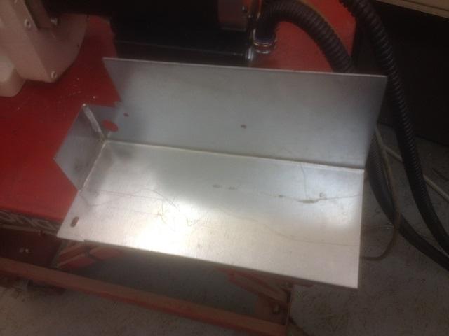

Long story short - he came round yesterday, and after four hours of tweaking, un-tweaking and head scratching we got it to a very acceptable performance. Servo motor is now reliably able to spin at 2500 rpm giving 2500 degrees a minute on the table.
So to celebrate, last night and this morning I made up the swarf cover and am ready to put it on the machine table and try it for real. That won't happen immediately due to family commitments

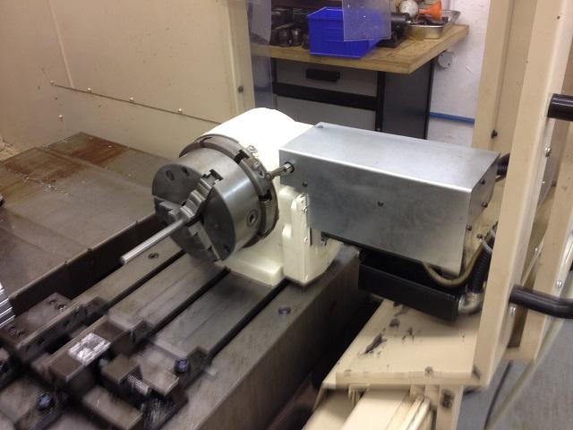

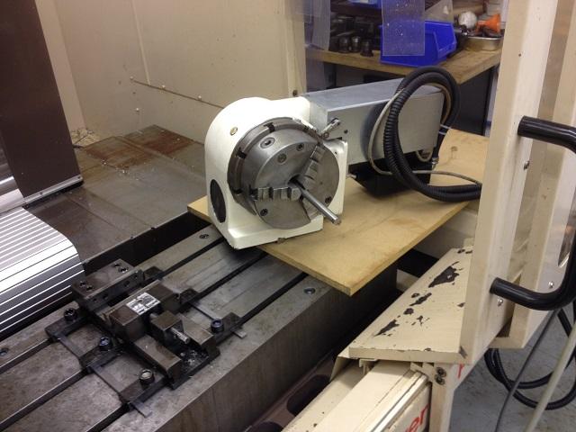

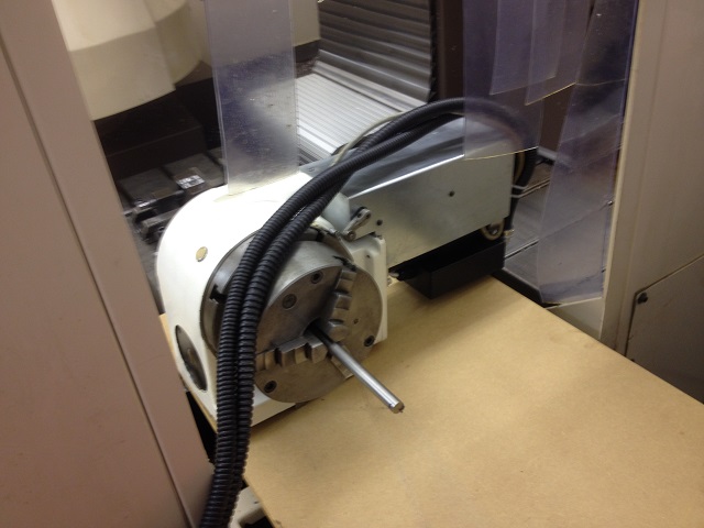

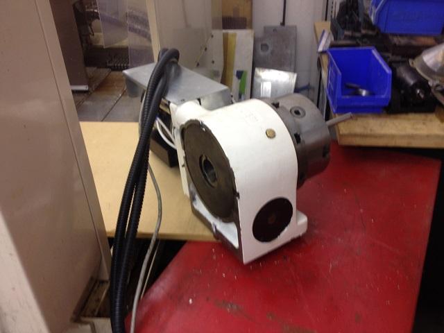

Well after a bit of a struggle I managed to get the unit up onto the milling table. By heck it's heavy. I fitted a bar in the chuck as a handle, moved enough junk out of the way to get my hydraulic pump up table closish, and used a bridge of 18mm mdf to slide it into place.
« Last Edit: March 11, 2014, 11:36:37 AM by awemawson »
  • Posts: 9051
« Reply #121 on: March 11, 2014, 10:49:20 AM »
So now it's on the table it needs holding down - I need to make some clamps
If you look closely at this picture, I've added a rear 'brace' to the swarf cover that picks up three of the bolts on the encoder belt box. This was to make it a little more rigid and stop drumming
