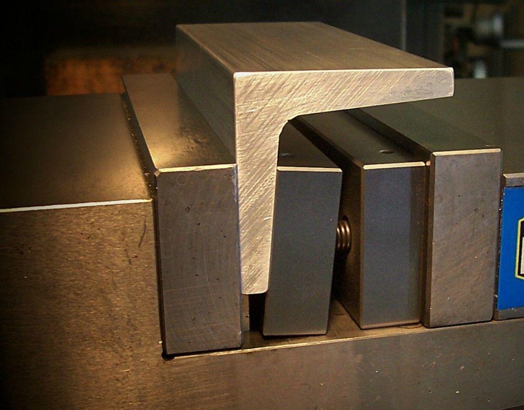

I found this kinda nifty and seem to be simple enough to recreate.. =)

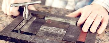

That looks identical to a printers 'Quoin' used to clamp type letters in a printing frame.

A "Quoin" is a wedge, so the keystone in an arch is a quoin. In printing it is an expandable wedge used to hold the type in place

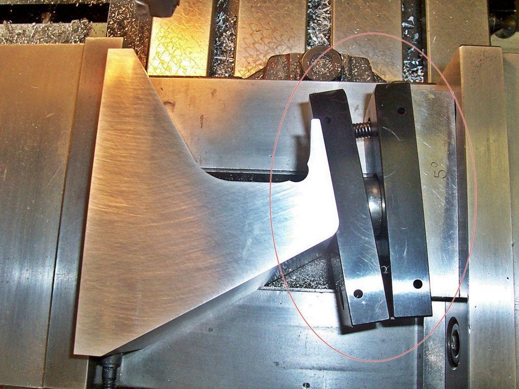

Dont really seem to work same way. This got a ballbearing making two plates swivel against each other taking out odd angles when clamping. Not expandable at all actually.

When I had my Adana 10x5 printing press the quoins were just as you describe pivoting on a ball but with the screw acting on the ball to tighten up. There were two dowel pins fixed in one half, and very loose in the other to allow a lot of out of parallel motion

Ah ok..  Then i misunderstood your little picture there.. Well it seems like a valid way of clamping odd parts like.. car parts  and such that in some cases isnt always straight. =)

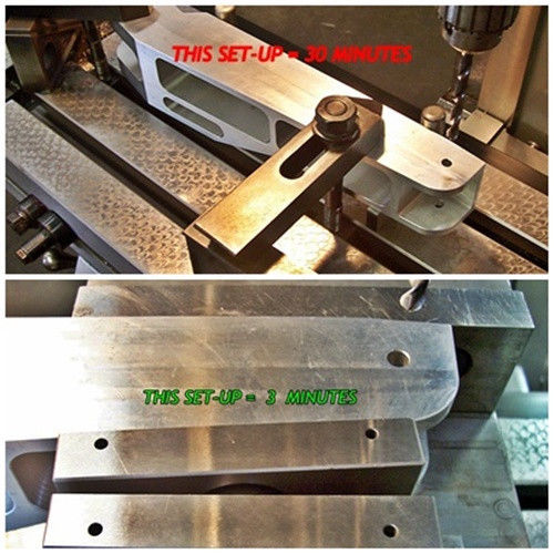

I think that's just what I need for a task I am trying to do.

What is the maximum acute angle you can achieve?  Looks like a useful clamp.

Ok, I give.  How does a feller make the recess for that ball bearing?  The rest is fairly easy machining.

Ball ended end mill, or form cutter

I wouldn't have thought it needs to be curved - a countersink type dimple ought to work just as well.
