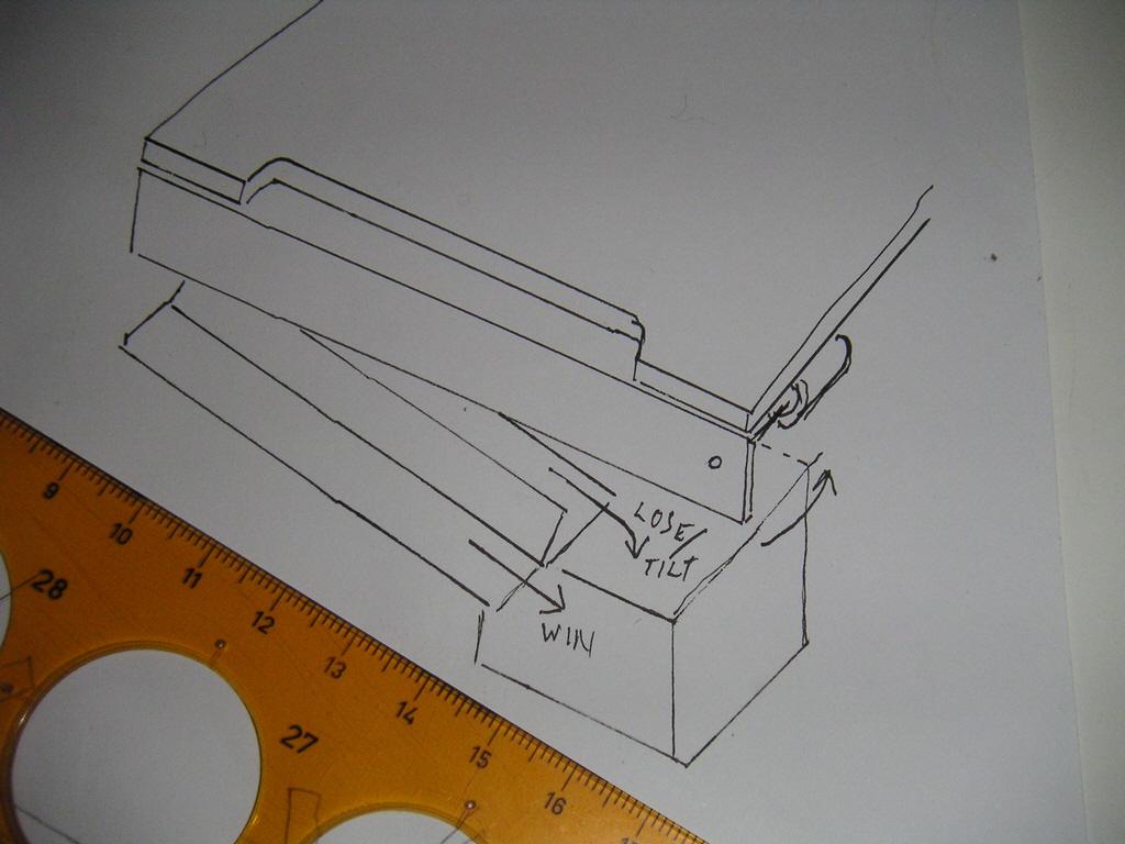

Hello again guys, been working on the pusher some more and will have pics shortly.
I was hoping to get some opinions please. I want to put an alarm on the machine so no one is tempted to tilt it and if they do, the coins will be collected in the cash box and not in the winning tray.
I can handle the sensing with an arduino and my idea is to use a solonoid to immediately lock out the winning tray but I then need to divert the coins to the cash box.
Drawing is really not a strong point, I'm terrible! However, my sketch below shows my idea.
The coins falling off the front edge are winnings and the cash box coins which the machine eats up are through the two holes at the sides but back from the front edge.
My idea is to have a sheet of mdf or Perspex (something low friction) at a very large angle. This has a divider in the middle. Coins falling off the front fall into the front tray and slide down through the trap door to the outlet wining tray. Coins falling through either of the secret holes fall into the back tray, slide down and around the corner through a hole to the cash box.
The idea is that the front winnings tray hole has a hinged flap. If the machine is shook and the alarm signals, a solonoid immediately pulls down the flap and any falling coins go over the flap and down into the cash box hole.
Too complicated? Will it work? Possible problems? Simpler ideas? ....your thoughts are welcome as always!!
Chris

« Reply #89 on: August 13, 2013, 04:15:18 PM »
.......I'm pretty sure it will be the first thing my brother in law does when he sees it!!
Have you considered voice recognition for guffaws AND-ing that to a tilt sensor and then if positive initiating an electric shock?

I think you are getting the wrong idea here... he won`t be interested in stealing the coins - he`ll want to do it to prove a point that playing isn`t necessary and you can just rock it to win!!
And lets face it.... when did it become mandatory to have a reason for additional madmodding!!  :proj:
I want to do it for the challenge of integrating this feature - I`d just buy myself a penny pusher if I wanted one!!!!  :mmr:

Why not have enough spring tension to keep the shelf in place secured by a solinoid to lock it,  when it gets tilted the solinoid releases and the weight of the pennies cause them to drop the spring resets the tray locked by the solinoid.

I would think that a spring like one of the type the shaft fits through with the two protruding ends to keep the base presure on the drop plate in the up position and return it after a drop the solenoid  just keeps it in place till the tilt is trigered  a simple incline ramp either spring load or just a gravity latch to catch it as it resets in the up position. The weight of the coins supply the drop energy. :coffee:

Tom, what about a pendulum weight instead of a spring? If the hinge line goes right through the center of the panel and the pendulum is directly below the hinge line, any coins off center either side will cause it to spill when the solenoid is released. Then the pendulum re-exerts a righting force and brings the panel back to level. Solenoid latches back when panel is upright -- maybe a microswitch activation.
Once the panel dumps though, the game is over until somebody replaces lots of coins. Maybe there should be a message under the coins on the panel when it returns to level. Something suitable......

I thought something like a flap hinged on the front edge pulled back to say 45 degrees to divert the coins into the cash box. Perhaps put it on a timer say for 10 seconds before it flips back. The cash could also go straight into your coin counter hopper ready for change to be paid out. I've seen some simple vibration sensors that would detect the movement easily.
http://www.ebay.co.uk/itm/Vibration-Movement-Sensor-Non-Mercury-Switch-5-pieces-/141022050779?pt=UK_BOI_Electrical_Components_Supplies_ET&hash=item20d591b9db
Not to be confused with tilt switches which would require the whole thing to be tipped over before switching :bugeye:
