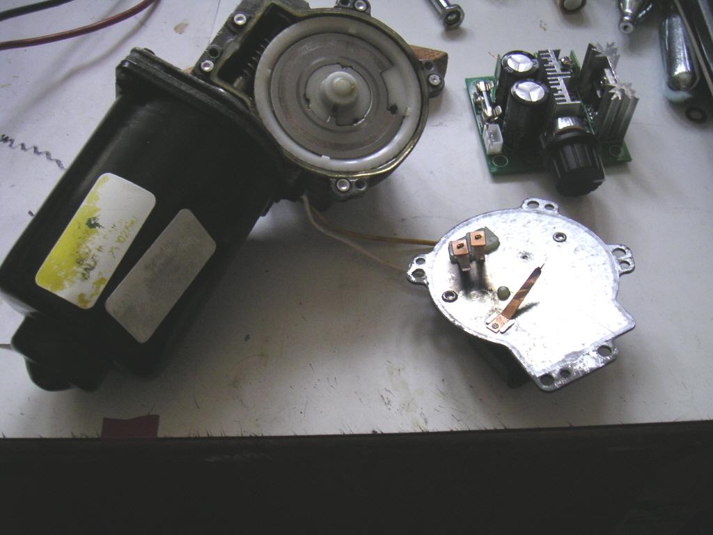

When I started reading this thread I was doing a job on my little X0 mill that needed a lot of slots cutting in it, I also plan to make quite a few of these and was thinking how great just some basic power feed would be.. :proj:
So when I read this thread a big light went on. I could use a wiper motor !!!!!.
So not half an hour later a few ebay purchases were secured.
Yesterday these turned up.
The motor cost £6 inc postage as it didn't park the wipers any-more - no problem for me.
It's from a Corsa C, comes apart easy, is well built mechanically and shows hardly any signs of wear.
The controller is the £8 one from etang. It has well specified parts and works great with the motor on both the low and high speed connections.

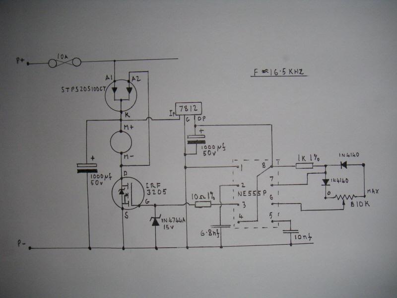

I've included a schematic I drew for those interested, it includes all the protection required with no extra parts needed.
Base frequency measured on my scope is about 16.5 Khz.
I hope the manufacturer/seller doesn't mind me putting this in but there is no way I could build this for £8 anyhow so I can't see it can harm. (untested circuit - build at your own risk values etc may be wrong.)

  • Posts: 6835
Re: Building a Penny Pusher Arcade Game
« Reply #69 on: August 09, 2013, 02:35:21 PM »
Thanks for the schematic -- that should be useful for mine if it needs repairs some day!
I'd love to see your final setup on the mill when you build it. That's what I bought mine for, as well.

That "A2" diode is the freewheel diode :thumbup:
