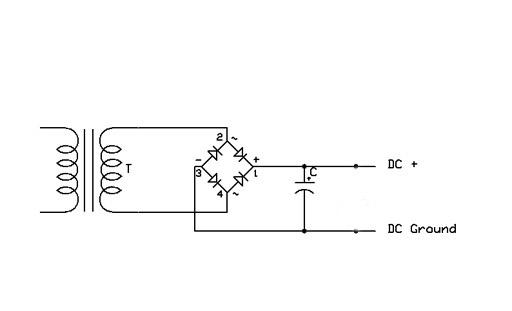

The one secret we haven't mentioned to Chris is..............
a 6V transformer when connected to a bridge rectifier will give you sommat more 'an 6 V DC. output.
  • Posts: 6856
Re: Building a Penny Pusher Arcade Game
« Reply #37 on: August 02, 2013, 03:07:48 PM »
Here, a picture is worth a thousand words.
This is for a simple transformer -- and according to Bluechip you can eliminate the capacitor as well.
Or if using a center tapped transformer, you don't even need 4 diodes, or a full wave bridge package. Just two diodes (I believe, or is it 1?)
The only problem with all of these, as you say Chris, is, they aren't adjustable. But if they're right, you're good to go
« Reply #38 on: August 02, 2013, 03:13:33 PM »
Not if you omit the capacitor. It'll just see the rms .
It will actually be a bit more than 6V rms with a 50VA tranny 'cos 50VA is a bit over-rated for the job.
It will be up a tad because of the favourable load regulation.
Not looked but I would guess the load regulation would be about 10% with a 50VA tranny ..

  • Posts: 9071
« Reply #39 on: August 02, 2013, 04:27:33 PM »
The simplest solution in my opinion is a suitable transformer, followed by a bridge rectifier and capacitor, followed by the pwm unit Chris has already bought. This way as he builds the penny pusher he can adjust the speed to suit. The speed will depend on the load and this will probably change as the design develops, so a fixed speed solution is not a good idea. Build a little 'post design design' into it for later tweaking !
