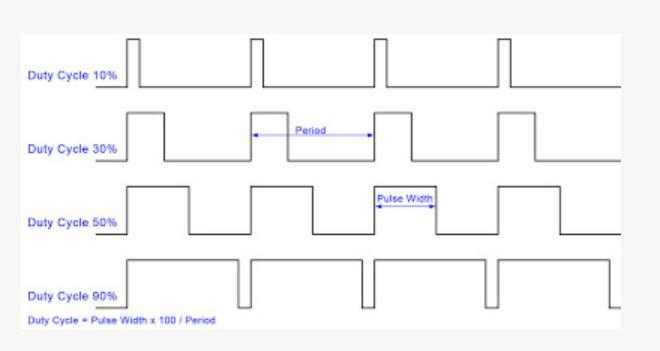

« Reply #8 on: August 01, 2013, 09:19:35 AM »
Chris
Pic I got from here
http://abertoatedemadrugada.com/2013/04/o-que-e-o-pwm.html
Top row,  if you imagine the pulses are right to left in time. the LH edges are all the same.
So, the frequency is F = 1/t. This is the base frequency, otherwise known as the PRF. ( Pulse Repetition Frequency ).
To take an easy eg. PRF is 1 kHz, if I have a pulse length of 1mS, the trailing edge of pulse 1 will be co-incident with the leading edge of pulse 2. ie. It's on all the time. 100% modulated.
If your doo-dah is 1.2kHz, then that is well within the audible range.
I do PWM with pic 16F886, and you can get a PRF of several kHz which takes ( hopefully ) most of the squawk well above audible.
BTW that motor is not on a desk top is it? Not got a sounding board effect have you?
I have some steppers that kick up the most hideous clatter until I pick them up ..

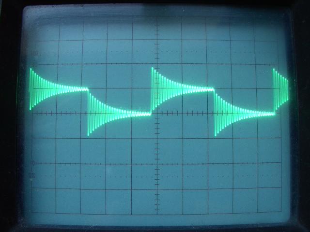

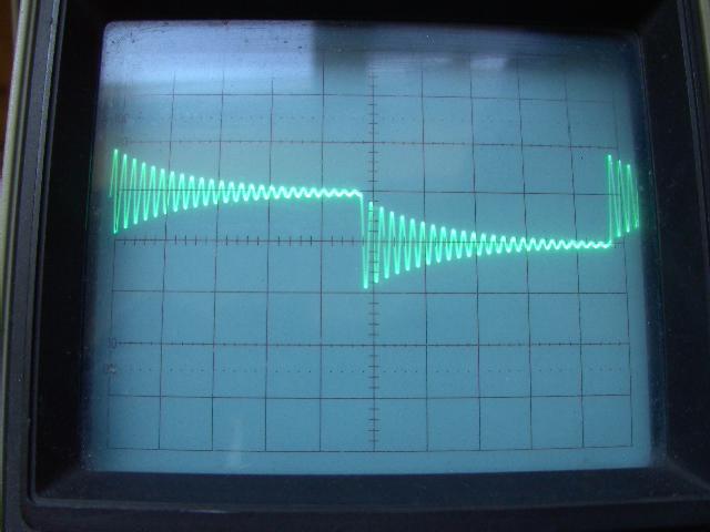

Just in case you're not really interested, and seeing as it's too damned hot in the shop ...  :thumbup:
Did a couple if piccys of the effect of driving a square wave current through a 22mH inductor.
Done on my venerable Hitachi V423 oscilloscope, vintage 1985  ( 1985 AD I might add. If it was much older it would be a fossilloscope, but I won't mention that. )
Using the 1kHz 0.5V pk calibration jack. which I doubt is capable of driving much in the way of amps ..
Shows the ringing which the choke causes, as you see they are several times the frequency of the driver pulse, so, if you make your PRF high enough, most of the junk is hopefully above audio ..
Dave BC
