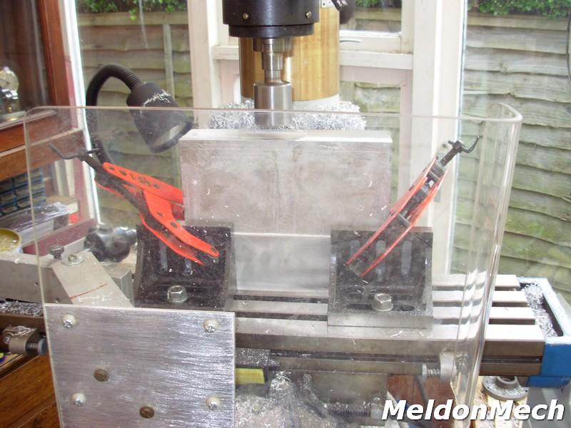

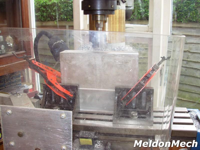

« Reply #9 on: November 30, 2013, 04:27:19 AM »
        I fly cut a lot of aluminium, and flying swarf is a big problem.  I built a perspex adjustable screen, which is attached to the milling machine, using T slots in the table.  The screen is pivoted to open outwards.  This contains most of the chips flying towards the operator, as I try to feed the workpiece from right to left.
                                                                                                                Cheers David
