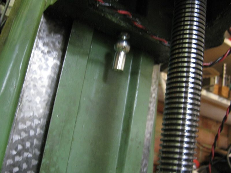

To mark the underside of the knee casting I turned up a pointed steel plug to fit inside the tube flange and lowered the knee onto it - result one centre dot that I could then use a punch to enlarge.
http://i115.photobucket.com/albums/n313/9fingersphotos/VMC%20Modifications/IMG_1847.jpgAnother 6 x 26 Knee Mill CNC conversion
Drilling and tapping the casting  M8 was a bit awkward with a right angle drive cordless drill and a small tap wrench with removable tommy bar.
Here is a the ball end fitted ready to receive the gas spring cylinder. There is a choice of end fittings available included in the price of the gas spring.
http://i115.photobucket.com/albums/n313/9fingersphotos/VMC%20Modifications/IMG_1848.jpgAnother 6 x 26 Knee Mill CNC conversion
Getting the spring into position is a bit tricky. uncompressed it is 850mm long before any end fittings are added.

With the cylinder fitted to the knee casting I could then remove the spacers and refit the nut securing screws.
Winding the knee up and down felt most peculiar. Remember we have 1200kN force upwards and 1000kN imposed by the knee. So it take MORE effort to lower the knee than raise it :D
I then used a spring balance and the feedscrew handle to measure the difference in torque need to raise and lower the table whilst gently letting some gas out of the spring one fart at a time remembering that there is no way back if I let too much out!
I've used these springs before and it is actually fairly easy - a sub one second burst makes a small but measurable difference.
I've now got it balanced quite nicely now and it takes about a 2kg pull at 200mm radius - about 4Nm to move the table in either direction.

Yes Rob, things are starting to come together - at least to an outline plan.
I have to confess to everyone about an error in my first post. I got my N & kN mixed up :doh: :doh:
The knee weighs about 100kg thus exerting 1000N
The gas spring is rated at 1200N
Sadly I still weigh more than 100kg - the only bit I got right. :lol:

On with the knee and fit the gears
http://i115.photobucket.com/albums/n313/9fingersphotos/VMC%20Modifications/IMG_1926.jpgAnother 6 x 26 Knee Mill CNC conversion
Adjust the gib strip and we have a working knee.
http://i115.photobucket.com/albums/n313/9fingersphotos/VMC%20Modifications/CopyofIMG_1927R.jpgAnother 6 x 26 Knee Mill CNC conversion
This also shows the enlarged opening in the top surface of the knee to maximise the Y travel and fit in the larger ballnut.
This photo is the underside of the saddle casting with a shallow pocket about 1.5mm deep for the Y nut carrier
http://i115.photobucket.com/albums/n313/9fingersphotos/VMC%20Modifications/IMG_1929R.jpgAnother 6 x 26 Knee Mill CNC conversion
And the carrier and nut in place
http://i115.photobucket.com/albums/n313/9fingersphotos/VMC%20Modifications/IMG_1930R.jpgAnother 6 x 26 Knee Mill CNC conversion
Until the ball screw is fitted, it is vital that a tube is retained to stop the balls falling out hence the wire through the nut.
In order to fit the saddle on to the dovetails, the nut carrier had to be removed and then fitted up though the underside to the knee. Bit awkward but doable - thank heavens for ball ended allen keys!
http://i115.photobucket.com/albums/n313/9fingersphotos/VMC%20Modifications/IMG_1935.jpgAnother 6 x 26 Knee Mill CNC conversion
And in with the ball screw
http://i115.photobucket.com/albums/n313/9fingersphotos/VMC%20Modifications/IMG_1938.jpgAnother 6 x 26 Knee Mill CNC conversion
I have made a start on the X axis by fitting the screw into the nut and mounting it onto the top surface of the saddle.
http://i115.photobucket.com/albums/n313/9fingersphotos/VMC%20Modifications/IMG_1941.jpgAnother 6 x 26 Knee Mill CNC conversion
This shows the X axis bearing carrier that bolts onto the table, I have bored this out to accept the nut flange which wins back another 12mm of table travel.
This shows the screw at the end of its travel.
http://i115.photobucket.com/albums/n313/9fingersphotos/VMC%20Modifications/IMG_1939.jpgAnother 6 x 26 Knee Mill CNC conversion
I'm stuck now until some small socket cap screws arrive in the post - tomorrow?? These hold on a oil feed to the nut - there is just no room to use the intended oil port on the flange so I'm feeding oil in at the other end.
I'll show that in the next set of photos.
That's all for now folks!
