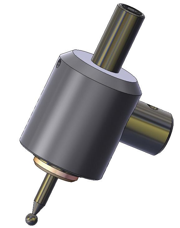

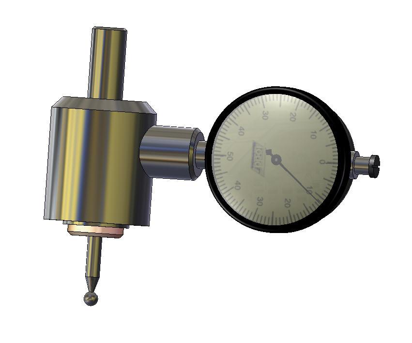

Sneak preview of my 3D indicator design.
  • Posts: 1179
Re: 3d indicator design
« Reply #1 on: April 03, 2012, 05:21:24 PM »
Finalising the design of the body.
Two parts Body of aluminium and Shaft of steel will be easier to make.

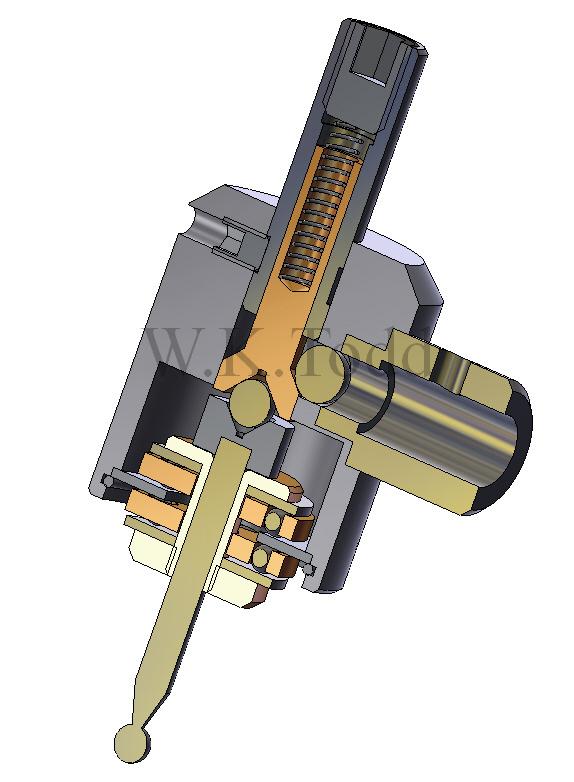

Still not quite worked out the probe bit yet, but you should be able to work out how it is supposed to work, from this section:

What advantages do you see for this 3D design over your earlier co-ax indicator?
It does a different job.
This is an edge finder, allowing any face in X, Y or Z planes to be located easily.

Nice drawing and concept, but not sure I can figure out how the probe gimbal works.  What keeps it in the centre under a side load.  I could understand a ball joint ?
  • Posts: 1319
« Reply #9 on: April 05, 2012, 09:59:39 AM »
Ahhh, the penny dropped, two caged bearing races slide over the sandwiched plate....

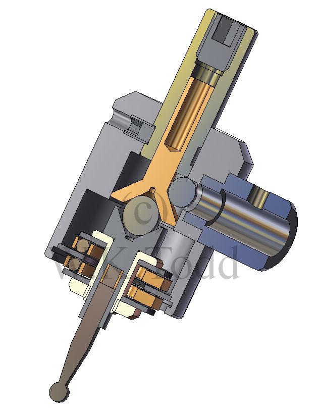

« Reply #13 on: April 11, 2012, 05:38:47 PM »
The latest incantation has bulked up a bit to accommodate a removable probe (held in place by a small magnet)
Still not quite there but getting close.

Gotta love the magnet idea
Really? I've gone off the idea after a thinking about it.  If/when a bit of swarf finds its way up the tube it'll cause chaos and be difficult to remove
« Reply #16 on: April 12, 2012, 08:51:03 AM »
Having a screw-in pointer (or a grubscrew fixing) might give a firmer fixing, Bill. One held by a magnet would have to be a very good fit in its hole to stop it waggling a bit from side to side.
  • Posts: 1179
« Reply #17 on: April 12, 2012, 10:25:46 AM »
Yes you're quite right.  A screw in one would be my preferred way, but I can see no way to stop the lower taper (the bit with the magnet above) turning.  A clamp with a grub screw might be the answer .
