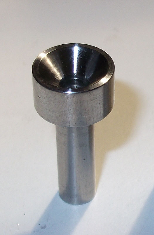

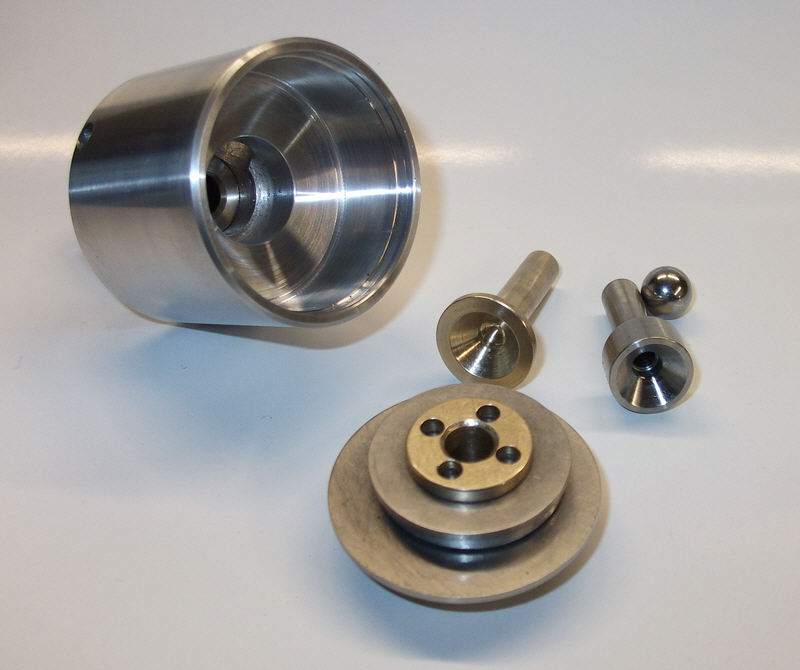

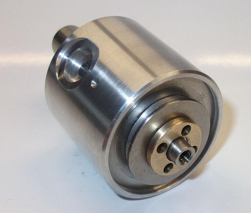

Made the upper taper and lapped  it into the main shaft. The two cones work as expected :)
The two ball cages were a bit of a disaster - I forgot to change the design (PCD of the ball holes) when changed it to use larger thrust washers  :scratch:  so the balls fell out when assembled  :hammer:

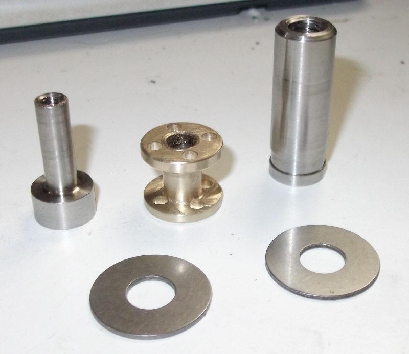

Also, real world tolerances of the thrust washers  (20.7 diameter instead of 21 with a 0.2 bevel on the edges etc.) mean that the over-lap between the washers is smaller than expected, leaving the slide a little short of travel (I am aiming at 4mm in all directions). So, although I had hoped to use standard parts, I may have to make the thrust washers myself :(
  • Posts: 1179
Re: 3d indicator design
« Reply #28 on: April 28, 2012, 01:24:14 PM »
Made the larger thrust washers from stainless steel (after three attempts!) - just need to lap the surface to a good finish.
Made the body from a piece of 40mm aluminium bar.
I still have to make the correct sized  bearing cages and the DTI mount.

To save making two of the thrust washers, I've redesigned the slide so that the slide-tube and nut do the job (they're very lightly loaded so don't really need to be hardened). I've also found some SS mudguard washers in suitable sizes (16x50)  which will avoid having to make any more bloody washers!.

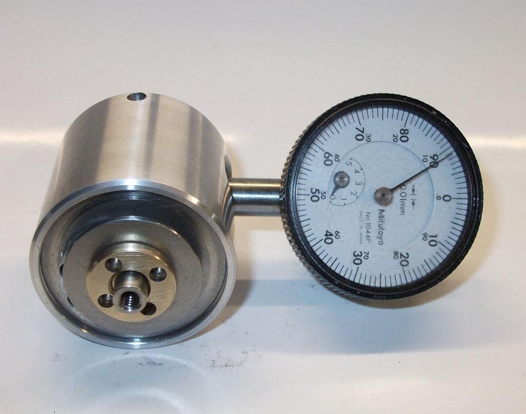

I found the time this afternoon to fix my cock-up and make the two new ball cages, so now it is almost finished.

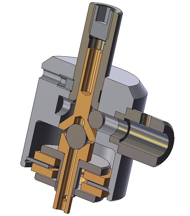

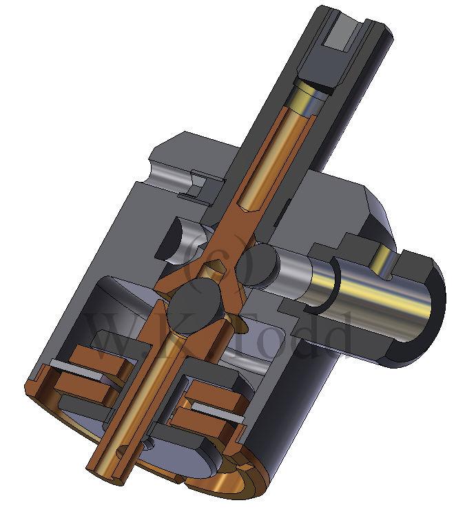

However, I've discovered a snag with the cir-clip idea; The large thrust washer has to be held against the step in the main body if the zero reference it to be stable. The cir-clip does not hold the washer tight enough (there's no room for a spring) .
To solve that I've redesign the body to have a screwed in locking ring at the bottom. As a simpler alternative, it would be also possible to screw the washer in place with a half-a-dozen small screws.
The next problem is because everything is tight with minimal clearances, I keep getting random jams - one minute it'll slide nicely, next it'll snag and jam  - a major PITA  :bang:

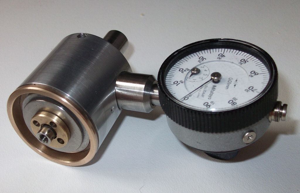

Well, your polishing idea has helped a lot :)  (it also showed me I had a slight eccentricity in the upper taper part ) Although, I think the main problem is a poor choice of materials (aluminium is too reactive to make a good sliding material).
It is now basically working (apart from the loose main thrust washer). I'm getting about 3.5mm movement in all directions.
However, I have spotted a fundamental flaw in the design; Most of the play in the sliding parts can be removed or ignored (i.e. the ball-slide can be tight and it really does not matter if the upper taper is a bit sloppy because it is biased one direction by the forces on it).
But, the bottom taper has to slide perfectly in the vertical direction without side play or the centre 'zero' position will be inaccurate  :bang:
Back to the drawing board...

That's a good point  Andy . One quick fix for the wobbly vertical slide would be to remove it - i.e. fix the probe in to the XY-plane slide and just use it as a 2D probe  :thumbup:

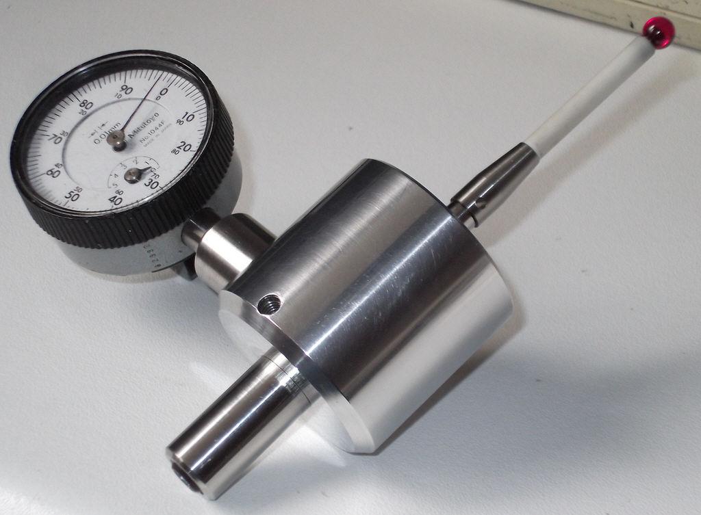

Adding a threaded lock nut has fixed the zeroing problem and makes the whole thing feel better :) (although I won't be using a 40tpi thread on the next one - way too fine and far too easy to cross-thread !)
Thinking about it some more; The play in the vertical slide only messes up the initial zero measurement  i.e. the rest position will not be exactly 2mm from the centre of a 4mm probe. However, as long as the play is consistent in all directions (which it should be), the edge position should be reliable.
Next , I'll make a short 4mm diameter probe  and test it.

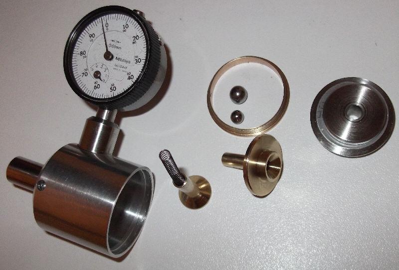

I've replaced the ballslide's  brass tube and washer design with a steel 'top-hat' & nut that runs directly on the balls.
The fit between the new brass bottom taper part and the ball-slide tube is now ten times better, and enlarged the top of the taper is less inclined to tip. All this has increased my confidence that this thing might work :)
I just have to tweak the depth of the shoulder in the body to suit the new parts and it should be ready to test properly  :thumbup:

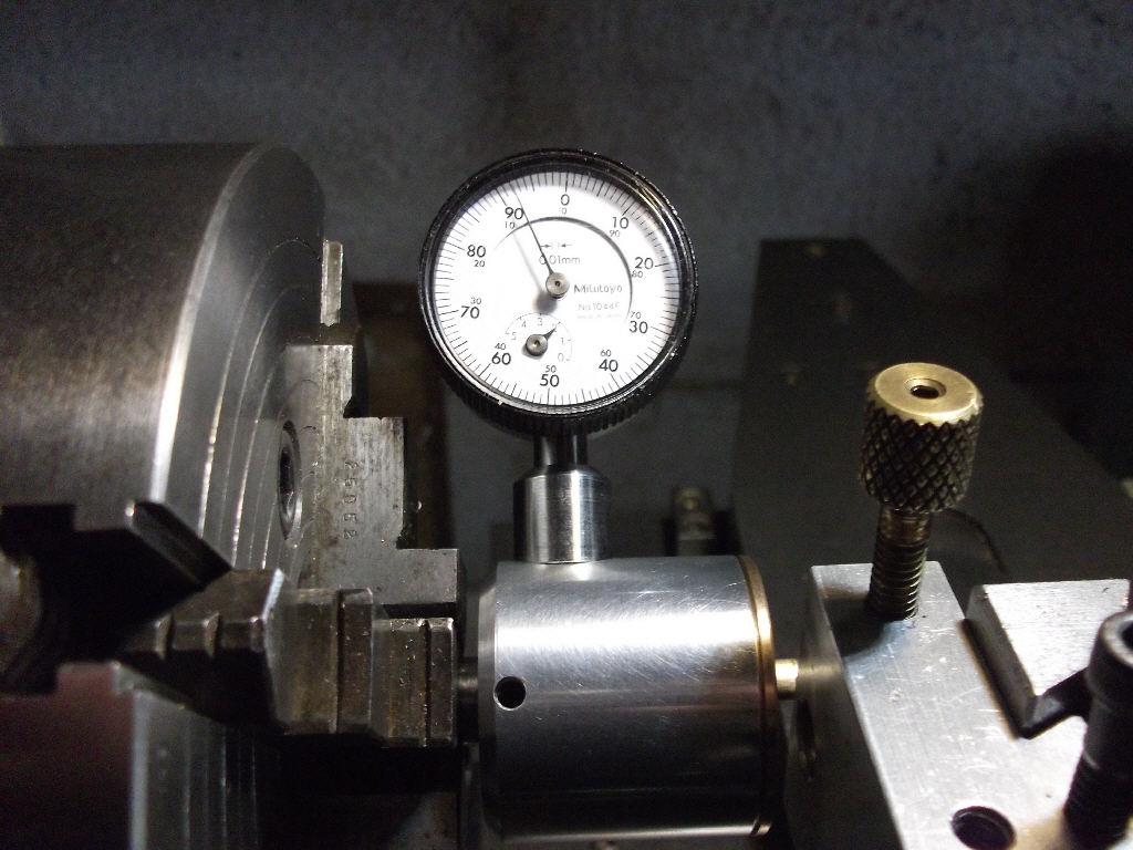

Well it kinda works...

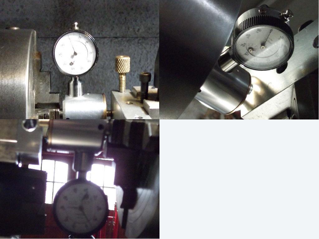

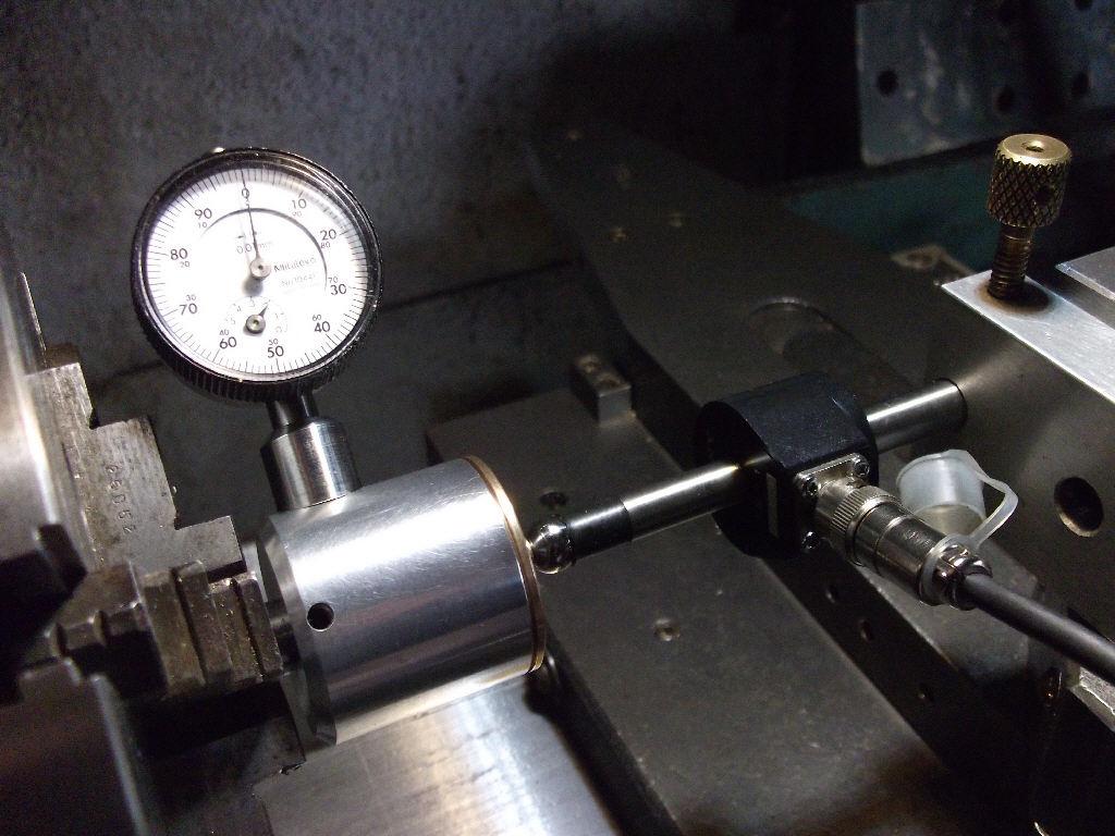

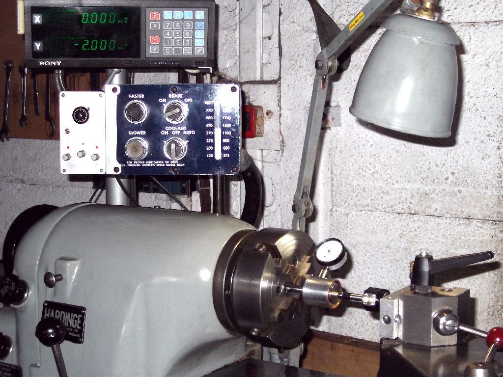

To test it I set it up in the 4 jaw on my lathe so I could access the accuracy using the lathe's Sony DRO (good to a few microns)
I zeroed the dial then used the DRO's touch sensor to set the DRO to zero for the 'depth' (Z axis) test. Then wound the carriage in by 2.000mm (see test1.jpg)  . The dial reading was about 50um short. This was not unexpected as I don't know how accurate the DTI is or how accurate my 45° tapers are, and absolute accuracy it is not too important for an edge detector.
Then I zeroed the DTI (at 2mm in) to test the XY plane using the cross-slide (see test1a.jog). I zeroed the cross-slide DRO just as the tool post hit the probe (couldn't get the touch sensor in a position to test this so there could be a small error) . Then moved the cross-slide in 2.000mm. This time the DTI read 80um short (meaning there is about 80um movement in the X+ direction, i.e towards the indicator, before the DTI moves) (pic test 2a.jpg).
I re-zeroed the DTI and tested it in the three other orientations (X-, Y+, Y-) see test2.jpg.  It seemed reasonably consistent  perhaps 20um out in the Y- direction (could be chucking run-out  or a gravity effect?).
All of which makes me wonder if this is ever going to be accurate enough to be useful  :doh: ?????
There is only the tiniest play in the ball slide (I chose to bond the parts together this time instead of screwing them) and the fit of the other parts would be difficult for me to improve on, so I'm now not sure if I can get this to work  :scratch:
