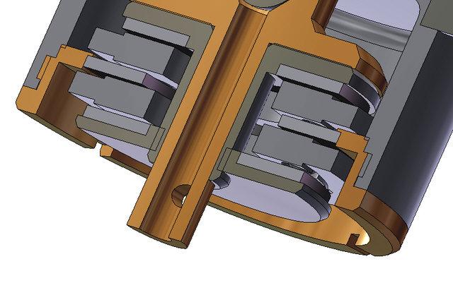

Yes, the cross-section view can be a bit misleading.

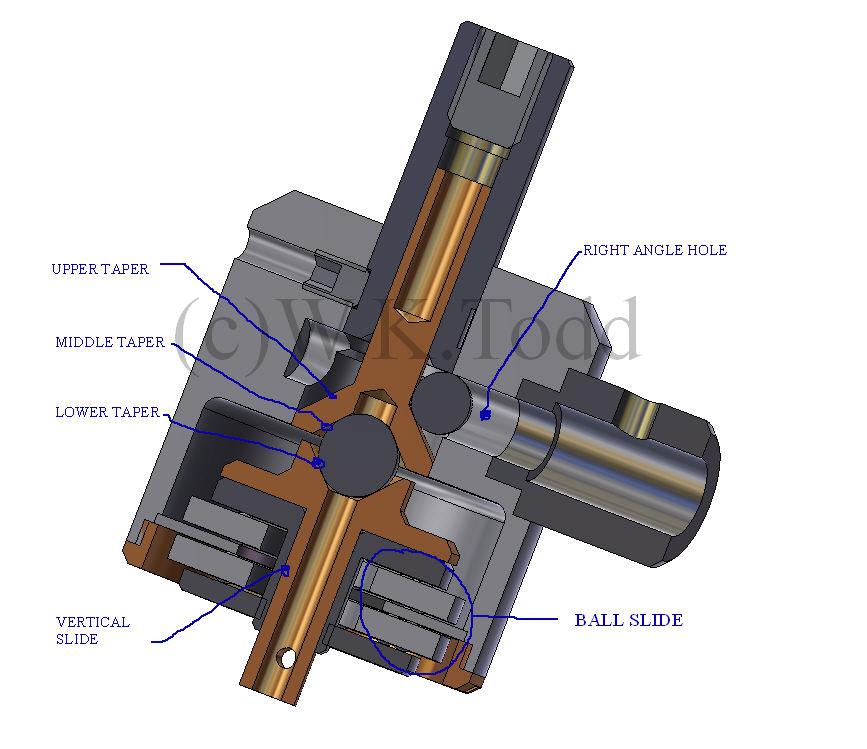

It is, as David suggests, a disc with a torus around the edge.  :) It might  make a simple edge detector but, because to the non-linearity, it would be only be suitable to a fix sized probe
I haven't abandoned the ball slide idea just yet; While sitting on the throne this morning, contemplating the weightier of matters of state, I started to wonder where the errors are creeping in...
First up is to test the DTI. Then, just to see where the 50um/2thou" on the Z axis has gone, test the upper taper section with out the lower taper or ball in the way.
At the moment, I cannot account for all the missing 80um/3thou" in the XY plane; The play in the vertical slide  is << 1 thou" and by playing with it (pushing and pulling it ) the ball-slide has <10um according to the dial.

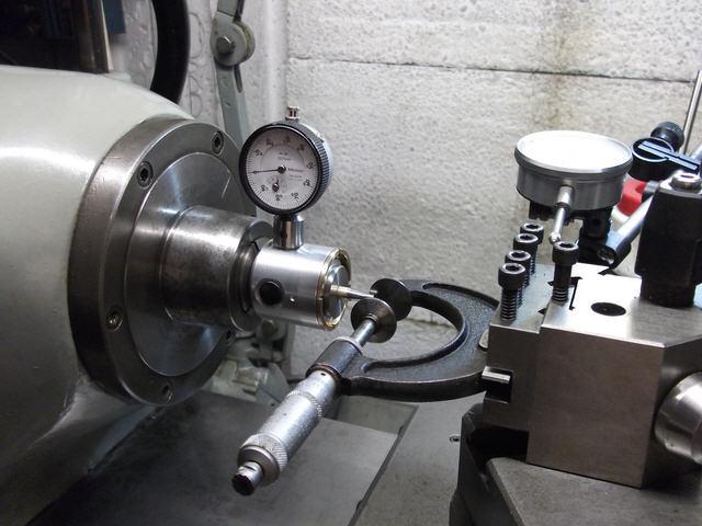

I found a hour yesterday to test the DTI etc.
The DTI is OK within a few microns (i.e. within readable limits)
When I tested the Upper Taper alone. I discovered that there is a small difference (~15um) between one direction and the other. That is, going IN to zero on the DTI will give a different reading on the DRO to moving OUT to zero.
I think this is caused by the motion of the ball in the right-angle hole and this maybe due to my use of a non-flat tip on the end of the DTI, so I'll have to make a flat tip and test it.
I'm now fairly sure that the major cause of the other errors is the angle of the tapers: The upper taper shows a error of ~50um over 2mm (middle taper was cut at the same time so will have the same error) .  The lower tape was cut in something of a hurry so is likely to be even worse!

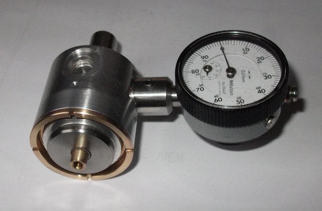

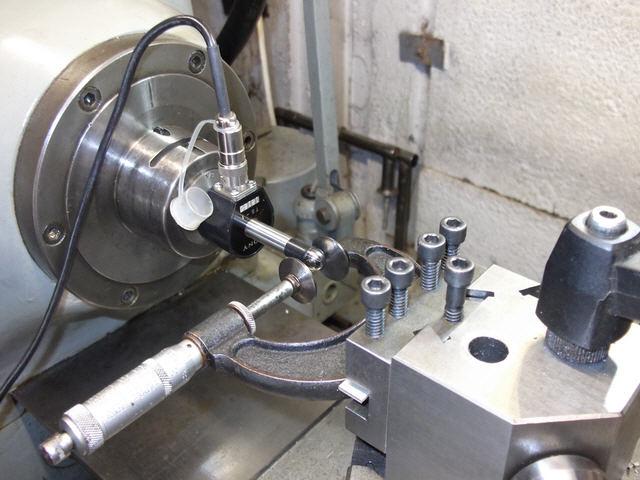

I've fixed IN/OUT the problem with a flat DTI tip. It now repeats within a few microns.
However  :scratch: :scratch: :scratch:
I spend a couple of hours checking and rechecking my taper setting using a sine bar. Finding a stack of objects exactly 3.5355" was a challenge but,  in  the end,  two V blocks & a thrust washer measured to better than 1/2thou".

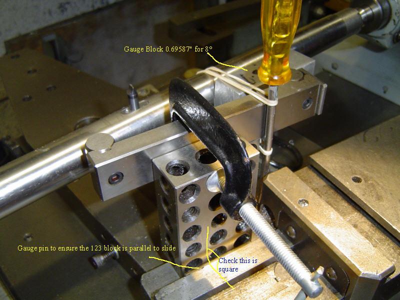

Then I carefully set the top-slide (the picture below is of the general method used ) and re-cut the tapers - well I say "re-cut" but actually there was so little difference between the existing tapers and the new uber-accurate ones it was hardly worth touching them :(
So, with my backache getting the better of me,  I set about measuring the top taper in the indicator :
Unsurprisingly; 2.000mm indicated on the DRO read 1.920mm  on the DTI   :bang: :bang:
So, where is this error?
I then stepped the DTI 100um at a time while noting the DRO reading (see PDF)  to see it I could spot a jump or anything that could explain a taper (as shown by the difference plot)  of nearly 0.1mm (>3thou") over just 2mm (~3/32")  (that should be almost visible!)
The only place it can be, is in the right-angle hole but that doesn't look too bad from what I can see so....
what am I missing??? Ideas welcome. (remember I'm testing this without the lower taper part and ball-slide so it should be at least as good as the DTI)

Hi Pekka,
I've checked the DTI against the DRO directly and both correlate very well (to within the thickness of the needle). I have great confidence in the Sony DRO - I have checked it against standard length gauges etc.  - It was a very expensive piece of kit when new !
I'm now thinking about increasing the bore of the right-angle hole to 8mm (as I have some 8mm bearing balls)  that should compensate for the material removed from the tapers and give me the opportunity to correct any taper (or irregularity) in the bore.
[edit]
I threw caution to the wind and drilled the hole out to 6.5mm   -  worse errors  and on close inspection there was a small step in the bore just  where the ball would be running.
Drastic action...
Dismantled the body parts completely and drilled & reamed another right-angle hole at 90° to the previous one.
Result - less error but still ~50um short ...
Back-ache stopped play -  retired to the pavilion ...

I really hesitated to post this, but it seem (to me) the error comes from the 45 deg taper.
The way I'm looking at it the DTI reading is always smaller, so the ball isn't moving as much as it should. So if the taper angle was larger than 45 deg that would cause the ball not to move as much.
Try a new 6.5 mm dia hole opposite the very first one, that should eliminate any slight difference to the accuracy of the main bore and the right angle hole not being exactly at 90 deg.
Don't hesitate if you spot something ('cos I'm a blind as a bat when it come to some things)
Anyway you're kinda right ....

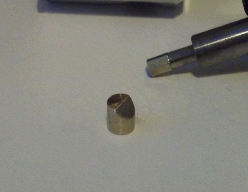

Cracked it :ddb:
Or rather my friend Chris cracked it  :beer:
I was showing him the problem this evening and he came up with the brilliant suggestion that the ball might not be running down the centre of the cone . BINGO Indeed it will  try to do everything in its power to avoid running down the highest spot
Any error in the centring of my hole, or play between the ball and the hole, will allow the ball to run to one side of the taper and thus run on a parabola (a conic section) not on the true 45° face.
The fix was simple: replace the ball with a small brass slide that presents a flat plane to the cone thus only following the highest part.
Testing on the lathe now shows the right-angle DTI  tracking to within a few microns (<8um at 2mm) .
I'm back on track :)
I now have to adjust the fit of the large thrust washer, so it goes a bit deeper into the body (again!) and I'll be ready to test it properly (again!)

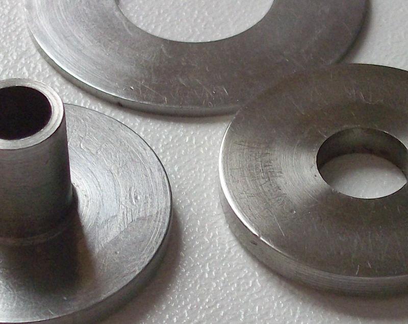

Today I pressed the slide apart only  to find all the surfaces badly brinelled (dented by the bearing balls)  - I knew this could be a problem with non-hard surfaces, but was surprised because of the relatively light loads on the bearing.
So, now I'm trying to  figure out how to fit standard sized hardened thrust washers to the bearing surfaces  :scratch:

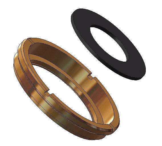

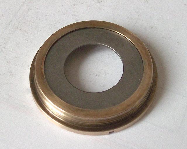

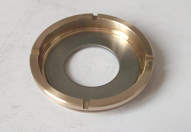

I can't find suitably wide (i.e. large diameter with a small hole) thrust washers anywhere, so I've had to redesign the locking ring to hold a standard (30 x 17) thrust washer.
I found time today to make the locking ring and press fitted the washer. seems OK :)
Hopefully, tomorrow I'll trim the bearing cages to clear the lip (that keeps the washer square )

Yes, the washer sits down on a tiny facet turned true in situ (I used the indicator body to hold the ring while turning the face).
I hope to get on and finish it this afternoon (it's a bank holiday here today).

Hmmm quite well, but consistently 17thou off (measuring an inch)  - I was expecting an error because of the dead spot in the middle (slack in the ball slide & other parts) but not that much   :bugeye:
However, it is consistent, giving the same error in all directions (well the 90, 180 etc. that I tested) so it's a simple matter of adjusting the size of the probe to compensate...
That's where the day peaked  :hammer:
Had a phone call - "This 'clip' you want made... Is it really nearly an inch thick and half-a-metre wide ???"
DXF conversion strikes again - 16mm gets changed to 16 inches then converted back to 406mm on import   :bang:
I make the probe tip, after a lot of faffing around
Then I manage to break the  washer out of the ring while trying to screw the probe in  - Of course,  it will not go back in with out more faffing - Now I'm waiting for the loctite to set...  :bang:
Time for more coffee

Finally I found time to do some tests.  I clamped a micrometer in the tool post and used the DRO's touch probe to give me an absolute zero face  then adjusted the mic to give a second face at 20mm spacing.
 :scratch:
While it appears reasonably consistent in any one direction ( i.e. once zeroed in a direction it will return to zero within 10um - even if removed from the lathe),  it will not accurately measure between faces because of the play in the bottom taper slide (I had to re-ream this after I threaded it, so I guess it's now too big :()
Maybe it's time to throw in the towel ? (I've lost faith in the design)
