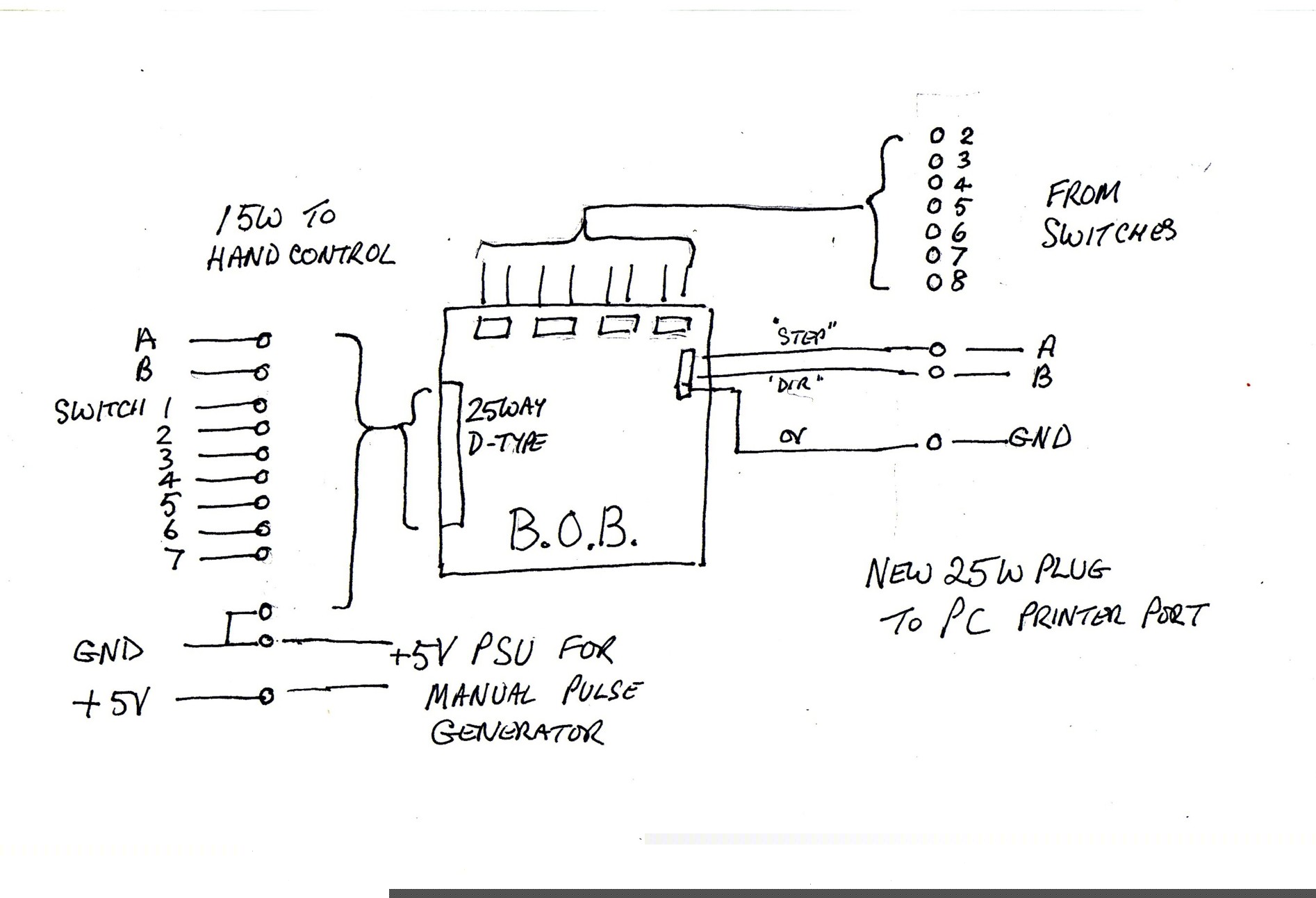

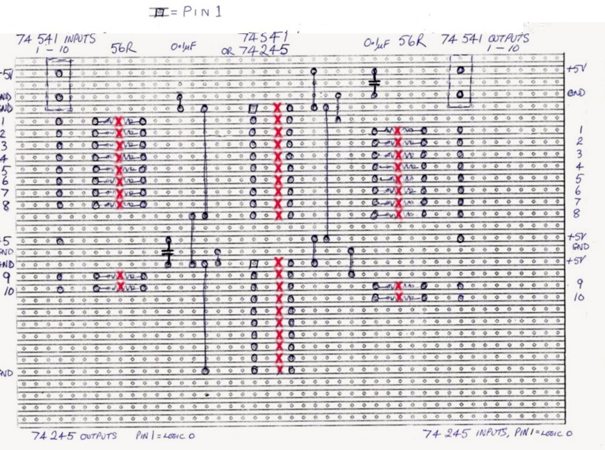

Hi Rob,
now I've had a look at the data for the 74245 and 74541 , the new revised the layout can be  use with either IC
assuming the D type connectors are connected via a ribbon cable
note when  pin 1 is connected to 0V the input and output pins are on opposite sides ! (74541 o/p  pins 11 to 18 , 74245 o/p pins 2 to 9 )
pin 1 on the 74245 controls the direction of data flow
and at +5v the data in and out will match that of the 74541
as before the 56 ohm resistors are optional
just a thought ,the break out board you have could be used
if you make a cable / adaptor ,connecting the manual control  to the breakout boards 25Way connector
and wire a 25way D-type  to the 5 pairs of step and direction terminals to connect to the printer port
PS - without a copy of the manual I am not sure if an enable input needs connecting to GND , assuming open circuit  = logic 1  ?

Wow John ,,,,, you have been busy  :thumbup:
I have already started on BOB 1.0   :dremel:  just needs soldering .
I would rather keep that as a spare ,,,,,, more fun building your design  :)
Its only one page ,,, mostly chinglish  :lol:  ,,,,,,,I had it connected to ground  , What i can tell you is when the enable button is pressed the selected pin in Mach goes High and stays High  , only goes Low when another pin is selected and enable is pressed ,, any help ?
i will scan handheld sheet  :thumbup:
Thanks Rob

Not allot done today ,,, soldered the parts to the board as per Johns diagram   :med:   ,, although i did move the E stop to the other side of the board so i can just link it straight across to the first BOB E stop input  .
Hopefully i should get time to pick up the chips tomorrow  :zap:  ,,,,, i also  still have the leads to solder to the board .
Offline John Swift
  • Posts: 344
Re: Chester 626 mill CNC Conversion
« Reply #79 on: October 23, 2011, 04:03:38 PM »
Hi Rob
thats  looking great
for now you can check you have +5v on pin 20
and 0v  on pins 1,10 & 19
as soon as you receive the IC's you can test the board
with the notched end of the ICs nearest  to the other breakout board
you will find all the remaining pins at +5v until the control switches or MPG
connects a pin to 0v (GND)

Cheers John  :thumbup:
Got Those voltages at those pins  :thumbup:
Installed chips ,,,,,, dont have +5v on the other pins  :scratch:   ,,,,,,,, all pins on the left side of chips at 0v ,,,,,, nothing on the Right side

« Reply #81 on: October 24, 2011, 01:24:12 PM »
Hi Rob
just had a look at your pictures and it looks OK  ,should of worked
double check the ICs are in the right way up --- see  the diagram
with nothing on either the input or output pins
its as if the level on the output enable pin 19 is wrong
and the i/o pins are high impedance ,but it says in the data its active low
easy way to prove the enable input is correct , unplug the IC and put it back in with pin 19 bent out to miss the socket ,
if the ic now works the connection is wrong
  an unconnected TTL IC input should count as a logic one
I'll have a look to see if I have an IC  to prove the circuit

Hi John
Did that ,,,,,, and with pin 19 out ,,,, there is nothing on both sides of the pins  :scratch: .

  Hi Rob ,
I've found an IC  on  an old board and de-soldered the   DM74LS245N
 connecting pins 1 , 10 and 19 together to 0v
and pin 20 to +5v with a few wires dead bug style
this is what I measured from pin 10   (0v / GND)
pin 20 = 5.08v  (positive supply pin)
input pins 11 to 18 = 2.5v  ( pin not connected to any thing)
output pins 2 to 9 = 4.85v
connecting an input to 0v , the corresponding  output =0.1v
so it works as expected
whats   RS part number of your IC's  ?

Well looks like it my fault ,,,,,,,, nowt wrong with the chips wired them up on a bread board ,,,,,, and they work  :coffee:  just as John said it would  :med:

Hi Rob ,
I am sure your board is correctly wired
the only thing I can think of is the HCT version being  a CMOS device , needs the input pins connecting to +5v via a resistor
unlike earlier devices like the 74LS245 version I've tested
you can prove this by connecting one  inputs of a 74hct245 to +5v   (with  pin 19 back into the socket !)
if you now have +5v at the output ,
then you need to use  pull up resistors connecting the input pins to the +5V
(or another version of the IC like the 74LS245)
if you re-used the 56 ohm resistors for the switch inputs the switch will pass 0.1A to GND
without any info on the manual pulse generator
try 4k7 resistors to connect the A & B inputs to +5V
the connect the un used 74hct245 inputs to either 0V or  +5V
another way is to use single in line resistors
