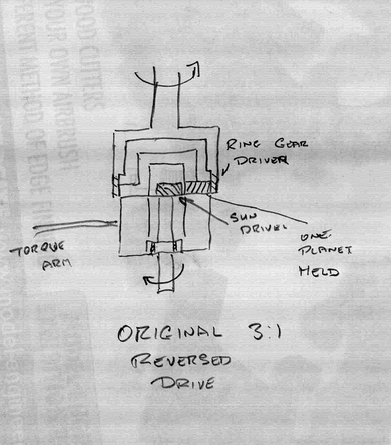

I had a look at that kit a couple of years ago and was a little concerned about the provision of bearings, even without adding anything extra like an ER collet, - I seem to recall that at least one of the shafts only had a bearing at the top or at the bottom.  Also, from memory, the output direction was reversed, so when in use under CNC you'll have to make sure that your CAM transposes M04 and M03 when the speeder is deployed ....
My impression was that it might be appropriate for light horological work, but not for long CNC runs.

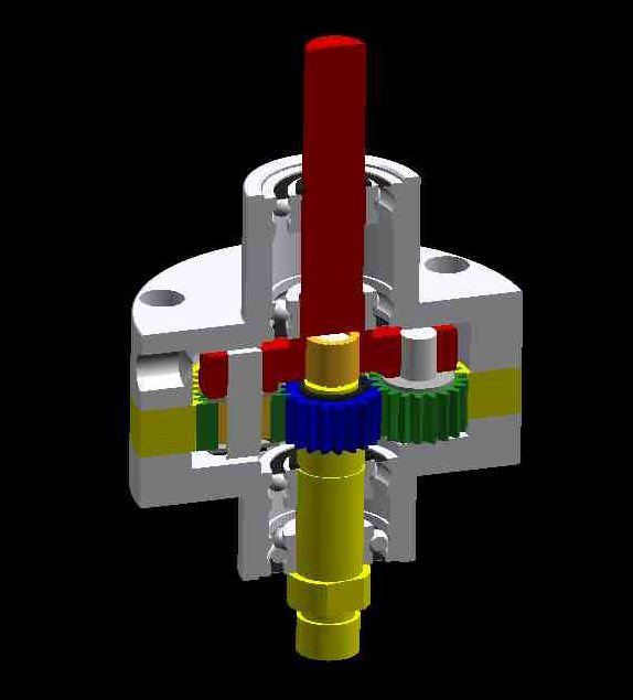

It's not a good design, in fact it's very flawed.
One it reverses rotation, secondly no top support bearing and it only uses one planet wheel so it's trying to force the top of the spindle out of mesh and the missing bearing helps.
Using the same components and one extra planet redesigned it can be made to go the same way and have a 4:1 increase instead of the 3:1 of the original.
Original design.
Improved design using same parts but two planets
Four bearings for stability and can use an off the shelf collet chuck as the output shaft.
John S.

Very interesting John  :thumbup:  the redesign looks a big improvement on the original and making one would save the work of modifying the original head  :dremel:
