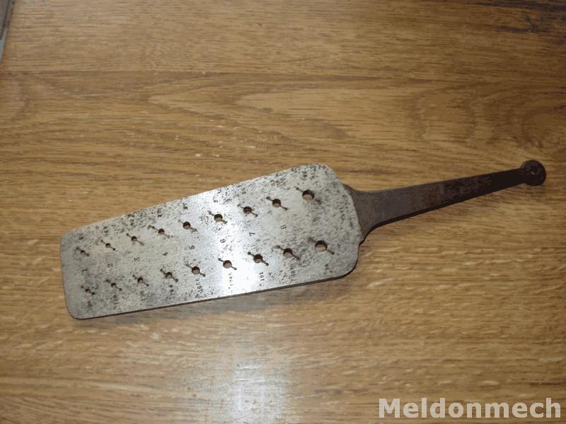

Hi Guys,
                 I have this screw plate stamped Buck & Hickman 1892. The threads are numbered  1 smallest to 9.  The left hand threads are decimal marked from .094 to .25. The threads on the right are the same size but have numbers marked which are not  sequential, top to bottom :57, 49, 42, 37, 37, 50, 26, 33, 20, may be tpi ? Can anyone provide further information regarding the identity of these threads.
                                                                 Cheers David

Hi there, David,
I have just had a quick look in my 1971/72 edition of the Buck and Hickman catalogue (the last hard-back version before they went paperback).  Sadly, I have to report that I couldn't find any mention of your screw plate there.

« Reply #2 on: May 17, 2013, 09:23:07 AM »
You could try running some soft wire through it and gauging the resulting threads to confirm TPI.

I'm going to take a stab at it -- pure guesswork -- and suggest that it is an early BA thread --  but prior to standardization in 1903. I think the sizes are a therefore a little arbitrary but I'm guessing the maker made them compatible with Birmingham / Stubs wire gauges eg the first screw die takes a 13GA --  I'm not sure about the consecutive numbers because they don't match with wire gauges but that could just be a simple identification.

As far as we have it, Buck and Hickman only started in 1830.
The screw plate is far earlier than that. Charles Holzapffel illustrates the tool and goes on to wisely conclude that diestocks , in common with other  general tools, has received a great many modifications that it would be useless to trace in greater detail.
Oddly I have a slightly more modern version which hangs -with my screwing tackle- pronounced 'Take-ell' in Armstrong Whitworth country.  Mine is 'Coarse Whitworth' of course.
