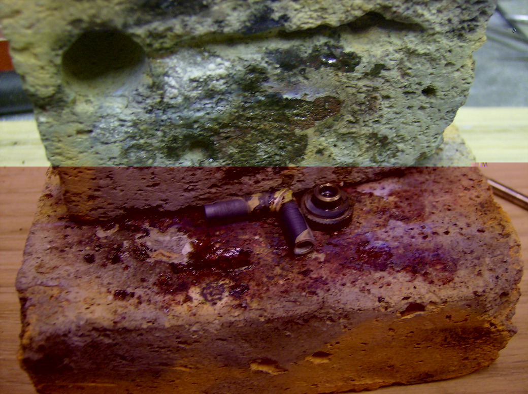

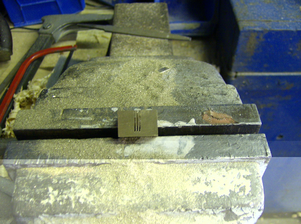

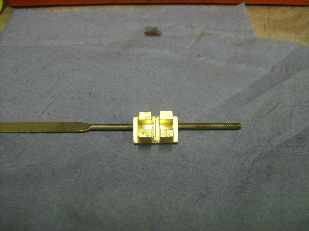

HI all its bin sum time  sinse i last posted right on friday i maniged to start and finish the valve chest for my engine No 11 right pisc

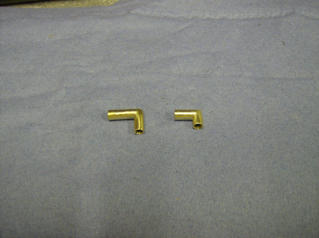

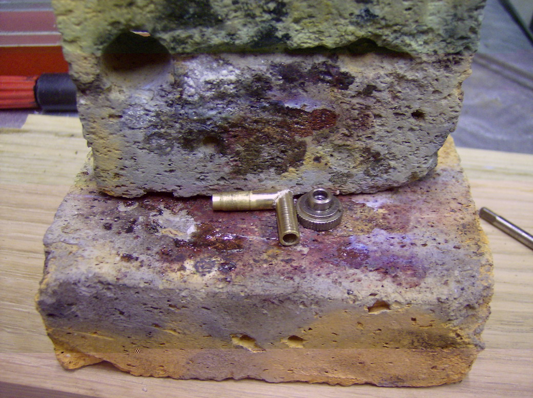

HI all ? have looked for my post on engine No 11 can not find it   never mind did a bit more today made the valve and valve nut and two pipe fitings   sum pics

« Reply #5 on: May 29, 2011, 09:05:02 PM »
Krv,
It's nice to see that you are doing it the long way, by hand.
A lot of us have forgotten that a drill, hacksaw and file can be used instead of a mill. It brings back memories when I had no mill either, but I had a lot of elbow power then.

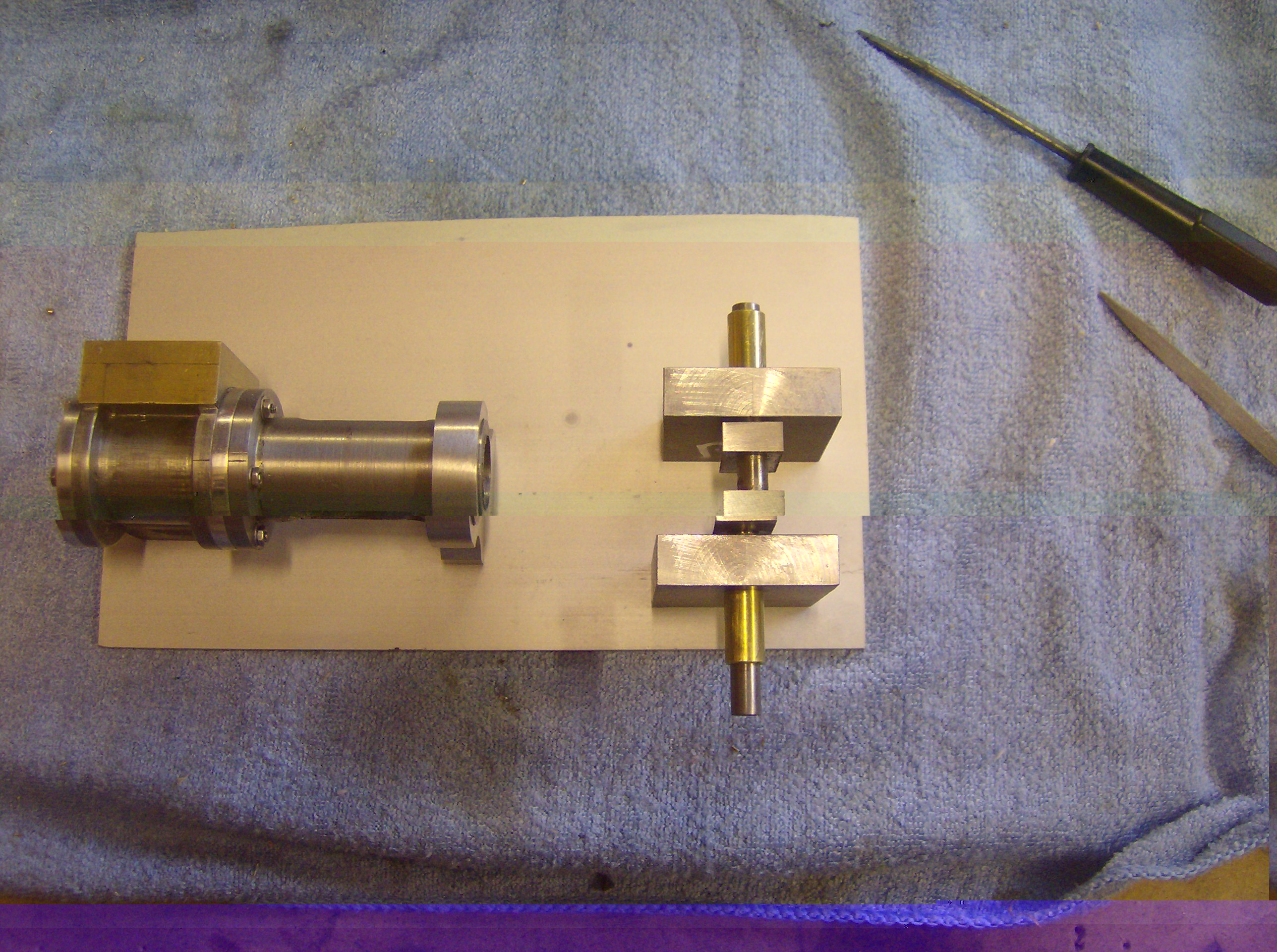

Hi more pics

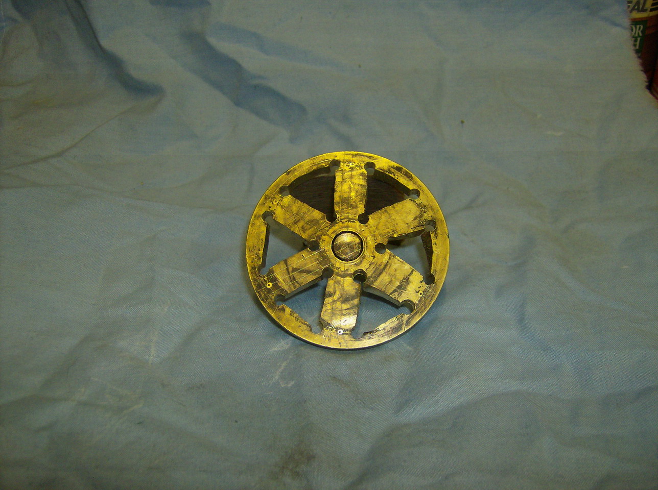

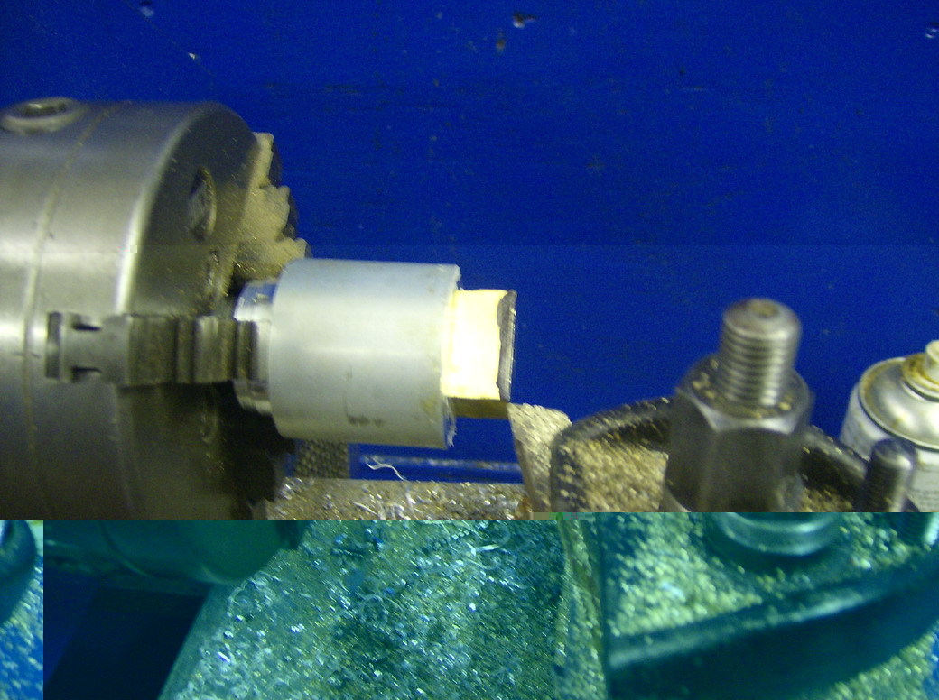

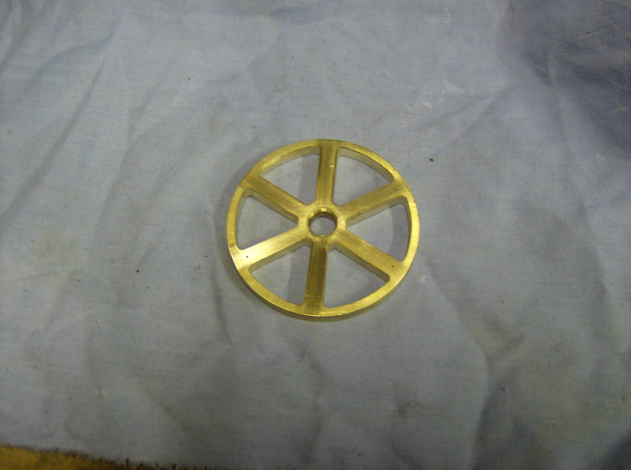

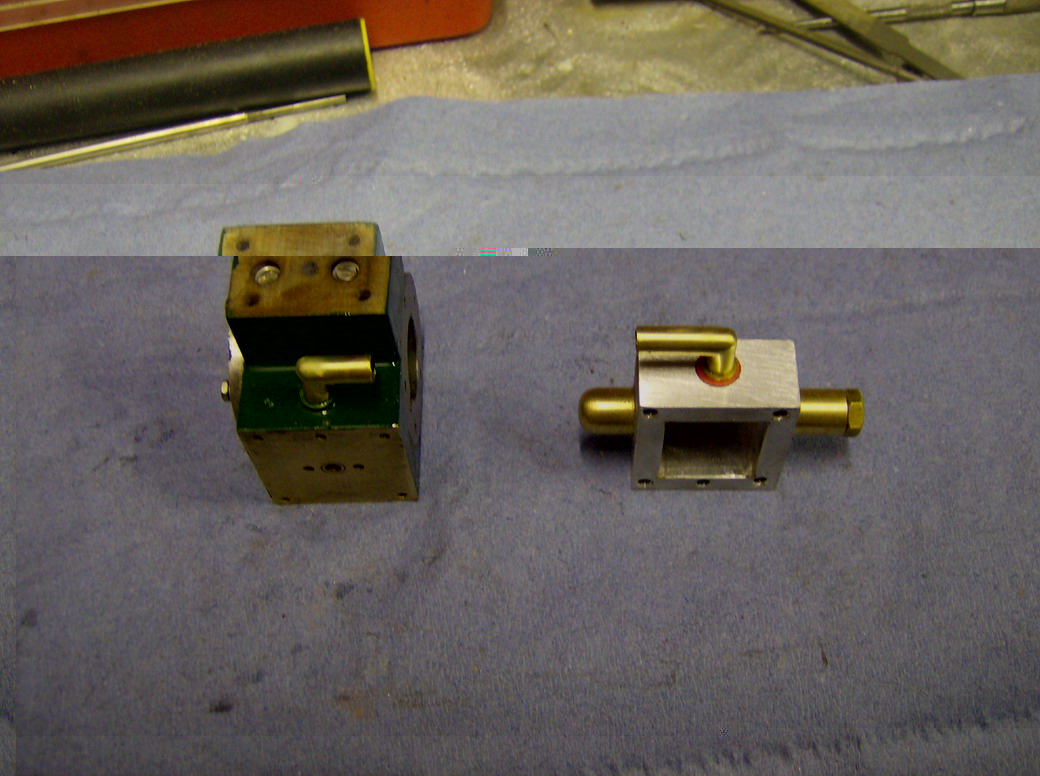

hi all i hope you all are not geting fed up of me posting so much    right i did a bit more today i gave sum partes a good cleen redy for fimel asembaly and made up the cupaling for the valve   sum pics

Really nice going Bob  :clap: :clap: :clap:
Very impressed ,, just love that flywheel   :dremel:
You could do with a few more photos  :poke: :poke: :)

In your pics, i see what looks like wood in the barrel can u explane a little, i dont know the design :)
A little bit every day, sometimes the same little bit!
Re: engine No11
« Reply #24 on: June 04, 2011, 07:57:41 AM »
HI yep no problem the engine is made up by me no desing as sutsh rufley bast on a stuart turner No 10 horesontel engine the wood on the barrel is to asimualate silinder laging all i did for that is turn up a pece of wood then drilld out the midel cut to lenth then cut it to fit a rawnd the cilinder its not one hole pece but two if you look you may see the joine then its glued on to the cilinder with thermobond its a bit like epoxey but desinde for things that gets hot
