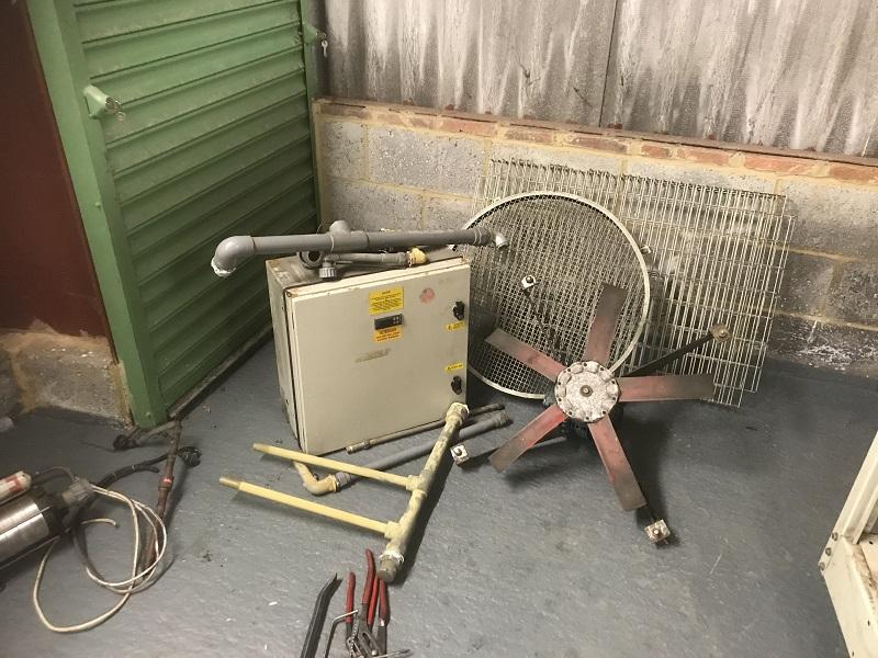

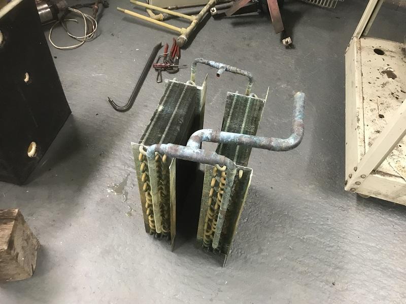

So at last back to the chiller - I've decided it is not worth re-working the case - I will make a skeleton one out of heavy box tube giving a much smaller footprint  so no point in more case dismantling - the scrap recipient can do that!
So I removed the entire control box with it's various useful breakers and relays, and also the huge extractor fan that sat on the lid, and then turned my attention to the water tank.

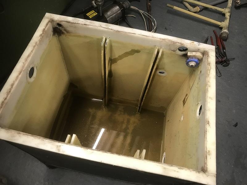

An angle grinder took care of the internal copper plumbing allowing me to remove the copper evaporator as a complete unit (lucky scrap recipient - it's heavy and solid copper!) and then cleaned the tank using my petrol pressure washer - it's not come out too badly.

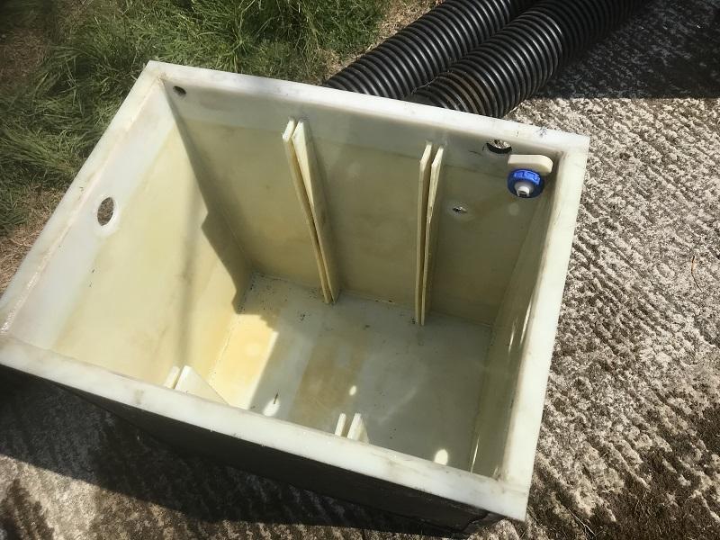

This tank is 110 litres /  or 24 UK gallons so reasonably sizeable - I think a frame about 30 x 24 inches should accommodate the tank and pump on the ground floor, with the heat exchanger and other controls a bit higher up. I ordered some cheap imported LED temperature indicators on ebay so that all ports of the heat exchanger can be monitored - so a front panel mounting them, the start / stop for the pump and anything else I've forgotten can be up at eye level.

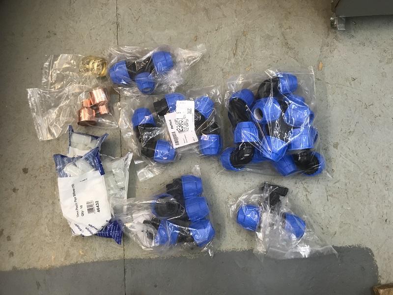

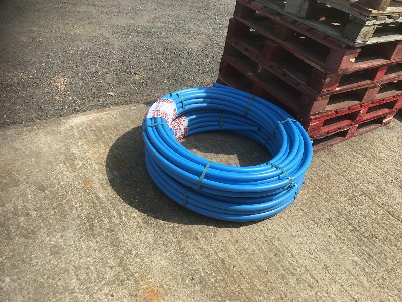

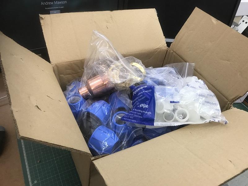

While all this was happening the pipe and plumbing fittings were delivered - so a quick goods inwards check to see that it's all there - yes it is but I'm sure I've forgotten something - always seems to happen with these projects!

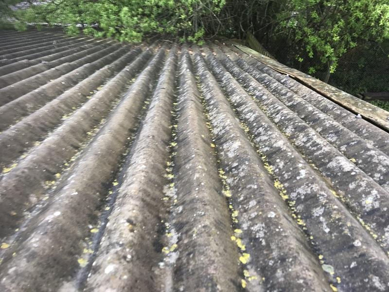

Pouring down here and I’ve just been out to the ‘soon to be’ foundry to find numerous leaks in the roof :bang:
It’s a fibre  reinforced cement ‘big 6’ roof in good condition only 10 years old but laid to a fairly shallow pitch. Leaks are at sheet overlaps so I’m hoping that maybe there is a build up of leaves from a large tree close by. Too much rain to look at the moment. Don’t fancy drips into the high power electronics  :bugeye:
« Reply #205 on: April 28, 2020, 06:24:27 AM »

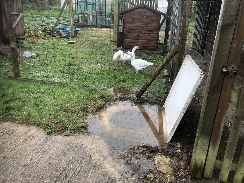

The rain has subsided to an annoying drizzle, so I was able to put a ladder up and look at the foundry roof. Sure enough there IS a bit of a build up of moss and  rather too much overhanging willow tree. I expect that the water isn't clearing fast enough and is tracking back up the overlapping joints when the rain is heavy.
Talking of heavy rain - the bore hole is now OVERFLOWING  :bugeye:
The Black Jack to paint the newly cleaned manhole frame and cover has arrived, but that can't go on until the weather changes.

Probably so Ade !
I'm hoping to be able to incorporate an overflow pipe at the level of the lowest brick course. I happen to have a run of perforated ground drain not very far from there, (albeit the other side of a Portakabin) that joins into the main run of surface drains to the stream - with any luck I can intercept it and join in.

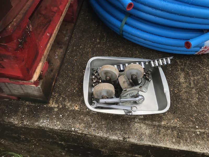

Old Chiller chassis palletised and dragged out to make a bit of space, I did save it's castors as it was easy to when hoisted up with the forklift!  And then I finished off cutting the box tubing for its replacement that I started yesterday. I need to clear space in the welding shop before I start putting it together - of course sods law dictates that it's slightly too large for my welding bench !

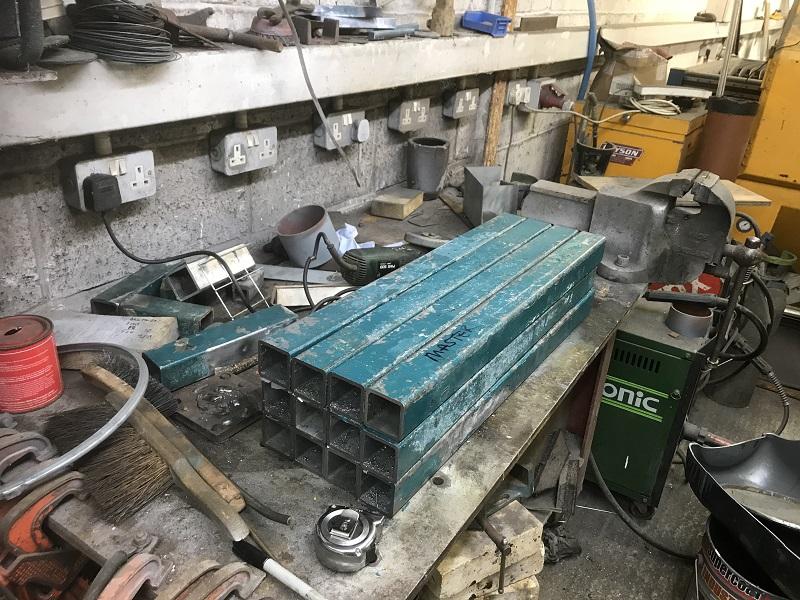

« Reply #213 on: April 29, 2020, 11:02:38 AM »

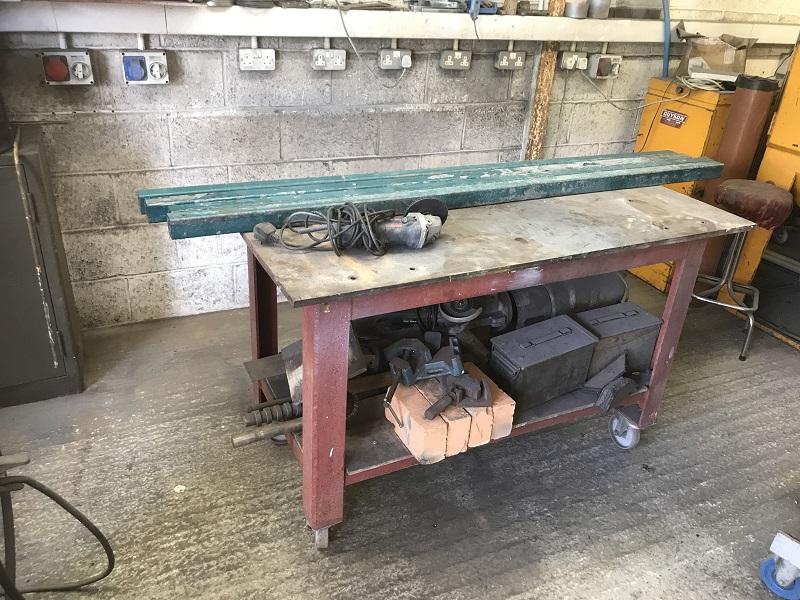

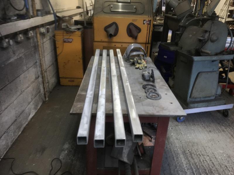

Raining hard again this afternoon, so the welding shop didn't get reorganised (much easier when things can be temporarily be moved outside)

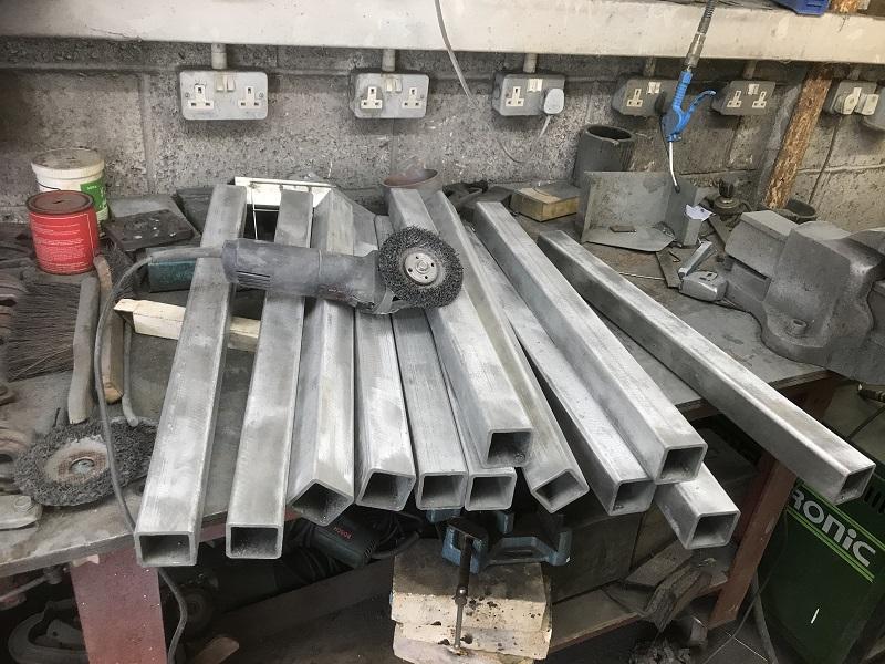

But I did strip the peeling paint off all twelve cross members ready for welding. I didn't do the four uprights as they will be far easier when the bench is moved to a more convenient place - hopefully tomorrow.
I used grizzly stripping disks - these take paint off at a great rate of knots  and are slightly kinder to the underlying metal than coarse sanding disks. They are also EXCELLENT at taking the skin off your knuckles! Amazingly I found that I had a box and a half in stock from some other project. Used three so far.
These box sections are very heavy dip galvanised and I wanted to leave as much zinc on them as possible.

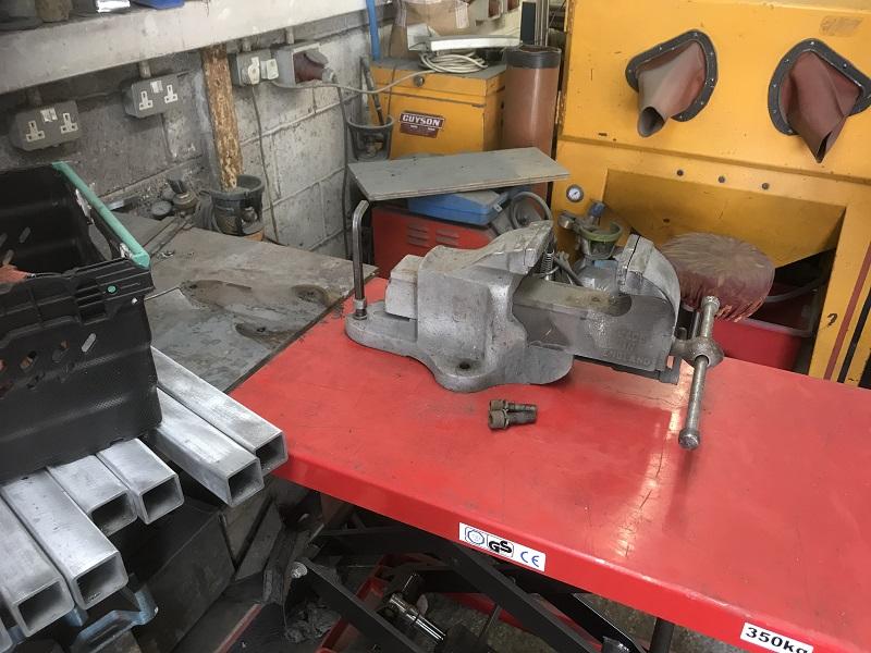

« Reply #214 on: April 30, 2020, 10:24:32 AM »

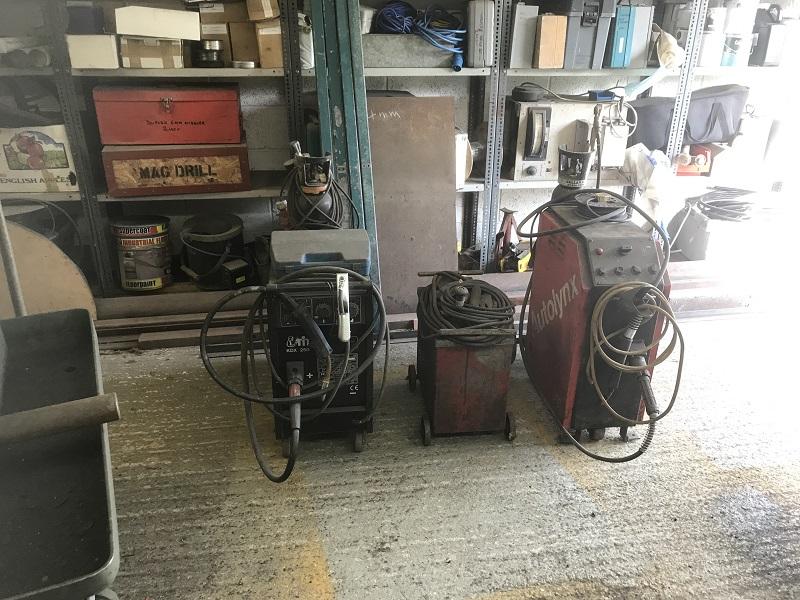

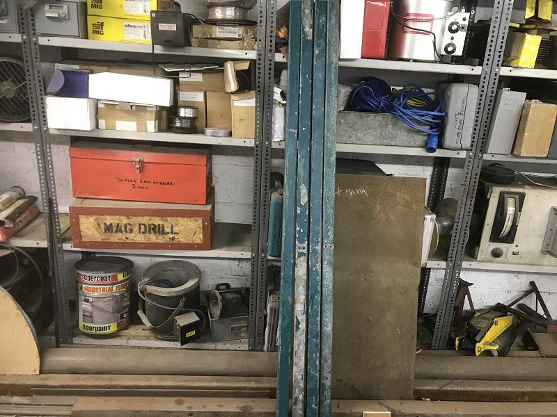

A major push this morning to dig my welding bench out from the accumulation of encumbrances that have  built up around it - various  welders (which I suppose are justifiable next to a welding bench!) and other junk not so justifiable.
Then finding a home for the multitude of clamps that normally sit clamped to the edge of the bench, and removing the very heavy vice, and a pile of rather nice fire bricks (thanks Pete. !) I was able to pull it out to a position where the frame that I'm about to weld up can hang over the edge, and be worked on all round.

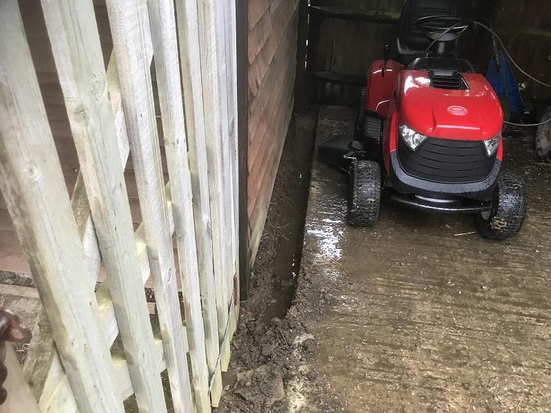

About then my oil boiler man turned up to service  the three systems we have on the farm and repair the oil level monitoring system, so activity had to cease.
I did however manage to plot the route of the ground drain that I want to intercept for the bore hole overflow, and start the digging of a trench from the bore hole to the fence, the other side of which the drain runs about three foot out. I have a 'CAT and Genny' - ie a Cable Avoidance Tool which is fine for metal pipe and cables but not plastic pipes. So again my 250 metre long reel of fibreglass ducting rod came in handy, tying a random length of wire to it, and threading it down the drain, attaching the other end to the genny. Worked an absolute charm. (Picture rather fussy - rain pouring down - taken from under an umbrella !)
Hopefully tomorrow will see the four frame uprights paint stripped and welding can commence.
(later edit: for the record so that I can refer back to it if I need to, the detected field drain is 69 " from the face of the fence)

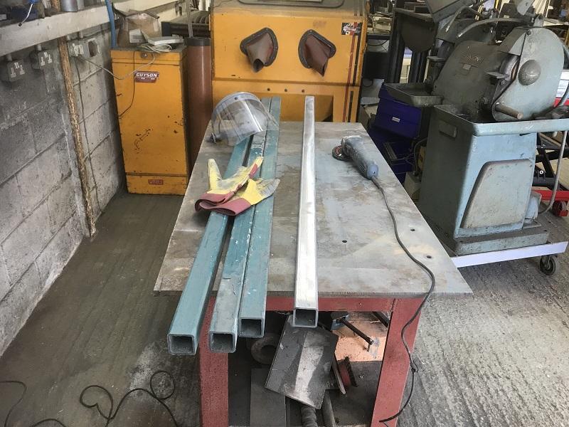

« Reply #215 on: May 01, 2020, 06:09:12 AM »
I was determined to get the four six foot long upright box sections stripped of their paint today, so grabbing a cold (cooked!) sausage in lieu of breakfast I got out early before other things distracted me.
Four stripper disks later and about an hour and a half of angle grinder time not only was EVERYTHING covered in paint dust but the uprights are at last stripped.
. . . let the welding commence  :clap:

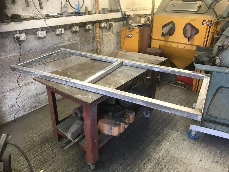

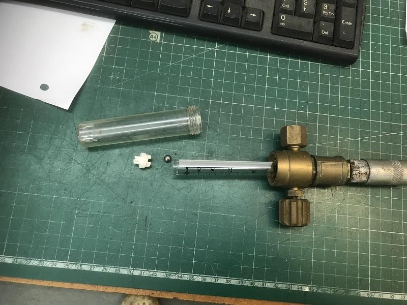

I had set up for the first weld and then was conscious of a hissing sound  :bang: A bit of hunting about and I found that the plastic upright tube of my 'Peashooter' Argon flow gauge was leaking where it screws into it's base / tap / outlet thingy.  At £160 per bottle leaks cannot be tolerated !
Fortunately I was able to unscrew it by the expedient of wrapping a bit of 200 grit wet and dry round it and gripping in the lathe chuck, expecting it to crack at any moment. It unscrewed  suddenly with a flurry of ball bearing / inner tube and odd shaped plastic spacer falling in the swarf !
OK it just needs screwing together with something to seal the threads. Being plastic I'd usually use PTFE tape but getting the ball, inner tube and spacer in necessitated partially threading it on first so non too easy with tape. I resorted to Loctite 542 that says on the bottle 'do not use on plastic fittings' - well I did !
It needs a bit of time to cure, so I stopped for an early lunch. After about 45 minutes it seemed at least partially cured so I re-assembled it on the regulator and resumed welding.
All went reasonably well. I've finished the first 'frame' which could be front or back, left or right as it's symmetrical.  Not surprisingly there is a bit of a twist in it, only about 8 mm but I should be able to pull it back when it's got the rest of the bits welded to it.
