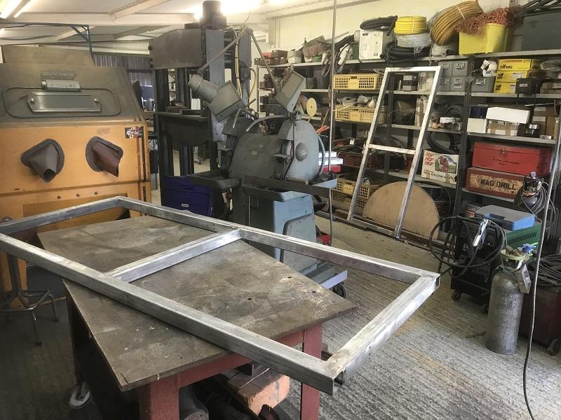

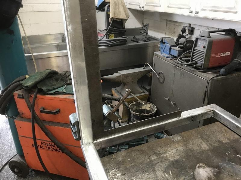

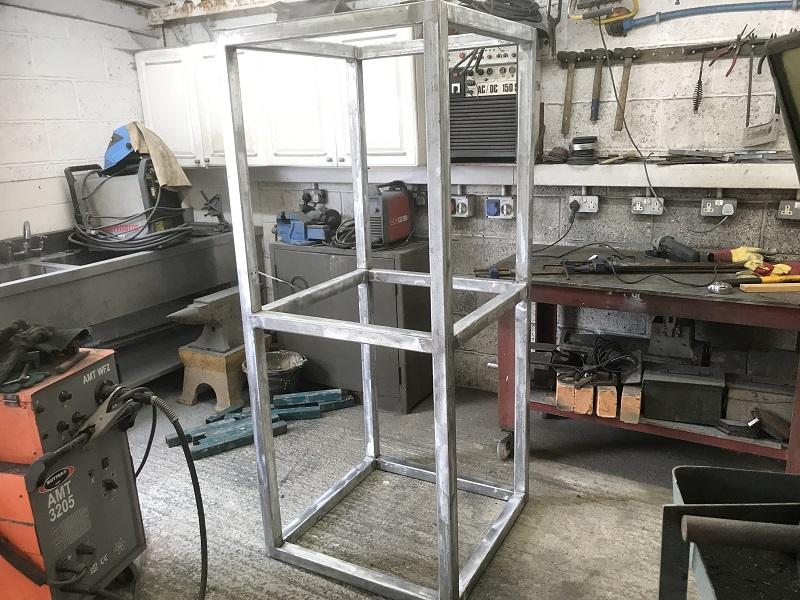

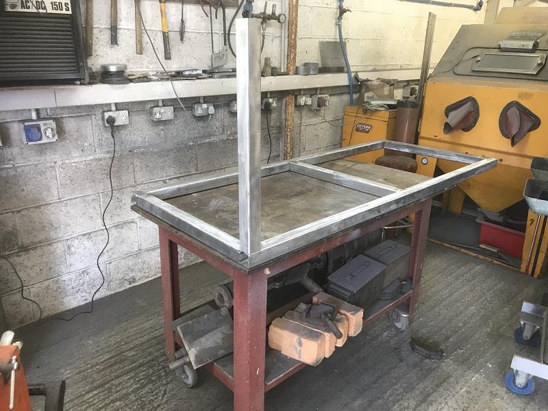

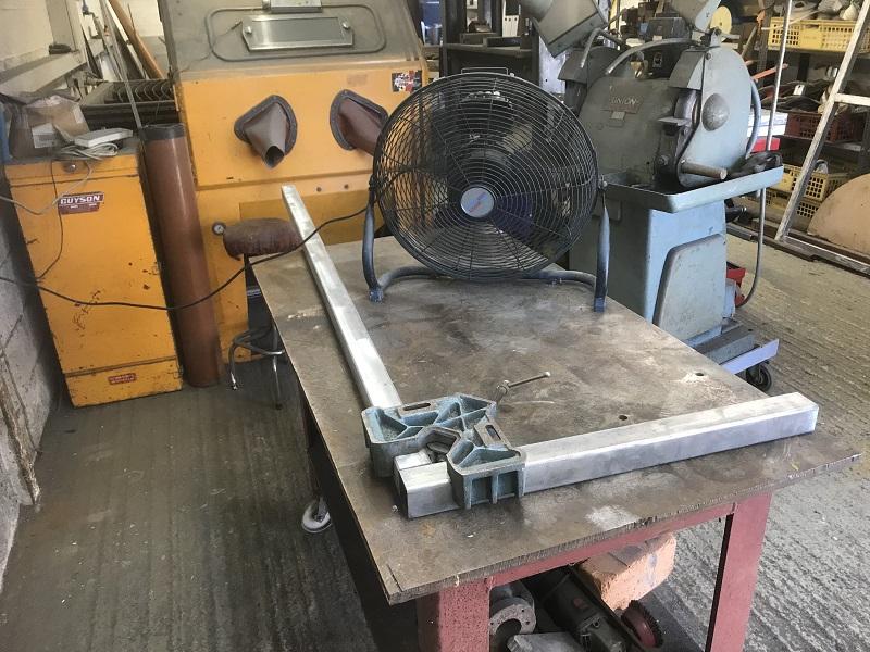

So this morning it was just a case of 'rinse and repeat' - make another frame like the first - simples !
. . . well yes simple if you clamp the first corner the right way round - I had the two bits in the wrong orientation - the short bit should be a stretcher between the long bits, not the other way round. Of course I only noticed when I'd welded it  :bang: Never mind, the work of a couple of minutes to cut the weld, grind back and glue it back together the right way  :clap:
After that all went well - I had a bit of an issue getting the last corner to join, and had to resort to extreme measures welding dogs to the table and using wedges, but I got there in the end.
OK so that is two frames made, and this one is remarkably square. The next thing to do is to weld another set of six stretchers to make this last frame into a table like structure - I just need to work out how I'm going to jig and clamp them to get everything mutually at right angles.
It may just be a case of holding it, tacking it, bending it square and finish welding  :scratch:

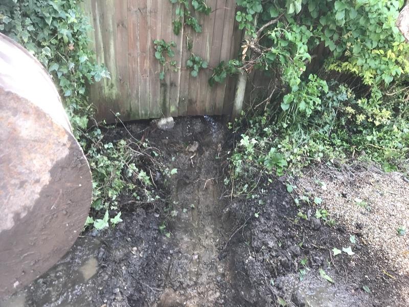

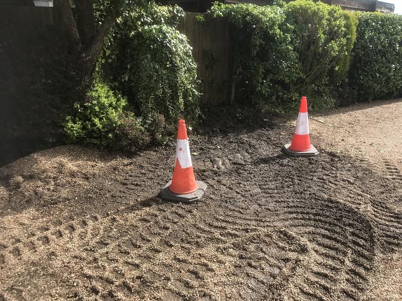

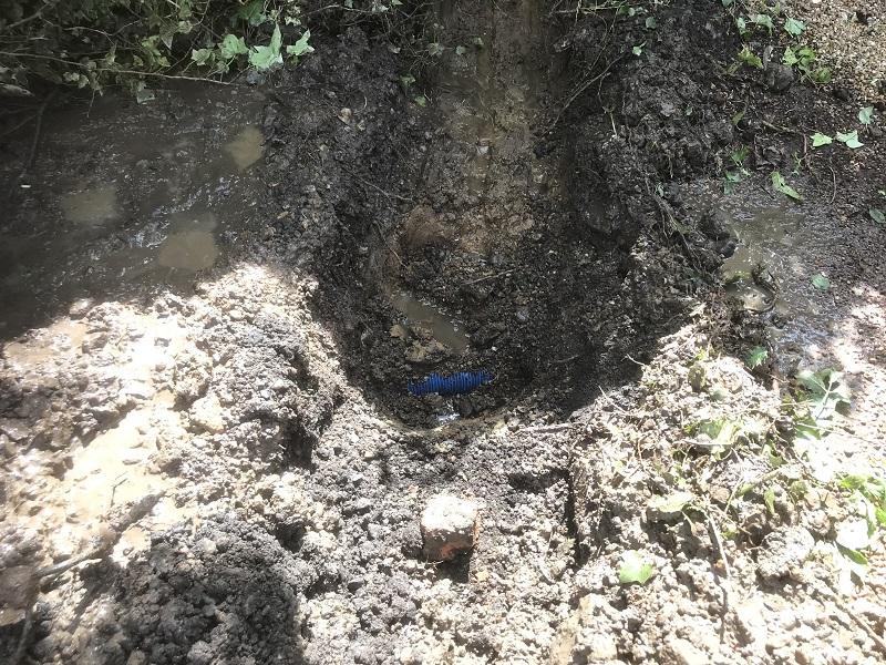

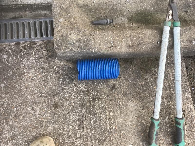

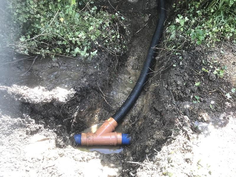

So the forecast for this afternoon was fine for once so I decided to do the 'outside work' of intercepting the land drain and connecting the over flow from the bore hole to it.
Very tentative scratching away with the JCB 803  eventually exposed it without ripping it apart - amazing how quickly the tooth of an excavator bucket can do a lot of damage to services  :bugeye:
Then spade work exposing enough to inset a 45 degree branch for the overflow, surround in pea shingle and back fill - fairly simple but awfully sticky wet and muddy!
Once that was done, it was back to the bore hole to cut a slot in the two top courses of bricks to receive the new pipe. I was very surprised how hard and resilient the bricks and mortar were - took far longer than I'd expected.
Then I pumped the well down a long way to give the mortar that I was fixing the pipe in with a chance to go off without being swamped. No doubt I'll have to run the pump a few times before the mortar is reasonably hard.
The outer farm yard is now a bit of a mess and churned up - it all needs to dry a bit for the scars to clear!
. . .but I do now have a nine inch length of blue land drain  :clap:

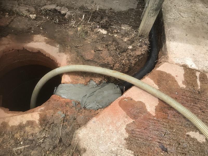

« Reply #228 on: May 03, 2020, 07:30:27 AM »
So I did go out at about 8 pm last night and re-started the pump - level was no where near the mortar but might as well give as much free board as possible for overnight.
I noticed that the suction hose was curling under water so not as long as it could be (at night with a torch you can see more down the 'hole' than in the day time) so I gave the hose a shake to straighten it and was just walking away when I saw that the pump, with it's vibrating engine, was walking towards the lip of the bore hole and quite likely to plunge to it's doom pulled by the weight of the 2" suction hose  :bugeye: So I pulled it back a bit (loosing suction hose length) and baby sat it for a bit.
This morning the mortar is rock hard - I deliberately made a hydraulic mortar  (IE excess Portland cement) so I'll let it fill back up to level.

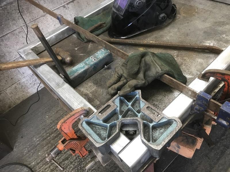

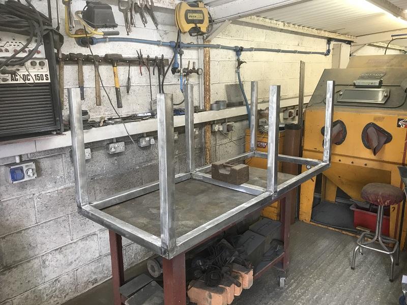

I was very pleased to find that the 90 degree welding clamp that I've been using will accommodate a 'three ways meeting'  of box section - only two ways are forced to 90 degrees so a large square was used for the third axis.

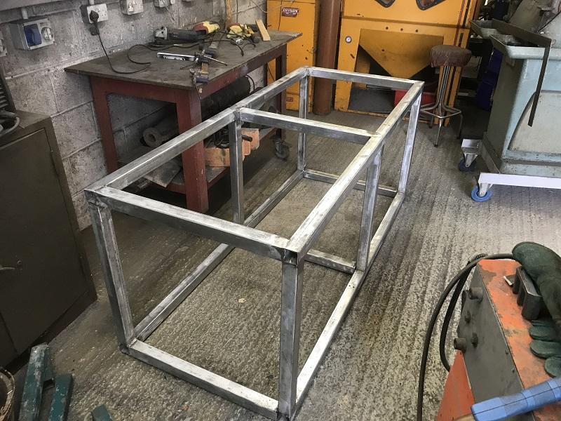

The six stretchers that will be horizontal when the chassis is stood upright, are now welded to one frame. I now need to lower that to the floor with the stretchers horizontal, and offer up the second frame for welding, but that probably will be tomorrow. It's getting blooming heavy !
« Reply #229 on: May 04, 2020, 10:54:25 AM »

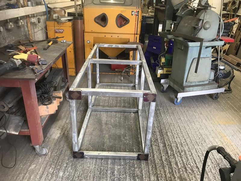

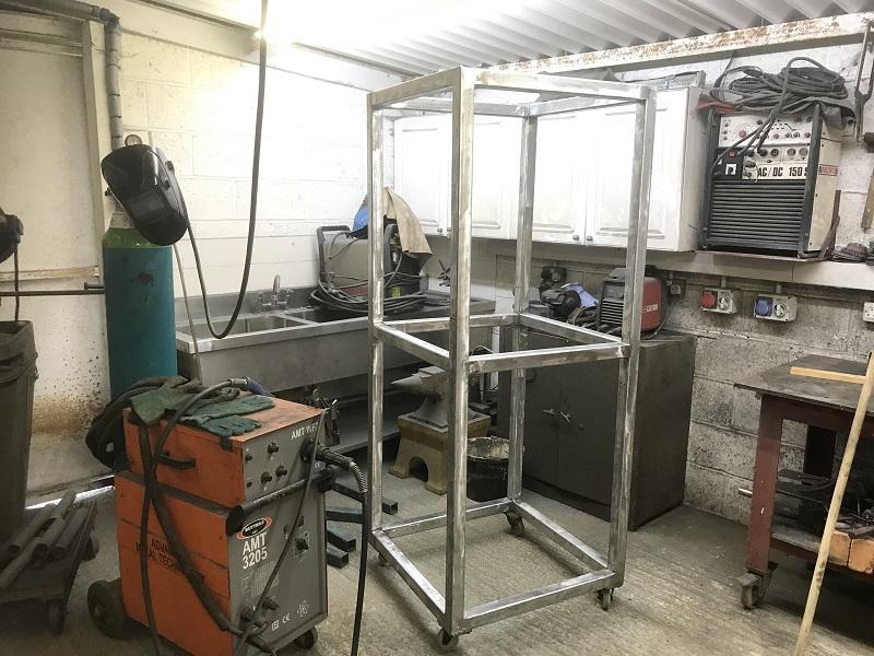

Today I assembled the 'table' part of the frame and the second frame, pulling them into alignment with various clamps including three sash cramps borrowed from the woodwork shop.
Having got the upper joints welded and the lower ones tacked I then rotated the frame to present the lower joins as 'in position' welds. This zinc tube is awful to weld at the best of times, especially 'vertical up' for some reason, and it pops and bangs all over the place.

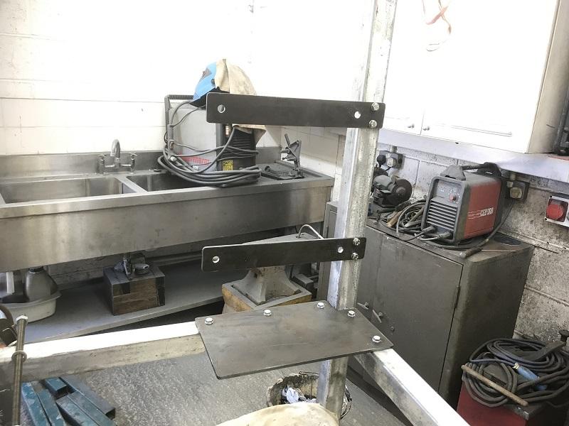

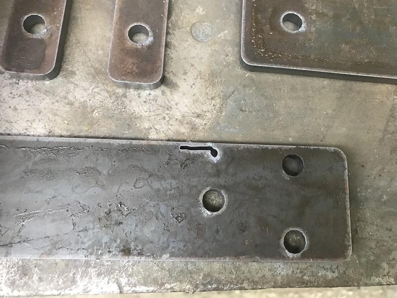

Once all welded I got my ever helpful CNC Plasma Table to cut me some plates to take the original castors off the previous chiller. These were welded on, drilled and tapped, and the castors bolted on.
A bit of grunting and it was set on it's castors ready to be fitted out with it's equipment. I'll do a 'dry fit' of everything, then break it down for spraying before final assembly.
Quite pleasing that as it is now is entirely made from re-cycled materials.
So next I need to make a base plate onto which the tank and Grundfos pump will mount, and sort out how I am going to mount the heat exchanger and other bits and bobs.

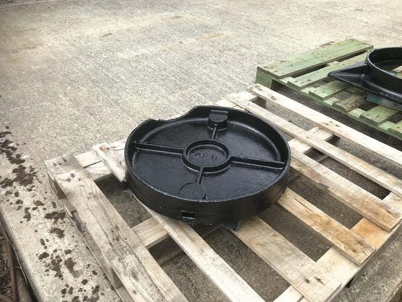

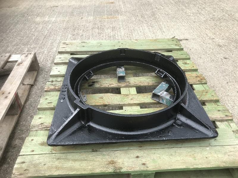

Meanwhile the Manhole Cover and Frame got a coat of black bitumastic paint to keep the rust at bay.

Tsk, tsk. Poor show Andrew, you didn't repair the damage to the cover  :lol:
« Reply #231 on: May 04, 2020, 04:52:19 PM »
A friend wanted me to drill it and put eye bolts in, until I pointed out that it had key slots and eye bolts would be a dreadful trip hazard!
And no, I didn't weld up the bite out of it - it's been bad enough welding that heavy galvanised box section with all the popping and spluttering and porosity that it gives without trying malleable iron !

How long does that bitumastic paint take to fully cure? Is there a risk it will just glue the cover into the frame?
-Russ
« Reply #233 on: May 05, 2020, 02:21:37 AM »
It was touch dry in less than an hour. It has a reputation of being hard to brush, so I left it in a bowl of hot water for an hour before I opened the tin. In fact it was no problem as quite fluid but I suppose it probably can be a bitch in cold weather.

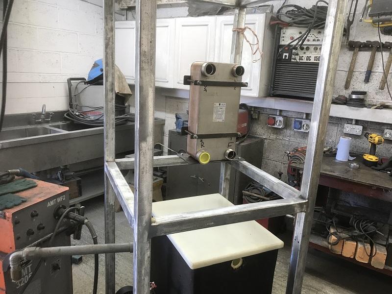

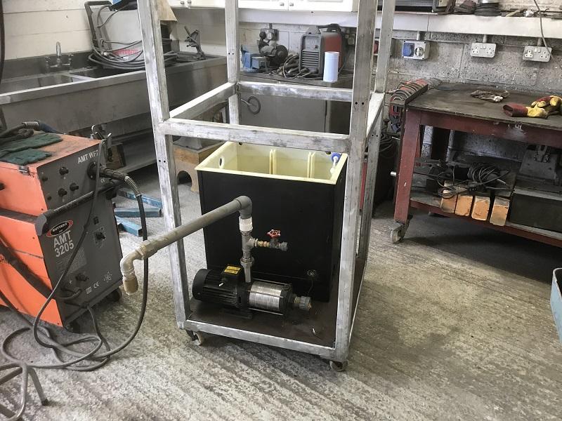

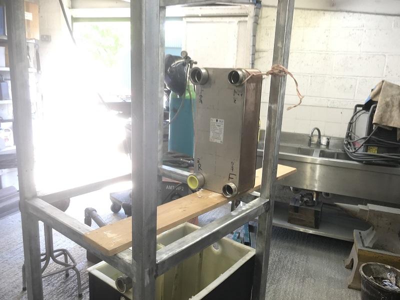

This morning I cut a 750 mm square 'bottom shelf'  (with notches to accommodate the verticals) out of 6 mm plate on the CNC Plasma table.
Why as heavy as 6 mm  :scratch: Two reasons -  A/ I had a handy bit and B/ 6 mm is thick enough to drill and tap and not have to bother with nuts in hard to locate places.
This allowed me to do a 'dry fit' of the tank and pump, and (although not in the picture below) also the huge heat exchanger balanced on a plank on the middle rails. This was to better let me work out pipe runs and place yet another big plumbing bits order  :bugeye:
The issue that I have now is that one side of the heat exchanger is male BSP, but the other is a 54 mm stainless steel socket intended for soldering in copper pipe. Now it is a massive heat load to solder, and I'm not sure what solder and flux you'd use with those metals - any suggestions welcome.
I rang the manufacturer of the heat exchanger for advice and I'm waiting for their technical people to get back to me but I expect that's not going to happen any time soon  :(
I also asked what the price was of that model - £500 plus - glad I got them on ebay not off the shelf  :clap:

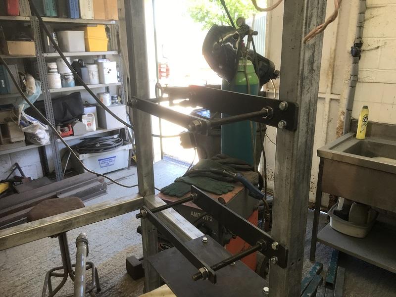

My temperature gauges arrived for monitoring the ins and outs of the heat exchanger - I need four so I ordered five to have a spare - I left three of them hooked up over night to see how consistent they are - not hugely is the answer but probably OK for this application.
Today I drew up and cut the mounting arrangement for the heat exchanger having first balanced it on a plank and tied it on with baler twine to prevent it leaping to it's doom. Again I cut the bits out of 6 mm plate as it was already on the machine - cocked up and failed to re-set zero on one part and overcut a previous one, but no great issue just cut another !
I intended to clamp the H E with 8 mm studs as I was sure that I had quite a few lengths of it. Where it's gone is a mystery so I had to use 12 mm which is definitely overkill - (this thing will never escape!) and it had the disadvantage that there was no longer room for nuts to retain the studs when not in tension, but never mind that's only ever an issue when installing and removing the unit, which hopefully will not be too often.
So all in place - plumbing bits due to arrive from BES this afternoon so I can hopefully complete the dry fit but meanwhile as all the components for the bore hole pump and control have now arrived I'll try and assemble that while waiting.

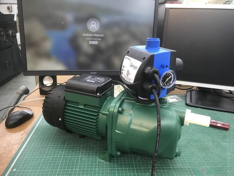

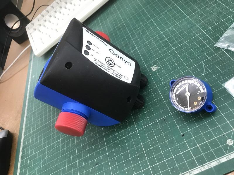

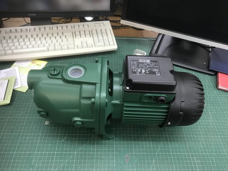

So this afternoon I unboxed the Bore Hole Pump and its controller and wired them together.

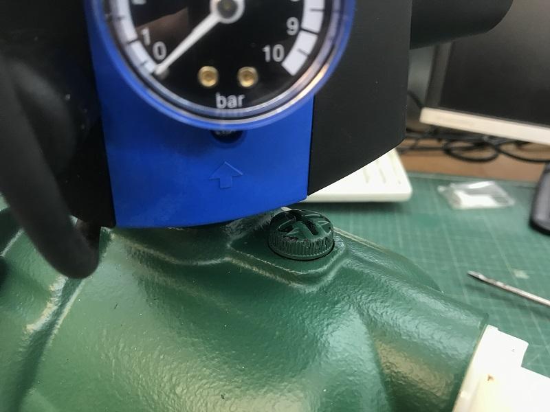

The pump is cast iron with 1" BSP female ports, but the controller, although male 1" BSP is the dreaded PLASTIC threads - horrible things and so easy to cross thread when you have a wrap of PTFE tape over them - give me metal threads any day!
They obviously intend that the suction side is on the left whereas mine of necessity is on the right - this means that I've had to orientate the controller at 45 degrees as two faces of the controller need to be visible from the front - the indicators and buttons on one, and the pressure gauge on the other.
As a consequence the priming plug (hey this is supposed to be SELF PRIMING!) is even more difficult to access than were the controller set in its intended position.
I may extend the controller upwards with a bit of stainless pipe, and may even dress the suction hose round to the right so it all sits as the makers envisioned as an extra metre of pipe probably is of no consequence.
Having assembled it - time to do a test - so once primed with the fussy plug it went splendidly - I fitted a stop cock to the output to test the auto on / off function and also make measuring its delivery rate easier. A 3 gallon bucket filled in 16.09 seconds so I make that 51 litres / minute which is above my estimated 45 litres / minutes for adequate cooling. Mind you that was though a relatively short length of pipe.
Now to give serious consideration to building something to house it next to the bore hole.

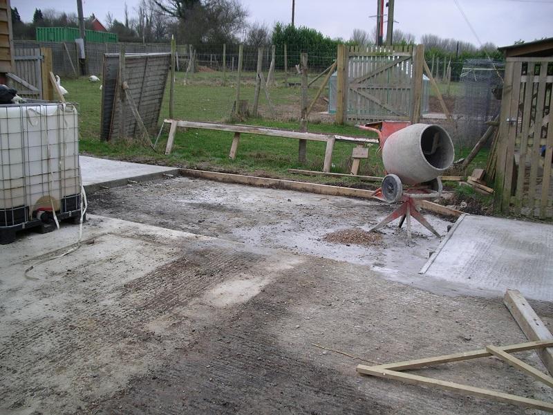

Been measuring up for a slab to build a kiosk for the pump. Size determined by a 900 x 600 mm flag stone that will form the roof. Need to hunt around for some  timber for form work.
A friend is coming tomorrow after work to use his diamond saw to cut across a concrete path to feed power to the kiosk, and a 25 mm pipe to connect to the horticultural taps. Path is about 9 foot wide and laid in panels, each panel joined to the next with cast in situ rebar. Plan is to cut across at a join leaving the rebar intact, breaking the concrete away underneath and threading the pipes & cable under the re-bar before making good. This way hopefully the slabs will move together.
This is the slab before laying in March 2009 - you can see the re-bar and the bore hole manhole cover is just visible behind the concrete mixer!
