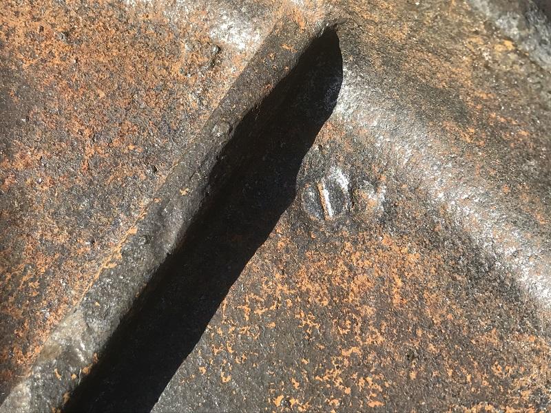

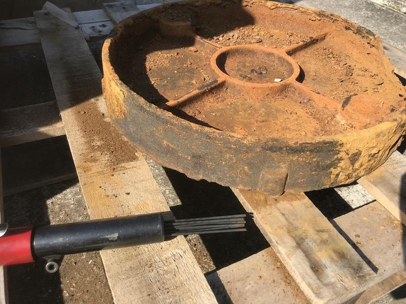

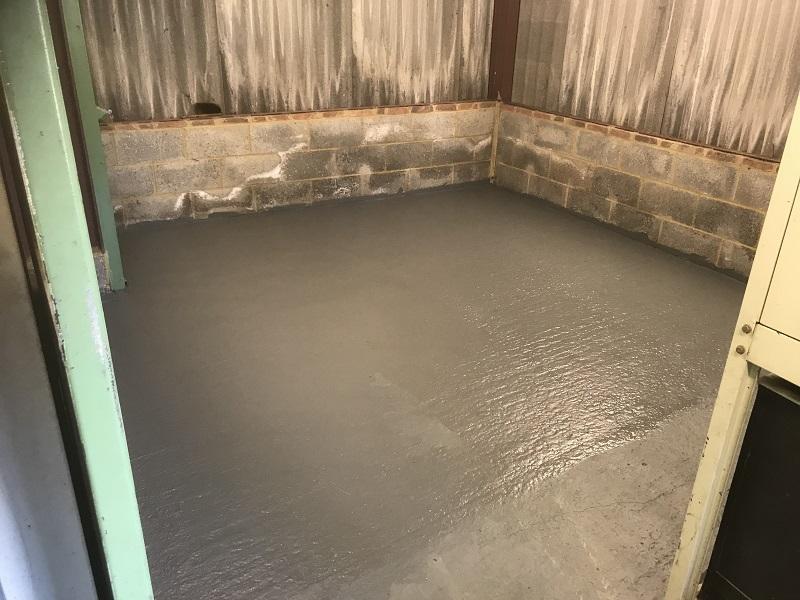

This morning the last half of the foundry floor was due for its last coat of paint so that went down first thing. I had to start a second tin, and the colour was distinctly more 'elephant' than 'blue grey' but I don't suppose that it matters much  :clap:

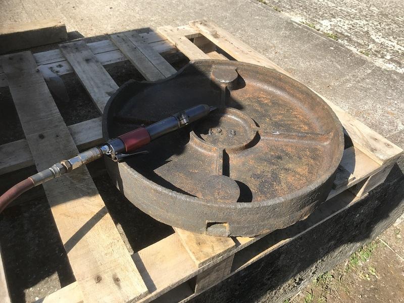

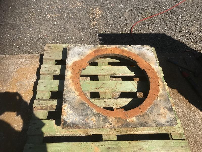

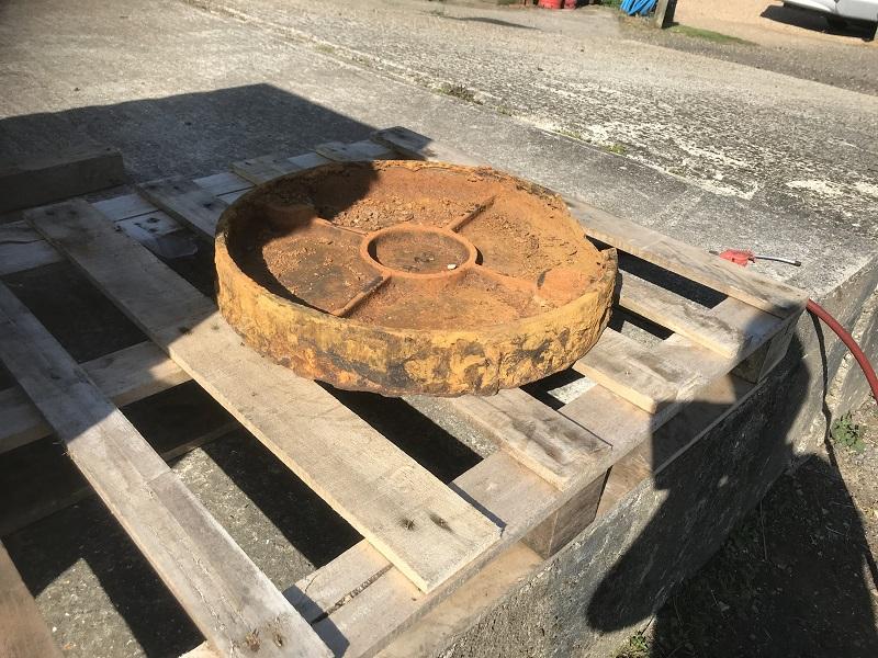

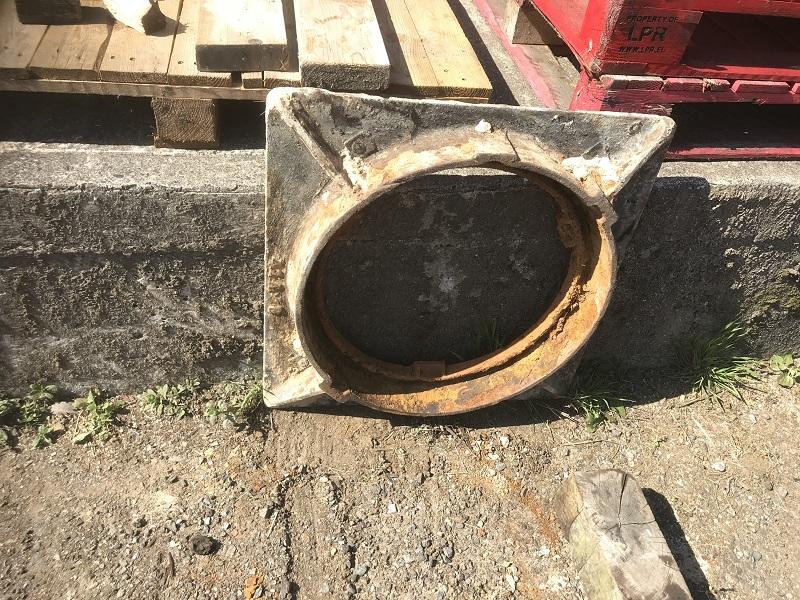

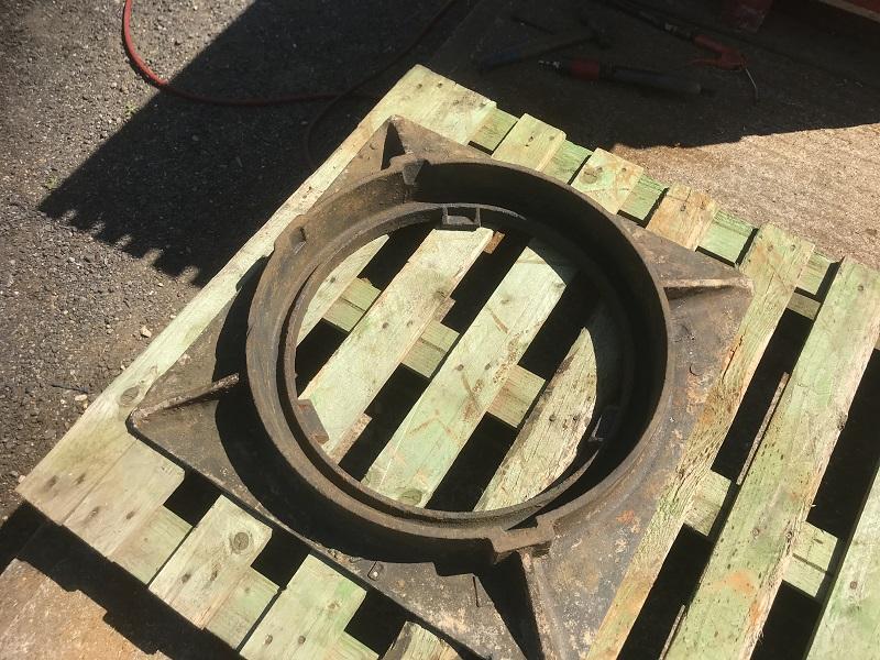

While the paint was drying I put Phil's excellent suggestion to start with a needle scaler on the manhole castings into effect. It hadn't occurred to me for some reason, and I have to say for this application it was much less hassle than setting up the big Hodge Clemco, and made less mess. I got this needle scaler probably 30 years ago when I stripped all the paint and bondo off my Bridgeport before repainting, and I must say it's excellent. For this job I used the coarse needles - the Bridgeport got the fine ones !
It took perhaps 90 minutes to do the cover so not too bad at all. I still have to do the frame, but I came in to have a bit of a rest and upload this.
As is often the case, the casting revealed a bit of the construction of the original pattern, screw heads showing in the metal. No doubt the pattern would have had those heads puttied and painted, but in use the putty plug has fallen out.

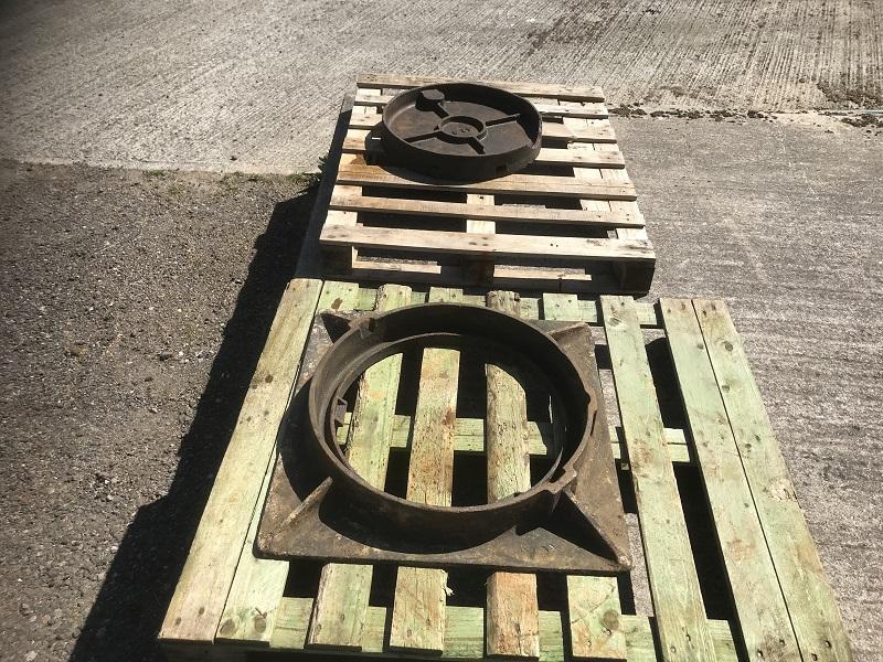

So after a spot of lunch I resumed work with the needle gun and finished off both sides of the frame casting. Underside is just a flat surface so was very quickly done, but the upper side is rather fiddly - it's not come out perfectly as it's proving impossible to accurately direct the needle at vertical walls in channels, but it's perfectly serviceable. To be frank were I to paint it it probably needs a quick tickle with the sand blaster but it's not at the top of my priority list at the moment.

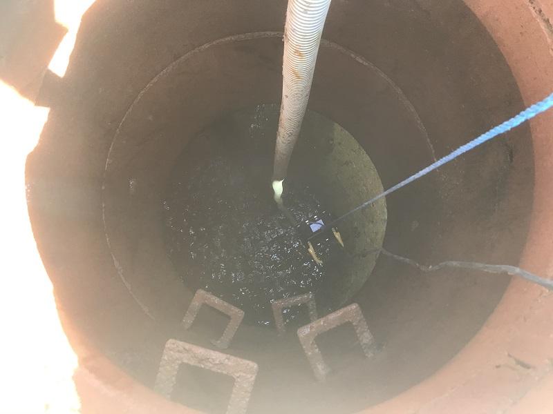

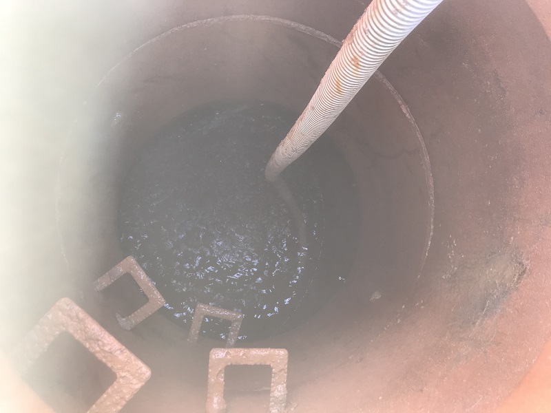

Having fixed the Honda WD20X petrol driven water pump it was time to do another trial pumping of the bore hole. My intention was to pump as low as possible and try and get an idea of the structure, and rate of water return.
My suction hose, complete with it's strainer and one way foot valve is marginally over 5 metres, so I was limited by that length - (of course the absolute maximum would have been 32 foot or 9.7 metres, that being the Torricellian vacuum limit for supporting a column of water)
It only took 48 minutes, shifting a calculated 27,600 litres (or 27.6 tons if you prefer) at a great gushing rate into our stream, before the pump was gulping on air having reached the end of the pipe. An impressive performance for a pretty tiny and rather old pump, and certainly an impressive gusher into the stream.
I made several attempts to take decent pictures of the inside of the bore hole, but all are pretty hard to make out - I even lowered a 240 volt LED flood light on a rope in a rather gingerly fashion, but still not too good.
The construction seems to be  24" concrete sections with integral steel steps for the first couple of metres, then it widens out to a significantly wider bore, but not concentric with the first bit, which is offset so the two circle meet tangentially.
There certainly seems to be enough for my modest 45 litres / minute for a few hours every now and again  :lol:

It does have a slight tinge to it, and of course the walls of the borehole are rather brown with (??) muddy deposits, so I'd like to filter it - I'm sure it would be fine for watering gardens and live stock, but . . .my heat exchanger . . .  not sure !

Out of interest, how long did it take for the water level to recover from the 5 metres you pumped out of it?
« Reply #189 on: April 23, 2020, 02:58:31 PM »
It's still not back there Ade - when I last looked a couple of hours ago it was back to about the lower edge of the smaller concrete sections - actually it's quite hard to judge exactly where the level is.
Last time it was up to six inches from ground level after a couple of days which make me think that there must be a bit of artesian well acclivity going on as the ground slopes away quite a bit from the top of the bore / well / whatever it is across the site and down to the stream.

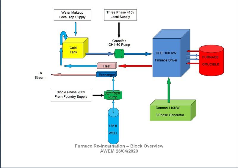

So I have a JET 102M self priming pump, control box, and 100 metres of 32 mm MDPE pipe on order along with numerous fittings - so while waiting for them I've started dismantling the defunct refrigerated chiller to rescue various things such as it's reserve tank and Grundfos pump. The case I will probably scrap, or possibly cut down into a smaller unit to re-house the tank, Grundfos pump and new heat exchanger. The jury is out on that decision at the moment.
However to sort my ideas out and make sure I've not forgotten anything I have re-worked the 'overview' diagram, as it gets a bit complicated what is fed from where - don't want anything overlooked while trenches are open !

  • Posts: 288
« Reply #198 on: April 26, 2020, 08:42:25 AM »
It seems like it shouldn't be an issue, but could you return the well water to the well? The sheer mass of the well ought to be able to keep the temperature rise under control, and there is no chance of pumping exceeding the supply rate.
-Russ
« Reply #199 on: April 26, 2020, 10:57:58 AM »
Russ I had considered that but decided against on simplicity grounds - pipe length is about the same as I'll be using a roof gully that's about 20 metres away - I had considered running the waste water down the gutter of the welding shop roof to save 20 metres of pipe but that just seems crude !

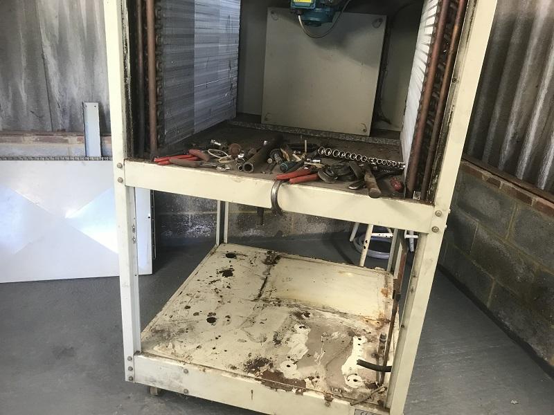

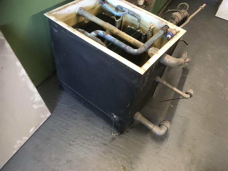

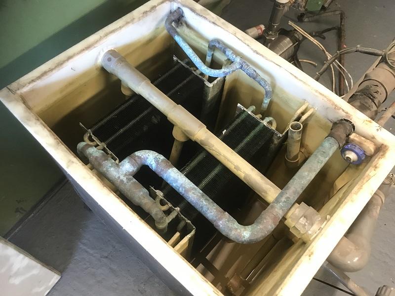

So the task this afternoon has been to dismantle the old water chiller unit - no major complications except that it must have been assembled on a stand in the factory, as everything is fixed with nuts and bolts to the base and there is barely enough room to get a hand under. In the end I jacked up one side to gain access only to find that the tank wasn't quite empty and I was pouring loads of grubby water on the floor  :bang:
Having spent an hour with an old towel mopping up round all the obstructions what is left can (I think) be left to evaporate - well over a gallon mopped up!

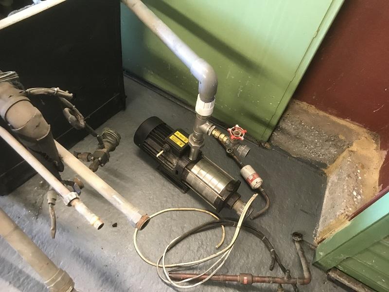

So I now have the Grundfos CH4-60 pump out and this will definitely be reused. I have the insulated nylon cold tank removed, that is crammed with refrigerator gubbins all of which should remove quite easily - this I probably will reuse.
The main casing is huge - I need 'something' to house the Grundfos pump, tank, and the heat exchanger along with a three phase contactor and a few water valves, filters and connections - cutting it down may be more trouble than it is worth, but I may well reuse for instance its corner upright members to create a somewhat more compact unit.
The upper part of the cabinet still holds the original temperature controller and its contactors, and also two huge slabs of cooling radiators and a big three phase extractor fan - these all will need removing tomorrow.
