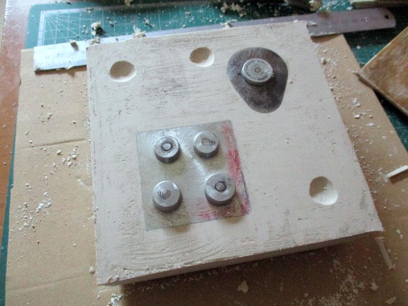

My current problem is the castings for the bearings, the commercially available ones are bronze. What type of bronze? Can I cast them myself? It would be nice to make accurate castings. I have made the patterns in aluminium and have made the moulds in plaster of paris.
Bronze, there is bronze that is an alloy of copper and tin or an alloy of copper and aluminium. Lead free solder (99c) is almost pure tin, I could use that. There are so many variables. Whatever I use will not be perfect but will probably be good enough for what I want to do. Will my mild steel crucible be enough for the job? Time will tell.

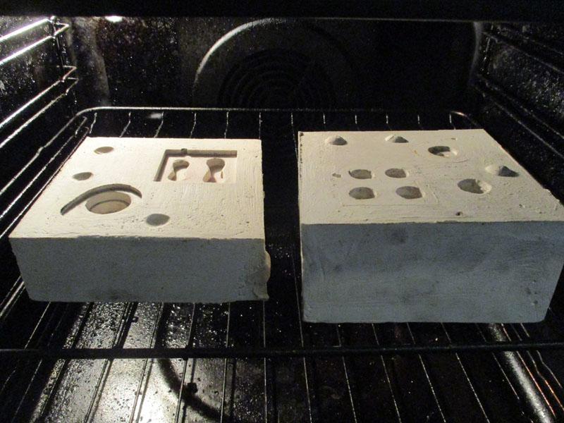

Here are my moulds for the bearings.
The second picture is the moulds in the oven to dry them out.
I don't have a wife to answer to!

The location bumps were cut freehand with a ballend mill.

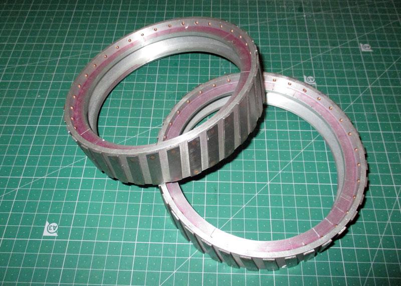

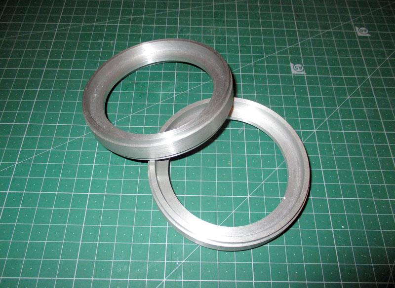

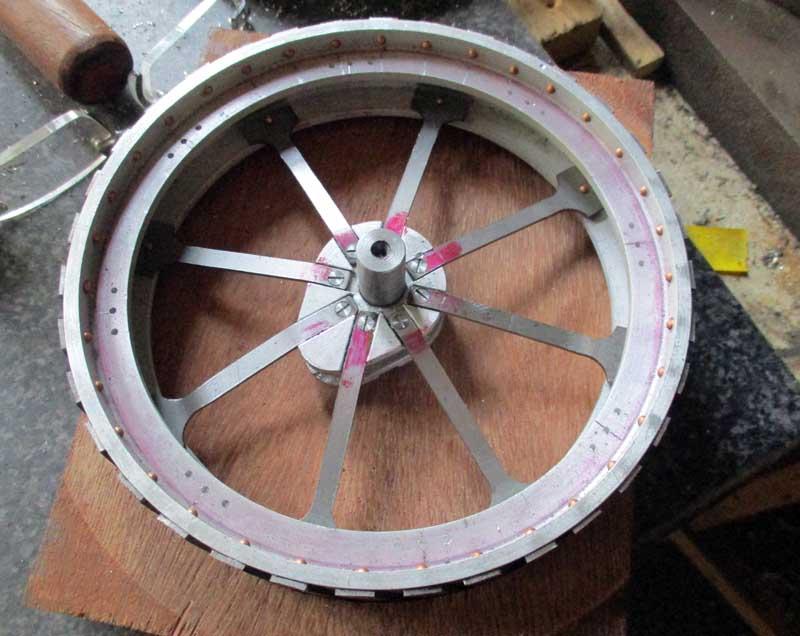

Some more parts, the wheel rims. I can't understand why the castings for the rear rims are so expensive (£70)! They cost me next to nothing to cast them myself.
The strakes on the hind wheels were a bit tedious to make but riveting them was fun.

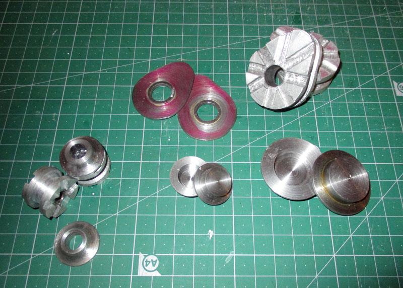

Also the wheel hubs and associated bits. The slots for the spokes are a bit rough, I made my own milling cutter, it didn't keep its edge, but it won't matter as the hub covers will hide it all.

I gave up on the idea of making bronze castings for the bearings as I could not source any copper. Instead I thought that I would cast them in aluminium and sleeve them in a more hard wearing metal. The castings in my expensive plaster moulds were a failure. I believe that as the plaster was cold it caused the metal to shrink away from them. My precise sharp cornered patterns were translated into rounded cornered castings!
What a waste of money, £12 for the plaster.

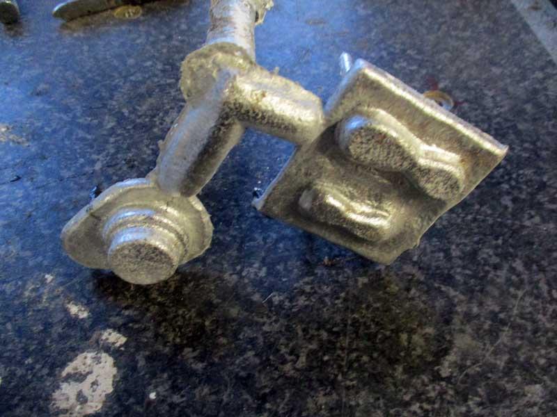

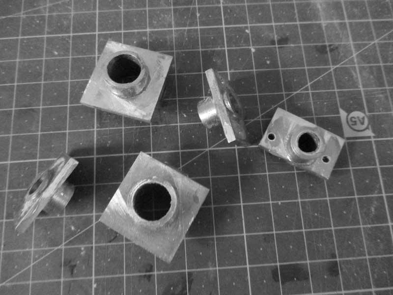

So instead, I fabricated to bearings in steel. I do not have any silver solder so I araldited the parts together. They look ok, remember, this is intended to be a display model rather than a fully functioning one.

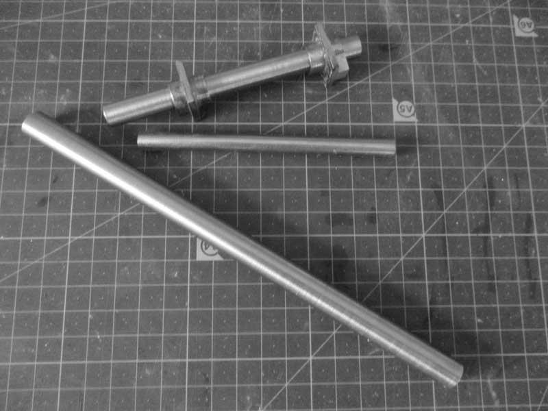

The plan calls for ground steel for the shafts, I decided to turn them from oversize metals. The longest shaft is 12mm dia x 200mm long. I turned it between centres and initially it turned out oversize at the tailstock end but a bash with a hammer on the tailstock ended up with it being parallel over the whole length. I am quite pleased with that. After that the other shafts, only 100mm long, were a doddle.

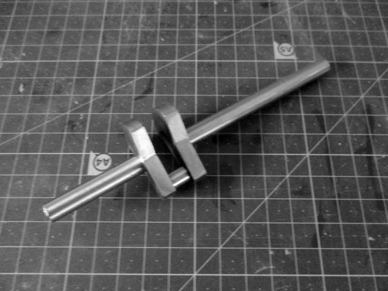

The crankshaft was my next attempt. I made it in three pieces and loctited it together. I will pin it when I have the material for the pins.

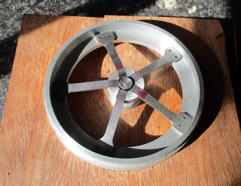

« Reply #17 on: September 20, 2017, 01:05:26 PM »

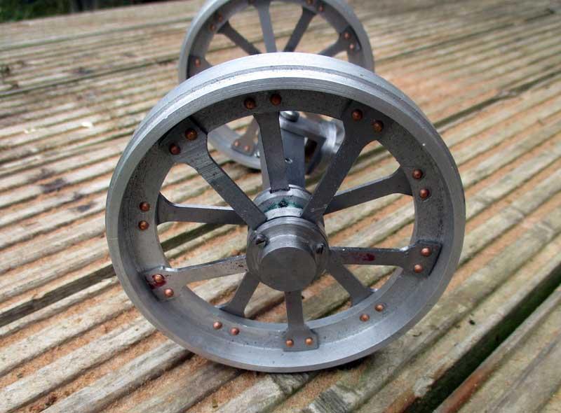

Making the spokes was tedious. I tried a couple of different approaches but it just needed patience and I got there in the end.
I started on the front wheels as they seemed easier.

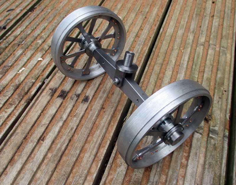

And here are both front wheels completed and mounted on the axle.

Today I started on the rear wheels.
Wheel building is fun, and progress is quite rapid.
