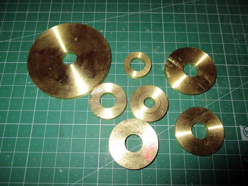

I have made the blanks for all of the gears except the largest, I don't have any material for that. I have made them in brass as that is what I have.

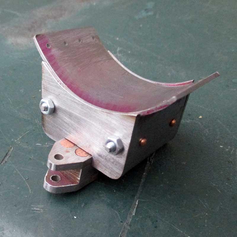

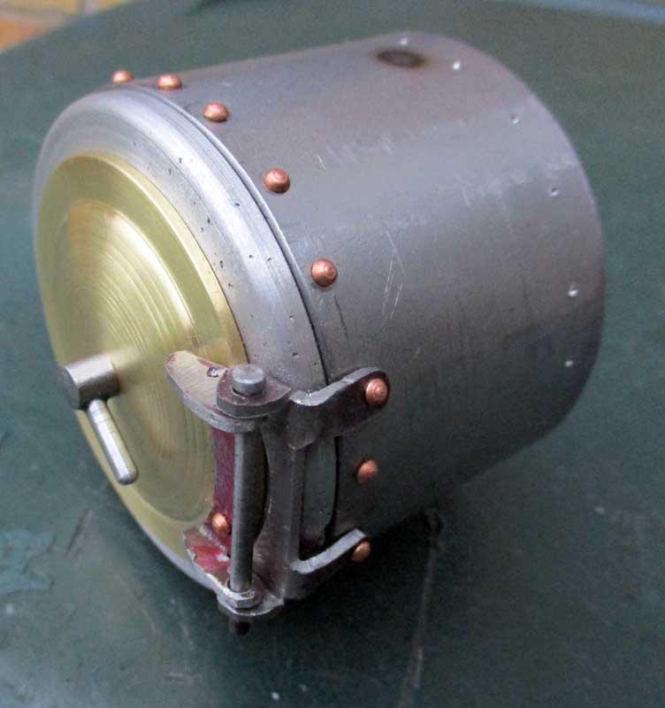

I have also completed the smokebox and the perch bracket.
I bent the tube for the smokebox from 1.5mm sheet and welded the joint. That was a test for my welding, I initially burnt a hole in it but with a bit of practice I was able to weld a patch in it. It doesn't look too bad and anyway the perch bracket will cover it.

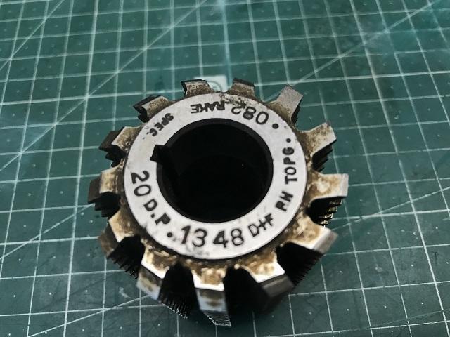

What I need is 20DP to cut 15,20,25,30,50 & 80 tooth gears. I think that single point cutters would be best with my milling machine.

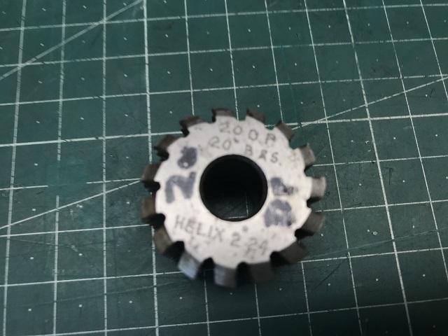

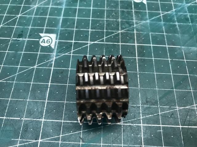

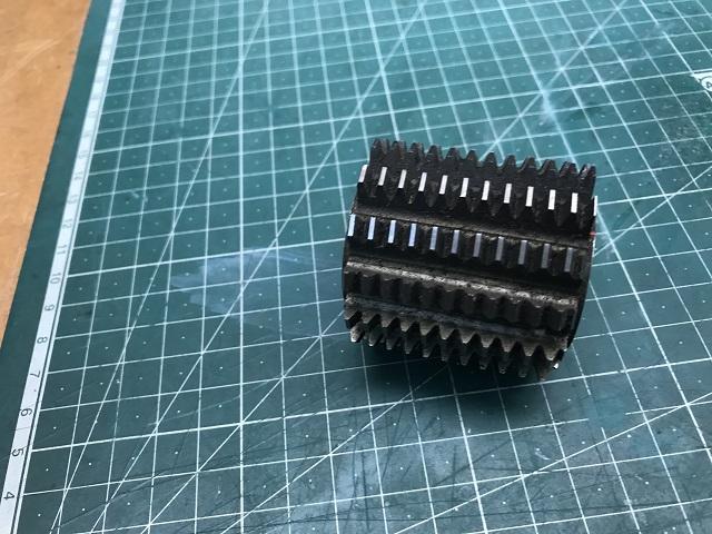

Norman, I have all sorts of B&S cutter sets but not 20 DP  :bang:
HOWEVER I do have  20 DP hob as per pictures. 3/4 bore weighs 400 grams
  • Posts: 9051
Re: Minnie on the cheap!
« Reply #36 on: October 04, 2017, 03:12:19 PM »
OK a bit more trawling through the hob drawers !
Turns out that I have two of the above hobs AND:
A nice little 10 mm bore one that I used to use with my Mikron gear hobber (which is for sale at £1000 if anyone wants it - needs a clean up as been in storage for 10 years)
This little one weighs in a 75 grams  :thumbup:

The hob rotates in synchronism with the blank at a ratio suitable to cut the right number of teeth. The hob is then transversed across the blank at a fixed cutting depth. Depending on materials it may take several passes at increasing depths before the full tooth form emerges
« Reply #43 on: October 04, 2017, 06:10:12 PM »
The hob is also at an angle to match the hobs pitch , you also can't start at the edge of the gear if trying to cut a gear being driven by the hob , I have tried this and bent the mandrill for my hob and totaled the gear .

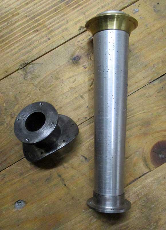

I was busy over the weekend, I made the chimney. I cast a piece of aluminium using the lost foam method, what a lot of nasty fumes that produces! It was a terrible casting, barely big enough and full of bubbles. What the heck, it's going to be painted so I can use filler to hide the defects.
The chimney cap was fun, I made it from two pieces of 1/4" brass silver soldered together. I've finally worked out how to use my gas torch, outside of the furnace, without it blowing out. It was an interesting diversion from machining to work out the angles to rough out the two curves, my trigonometry tables from my school days came in handy for that.
Offline NormanV
  • Posts: 633
  • United Kingdom
« Reply #49 on: October 10, 2017, 03:41:19 PM »

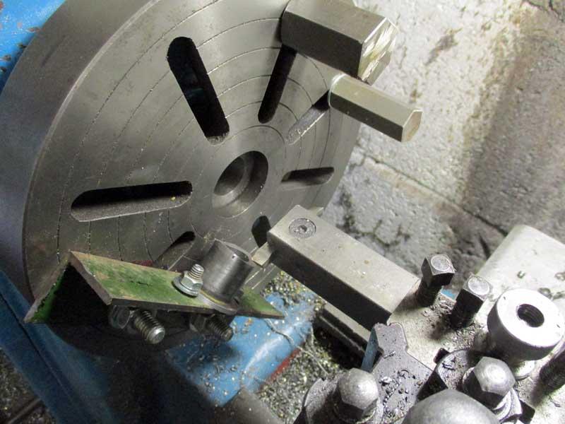

I fabricated the chimney base rather than buying or making a casting, I was able to do it more quickly than it would have taken to make the pattern. I had to cut a large radius in the base of it and was rather pleased with my setup. I mounted it on a piece of angle on the faceplate, which needed counter balance weights to prevent vibration. I used my 1" square boring bar to hold the cutter, there were no problems with chatter.
