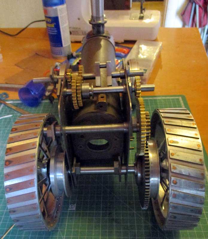

« Reply #51 on: October 18, 2017, 11:41:20 AM »

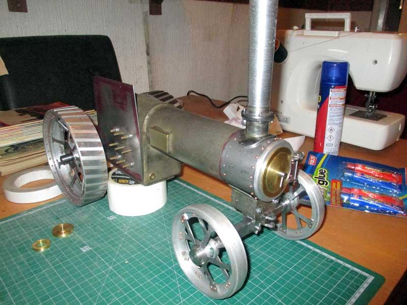

Here is progress so far, it is not fully assembled just propped up in the right places.

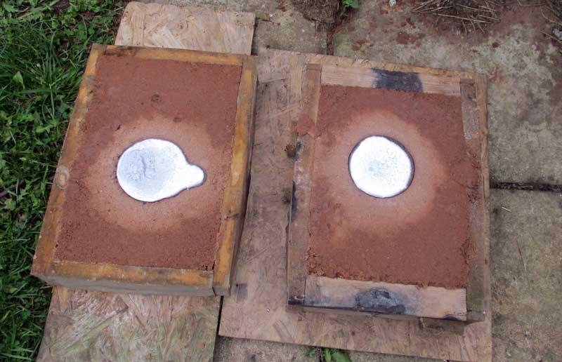

« Reply #52 on: October 18, 2017, 11:46:57 AM »

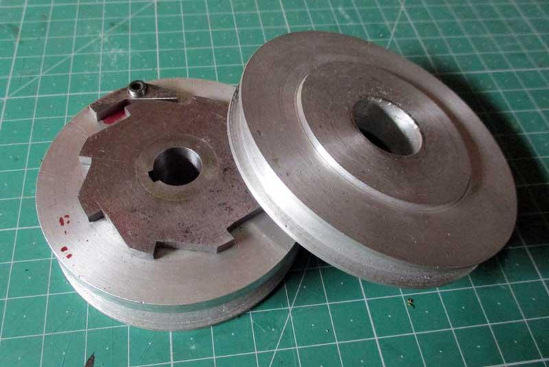

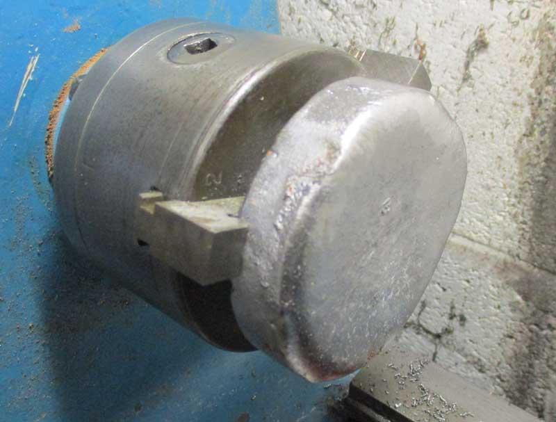

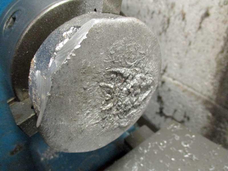

Today I made a start on the brake and winding drums. The plans call for cast iron, I decided to cast aluminium blanks to make them.
I cast them in open top moulds. My sand is rather damp and when I poured the metal one of them boiled like a witches cauldron. Obviously that was a very damp bit of sand. You can see the difference in the appearance in the two photos. When I roughed them out I was expecting huge voids, but no, it's fine for the job.

I've machined the cable drum and the brake drum. I made the ratchet and pawl by careful marking out and filing, it wasn't worth setting up the milling machine and I get pleasure from making stuff by hand.

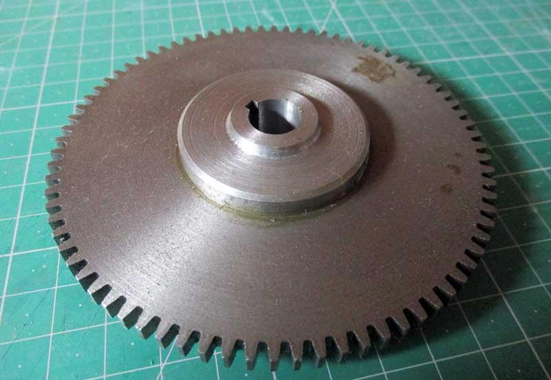

« Reply #55 on: October 22, 2017, 10:08:02 AM »
I've also done the final drive gear with its centre. I was lucky to find a lathe change wheel of the correct DP and it was a simple job to machine it down to the correct thickness and bore it to size.
The keyways were a bit of a faff. I did them by putting a parting tool sideways in the lathe toolpost and racking it backwards and forwards taking a light cut each time. I tried it first on a piece of scrap, it was a hell of a struggle taking a lot of effort to pass the tool through the hole plus it kept digging in. I gave up and tried to make a broach, I tried to do it rough and ready and it was unsuccessful so I went back to the parting tool. After I had adjusted the gib strips it was better so I attacked the first keyway. It was still hard work but I got there. The second keyway was a doddle, I reduced the feed to one thou. for each cut and it sailed through, no dig ins. Well next time I have to cut a keyway I'll know how to do it!

  • Posts: 9051
Re: Minnie on the cheap!
« Reply #56 on: October 22, 2017, 10:47:00 AM »
When broaching keyways in the lathe I first turn up a peg that fits in the centre hole flush both sides. I then drill a hole that is slightly smaller diameter than the intended keyway at the intersection of the peg and the gear leaving a D shape in both.
Then removing the peg I broach away. This way there is much less material to remove and the hole tends to guide slender tools.

« Reply #57 on: October 22, 2017, 10:50:41 AM »
That's a good idea, I will file it away in my memory for the next time, thanks.

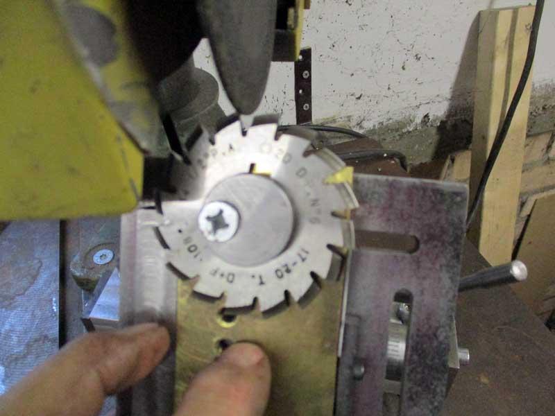

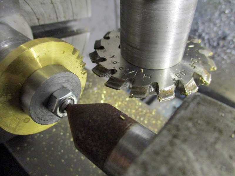

« Reply #59 on: October 24, 2017, 12:08:18 PM »
Tom, I don't smoke but that is no reason to not keep a stock of cigarette papers. I need to get some.
When I used to smoke(50 years ago) they cost 2d. I think that they may be more expensive now!

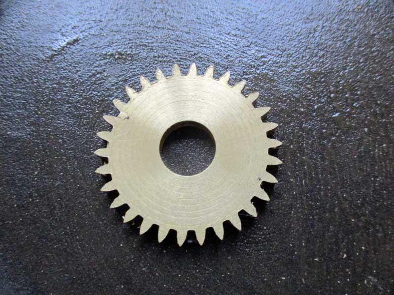

I managed to buy some involute gear cutters at a good price, They needed sharpening. This was my first opportunity to use my Harold Hall grinding jig. It was a fiddle to set it up but it did the job.
Offline NormanV
  • Posts: 633
  • United Kingdom

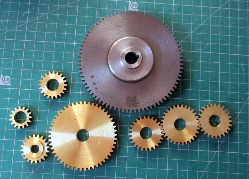

« Reply #60 on: October 24, 2017, 12:12:12 PM »
Then it was onto my homemade milling machine with my homemade rotary table to try to cut my first gear! It bloody worked!!!!
I did not get the cutter exactly at centre height but it was certainly good enough for me.
The next ones will be better.

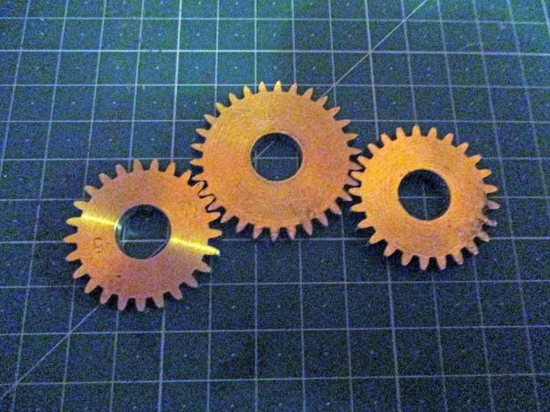

« Reply #61 on: October 24, 2017, 01:30:51 PM »
I've just cut the second gear, irt is also good. I could get addicted to this!
« Reply #62 on: October 24, 2017, 01:58:53 PM »

« Reply #64 on: October 25, 2017, 09:47:50 AM »
Here we are! A complete set of Minnie gears. It needed a lot of attention so as not to make any mistakes. I managed to be one hole out on one of the teeth as the blades on the rotary table slipped, but when it goes through the worm wheel the error is somewhat reduced.

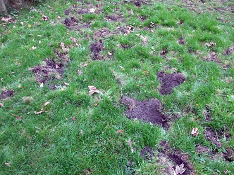

This afternoon as a break from spoiling metal I decided to cut the grass for relaxation. What a bloody fiasco! I have a problem with badgers, don't get me wrong I love to see them in the garden, but in places it looks as though someone has attacked my lawn with a rotovator! I am not too worried about the appearance but there is great danger of me twisting my ankle in the holes that they make.
I can't shoot them, they are protected, does anyone know of a good badger repellent? I am prepared to forgo the pleasure of seeing them.

Lion Poo from the local Zoo...that'll shift um..   Chester Zoo sell it for £5 a small bag, mind you will also loose most other animal visitors to the garden.
Do not use it if you have a house/pet cat...

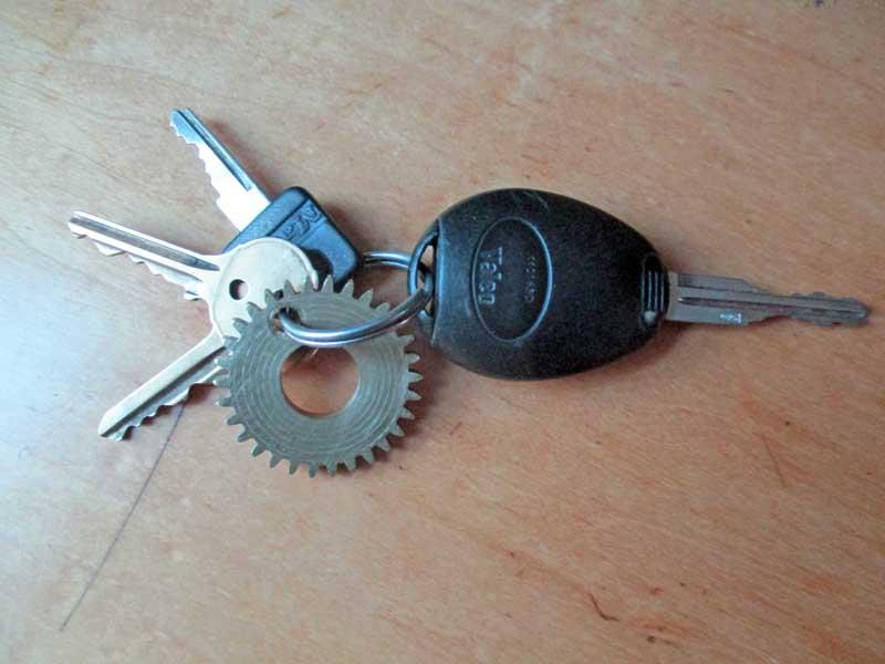

I found a use for the gear that I messed up. I drilled a hole near to the edge and now I have an interesting key fob.

« Reply #72 on: October 28, 2017, 11:59:00 AM »

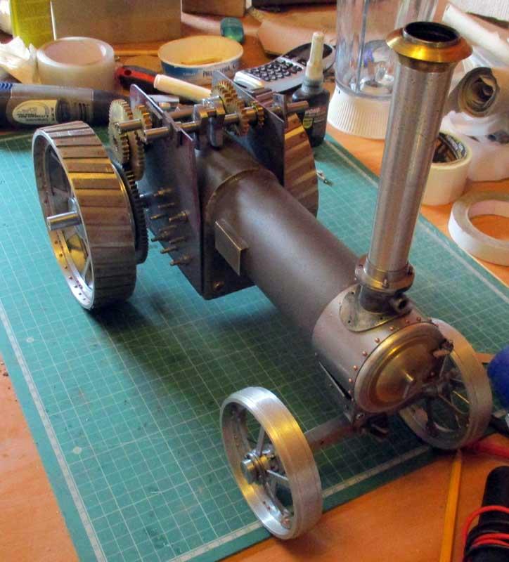

I've now drilled the hornplates and am able to fit the shafts to check the mesh of the gears. Everything seems ok, they run a bit rough but I am sure that they will bed in with a bit of use.
