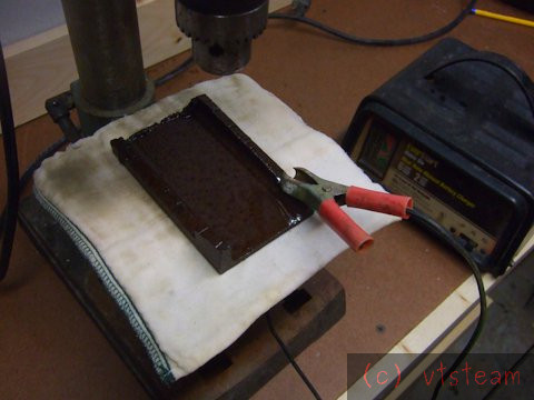

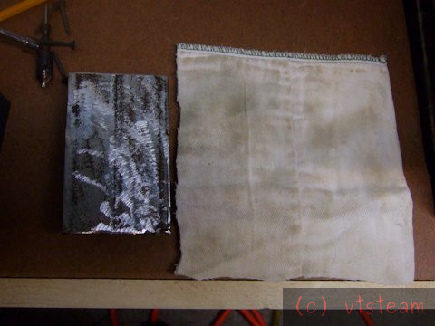

Here's a cloth pad (old cloth diaper (nappie?)) cut to fit the drill press table, and a scrap block of steel as an electrode.
« Last Edit: January 15, 2018, 11:10:03 PM by vtsteam »
Re: Working on a new tiny shop
« Reply #76 on: December 20, 2014, 04:49:41 PM »

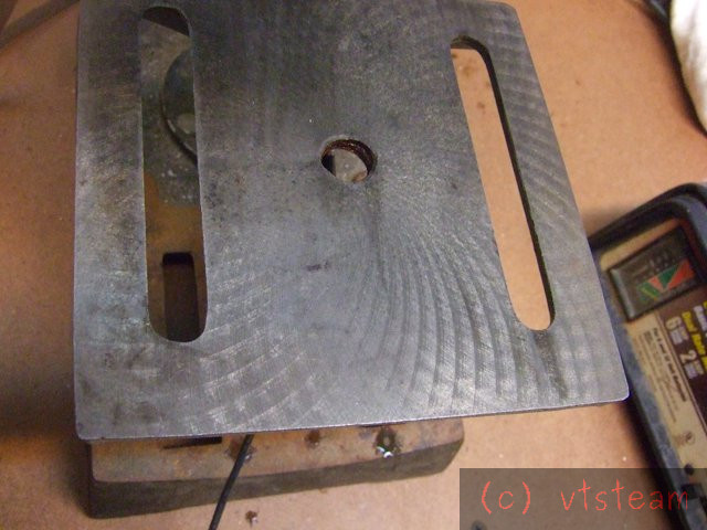

Here's the pad and electrode set up on the drill press. I used a battery charger set to 6 volts. Current draw with this setup was about an amp. I wore rubber gloves even though this was a low voltage (washing soda is rough on skin -- as well as conductive), and never touched the press or pads while the charger was plugged in. Even low voltage can kill if the current is high enough, or there is a ground fault, and I don't take chances that way.
I had the door to the tiny shop open while de-rusting -- that's practically as much ventilation as removing a wall on a shop this small. I don't recommend anyone else try this under other circumstances, but as I did it I felt confident I wasn't going to fry myself or ignite gasses. The precautions hold true of charging an auto battery in a space like this.
« Last Edit: January 15, 2018, 11:10:37 PM by vtsteam »

I was gratified to be able to see even the original factory milling marks of the drill press table after only 10 minutes of de-rusting using this setup:

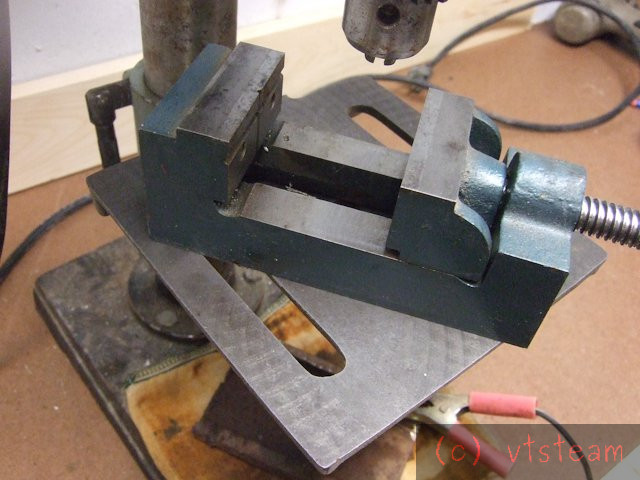

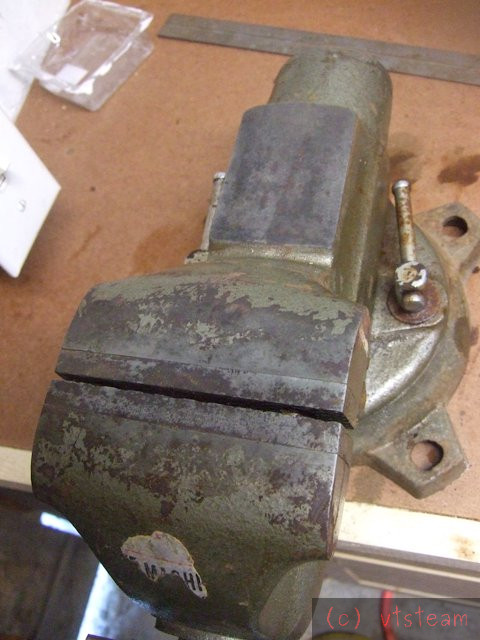

« Reply #78 on: December 20, 2014, 05:01:09 PM »
The bench vise was trickier because it wasn't flat, Rust removal wasn't perfect, but good enough for now. Next summer I'll probably take it apart, de-rust in a tank, and paint it.
« Reply #79 on: December 20, 2014, 05:06:11 PM »
The drill press and drill press vise look a lot happier than they did before. You can see I'm de-reusting the base below.

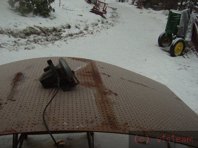

I bought a sheet of pegboard the other day, and it's started snowing again, so I figured I'd better cut it up and get it inside. It's "tempered" which means water resistant, but I don't like to get it wet for long anyway.
I'm looking forward to working inside one of these days!  :loco:

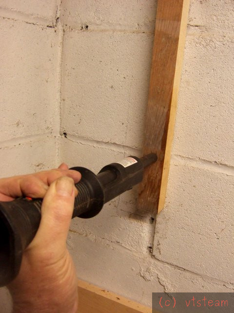

I ripped up some 1-1/2" square strips from 2 by material to hang the pegboard from. And I used a Ramset nailer to attach the cleats to the concrete block walls. These use a .22 charge to propel a hardened nail into the block.

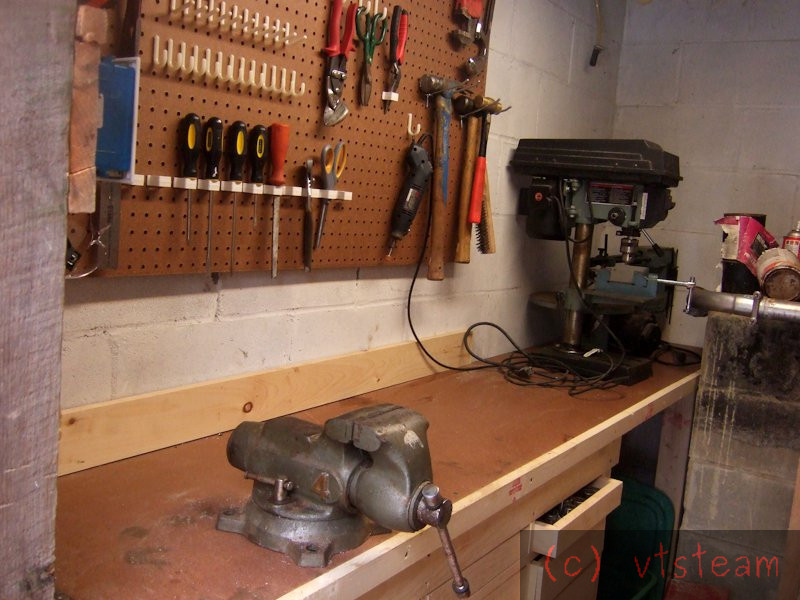

And a view of the shop as it stands so far. I still have to photograph from outside to get it all in the picture!
« Last Edit: January 15, 2018, 11:15:10 PM by vtsteam »

I have one of those Ramset guns, and when I first got it (perhaps 20 years ago)tried fixing a batten to a blockwork wall. The nail went right through, travelled 8 foot, went through the control enclosure of my Moog Hydrapoint 1000  NC machine, and penetrated a 24 volt power supply righting off the transformer  :bugeye:
Since then I've treated it with caution  :lol:
Last time I used (couple of years ago) it was to fix battens to the steel Universal Beams of my barn. It had no problem pushing a nail through a 6 mm web of the beam, but highly effective. Quite a kick though, my wrist hurt for days  :bang:
« Reply #89 on: December 21, 2014, 05:55:35 PM »
  :lol: Holy tamale, Andrew, you think maybe you used too high a number charge?
Sorry, it's not funny, really -- I imagine that must have shook you up! Not to mention irritated you about the CNC machine!
Stuff like that, that's when I usually start using some choice swear words about myself.  :bang: :bang:
I use a #2 or #1 (green or brown) with concrete block. I think they go up to #5 (I don't even own anything over a #3).
I always shoot into a center rib or the mortar at a rib with concrete block. And since I built the wall, I know I'm going through solid. Never had a wall penetration.
Sometimes I don't get a full bury, but then I just hammer it home the old fashioned way. I'd rather under shoot than over!
Never tried it on steel. I know it's done, but seems impossible!

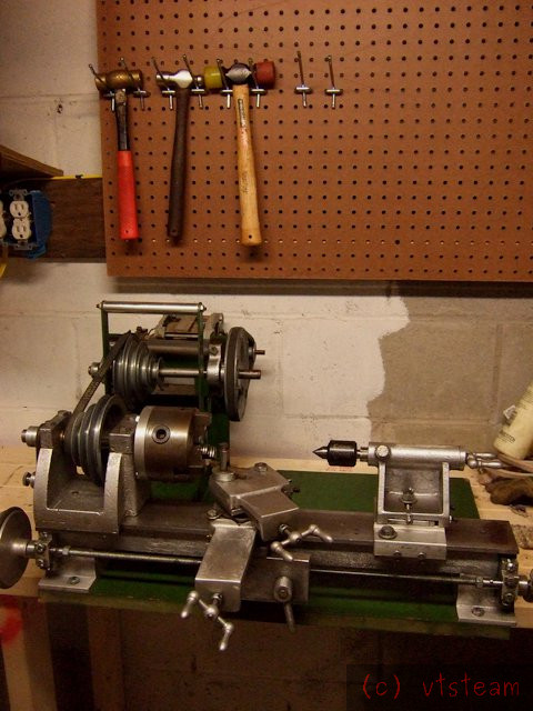

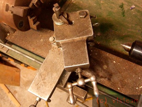

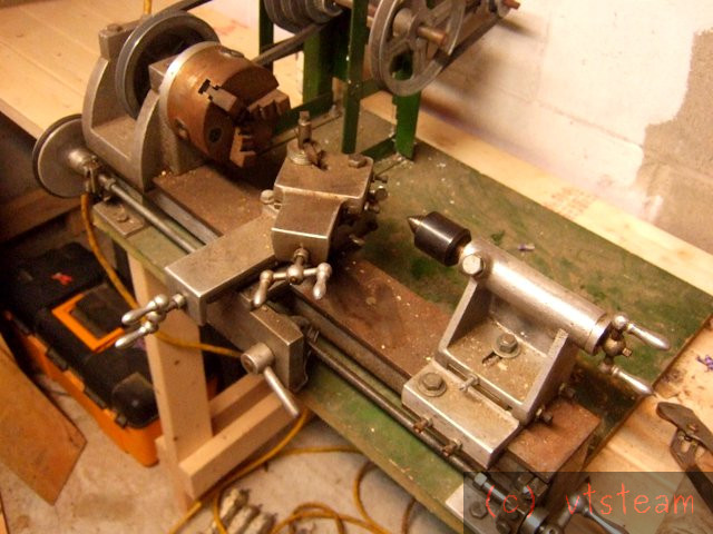

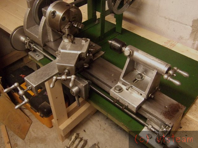

I managed to put away a lot of the tools I was using to build the shop and shift other items to storage. This uncovered my Gingery lathe, which had suffered a lot in storage. I decided to take another break from construction and clean it up to get an idea how bad the rust was. Here's what it looked like before cleaning:
« Last Edit: January 15, 2018, 11:16:56 PM by vtsteam »
« Reply #94 on: December 22, 2014, 05:16:46 PM »
But a little kerosene and a brush, and a clean with some rags showed that what I thought was rust, was mainly grime and old oil, and the lathe looks pretty good except for some minor spots -- I'll probably deal with those using some spot eletctrolysis pad cleaning with washing soda and water. There is far less rust than there was on the drill press and vises. The only real spot needing treatment is a small bit of surface rust behind the tailstock.
Quite happy about this -- it has really been bothering me seeing the state the Gingery lathe had fallen into these past few years in storage. Now it's rescued and will be used!  :ddb:
« Last Edit: January 15, 2018, 11:17:36 PM by vtsteam »

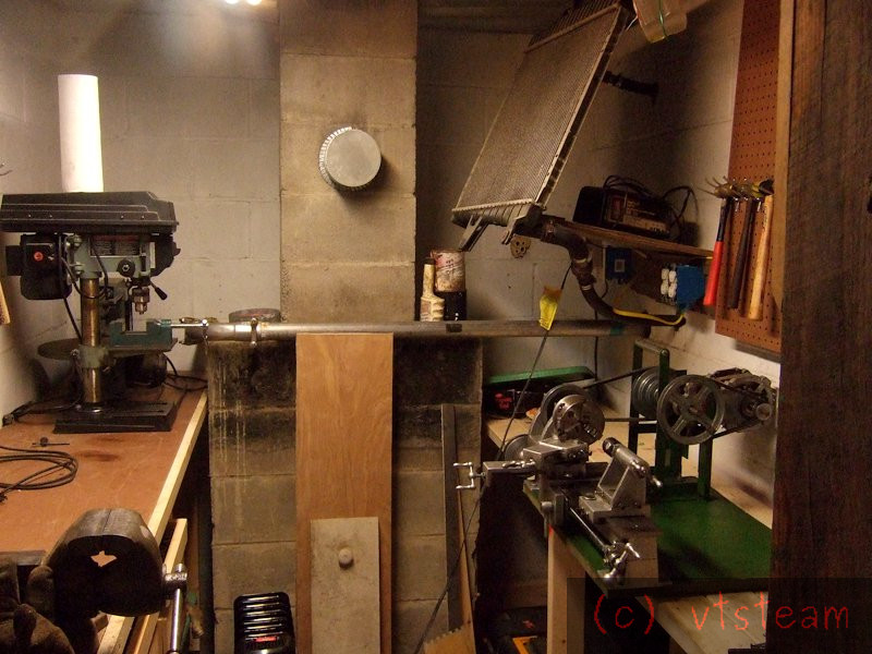

The lathe is located on the right side bench, which needs more work -- it will be extended wider, covered wth hardboard, and will receive probably shelves under, rather than drawers this time, so I can store metal stock and hand power tools.
I also want to make a different (sturdier) mount for the lathe, and move the motor, so the whole package is narrower.
I did manage to get some construction work done after all. I put up pegboard on this side of the shop, too. To do it, I had to move wiring and an outlet (not finished yet, but temporarily usable).
« Last Edit: January 15, 2018, 11:18:30 PM by vtsteam »
« Reply #96 on: December 22, 2014, 05:30:57 PM »

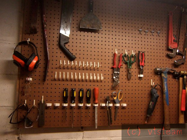

This is the latest state of the shop, as I left today -- view from the door. You can't see the left hand wall pegboard with tools shown earlier.
Two 8' benches, 32 sq ft of pegboard, and 15 drawers, so far.
« Last Edit: January 15, 2018, 11:19:04 PM by vtsteam »
