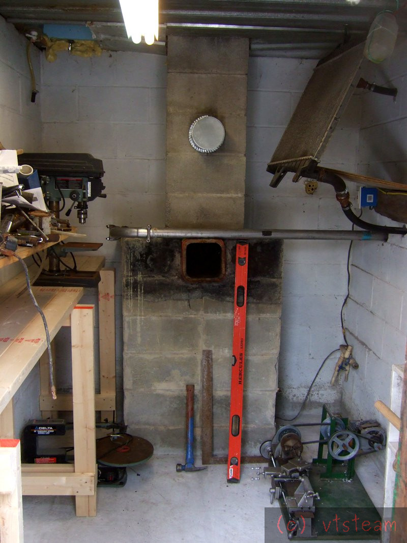

My main shop is about 300 feet from the house, 10 x20, uninsulated and unheated, and it doubles as storage space. It's okay for summer use but pretty tough for winter work -- and steeply down hill. Kinda creepy walking there through the dark woods at night, too!
I have another small shed only 20 feet from the house that once housed a wood furnace I built (HAHSA type).
It's built of concrete block and has a metal roof and also features a built-in brick chimney. So it would be ideal for a small cozy shop to work in evenings.
It should be easy to heat There is  3" foam insulation on the outside of the block, giving a good thermal mass. And one end is actually underground, since it's built into a steep hill. Heat retention is very good. The only problem is, it's tiny -- 6 feet by 8 feet, and the chimney comes down to the slab at one end giving a practical floor space of really more like 6 by 6 feet.
Still I think it's usable -- a small space is better than no space! So I built up the floor a couple weeks ago with a couple inches more concrete (it used to drain in from the door instead of being level), and have started to make two full length benches. They can extend beside the chimney -- so can be full 8' long. Top width on one side could be 24" and on the other side 20" to clear the door.
Two full length benches would take up 44 of the 72 inches available, leaving an aisle of 28" between them. I think that's tight but do able, and I figure I'll mostly be sitting down anyway. I suppose I could reduce wider bench to 20" and get an aisle of 32". But I'm not sure if that will really make much positive difference, and a wider bench seems to me to be more useful.
I know the basic machines I'd like to put in there -- all of which have been stored and and unfortunately attacked by surface rust. They need TLC -- and the new shop is just the excuse needed to restore them to good condition.

And if I can figure out how to do it -- I'd like to convert the lower block portion of the chimney to a miniature forge and melting furnace. It could then also provide heat, though I'll have an electric oil filled radiator in the shop as well.
The jigsaw and sander will be used for pattern making, and the sander can double as a tool sharpener. If I need to take off serious metal I can always go down to the bigger shop and use the bandsaw and grinder.

No Andrew, that's not possible. The house is on concrete piers, 15 of them. Drop offs on 2 sides -- one side is probably 20 degrees, though there is a cantilevered house section there of 10' x 20' that could be deepened -to give headroom - but essentially inaccessible without road building, etc.
I'm hoping to use my rehabilitated backhoe next summer to make some changes around the house in general for better access, but not this year.
After checking my Atlas mill and Gingery lathe, I think the 20" wide bench I started yesterday is just too narrow for them. And I think the 24" bench (not started yet) is going to take up too much aisle room for me to be happy with both -- at least if they are both full length. So I may be shifting things around today and also shortening bench plans.
In fact I might have to eliminate the Atlas mill altogether, which wouldn't be a tragedy. I built extensive milling attachments for the Gingery lathe. And it's more fun to use something you built yourself.
I just hate the fact that I never use that Atlas mill for anything and I've got a big range of tooling for it. But it really wants mounting on a bench corner as a minimum -- you really need access to 2 sides of a horizontal mill. Full length  benches have no corners! Maybe it's time to think about selling it.

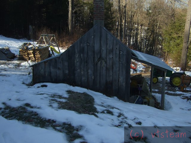

Finally, here are some pics to show you what I'm talking about. Shed from back (in ground lower wall). You can see the two side extensions and chimney.
« Last Edit: January 15, 2018, 10:53:23 PM by vtsteam »

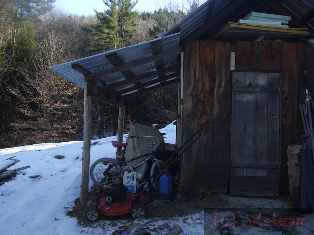

« Reply #12 on: December 05, 2014, 02:36:02 PM »
From front, left extension. Slab just poured with bikes/storage already on it.
« Last Edit: January 15, 2018, 10:53:59 PM by vtsteam »

Interior of the central block house, showing chimney, partially decked 20" bench on left. The distance to the walls from the chimney is 20" on each side. The door is offset to the left. The right side could be 24" and still clear the door. Left must be 20" to clear the door.
The upper crowded shelf on the left is left over from earlier and will be removed.
The radiator upper right is for the generator and can heat the shop.
« Last Edit: January 15, 2018, 10:54:26 PM by vtsteam »

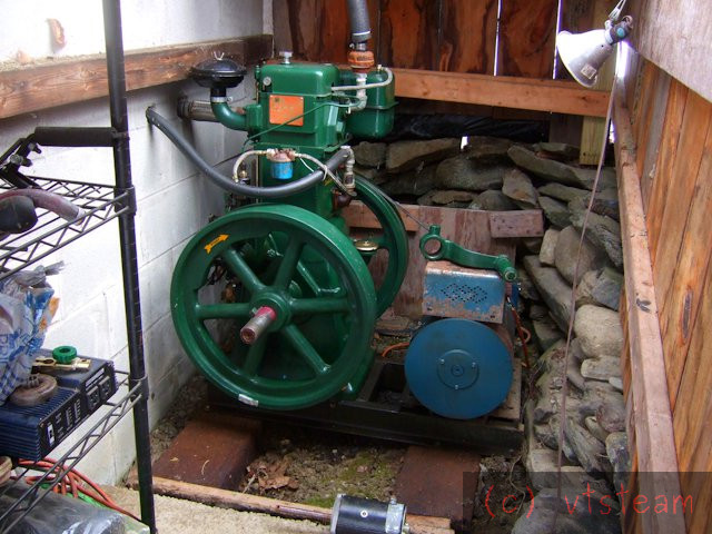

Interior of the right side extension of the shed, showing the generator:
« Last Edit: January 15, 2018, 10:55:18 PM by vtsteam »

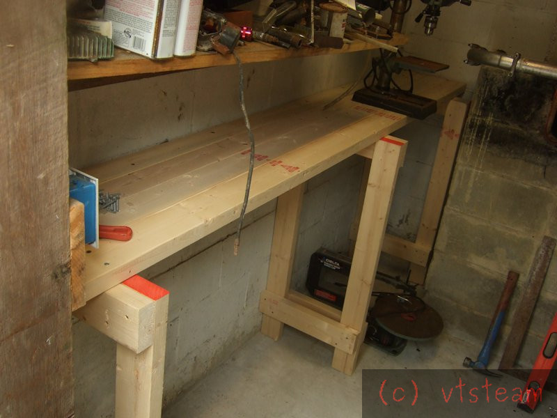

« Reply #15 on: December 05, 2014, 02:53:54 PM »
Bench partly planked -- giving a better view of the size (8' long).
Interfering shelf will be removed.
« Last Edit: January 15, 2018, 10:55:39 PM by vtsteam »

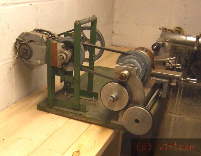

Thanks David it doesn't take much to heat that tiny insulated space. I don't want to tear out the chimney. I also have an oil filled electric radiator, that I probably will use a lot of the time anyway.
Eric, I sure have drilled a lot of holes with that drill press since 1995!  :dremel: -- TThe last 8 years it's been in storage along  with the now somewhat shabby Gingery lathe.
This new shop Is a great reason to bring them back and fix them up -- really happy about that. I always liked working with the Gingery -- more than the 12" Craftsman that I mostly use now. The QC toolholders I made a couple years ago fit both, so this should make the Gingery even better.
I removed the shelf over the 20" bench and set the Gingery on it. Photo below. Sticks out quite a bit. But if I move the motor on top of the jackshaft instead of in back of it, I can lose about 6" of width for the lathe footprint, and it will fit. So, if I don't use the Atlas mill, I won't need a 24" bench on the other side -- I can go with 20", and that will make the shop feel roomier. And possibly allow the furnace idea down the road.
If someone was really clever they would move the whole drive section over the top of the headstock, and maybe even create a mini lineshaft to drive a Pott's spindle. But not me, at this point!

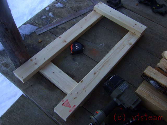

Today I cut wood and made up 3 sets of legs for the right side bench. These are shorter legs -- 34-1/2" to yield a 36" finished height. The left bench has a 40" finished height, which feels okay for some things but high for others. A framing nail gun is overkill for making these, but since I have it, it does make holding alignments easy compared to pounding in nails.
I got the right side bench partially planked by evening, but no photo for that, yet
« Last Edit: January 15, 2018, 10:56:57 PM by vtsteam »
