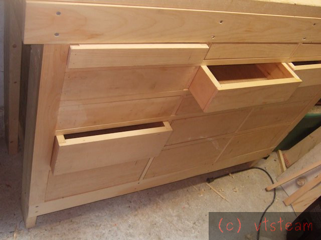

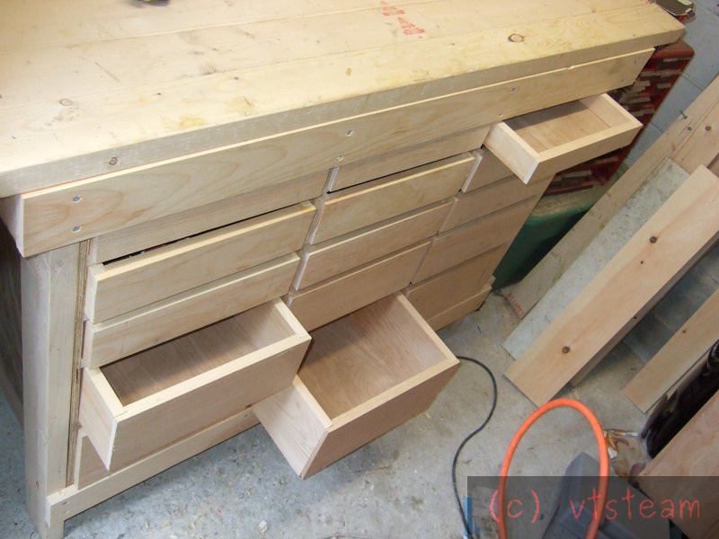

I finished making the drawers this afternoon. Still more to do, but I already put a few things that were lying around into them!

Finally today I cut up most of the scrap from the drawer wood into strips and added those as trim to the sides and between the drawers. Now they are flush and the plywood edges are covered. Only problem is........I should have made drawer handles first -- it's rough on the fingernails getting those drawers out! :loco:
Oh well, tomorrow.......

Why not bore finger holes - maybe a bit over an inch. Handles are going to snag you as you work in there.
  • Posts: 6870
Re: Working on a new tiny shop
« Reply #59 on: December 18, 2014, 05:10:15 PM »
I just don't like 'em, Andrew.  :beer:
  • Posts: 9074
« Reply #60 on: December 18, 2014, 05:12:09 PM »
OK a 'hand rebate' in the top edge of each drawer?

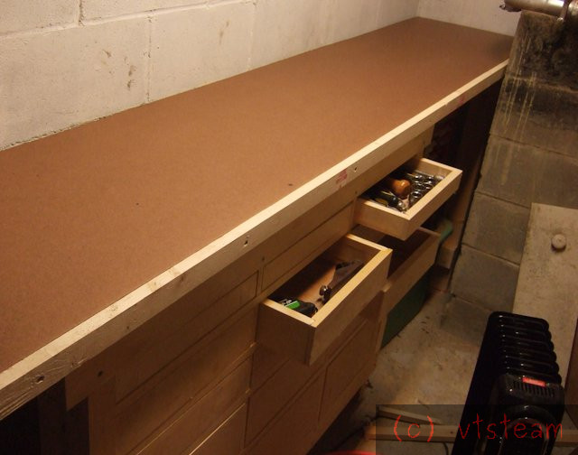

Today I went to the lumberyard again and picked up a sheet of 1/4" tempered hardboard (we used to call it Masonite) to surface the bench with.
After I got back home, I replaced the benchtop timber I had sawn off a few days ago to gain access to the back of the bench. It was just a matter of screwing the 2 by 4s to the rear legs and to a cleat under the joint between the two sections.
Then I took an 8 foot 2 by 4 and ripped it into a 1-1/2" square section, and rabbeted it 1/4" deep and 3/4" across on the table saw to serve as a cap. The rabbet is there to accept the hardboard. I attached the cap to the benchtop all the way to the back wall, further stiffening the joint between the two halves of the top.
Then I ripped a full length strip of hardboard (without a helper or a big bench it was like like trying to saw a wet noodle!) and screwed it down, countersinking the screws.
Here it is when I was done. The bench is back to the full 8' long, and the cap padded it out to just short of 20" in width.

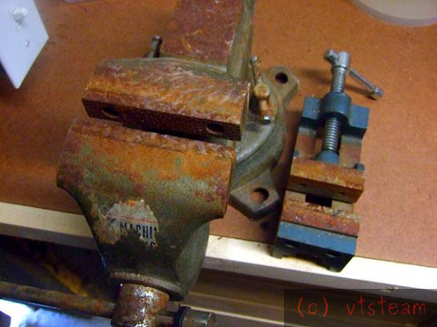

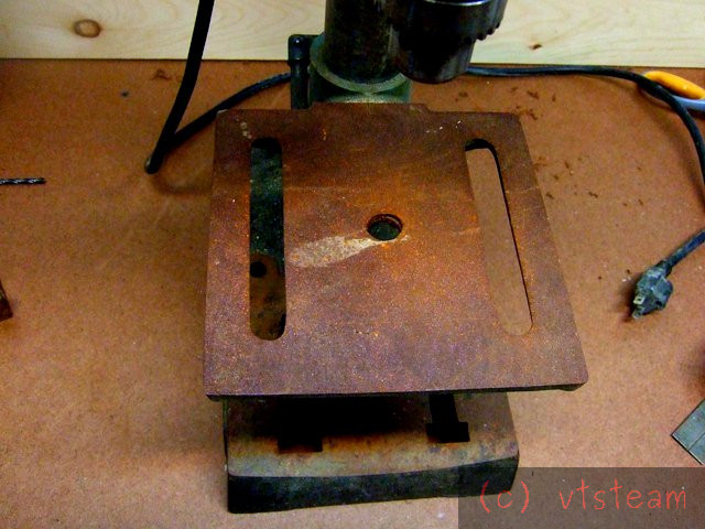

After pulling out the vise and drill press to see how they fit on the bench top, I decided to spend the afternoon cleaning off the storage rust.
Since it's too cold to keep a tub of water and soda electrolyte, or connect a hose to rinse them off, as in summer, I decided to try to use a damp cloth to carry electrolyte, and clean some pieces, in situ.
Here's what the vises and drill table looked like:
