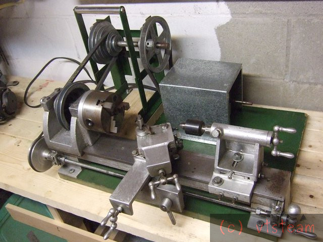

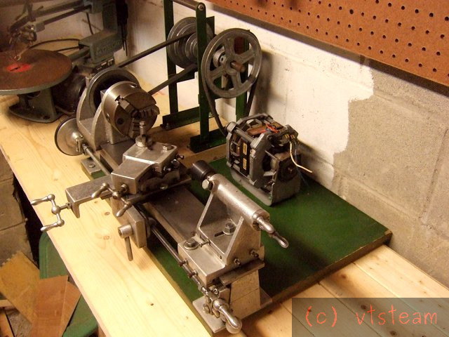

I did work on the lathe a little today, to make it narrower.  The motor is mounted in back of the bracket as shown. And that extends the width of the lathe, and requires a really wide bench top.
This bracket has an over-center lock. By pulling the handle forward, the lathe change belt is disengaged from the spindle. The motor is on the bracket to maintain tension with the jackshaft, no matter what position. My earlier thought was to move the motor higher on the mounting bracket and nearer to the handle, to get it away from the back of the handle.
Here you can see it against the back wall on the right hand bench.

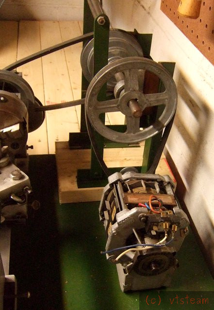

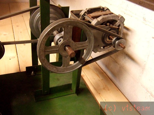

But today I realized that because of the motion of the bracket, it also moves the jackshaft closer to the base when you release the lathe spindle. And when you tighten the belt again, it moves the jackshaft away from the base.
So if I mounted the motor on the base, it could tighten its own belt on the jackshaft pulley at the same time the lathe spindle pulley tightened.
In other words it would be a double clutch action instead of a single, and the jackshaft would stop when the handle was pulled forward along with the lathe pulley.
And I also thought that if I raised the bracket up, I might be able to find a position where I could re-use both belts. Here I was testing the height with some scrap blocks and the motor position needed to get both belts to work with this idea.

« Reply #107 on: December 27, 2014, 05:34:27 PM »
There was a position where it all worked, and I bolted and glued the spacer blocks down to the base, and bolted the motor down. This should also stiffen the area between the bracket and the lathe headstock. It has made about a 5 " difference in the width of the footprint. In fact I could probably reduce it another 2" by trimming the back edge of the mounting board, since the blocks are that far inboard, and the motor is, also. The lathe now fits well on the bench top.
« Last Edit: January 15, 2018, 11:21:44 PM by vtsteam »

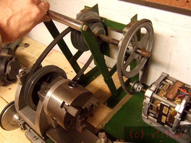

« Reply #108 on: December 27, 2014, 05:38:42 PM »
And finally for today, here's a shot of the handle being moved part of the way forward. Both the lathe and the jackshaft disconnect from the motor this way.
Another possible advantage of the new setup is that the motor and jackshaft could also now have a couple of different size pulleys, for another speed range, since the belt now slacks to allow changing the motor belt position.

Looking good! I was just wondering if you could switch the pulleys around so the motor is behind the chuck and not in the swarf zone.
Re: Working on a new tiny shop
« Reply #110 on: December 27, 2014, 08:58:16 PM »
You could, Tom, but then the footprint would be longer. I'll be making a motor enclosure for this particular configuration.

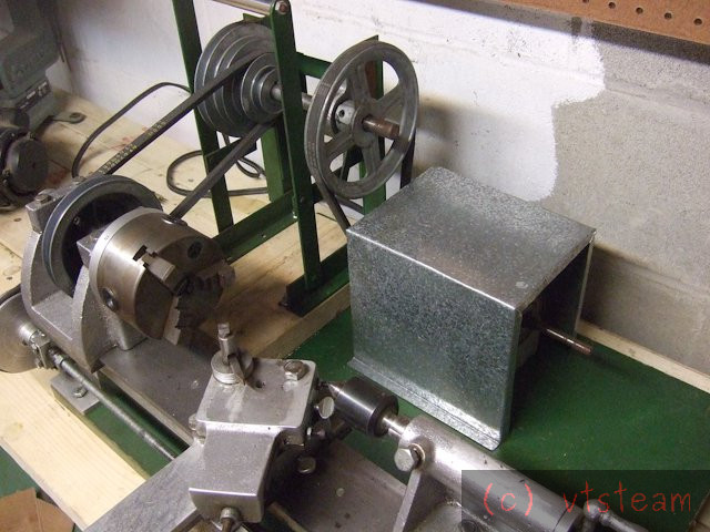

Yep, A motor enclosure is an extremely good next move. Too many sparks otherwise - at least till things blew up.  :zap:  Does the motor have a cooling fan someplace? I can't tell from the Pictures. You could fit one on the shaft by the looks even with a second pulley I think.

Yup, John, the motor does have a fan. I've got the sheet metal for the enclosure all ready. Might do that tomorrow if I have time -- we're supposed to visit friends in the morning.  :beer:

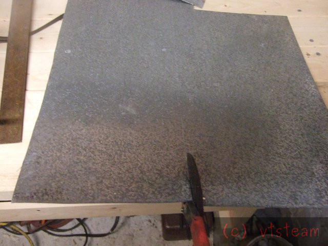

From a former piece of ductwork:

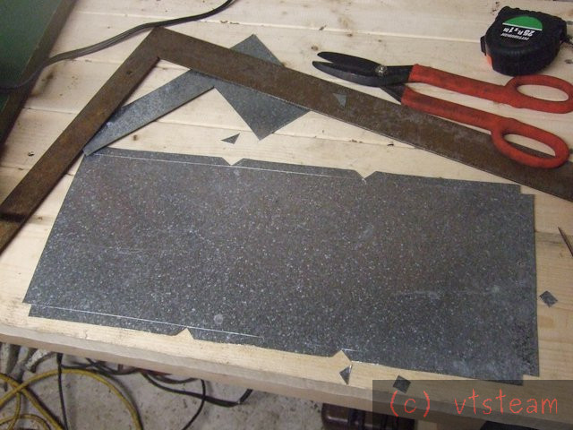

I laid out the shape for one of the housing pieces and notched it:
« Last Edit: January 15, 2018, 11:24:42 PM by vtsteam »

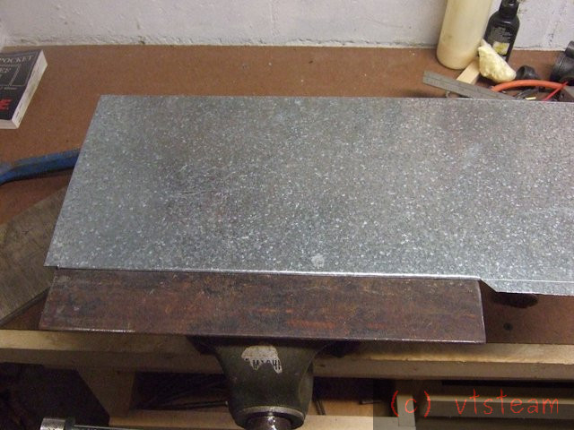

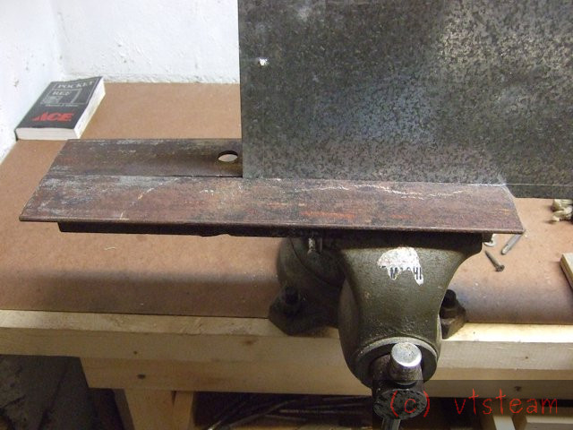

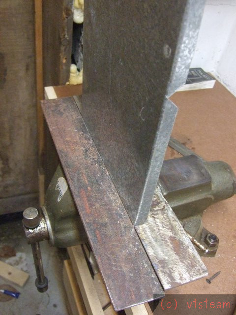

I don't have a bending brake, so I used two pieces of angle iron clamped in the new bench's vise:
« Last Edit: January 15, 2018, 11:25:04 PM by vtsteam »

Some gentle tapping with a soft hammer while applying pressure by hand folds it flat:
« Last Edit: January 15, 2018, 11:25:31 PM by vtsteam »

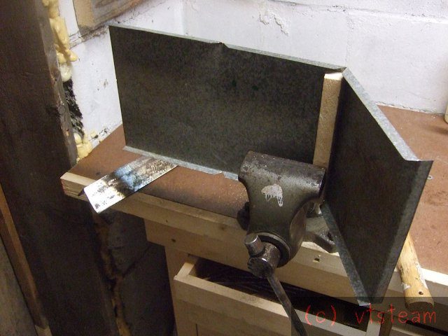

Edges done, now folding the bottom flange:
« Last Edit: January 15, 2018, 11:25:59 PM by vtsteam »

Bottom flanges done, now folding the corners. I used a piece of pine offcut from the drawer slides. Hardwood would have been preferable as a permanent addition to a new "bending tool" collection, but the pine served....
« Last Edit: January 15, 2018, 11:26:23 PM by vtsteam »

Trying the cover piece in position:

Incidently, I made a similar bending project a few days ago. I spent maybe 1.5 days planning, sourcing and building a bender first (the DIY type where you bolt down some heavy duty L profiles to the bench).
Long story short - it worked, kind of, but in the end it was just too much of a hassle and not flexible enough (no pun intended). In my desperation, I ended up doing it just like you, in a vice. That way, the whole bending was done with in about 30 minutes and turned out very fine. Wish I had seen your photos before wasting those 1.5 days. :)

Crazy, I was just thinking about inlaying a section of angle iron in the bench edge with tapped holes to accept a second piece for bending sheet metal  :)  -- is that what you had tried?
BTW the angle iron in the vise wasn't ideal -- mainly because angle iron has an inside corner fillet, so it makes aligning the work and two irons difficult. You have to align things above the jaws, not resting on them. Takes 3 hands!
I think I might attach a padding strip of steel to the inside face of the angle iron to pad it out past the radius. Then the iron can rest on the jaws and align automatically. Or you could mill out the radius. But shifting things around for a minute or so worked okay for this job, lacking better facilities.
