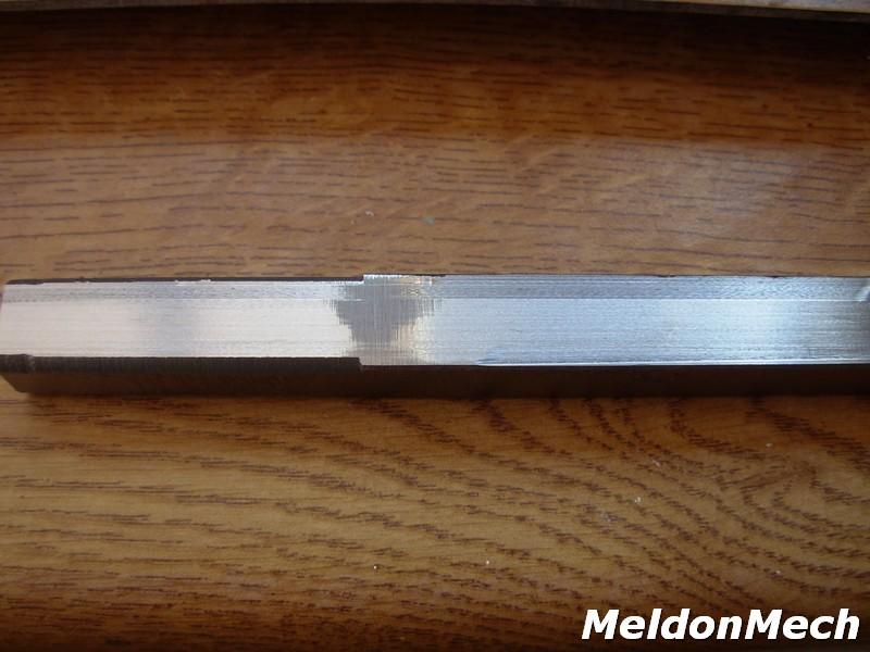

I have recently been given some lathe tools
http://i261.photobucket.com/albums/ii63/john970s0/cap%20frame/GrabbedFrame12_zps2ef450e0.jpgsmall lathe big tools
They need machining to fit my tool holders
http://i261.photobucket.com/albums/ii63/john970s0/cap%20frame/GrabbedFrame14_zpsbf97d4b8.jpgsmall lathe big tools

« Reply #1 on: August 11, 2014, 08:59:46 AM »
Used to turn em down when had an ML7 without QR.
Ok if decent tools like Kennametal, Ceratizit, Iscar and Horne but wouldn't risk it with the cheap imports.
I now use the 250-200 series and only have one holder untouched milled out of 23. Biggest tool in is a 1" RH still ample unless taking 1" off, majority are 20mm high including threading, easy on.
Don't think theres much height difference between the 250-100 and 250-200 series.
