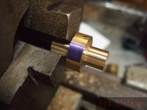

« Reply #50 on: July 26, 2014, 05:19:01 PM »
Turning done:

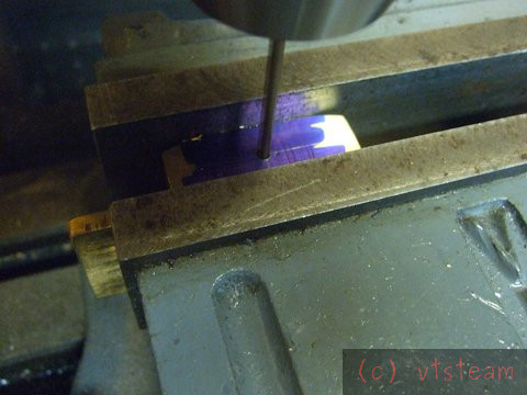

« Reply #51 on: July 26, 2014, 05:21:04 PM »

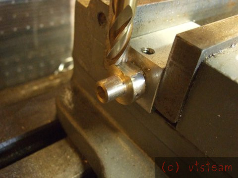

Then back in the mill to add some wrench flats. I got to use one of my mill holders for my mill sharpening sander project to act as an indexing block while milling the valve here:
« Last Edit: January 12, 2018, 10:38:09 PM by vtsteam »

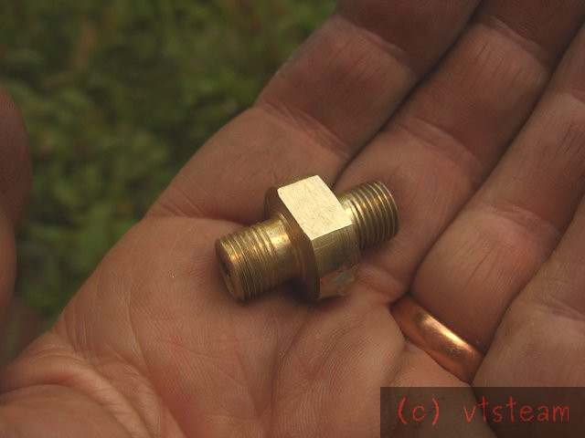

Valve body done. After this photo I set the valve in the bench vise, dropped the ball in place and, with a drift, gave it a light tap to seat it.
« Last Edit: January 12, 2018, 10:38:46 PM by vtsteam »
  • Posts: 6941
Re: Popular Mechanics Boiler
« Reply #53 on: July 26, 2014, 05:28:23 PM »
The brazing rod fit well and trapped the ball with just the right amount of play.
« Last Edit: January 12, 2018, 10:39:46 PM by vtsteam »

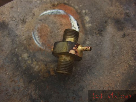

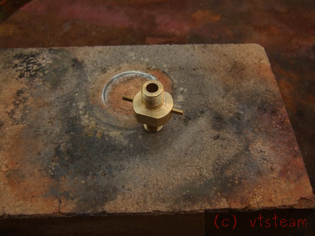

I threaded both ends 1/8" NPT pipe thread. Then it was time to seal the pin.
The check valve outside on a fire brick, ready to silver braze the pin in place:
« Last Edit: January 12, 2018, 10:40:36 PM by vtsteam »
  • Posts: 6941
« Reply #55 on: July 26, 2014, 05:39:38 PM »

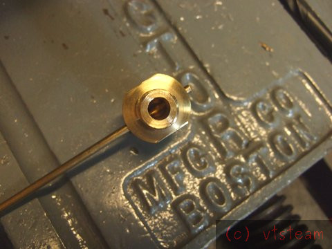

Brazed:
« Last Edit: January 12, 2018, 10:41:12 PM by vtsteam »
  • Posts: 6941
« Reply #56 on: July 26, 2014, 05:43:34 PM »
And done. It works great -- at least blowing through it. It seems quite free in the open direction, and instantly seals in the other. Horizontal orientation doesn't bother it. Quite happy with this result!
« Last Edit: January 12, 2018, 10:42:02 PM by vtsteam »

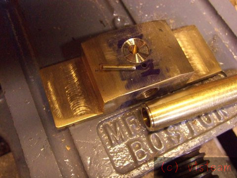

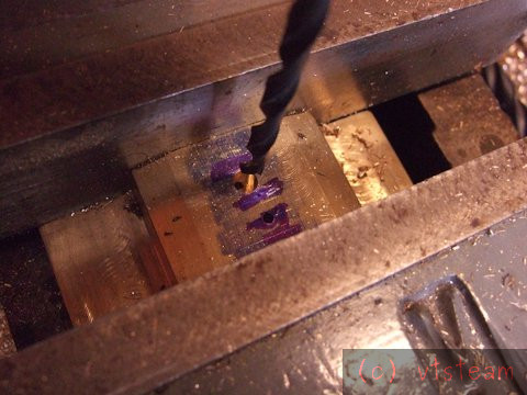

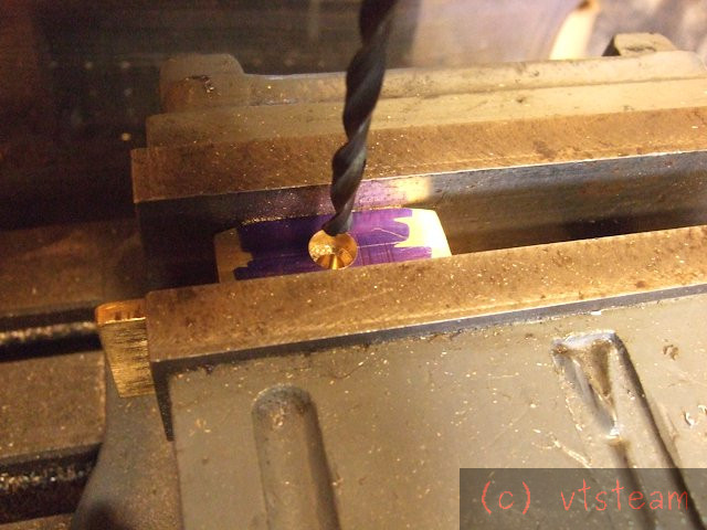

Today I started work on the pump base valve. First I drilled through 1/8":
« Last Edit: January 12, 2018, 10:42:39 PM by vtsteam »
  • Posts: 6941
« Reply #59 on: July 27, 2014, 06:53:12 PM »
Then I drilled 7/32" for the stainless ball, as done yesterday. And after, opened out to tap size for 1/8" pipe thread:
« Last Edit: January 12, 2018, 11:12:12 PM by vtsteam »
  • Posts: 6941
« Reply #60 on: July 27, 2014, 06:55:25 PM »
Then I turned the base upside up, and drilled for the retaining pin and a hole to connect the valve passages with the pump cylinder:
« Last Edit: January 12, 2018, 11:12:46 PM by vtsteam »
  • Posts: 6941

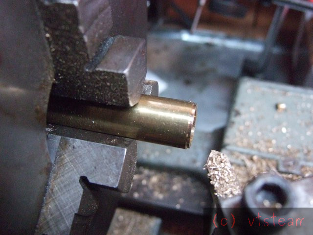

« Reply #61 on: July 27, 2014, 06:57:20 PM »
I''m going to use a 1/4" brass pipe nipple as the pump cylinder. I cut the threads off one end and turned a small step in the end:
« Last Edit: January 12, 2018, 11:13:20 PM by vtsteam »
  • Posts: 6941

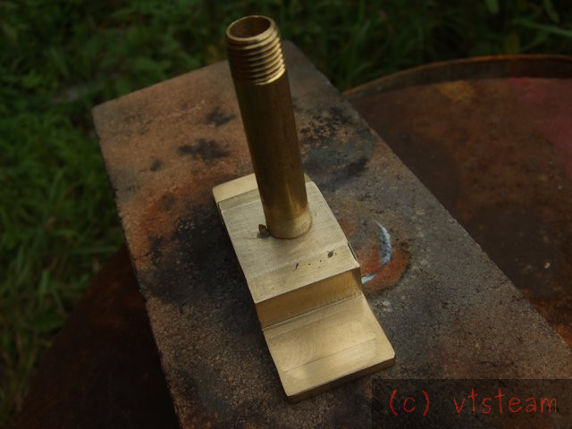

« Reply #62 on: July 27, 2014, 06:59:02 PM »
The pieces of the pump base -- I faced a small recess in the base to fit the step in the pump cylinder.
I had to offset the cylinder slightly to clear the retaining pin:
« Last Edit: January 12, 2018, 11:13:55 PM by vtsteam »

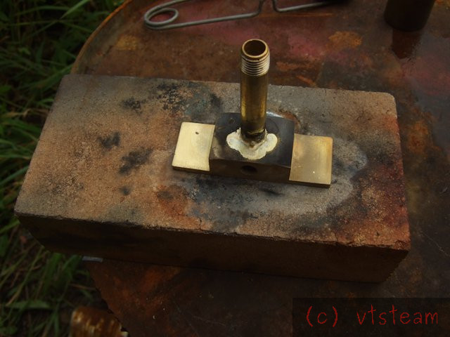

The pieces together and ready to silver braze:
« Last Edit: January 12, 2018, 11:14:51 PM by vtsteam »
  • Posts: 6941
« Reply #64 on: July 27, 2014, 07:01:18 PM »
Brazing complete:
« Last Edit: January 12, 2018, 11:15:38 PM by vtsteam »

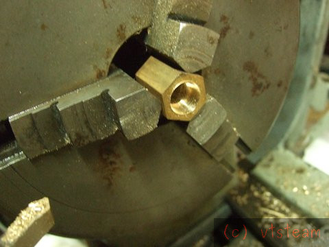

I found an odd bunch of scrapped hex fittings in my nail keg o'brass, so I drilled one out as the pump cap, and tapped it to fit the 1/4" pipe nipple threads:
« Last Edit: January 12, 2018, 11:16:18 PM by vtsteam »

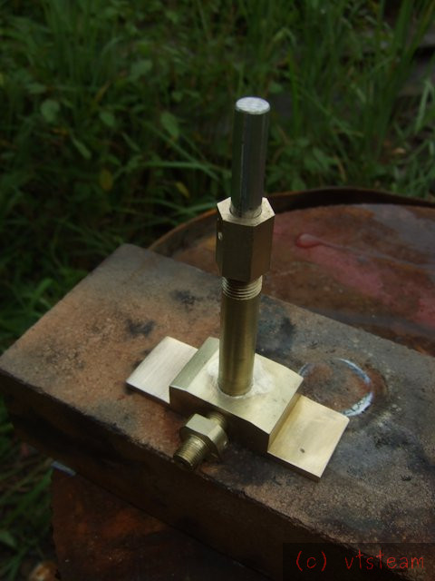

« Reply #66 on: July 27, 2014, 07:05:35 PM »
And finally, where I left off today -- the pump body and cylinder and attached check valve:
« Last Edit: January 12, 2018, 11:17:17 PM by vtsteam »

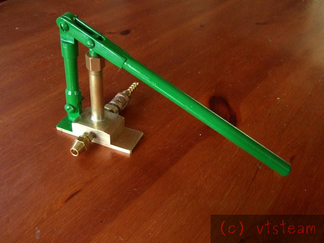

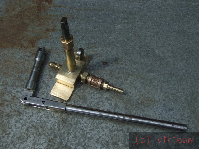

Here are a couple photos. Pump parts:
The plunger was 3/8" cold rolled rod that just coincidentally fit the 1/4" brass pipe nipple used for the pump body. No machining necessary.
I turned a groove at the end and added an O-ring.
I also changed the cap,  originally from brass scrap, to a simple pipe cap, drilled to .375" and some cotton string added for packing.
« Last Edit: January 12, 2018, 11:18:17 PM by vtsteam »
  • Posts: 6941
« Reply #74 on: July 31, 2014, 04:13:24 PM »
And here's the pump assembled and painted:
ps. re. the plunger -- I'm going to make another of stainless steel -- just found an SS bolt to turn down for the replacement at the hardware store.
