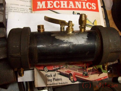

Here's the first trial fit. Nothing has been screwed down yet. The relief valve is immovable as specified (silver soldered to the lever arm and set in a hole with .001" clearance.) I didn't actually use a wood screw, instead I turned a valve from brass stock.
Later in the day I unsoldered the parts, and re-grooved the valve. It now lifts the lever freely, though there is no yoke to capture it if it lifts too high, and the part could be lost.
Using the spreadsheet I wrote earlier, I was able to calculate the the pop off pressure of the design as drawn was probably under 10 PSI.

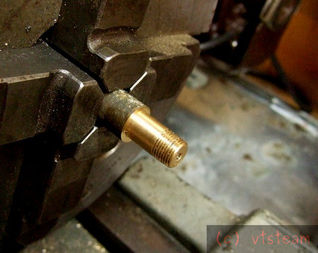

I don't particularly like the hole in the pipe body being the valve seat, and the sub 10 psi relief is lower than I'd like. That is with the 1 ounce weight out at the furthest notch. The only solution is more weight, or a smaller hole. More weight starts to get cumbersome -- it might contact the boiler side.
I decided I'd prefer .125" to the .164" present bore . so I started to make a replacement screw-in valve seat of brass. I can then drill out the present valve hole, tap and mount the seat. The seat was threaded for 1/8" pipe taper.

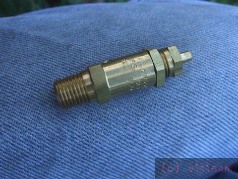

Here's a commercial ball and spring relief valve -- larger than needed for this particular boiler, but typical in design. In this case the spring is located in a housing above the ball. I like that particular feature.

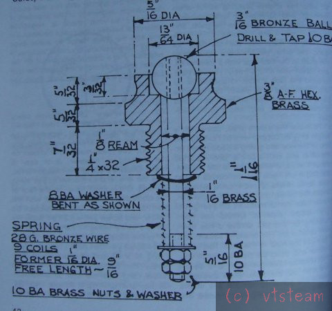

Here's a classic style small boiler steam relief valve. It's the valve actually used on Polly by Tubal Cain -- David Stilldrillin recently featured one of these engines here on MM:
This one requires a bronze ball and hand wound bronze wire spring. The ball is drilled and tapped to accept a guide rod. A cupped square hole washer is also required. The valve spring is located in the boiler, rather than externally.
These details make it seem difficult to me to build. I have no idea where I'd find bronze balls or wire, or how I would drill and tap the ball, and I don't like the idea of the spring being in the boiler as much as outside. Nevertheless I'm sure these give satisfaction -- just not what I'm favoring right now.

If the ball is guided by a rod, then wouldn't just a regular cone/ taper turned on the lathe work instead? It does seem weird to use a ball.

Hi Simon, a ball tends to be self centering, is easy to make a seat for (via light impact), and is considered to have less likelihood of jamming. You can buy balls ready made, high precision, and polished. Stainless is common, bronze isn't -- at least here.

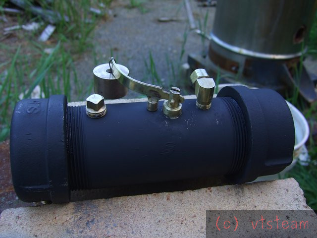

So I was thinking this morning of how to use a stainless ball, in an external relief valve, that is a lever-weight type, instead of spring loaded, and one that doesn't require drilling a guide rod.
I kinda like the look of the lever type, and it's easy to change the relief cutoff pressure. Plus it's unusual.
Here's my present mockup cleaned up and with a weight installed using the Popular Mechanics lever valve design (sans solder) -- and it now works freely, and could probably be used as is.
But I'm still interested in making a valve of my own design, so I've been experimenting today with fabrication.

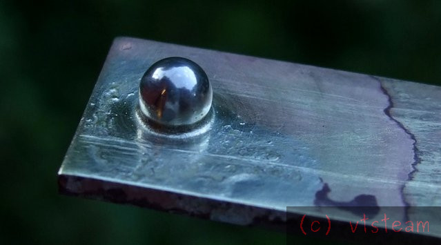

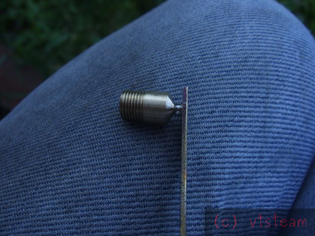

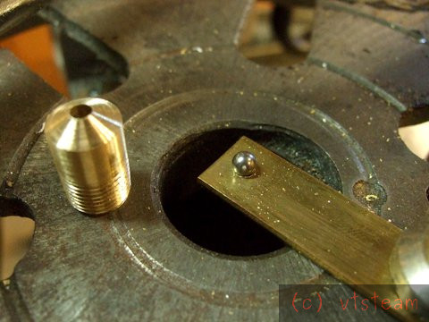

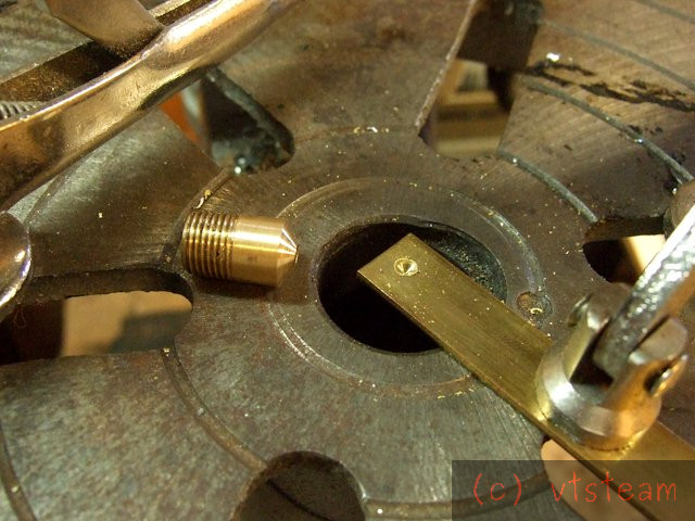

So today I was thinking about how to solder a stainless steel ball to a guide piece, without getting silver solder on the working valve portion of the ball. We're talking about a 5/32" diameter ball (4mm).
I didn't have much faith that I could manage a strong butt joint to thin wire, or keep the solder masked properly.
Then I thought of a possible way to do it with strip brass, so had to try an experiment:
Spotting with 1/8" drill -- new valve seat also shown:
« Last Edit: January 12, 2018, 10:20:55 PM by vtsteam »

The ball in place. The real question was whether I could solder something this small without getting solder in the wrong place.
« Last Edit: January 12, 2018, 10:21:39 PM by vtsteam »

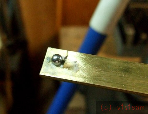

The setup for soldering. Flux paste and a tiny sliver of silver solder. I decided to heat from the bottom, as I was sure my torch would blow these bits right off the brass strip:
« Last Edit: January 12, 2018, 10:22:17 PM by vtsteam »
  • Posts: 6941
Re: Popular Mechanics Boiler
« Reply #13 on: July 20, 2014, 08:20:35 PM »

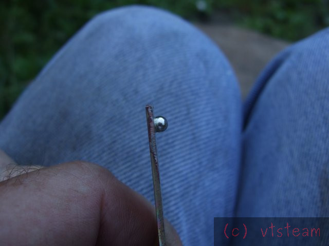

It worked!  :ddb:
I did have to steer the silver with a tiny bit of wire because the flux boiled and moved it away from the ball. But it did work.
Here's a close-up outside in stronger light:
« Last Edit: January 12, 2018, 10:22:54 PM by vtsteam »

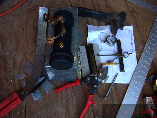

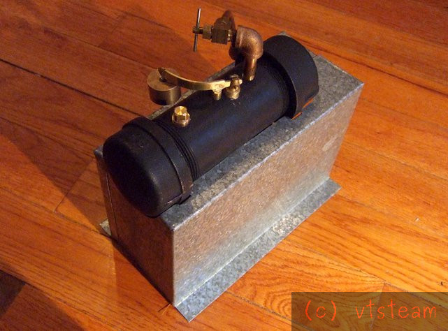

Today was Fun With Sheet Metal Day! I managed only one small cut on the back of the thumb.....I did everything with snips and a couple of pieces of angle iron clamped in the vise by way of a bending brake. The boiler base came together surprisingly well, for me. I have hardly ever worked in the stuff, and this was pretty heavy gauge metal I had lying out back. A good day!  :beer:
« Last Edit: January 12, 2018, 10:26:03 PM by vtsteam »
