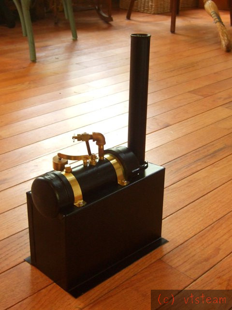

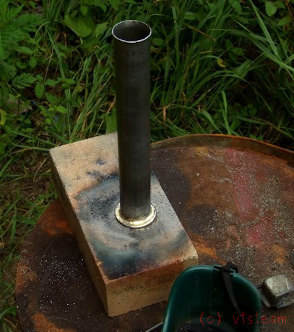

Hi Tom, I don't think I'm going to have a problem with misalignment, but probably best to make it first and talk about it afterward.
Today I didn't have much time to work on the boiler, but I did make a smokestack. I used a piece of fence post brazed to a bit of 1/8" plate that I had turned into a washer to fit. That's for a mounting flange.

By afternoon I had some paint on it and mounted the chimney. Now thinking about the firebox and door.
« Last Edit: January 12, 2018, 10:28:44 PM by vtsteam »

VERY flashy  :thumbup:
The heat losses on a design like that must be a high proportion of the input power. No real possibility of lagging, and a long response time due to the relatively thick wall of the boiler.
Looks the business though  :bow: :bow:
  • Posts: 6941
Re: Popular Mechanics Boiler
« Reply #28 on: July 23, 2014, 04:04:48 PM »
There's a copper coil under the boiler, and the inside of the firebox will be insulated. Not shooting for high efficiency, though, just playing.  :beer:

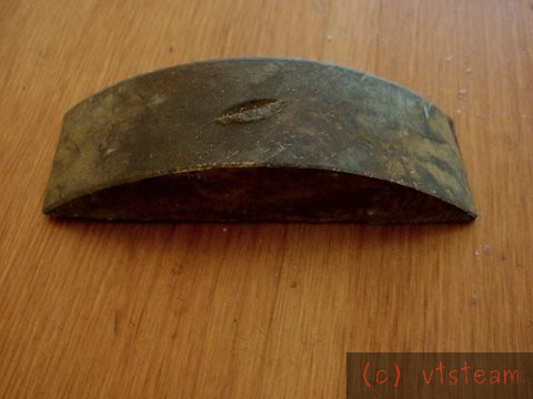

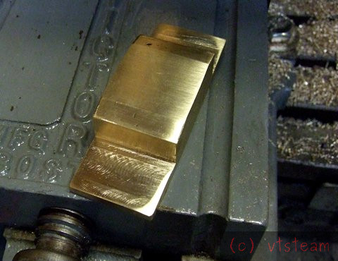

Not much time today for fun stuff, but I did make a start on a hand pump. Rummaging around in my scrap barrel, I found this cutoff of what I think is brass. Could be bronze, I'm not sure. I have a small half nail keg of stuff like this -- mixed brass, bronze, and sintered bronze material that I got in an auction (real, not online) at a closed Hayward-Tyler machine shop.
Anyway, I thought this might work as a base:

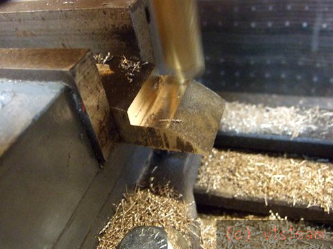

Milling a foot:

And ended up with a blank for the base by supper time. Haven't quite decided how I'm going to do this pump yet, guess I'll figure it out tomorrow!   :scratch:  :coffee:

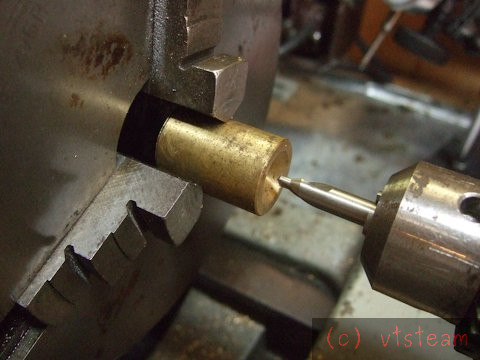

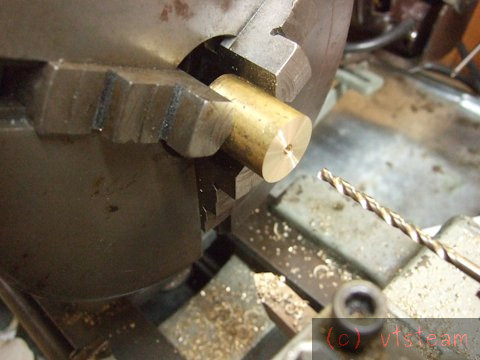

I guess you could Tom, but I made a free ball check valve today.
Here's how:
I started with about a one inch length of 3/4" round -- another scrap piece from my nail-keg 'o brass. Center drilled,
« Last Edit: January 12, 2018, 10:33:36 PM by vtsteam »

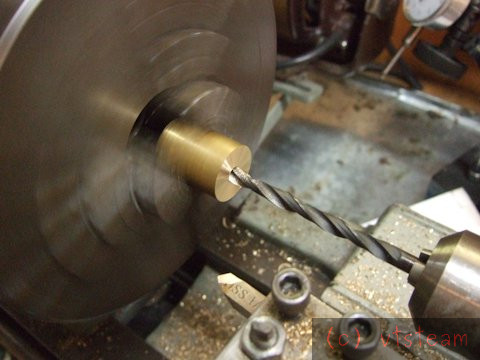

Then drilled 1/8" through:
« Last Edit: January 12, 2018, 10:34:13 PM by vtsteam »

Widened out one end to 7/32" for a depth of 0.75":
« Last Edit: January 12, 2018, 10:34:47 PM by vtsteam »

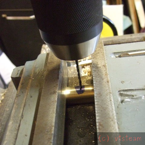

Then I put a 3/16" ball in the wide end, and checked the depth. I wanted the ball to have 1/32" free movement to a cross pin  which was to be made of .092" dia. stock -- a bit of brazing rod. I worked out the center location for the pin and cross drilled it in the mill:
« Last Edit: January 12, 2018, 10:35:27 PM by vtsteam »

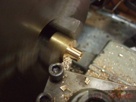

« Last Edit: January 12, 2018, 10:36:05 PM by vtsteam »

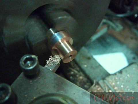

And the other end also to .375":
