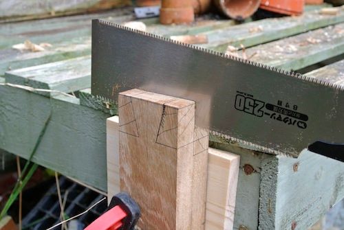

Once I was happy with it, I marked centre lines down all faces and marked the top (it could have been the bottom, but what’s a top or bottom between friends?;
http://i617.photobucket.com/albums/tt252/RossJarvis/Japanese%20Joint%201/subset1/_DSC3292.jpgI thought I'd try a Japanese joint!
Then “BONSAI” I attacked it with the saw and cut it in half (why do the Japanese rush into battle shouting ’small trees’?);
http://i617.photobucket.com/albums/tt252/RossJarvis/Japanese%20Joint%201/subset1/_DSC3293.jpgI thought I'd try a Japanese joint!

http://i617.photobucket.com/albums/tt252/RossJarvis/Japanese%20Joint%201/subset1/_DSC3295.jpgI thought I'd try a Japanese joint!
If you look closely you can see a bit of a miscockulation!  I generally use an edge for reference when marking out, but apparently the traditional way is to use the centre-line for this sort of thing, so maybe that threw me.  Back out to the “workshop” and time for a bit of ripping;
http://i617.photobucket.com/albums/tt252/RossJarvis/Japanese%20Joint%201/subset1/_DSC3296.jpgI thought I'd try a Japanese joint!
