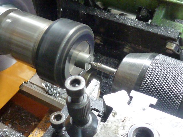

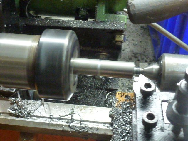

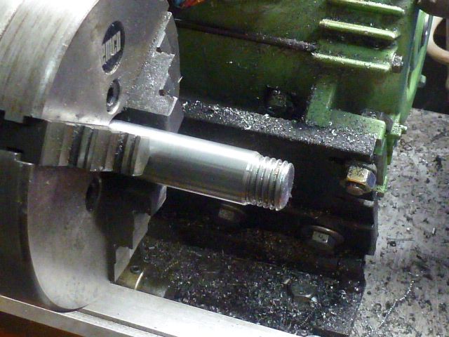

The top slide on the lathe still being  set up with the taper (about 20°) it's a good place to start.
http://i917.photobucket.com/albums/ad16/mattinker/gear%20carrier/gearcarier3_zps9a07b89a.jpgDividing head

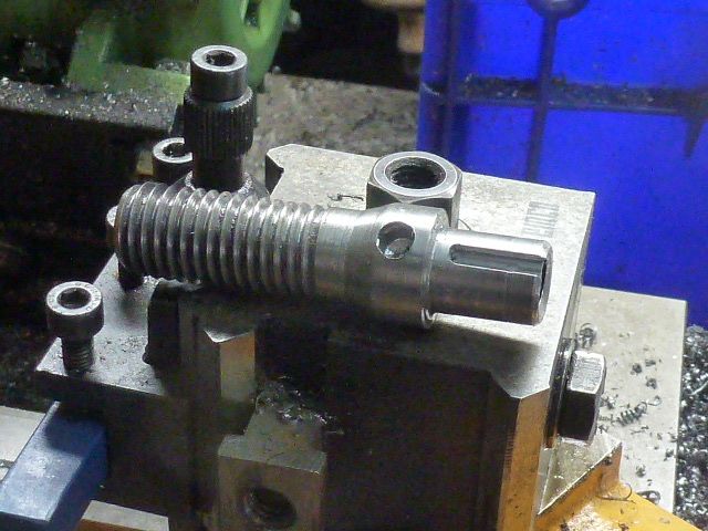

By turning the end of the 17mmØ down to 14mm and flipping it round, I could then cut the taper in the same direction as it was cut on the inside of the spindle.
http://i917.photobucket.com/albums/ad16/mattinker/gear%20carrier/gearcarier5_zps6f0c15df.jpgDividing head

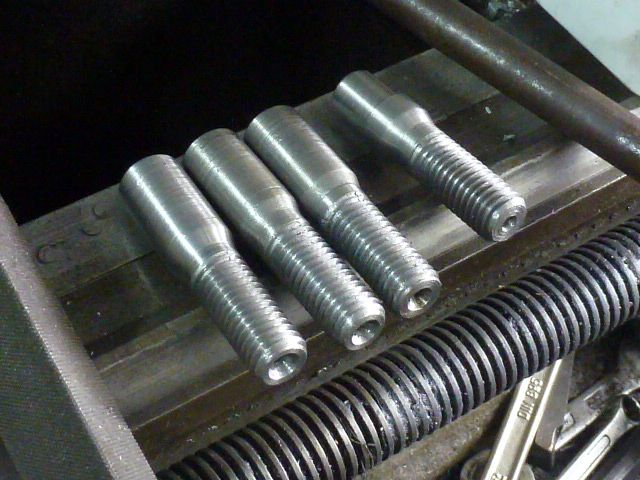

Cutting the M14 thread. I made four as who knows what gears might turn up in the future!
http://i917.photobucket.com/albums/ad16/mattinker/gear%20carrier/gearcarier6_zps1e00e700.jpgDividing head
Three blanks plus the one that I already  reduced to 14mm.

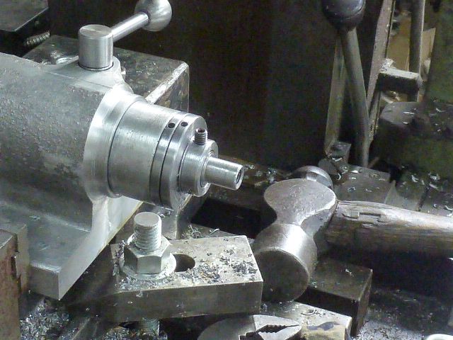

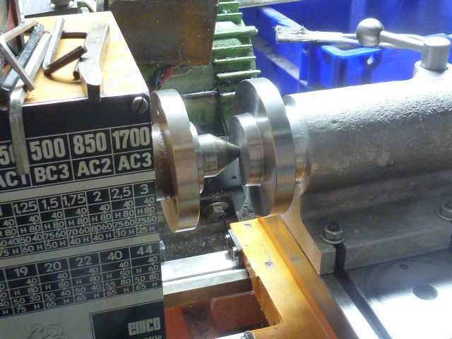

I set the spindle up in the fixed steady to use it as a mandrel to reduce the ends of the carriers and to drill and tap to M8 for the gear retaining bolt.
http://i917.photobucket.com/albums/ad16/mattinker/gear%20carrier/gearcarier8_zps6dc34467.jpgDividing head

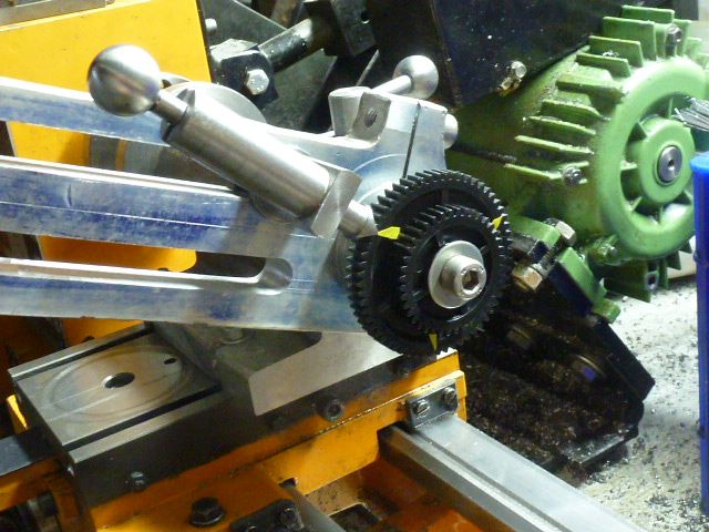

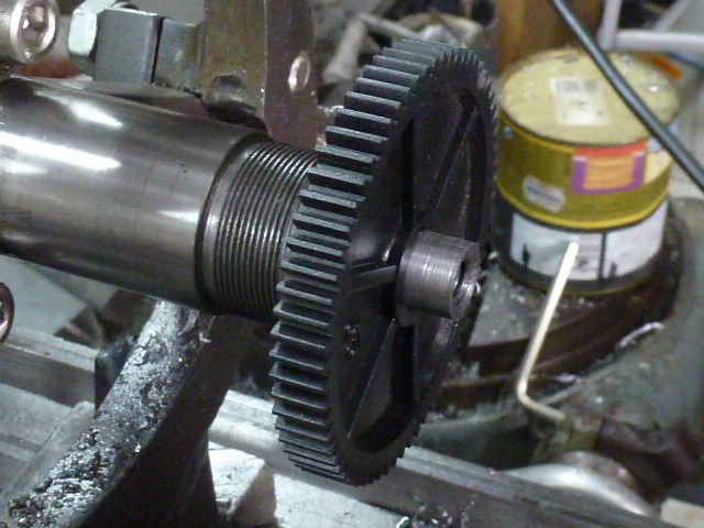

The 12mm carrier test with a plastic gear!
http://i917.photobucket.com/albums/ad16/mattinker/gear%20carrier/gearcarier9_zps4f024aa4.jpgDividing head

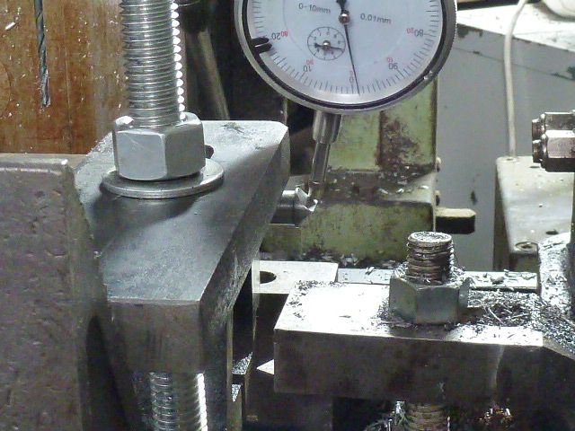

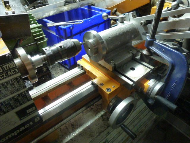

With the spindle once again set up in the dividing head, I centred with a centre finder and centre drilled for an M6 thread.
http://i917.photobucket.com/albums/ad16/mattinker/gear%20carrier/gearcarier10_zpsc88706f3.jpgDividing head
Without moving the setup, I drilled all of the carriers 5mm .
http://i917.photobucket.com/albums/ad16/mattinker/gear%20carrier/gearcarier11_zpsbb4a8e63.jpgDividing head

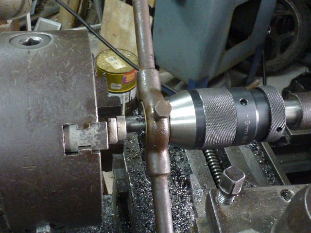

Tapping the spindle M6.
http://i917.photobucket.com/albums/ad16/mattinker/gear%20carrier/gearcarier12_zps2b93ec1b.jpgDividing head

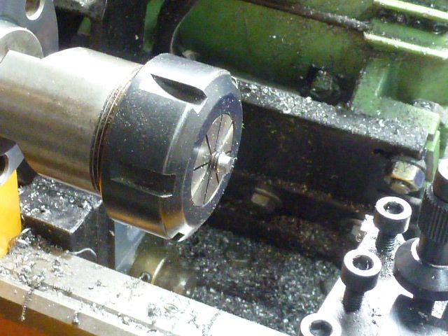

The drive belts arrived today, now I can use that nice precise little three jaw and the power feed again!
http://i917.photobucket.com/albums/ad16/mattinker/gear%20carrier/gearcarier13_zps7d22b3eb.jpgDividing head

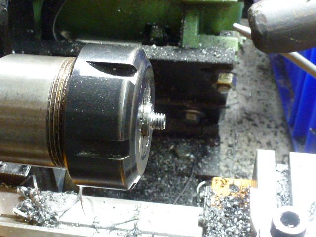

In addition, I can use my ER32 collets, handy when shortening and reducing grub screws.
http://i917.photobucket.com/albums/ad16/mattinker/gear%20carrier/gearcarier14_zps595c093e.jpgDividing head
Grubscrew, now there will be two Allen key sizes  on the dividing head.
http://i917.photobucket.com/albums/ad16/mattinker/gear%20carrier/gearcarier15_zps9b906b8b.jpgDividing head
The finished product, just needs deburring. I forgot to take pictures of cutting the keyways. I was nervous, having never cut 3 and 4mm keyways with a 2mm slot drill before, my mill seems enormous with that tiny little end mill in it! No problems encountered!
http://i917.photobucket.com/albums/ad16/mattinker/gear%20carrier/gearcarier16_zps0f1fd411.jpgDividing head

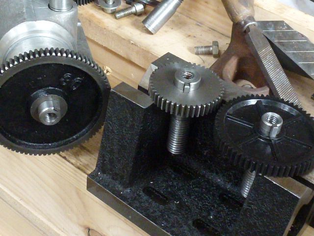

The three carriers finished with their respective gears and keys.
I may soft solder the keys in place so that they don't get lost.

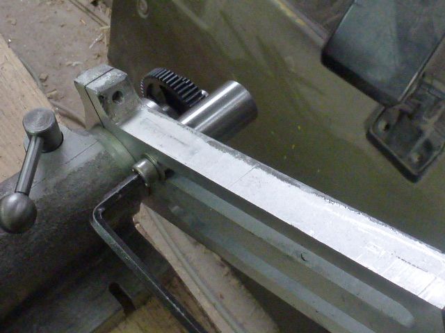

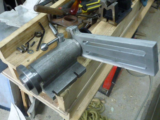

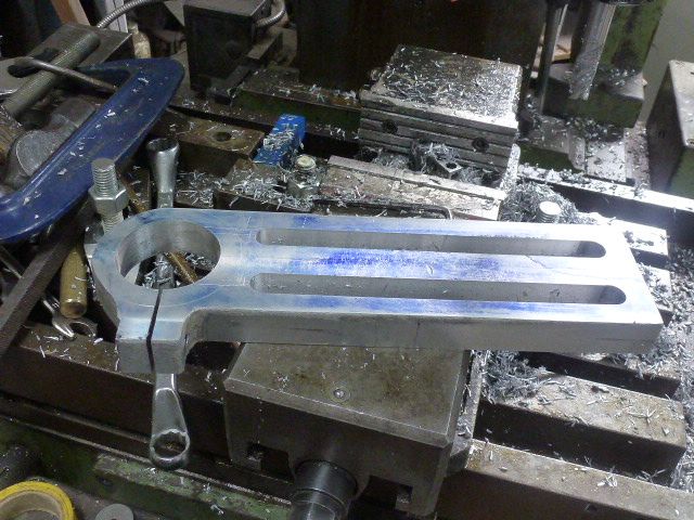

http://i917.photobucket.com/albums/ad16/mattinker/banjo%20slots/banjoslots1_zpsbf035c2f.jpgDividing head

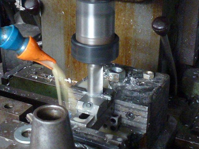

With the gear carriers done, I can get on with the Banjo. Spot the mistake!

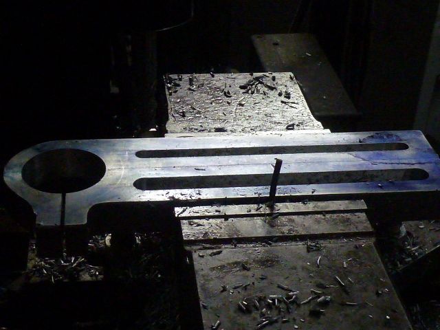

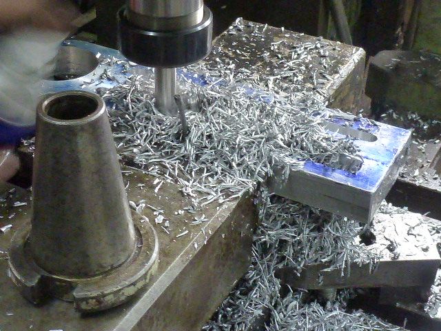

http://i917.photobucket.com/albums/ad16/mattinker/banjo%20slots/banjoslots2_zpsc3cfd458.jpgDividing head

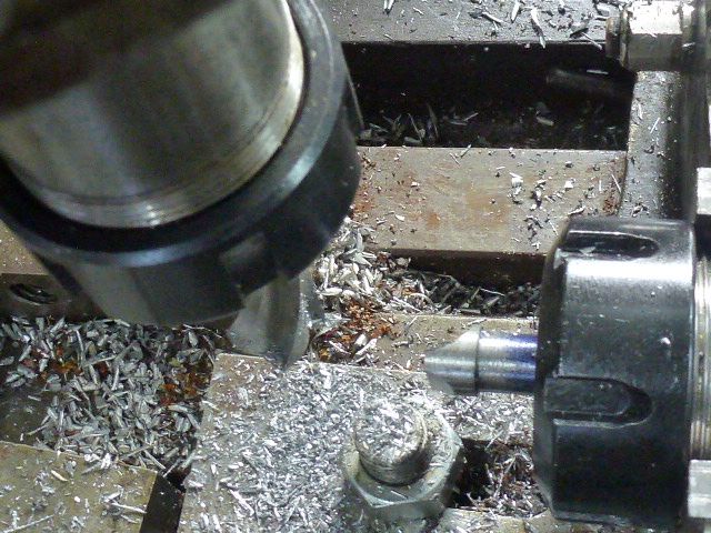

Carving out the slots.
http://i917.photobucket.com/albums/ad16/mattinker/banjo%20slots/banjoslots4_zps7645f35e.jpgDividing head
The set up is flawed, having not tried to cut slots this way before, I hadn't thought about the fact that I was squeezing up on an area that I was removing metal from!
http://i917.photobucket.com/albums/ad16/mattinker/banjo%20slots/banjoslots5_zps1a35baea.jpgDividing head
The Banjo gently started to rise in the vice, no damage, but another reminder about how to set up!
http://i917.photobucket.com/albums/ad16/mattinker/banjo%20slots/banjoslots6_zps18f006cf.jpgDividing head
The slots are finished, Al that the Banjo needs is a clean up and chamfer.

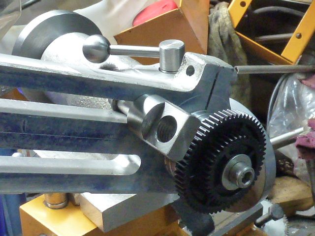

the next chapter is the plunger assembly.
http://i917.photobucket.com/albums/ad16/mattinker/plunger%20assembly/plungerassembly1_zps1276b602.jpgDividing head
A piece of 25mm cold rolled is reduced to 12mm over a length of 20mm.
http://i917.photobucket.com/albums/ad16/mattinker/plunger%20assembly/plungerassembly2_zpsd02c8694.jpgDividing head

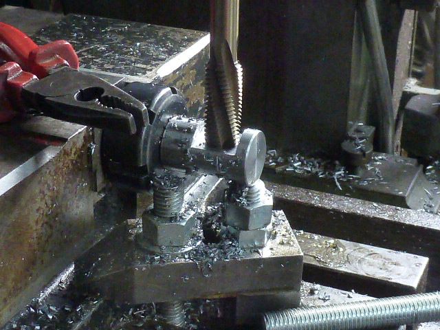

Drilled 6.75mm, tapping size for M8 and tapped  to a depth of 25mm.
http://i917.photobucket.com/albums/ad16/mattinker/plunger%20assembly/plungerassembly3_zps5ffa8334.jpgDividing head
This allows fixing in either slot of the banjo.
http://i917.photobucket.com/albums/ad16/mattinker/plunger%20assembly/plungerassembly4_zpscb83c975.jpgDividing head

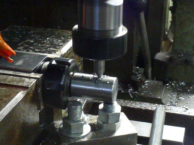

The centre is found and a centre hole drilled.
http://i917.photobucket.com/albums/ad16/mattinker/plunger%20assembly/plungerassembly5_zps8682ea6f.jpgDividing head
Pilot drilled.
http://i917.photobucket.com/albums/ad16/mattinker/plunger%20assembly/plungerassembly6_zps9b4c6f39.jpgDividing head

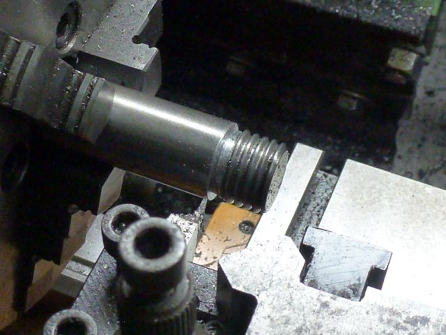

Plunger body, reduced and threaded M16.
http://i917.photobucket.com/albums/ad16/mattinker/plunger%20assembly/plungerassembly12_zps7dfb0228.jpgDividing head
Shoulder turned at the end of the thread to allow to seat on it's support.

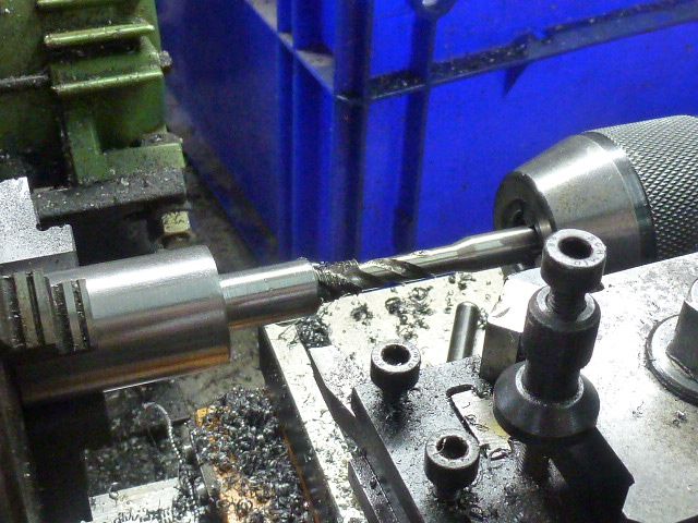

Drilled through 7mm.
http://i917.photobucket.com/albums/ad16/mattinker/plunger%20assembly/plungerassembly14_zpsd2daf7df.jpgDividing head

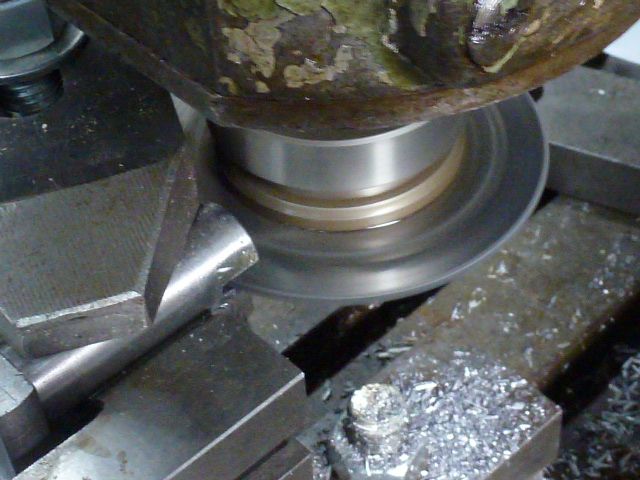

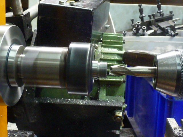

I haven't got a 10mm reamer yet, so I used a 10mm Slot Drill to drill the larger diameter in the plunger housing.

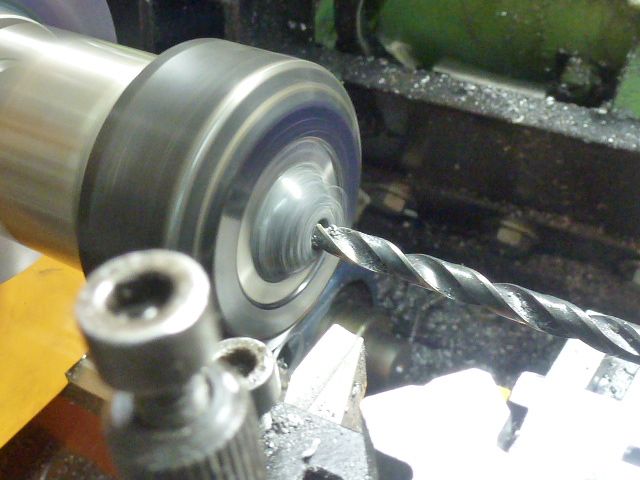

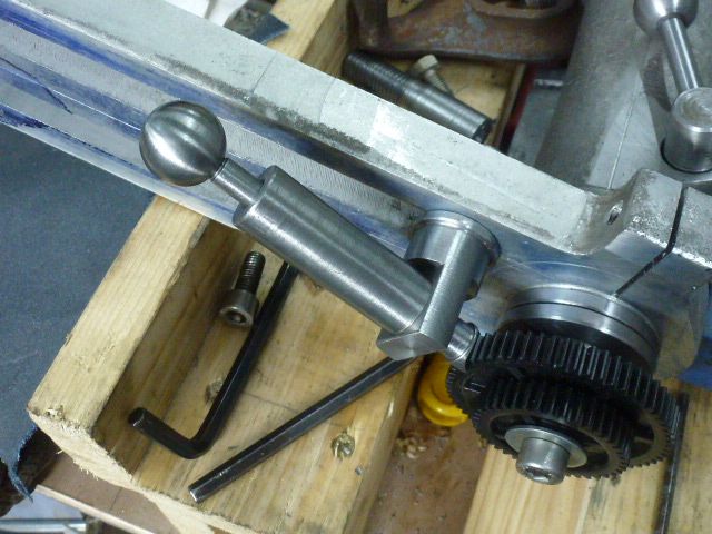

Centre drilling and drilling an annealed ball bearing to make the handle for the plunger.
http://i917.photobucket.com/albums/ad16/mattinker/plunger%20assembly/plungerassembly19_zps5af84c5a.jpgDividing head

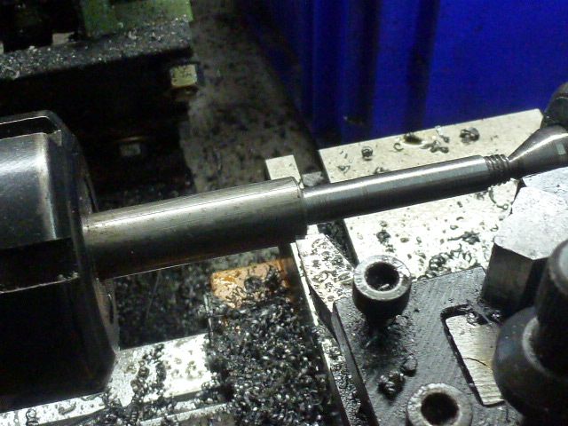

Centre drilling a piece of 12mm cold rolled to make the plunger.
http://i917.photobucket.com/albums/ad16/mattinker/plunger%20assembly/plungerassembly20_zps5089d6c6.jpgDividing head
First opperation, reduced to 6mm in diameter and threaded M6 to accept the ball bearing.
http://i917.photobucket.com/albums/ad16/mattinker/plunger%20assembly/plungerassembly21_zps4b3072a6.jpgDividing head
Preparing to reduce the plunger to 7mm and 10mm diameters.
http://i917.photobucket.com/albums/ad16/mattinker/plunger%20assembly/plungerassembly22_zpsadfb0472.jpgDividing head
7mm
http://i917.photobucket.com/albums/ad16/mattinker/plunger%20assembly/plungerassembly23_zps294c0ba2.jpgDividing head

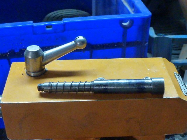

Spring winding, thanks Tom Griffin for your recent video contribution! I ended up making 3 mandrels, the first, 7mm, produced a spring that was nearly twice the mandrel diameter, A 4mm one was well undersized, a 6mm would have been best, but I made a 5mm mandrel as I had some 5mm in stock. I had to open up the coils slightly by hand. I got good results from 6thenths of a mm piano wire.
http://i917.photobucket.com/albums/ad16/mattinker/plunger%20assembly/plungerassembly24_zps071f7897.jpgDividing head
Plunger with it's spring.
http://i917.photobucket.com/albums/ad16/mattinker/plunger%20assembly/plungerassembly26_zps8aca563d.jpgDividing head
Milling the plunger point. I used a 17mmØ mill, which was as rear as I could get to the radius of the gear teeth.
http://i917.photobucket.com/albums/ad16/mattinker/plunger%20assembly/plungerassembly27_zps9a440867.jpgDividing head
The fit is reasonable, especially bearing in mind that the radii change with the diameter of the gears.
http://i917.photobucket.com/albums/ad16/mattinker/plunger%20assembly/plungerassembly28_zps7e527459.jpgDividing head
Plunger assembly nearly finished.
http://i917.photobucket.com/albums/ad16/mattinker/plunger%20assembly/plungerassembly29_zpsb00da5ea.jpgDividing head
Lining up the plunger body to slot the guide.
http://i917.photobucket.com/albums/ad16/mattinker/plunger%20assembly/plungerassembly31_zpsce3ee1aa.jpgDividing head
Slotting the plunger.
http://i917.photobucket.com/albums/ad16/mattinker/plunger%20assembly/plungerassembly32_zpsc16531b9.jpgDividing head

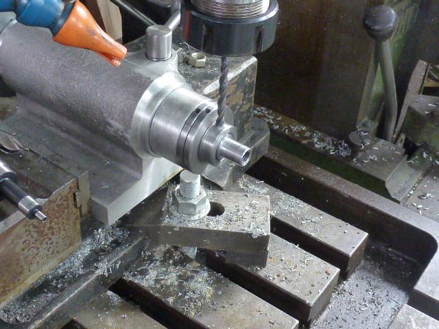

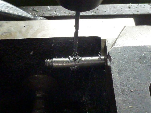

Dialling in the plunder to drill for the pin at right angles to the point.
http://i917.photobucket.com/albums/ad16/mattinker/plunger%20assembly/plungerassembly33_zps9a5fecd3.jpgDividing head
Centre drilling the plunger.
http://i917.photobucket.com/albums/ad16/mattinker/plunger%20assembly/plungerassembly34_zpsde0f81ea.jpgDividing head
Drilling plunger, 2.5mm.
http://i917.photobucket.com/albums/ad16/mattinker/plunger%20assembly/plungerassembly35_zps00f556f9.jpgDividing head

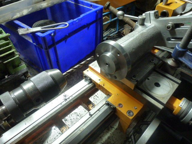

In place on the lathe.
http://i917.photobucket.com/albums/ad16/mattinker/plunger%20assembly/plungerassembly36_zps32154a29.jpgDividing head
http://i917.photobucket.com/albums/ad16/mattinker/plunger%20assembly/plungerassembly37_zps4a8bd199.jpgDividing head
http://i917.photobucket.com/albums/ad16/mattinker/plunger%20assembly/plungerassembly38_zps5d9a0779.jpgDividing head
Drilling the spindle.
http://i917.photobucket.com/albums/ad16/mattinker/plunger%20assembly/plungerassembly39_zps21cfbe8f.jpgDividing head
Final drilling.
http://i917.photobucket.com/albums/ad16/mattinker/plunger%20assembly/plungerassembly40_zpsee684db8.jpgDividing head

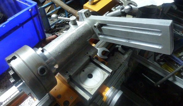

The chuck in place, one of those nice moments!
Nearly finished! To be continued.
