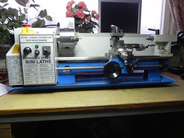

I brought my lathe in January this year and I have had a good time with it, but now it's dead.  :(
http://i1123.photobucket.com/albums/l558/Benni_Svensson/Error/svarv.jpgMy lathe is dead
The modell name is: JC0618A
What was happening? I don't know, I took some turn on the lathe, and then stop, then I should take some more turns, and nothing happend.  :Doh: .
I took some help from my son i law, he is working as a  reparatur and installer for plasma and laser cutting machines, so I thought that he could help me. We found out that the potentiometer was broken so I order one from http://littlemachineshop.com/.
Today I'll got the item, mount it and bang, it was an short circuit  :( :( :( .

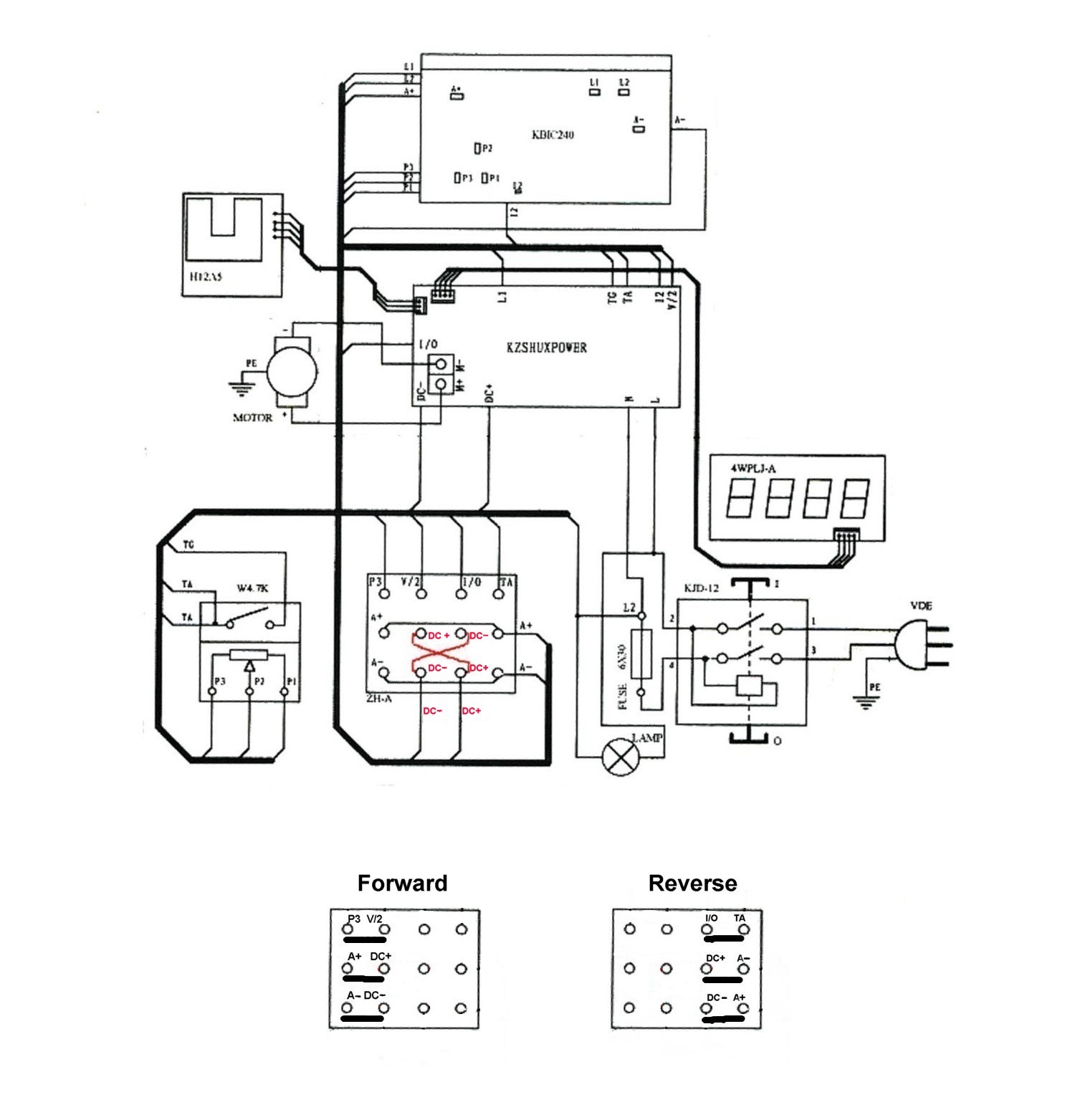

The only wiring diagram I found (I can't find any one) was this:
http://i1123.photobucket.com/albums/l558/Benni_Svensson/Error/IMG.jpgMy lathe is dead
And this don't say anything, it's not helpfull. What to do ???  :zap:

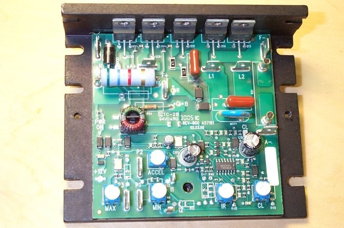

Offline John Swift
  • Posts: 344
Re: My lathe is dead
« Reply #7 on: November 14, 2011, 06:15:35 PM »
Hi benni
which board is damaged
is it the KB electronics speed control as in the picture ?

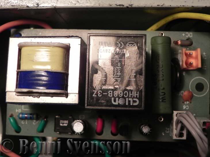

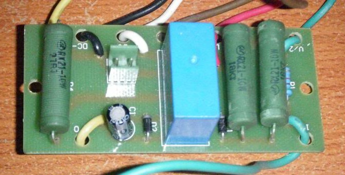

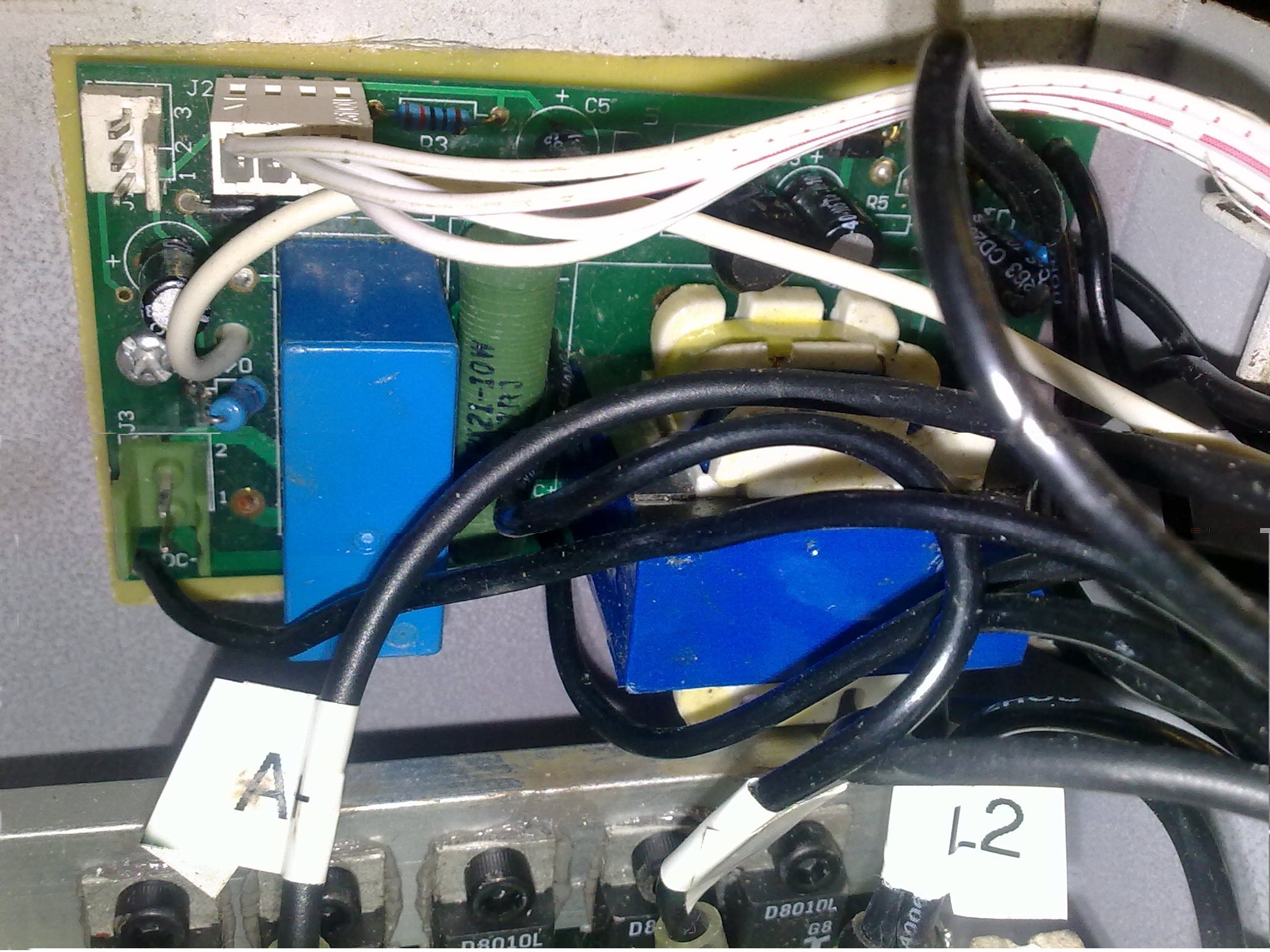

This is some photos of my board:
 http://i1123.photobucket.com/albums/l558/Benni_Svensson/Error/DSCN0589.jpgMy lathe is dead http://i1123.photobucket.com/albums/l558/Benni_Svensson/Error/DSCN0587.jpgMy lathe is dead
When I talked to my supplier, he told me that it was a chance that he had the whole controll panel, if so I'm in haven.  :D

  • Posts: 2554
« Reply #10 on: November 15, 2011, 07:12:47 AM »
Looks like a KBIC controller....I'd be surprised if it was faulty, they are usually pretty reliable..
But if your supplier comes across with a spare then thats a good result I'd say...
Even better would be if you got the whole lot and you got to keep the other parts..we could look to repairing the damage, then you may have spares for the future
Offline John Swift
  • Posts: 344
« Reply #11 on: November 15, 2011, 07:14:19 AM »
Hi Benni,
that's great , a replacement is the best solution
your  control board is a later version of the one in my picture
the surface mount components are more difficult to replace your self
   lets hope it's not too long before your using the lathe again
PS
looking at the wiring diagram
it looks like there is an error with the connections to the forward / reverse switch
take lots of pictures before you disconnect the old control

Offline pete3000
  • Posts: 23
  • Electronics, Computers and one day mechanics
« Reply #12 on: November 16, 2011, 09:11:12 AM »
Looking at the pictures you posted, I spotted a couple of potential points to look at. The red block top left is a double pole switch? em stop red button.
The blue wire shouldn't be floating it should possibly be connected opposite the brown. on the tab, perhaps the spade terminal has gone missing. I can't see enough to make sure but the mains should come in on flex brown= live, blue=neutral then enter switch.
live and neutral then leave the switch on two white wires? before going to the fuse and mains neon indicator. There is a split of wires covered in tape by the look of it with a live and neutral going to each pcb. This needs investigating to verify the mains supply. If the blue is floating and is touching or shorting to the case (earth) it will trip any rcd you have in the circuit in the house.
The other point is the pcb with the 14 pin chip looks to have a solder splash on the board at the bottom end of the chip? again can't really see.
The function of the two boards is quite simple,
the orange blue wires board is the start stop relay and a transformer to reduce 120v or 240v to the dc motor maximum voltage.
The other board is a pwm speed controller to generate pulsed dc from 0 to maximum duty cyle for the motor. This is done with the potentiometer and a pwm circuit which drives fet transistors. Reversing is done with the direction switch, which reverses the voltage to the motor.
Sorry if this is confusing, the good news is that it is very unlikley that the lathe is scrap unless the dc motor is burned out.
don't lose hope.
Do this in stages with other components isolated. Get the chap who knows to make sure the mains is safe and intact and then to put a meter across the motor + and - wire and take a reading. If it looks good you could try a powersupply or battery with a fuse to see if the motor will run at all. If this is all ok then the boards are next.
Start with the voltage dropper board and see if voltage is present on green wires may be ac/dc can't see a rectifier anywhere.
Then onto the pwm board. Get a replacement

Offline saw
  • Posts: 1003
  • lucky amateur
    • Svenssons AckordsWerkstad
« Reply #17 on: November 26, 2011, 07:31:22 PM »
sub-xtx: I saw it now, as you pointed out, it was a piece of solder. There I have not been and soldered. :bang:
John Swift: I have not yet tested A- and A  wires unplugged, but we have tested   the motor unplugged, and still the fuse breaks. :palm:

Offline sub-xtx
  • Posts: 5
« Reply #19 on: November 27, 2011, 05:09:07 AM »
You can try to disconnect main transformer and look for correct AC output. If you have a short in the trasformer, home energy drops.
I think you have the problem before entering the logic board.

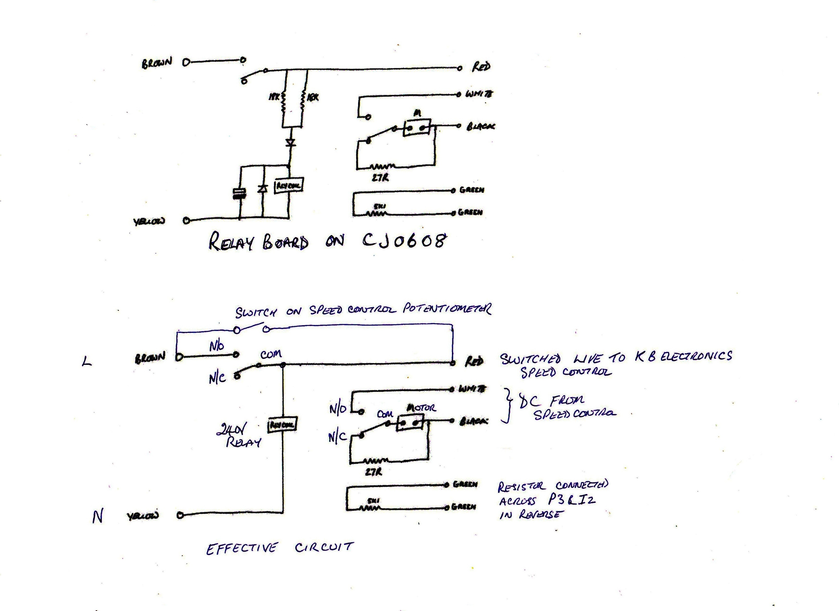

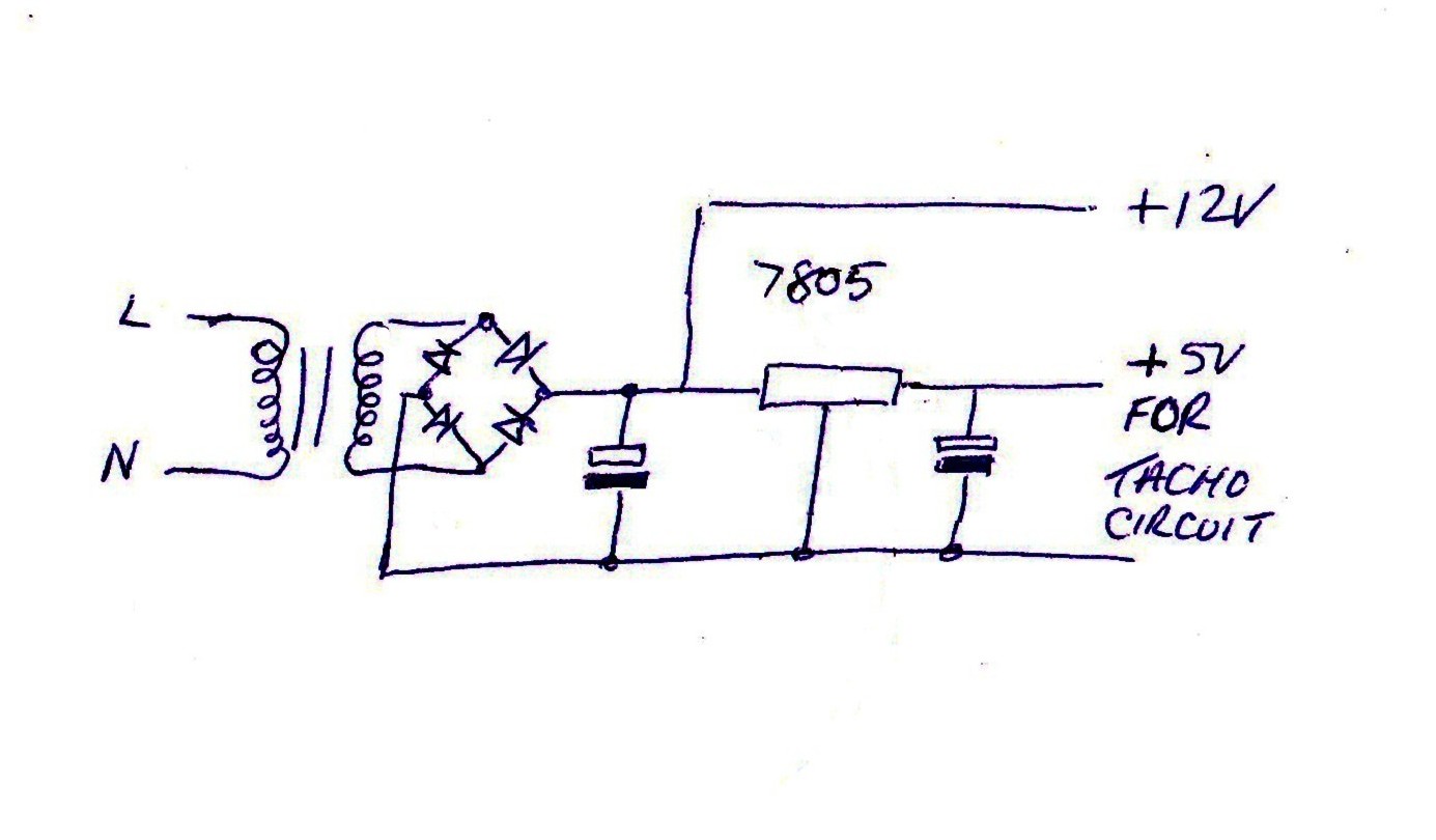

Offline John Swift
  • Posts: 344
« Reply #23 on: November 27, 2011, 10:44:38 AM »
Hi Benni ,
disconnecting the A- and A+ wires would only prove you had a fault in the motor or the DC wiring to it
if you unplug the L1 and L2 wires from the KB electronics speed control board
can test the relay and tacho powersupply board , you need to ensure the L1 and L2 wires are insulate
is it possible for you to post  pictures of both sides of the board with the transformer and relay
it will help to work out exactly the function of all the wires in the wiring diagram you have
from pictures of the board in another version of your lathe without the tacho
I've drawn the circuit that will be similar to your board but without the transformer and 5V supply circuit
the switch on the speed control potentiometer is closed with the control fully anti clockwise  (minimum speed)
once the relay is energised , the contact in parallel with the switch maintains the power when
you increase the speed
with the power switched off the second relay contact connects a 27 ohm resistor across the motor
to reduce the speed quickly
with the power on ,the relay contact connects the motor to the KB speed control DC output
 via the forward / reverse switch

Hi John.
Here is photo as you wanted
 http://i1123.photobucket.com/albums/l558/Benni_Svensson/Error/DSCN0591.jpgMy lathe is dead http://i1123.photobucket.com/albums/l558/Benni_Svensson/Error/DSCN0591.jpgMy lathe is dead
As you can see the connections to the motor is unconnected, I hope that this can help
