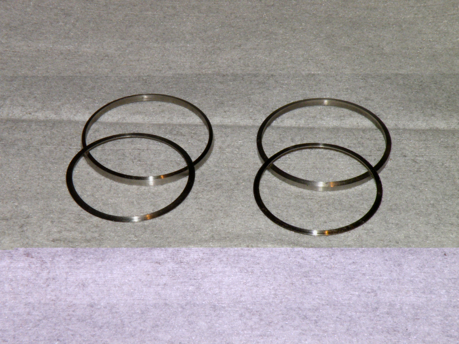

Thanks for machining the replacement Tag Heuer Bezel John the watch now looks decent. :thumbup:
http://img141.imageshack.us/img141/2358/tgl.jpgBIG Thanks To Bogs aka John Moore!
http://img714.imageshack.us/img714/1312/tgl2.jpgBIG Thanks To Bogs aka John Moore!
http://img826.imageshack.us/img826/294/tgl3.jpgBIG Thanks To Bogs aka John Moore!
Old knackered bezel:-
http://img560.imageshack.us/img560/4788/tgl4.jpgBIG Thanks To Bogs aka John Moore!

« Reply #4 on: February 07, 2011, 06:26:30 PM »
Chris,
As this was a private request, I don't normally take pics of the processes, just the finished article.
But a quickie explanation.
The internal dimensions and boring to fit the crystal OD was all done on the original stainless bar held in the chuck. It was then parted off and turned around. It was then held with an expanding 5C mandrel turned to size to fit the inside dimensions of the bezel. I was then able to put the two outside tapers on.
I hope that helps

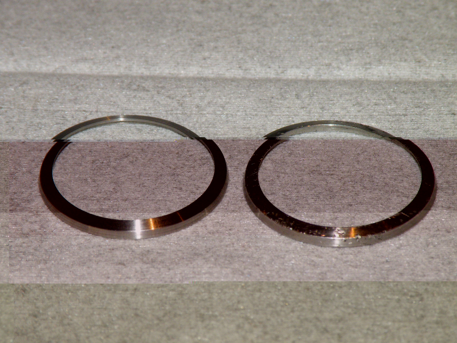

« Reply #8 on: February 08, 2011, 01:42:55 PM »
Bernd,
Not long at all, purely because when I was doing it, I prepared the bar to do another couple just in case something went wrong.
Because there was double angle being used on the outside, and it was a very complicated shape to measure up on the inside without a comparator microscope (which I don't possess), I actually cut slightly too deep on the inside for the first couple of attempts, but the third was spot on, with plenty of meat left on the inside.
The pic shows what happened with the first two.
BTW, between each one was only about 20 mins.
Added.
In fact the stainless bar (I have forgotten the material number, that was supplied by Bry) is still under my lathe, and still mounted in the chuck. Now that I know everything was successful, I can now take it out of the chuck and put it away somewhere safe just in case another one like this comes up.
