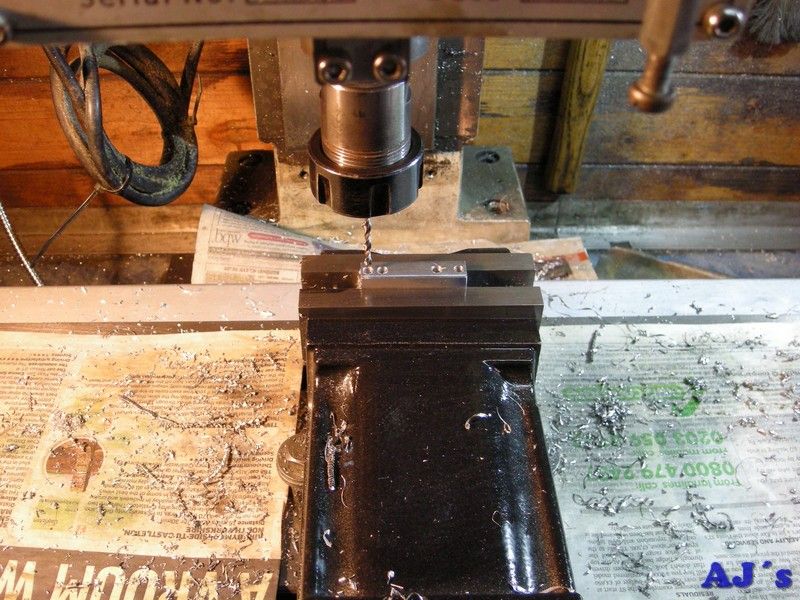

For the Y-axis, with the moving saddle on top had to design a couple of brackets to get things working and the scale protected.  Because the mounting surfaces on the mill are not flat or square the brackets were designed to have jacking screws at the corners.
http://i519.photobucket.com/albums/u356/dozerd10/Workshop/Projects/MillDRO/Image00056.jpgFitting a DRO to my Weiss WMD30LV mill.
A couple of pieces of 10mm ally plate were milled square and to size.
http://i519.photobucket.com/albums/u356/dozerd10/Workshop/Projects/MillDRO/Image00016.jpgFitting a DRO to my Weiss WMD30LV mill.
Holes were located and drilled.
http://i519.photobucket.com/albums/u356/dozerd10/Workshop/Projects/MillDRO/Image00017.jpgFitting a DRO to my Weiss WMD30LV mill.
http://i519.photobucket.com/albums/u356/dozerd10/Workshop/Projects/MillDRO/Image00018.jpgFitting a DRO to my Weiss WMD30LV mill.
http://i519.photobucket.com/albums/u356/dozerd10/Workshop/Projects/MillDRO/Image00019.jpgFitting a DRO to my Weiss WMD30LV mill.
