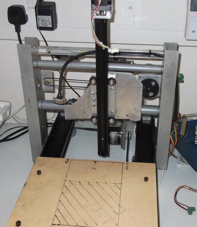

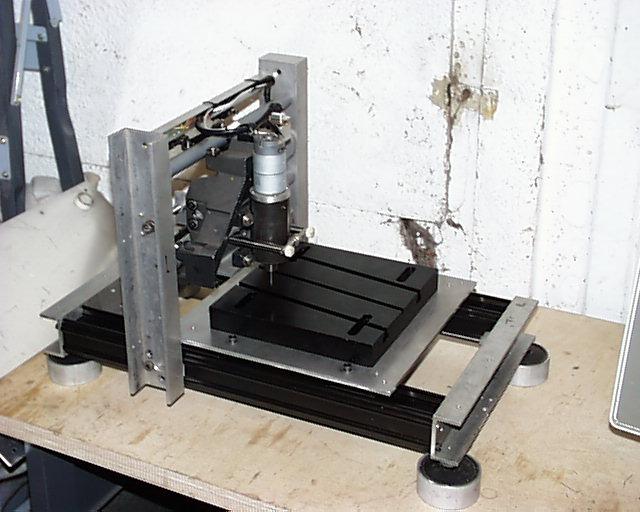

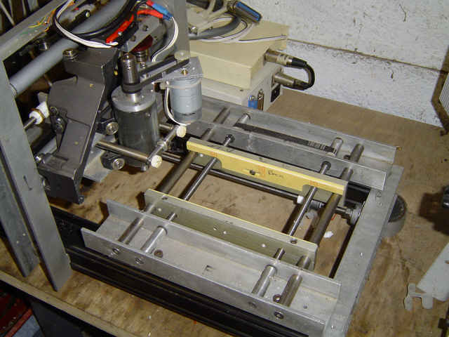

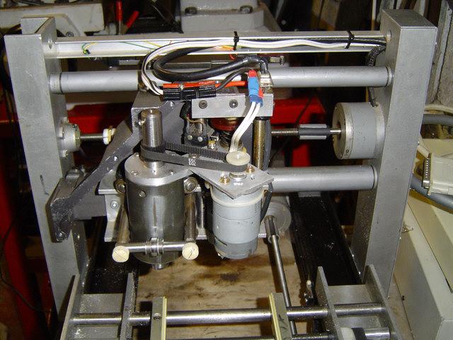

Inspired by Joules and the other guys with their 3D printers , I have decided to see if I can modify a machine I built toward the end of the last millennium into a 3D printer.
The machine was knocked up in the 80's (many many mods) from bits of an old Repro-Graphic  camera and just about anything I had laying around, with only a drill press and a x-vice.   I had initially hoped it could do light milling but it was only really capable of rather slow engraving.
I'll have to re-jig the X & Y axes : ATM they are driven by M8 screws in backlash free PTFE nuts and will be far too slow for a printer.  Although I have a length of 4mm pitch lead-screw which would be a simple fix . I think I'll just spin the motors around and use timing belts
I'll have to build a new Z axis but I've plenty of bits that I can use .
The electronics are housed in an old 5 1/4"  external drive box  (the modules were originally  mounted in a PC AT desktop case. With great foresight, I added four stepper drivers.
I have a PC configured with LinuxCNC to drive the thing (the first version ran on DOS based DANCAM ). I think a move to an arduino based REPRAP controller would be the best option , (but are they configurable for step/mm acceleration etc. ?)

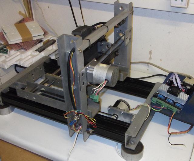

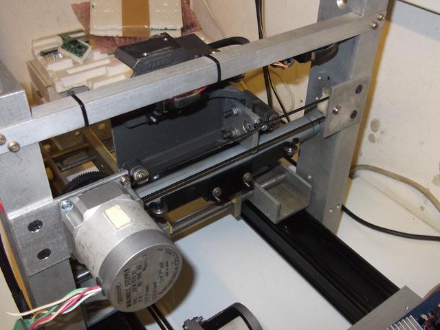

I'm finding it difficult to find time to do this... However, I did manage to get the belt drive X axis sorted today. I'm getting about 150mm/s &  >2000mm/s/s acc reliably which I hope should be OK.
I'm stil not sure whether to go for a Aduino RAMPS controller  or to try a LinuxCNC version with the bits I have first ,  If it looks like it functions OK,  then I may splash out on a Duet board (if i can find one)
Pictures will follow later
  • Posts: 1225
Re: Homebrew engraver to 3D printer Mod
« Reply #11 on: February 08, 2016, 03:51:35 PM »
OK Bodged converted the X and Y axes to belt and they're working . I've decided to swap the X&Y so the longer axis is Y so that it'll take up a narrower slot on the bench.
ATM I have the 'vice' attached where a bed will go. Somewhere (in some long forgotten place) is a 6mm ally plate that will fit the bolt holes. However....
What is the best material for the bed?  -  I have a selection of ally plate 4-12mm , some perspex ( 5 & 8mm) , a sort-of 'paxolin' fibre plate (~4mm) that maybe too flexible (would need strengtheners)  but is light and would take heat . Ultimately I want a heated glass plate for ABS .

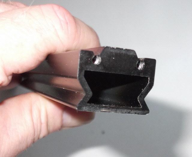

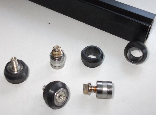

I've been looking at making the all new Z axis . I have a another piece of type-setter extrusion (same as the slides above) and a few bearing assemblies from old HDDs . I've made nylotron tyres for the bearings and am just in the process of CADing something together.

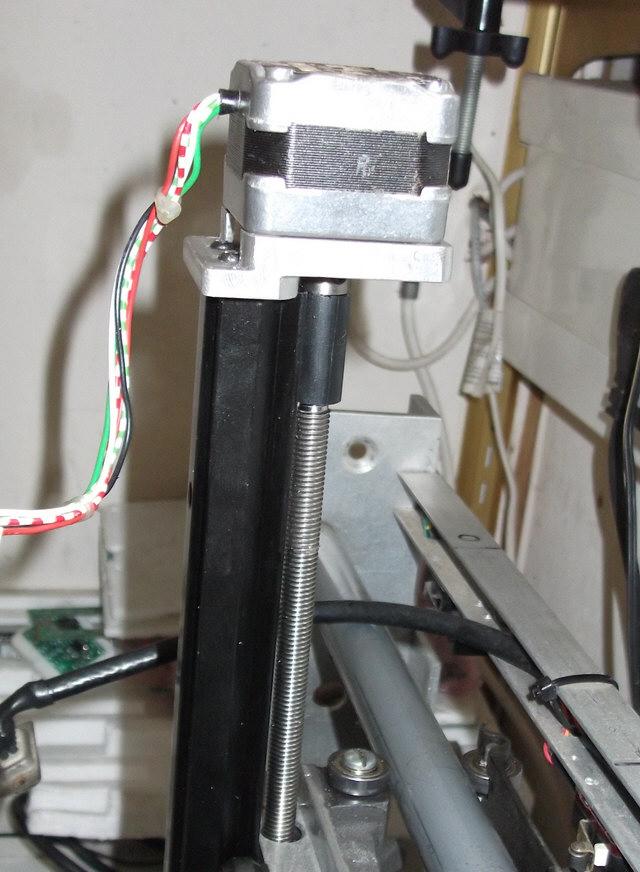

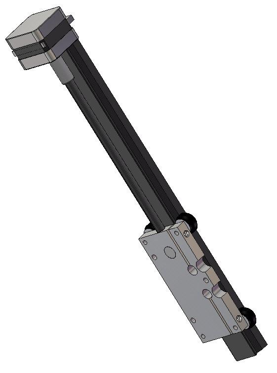

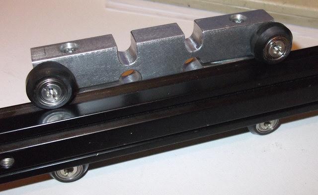

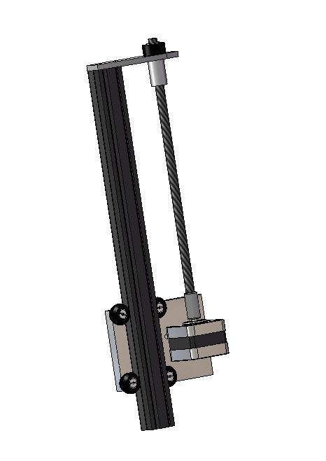

« Reply #14 on: February 11, 2016, 04:33:08 PM »
Not too much achieved today.
I managed to take the X axis slide off , cut the excess aluminium off to make it flat , ready to take the new Z axis.
I have decided to mount the Z motor on top of the Z slide so that the screw now goes down with the axis rather than sticking up in the air
Attached is a back view of the latest design idea:  The screw goes into a hole through the back of the mounting plate where it screws into a PTFE nut .  Two of the rollers are mounted on flextures which can be adjusted to close any play to the extrusion.
Still not sure what to do about extruder and hot end  ?   I may have a go at making them   . What are the panls thoughts on Bowen verses direct mounted drive?

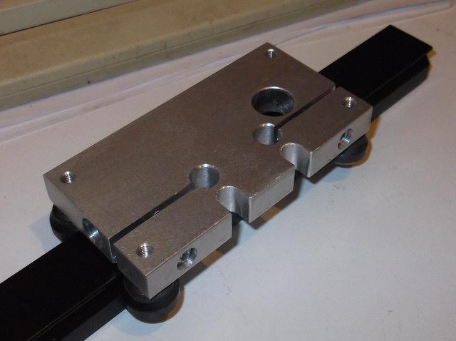

Today I mostly made  the Z axis slide  -  turned out OK smooth motion without any play  . I have yet to drill the mounting holes and I stil have a motor plate and nut part to make .
  • Posts: 1225
« Reply #19 on: February 14, 2016, 10:47:36 AM »
Found time to make a motor bracket and mount the Z axis . It moves nicely, albeit at a slow 6mm/s .
The axiz is still too long ATM  but I want to have enough spare movement to raise the X axis to a more useful height should the printer function well ( I would just have to make a pair of new vertical arms)

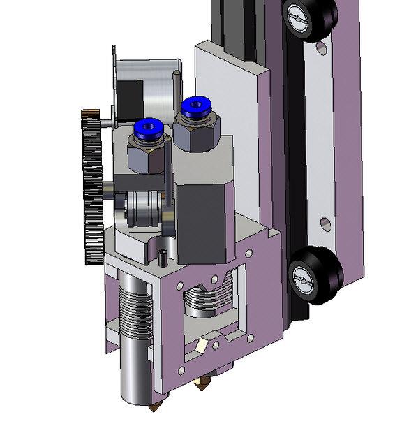

I've just been designing an extruder.  dual with single motor and auto lift , no idea if it'll work but should be a laugh :-)
  • Posts: 1225
« Reply #22 on: February 20, 2016, 11:57:40 AM »
Extruders get complicated fast !

Quick update:
My dual extruder design will not work - had not realised the extruder motor reverses in use  :Doh:
I may as well  just buy an extruder :-(
