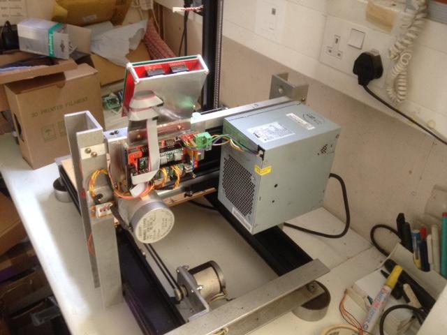

Re: Homebrew engraver to 3D printer Mod
« Reply #25 on: March 25, 2016, 06:47:15 AM »
Bill,
Could you find an answer from this ATX PSU rebuild description from reprap? It helped me at least.
http://reprap.org/wiki/Choosing_a_Power_Supply_for_your_RepRap
/Peter
  • Posts: 1225
« Reply #26 on: March 25, 2016, 11:26:42 AM »
Thanks Peter,
I've just hooked the5Vsb into the VCC pin and it now powers Marlin and allows me to power down the 12v from the menu :)

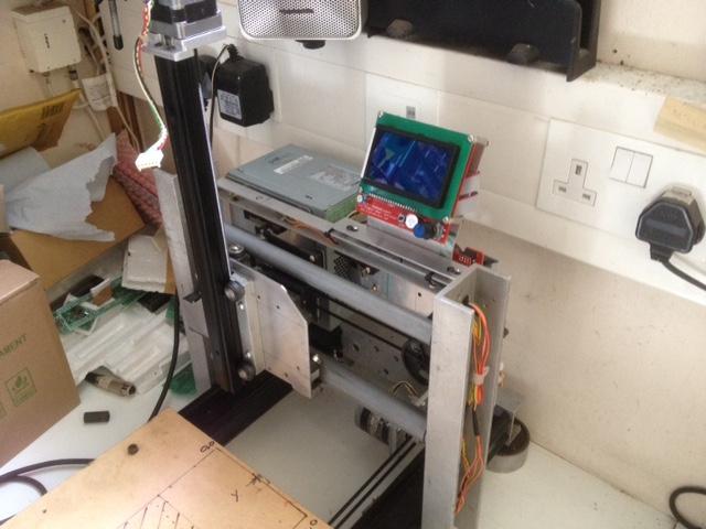

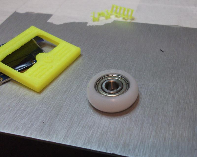

Never let it be said I rush projects...
A belated update: 2017 I got busy with work so only got to play printers towards the end of the year. I managed to set the machine up to the point of printing , well, a mess.  I replaced my home-brew extruder with a Chinese one , only to find out the problem I was having was simply one of temperature !
The first attempts to print were bugged with Y axis problems : The Y axis slideway (PEEK on anodised ally)  kept sticking so i resolved to replace it with a rolling bearing.
October '17 I got involved with a year long project at work (still ongoing!) but finally today, I found time to mod the axis with the bag of China's best plastic rollers :

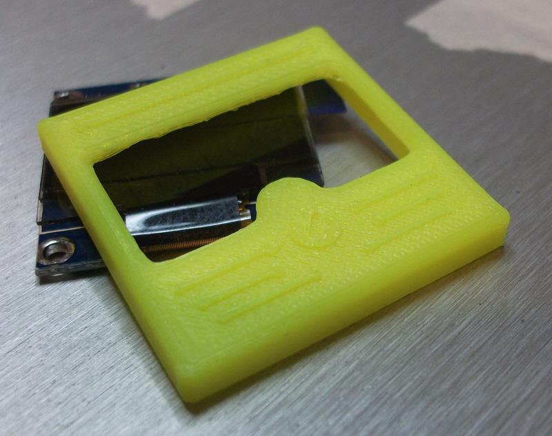

And now I have my first ever successful print  :nrocks:
It's a simple bezel for a OLED display (I chose it because it is small and ready to go)

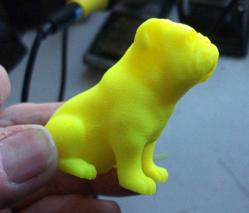

What happened??? --- calling 3d print experts
After two successful prints (one over night  - pecil holder dog from Thingyverse), the extruded filament does not want to stick [edit] extruder seems to work ok when open but clicks and seems to stall when trying to print onto initial layers
suggestions please (I'm just trying increasing the temperature a bit)

« Reply #30 on: October 29, 2018, 10:01:21 PM »
Extruder stepper clicking means it doesn't have enough torque to push the filament through the nozzle.   You may need to clean the nozzle.  The tensioner on the extruder may not be set high enough.  The filament may be out of spec (wide spots), etc., etc.
I'd recommend printing a temperature calibration object (There are several on thingiverse).
  • Posts: 1225
« Reply #31 on: October 30, 2018, 05:01:56 AM »
Thanks. I'll swap out the nozzles later and report back  :bow:
edit[]  That's fixed it  :D looks like the other nozzle had a burr around the hole ,I guess that after hours of pniting the burr colapsed and blocked the jet slightly.

« Reply #32 on: October 30, 2018, 08:38:25 AM »
Yeah, clicking is losing steps or skipping the drive wheel.  Causes, in rough order:
Low temp
Clogged nozzle
Too close to bed on the first layer
Bowden tube problem
And very.least likely, exotic heat leak issues causing the filament to soften and swell in the cold part of the extruder.

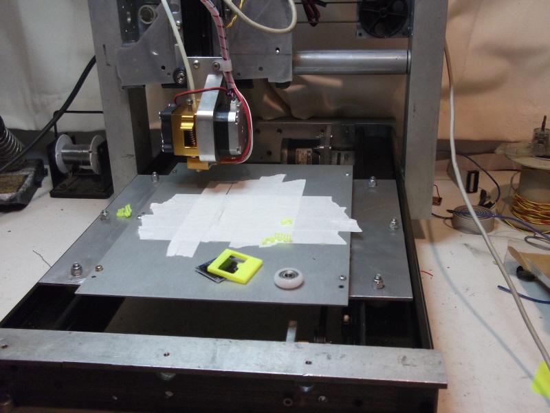

« Reply #39 on: November 04, 2018, 05:07:04 PM »
OK levelled the bed , but may need to make something stiffer / flatter later.
I'm getting problems with larger prints lifting , pulling the tape up or just not sticking
Need to solve this as I have a cunning plan....

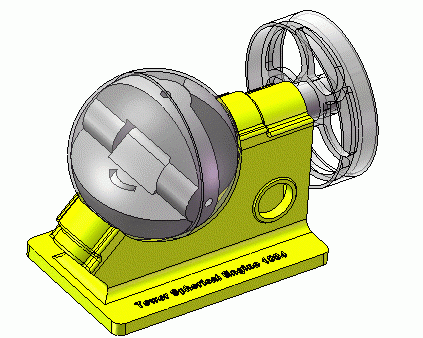

[edit] odd this should be an animated gif (mod's any reason the uploads no longer work??)
  • Posts: 2492
« Reply #40 on: November 04, 2018, 05:56:06 PM »
Hmm, it looks like a steampunk time machine?  :scratch:
  • Posts: 1225
« Reply #41 on: November 05, 2018, 05:16:42 AM »
Well, I suppose it is sortof.. It's an125 year-old steam engine design by BeuchampTower (http://www.douglas-self.com/MUSEUM/POWER/tower/tower.htm) . It was one of the first engines that I animated for Doug's site and have wanted to build one ever since. Machining one on the gear  I have would be a major problem but , with the advent of 3d printing it should be relatively easy .

« Reply #42 on: November 09, 2018, 03:16:11 PM »
Added a heated bed , which seems to work ok after a bit of tinkering.
It managed a long over night print ok (-ish, stil the odd blob of black snot from somewhere) of a de walt battery adapter.
But, two attempts printing the first part of my engine (the large circluar seperator plate) have failed after 3 hours with a 'bed thermal runaway error ' - I don't think that this is the actual problem but a consequence of power failure again  PITA!
