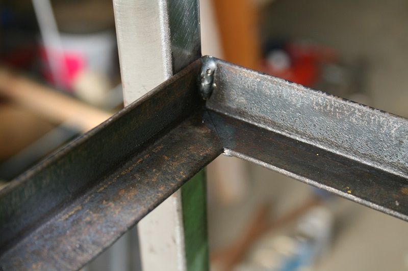

With the forced rebuilding of my workshop due to change of home and county, I thought some reorganisation was in order to locate all the lathe 'stuff' in one place. In the old workshop there was a small shelf above the lathe and the rest was scattered across a long worktop.
I have not seen one to this design before and thought it may be use to others.
It was made from 1" box section and 25x25x3mm angle with water-resist mdf for the shelves. The mitred shelf angle irons were tacked together to form the shelf supports and the whole lot tacked together. First attempt was disastrous, so detacked with the angle grinder and redone. I would like to say it's all square in the vertical plane but there is about 3mm of twist in it.
http://i1200.photobucket.com/albums/bb335/Spurry/Lathe%20tool%20stand/IMG_8962A_zpsyaspn0yk.jpgStand for lathe tools
Frame welded up
http://i1200.photobucket.com/albums/bb335/Spurry/Lathe%20tool%20stand/IMG_8964A_zps8xj8lm21.jpgStand for lathe tools
Bit of 12mm plate to mount the wheels
http://i1200.photobucket.com/albums/bb335/Spurry/Lathe%20tool%20stand/IMG_8966A_zpsnh1zkwuz.jpgStand for lathe tools
Mobile welding bench
http://i1200.photobucket.com/albums/bb335/Spurry/Lathe%20tool%20stand/IMG_8969A_zpsdfyqkiy7.jpgStand for lathe tools
Shelves fitted. Hoping the the couple of mm will stop any tools rolling off.
http://i1200.photobucket.com/albums/bb335/Spurry/Lathe%20tool%20stand/IMG_8974A_zpselzvlq2r.jpgStand for lathe tools
Just need some short m8's for the wheels

Wheels fitted and shelves starting to get loaded up. One thing that is particularly useful is having the 'normal use' drills on the top shelf, right under my nose. With varifocals that's very handy to just look down and have them there.  :)

Nice work. I'd put those heavy chucks at center height, cut down the strain on the back.

I did ponder on which shelf to put the chucks, but went for the bottom one to concentrate the weight there. Having made the stand mobile, the last thing I wanted was for it to have any tendency to tip over.
As I get more aged, the chucks may well migrate to a higher shelf though.  :thumbup:

I do have one observation though.  I would have made the rear vertical.
It seems you are losing valuable shelf space by sloping it in .

Making the 'rear' vertical was considered. It ended up as-is so that I could have two 'fronts'. The bottom shelf is 600 wide x 600 deep, so I felt reaching right underneath, from one side, could be a problem, hence the reason for the double taper.
It may well be that with the passage of time, the extra space may have been more useful than the access aspect....so who knows.
The wheels apparently will load up to 600kgs, are easy to push, all rotate (in the vertical plane :clap:) so the unit spins quite easily.
