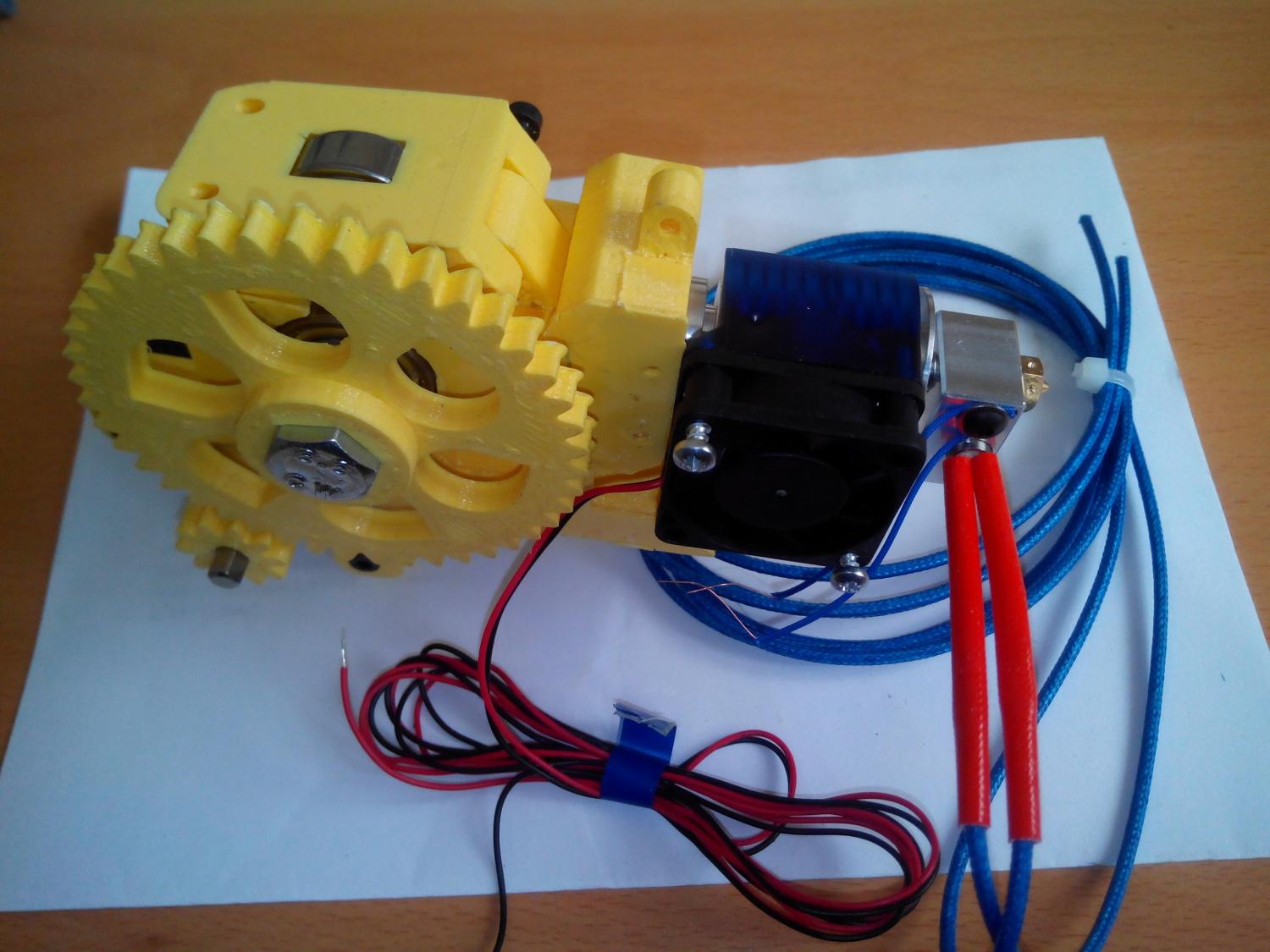

I think the motors are all but identical. I am assuming 360mN.m is 0.36Kgs force at 1mm, which equates to 3.6Kg.cms. If so they should be fine. The amount a stepper deviates from its controlled position is caused by the lamination tolerance plus the load you put on the motor. Lamination tolerance is unchangeable, however by minimising load you should be able to get close to that figure. The 3.6kg.cms figure is the point at which the motor rotor will have moved so much that it will likely step to the next available position. Choosing a motor for optimum performance is a tricky thing. On the one hand you want loads of torque so that you can maintain positional accuracy, but that comes at the cost of much higher rotor inertia which limits acceleration. So at best is an educated guess. I think the Y axis is the one to watch out for, as this will accelerate the highest weight load.
I weighed the assembled x axis filament feeder with motor and attached head/fan (minus bearings, carriage and rods) and it came out to 480 gms (picture), which is a high load for the X axis. I intend to use a bowden tube setup to minimise this load, but its something to bear in mind as this will hopefully be traversing the x axis at a fair rate and may cause frame issues.
Best Regards
picclock

The printed parts have turned up! They are made in ABS as that seems to be the best material for structural parts like these. Looking more closely at the bits we can see some flash and that comes from wanting to create a larger surface on the build plate to secure the part better and to get a better precision.
http://i577.photobucket.com/albums/ss219/H0n3/Tooling/3d-printer/3Dprinter-15.jpgPeterE builds a 3d Printer
I have started to tear the flash away, but to get it really nice I need to use both files and a knife. I want nice smooth bits to work with. As soon as all bits are cleaned up, the assembly will begin.
I'll be back!
/Peter

Good to see that your making progress, and have received your plastic parts. I weighed the Metal Y base and it came in at 302gms bare, the heater board at 164gms.  With 3mm glass at another 300 gms + bearings looks like an all up weight of around 800 gms. To which the weight of the plastic must be added. Let me know how your build weights work out. This is quite a mass to move about in an accurate timely fashion using a thin (stretchy ?) belt and relatively low power motor.
I am still completing other work after the house move, but hope to begin assembly on mine soon.
