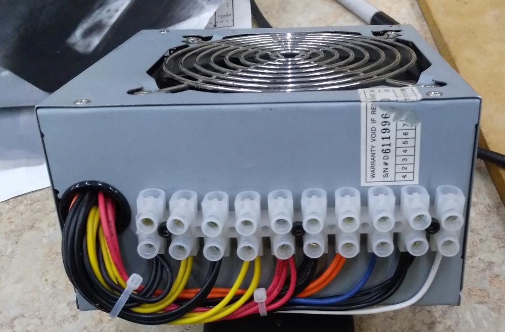

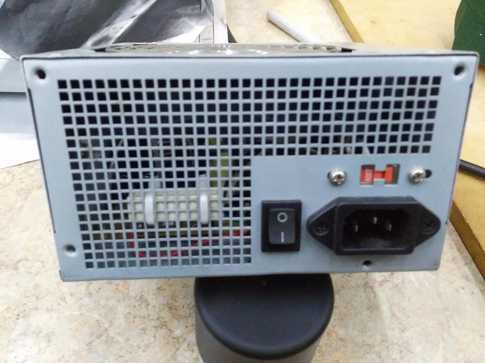

Today I bought a PC power supply for the printer. The one I had only delivered 15A DC max on the +12V line so it was under requirements. Need another 5 to be sure.
It was not very expensive, I think about 45£ or thereabouts.
http://i577.photobucket.com/albums/ss219/H0n3/Tooling/3d-printer/3Dprinter-48.jpgPeterE builds a 3d Printer
Back home and into the shop it was time for "unboxing" and opening the PSU with some expectations.
http://i577.photobucket.com/albums/ss219/H0n3/Tooling/3d-printer/3Dprinter-49.jpgPeterE builds a 3d Printer
I am following these instsructions from the REPRAP site;
http://reprap.org/wiki/Choosing_a_Power_Supply_for_your_RepRap. They seem to be good and Now I am on my way intot he unknown. Will stop at this point because I want to be less tired so I don't make un-necessary mistakes. It would be bad if I blew a new PSU that I have forfitted the warranty on by opening it.
Story continues tomorrow .....

PS,
Just had to add a comment as I got a question from a Swedish forum I am also posting on ...
If one reads further down the linked document it is possible to avoid opening the PSU to maintain warranty if so desired. But I still wanted to limit the "tail" of cables to a minimum so choose to open and cut out not wanted bits.
So there is actually two ways to go using a PC PSU, it is up to the user. Anyway, the choice of a PC PSU is quite economic compared with other types, at least I find it so.
