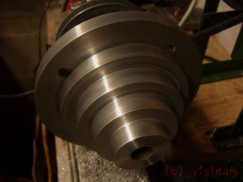

I took a break from casting today and drilled and tapped two 5/16" holes in the back of the cone pulley casting and bolted it directly to the lathe faceplate. Then I slowly worked off the machining allowance in this small lathe -- about 1/4" on the diameters of the sheaves. I couldn't dig too deep without chatter on something ths large -- I'm looking forward to a bigger spindle and bearings when the pulleys are finished!
When supper time came around I had it roughed out to 5",4",3" and 2" diameters. I haven't bored it yet, and I haven't started cutting the grooves for the J type Poly-Vee belt. I did make up a 40 degree gauge from some galvanized tin, and then sharpened a lathe tool using that to compare it with.
Here's the pulley on the faceplate:

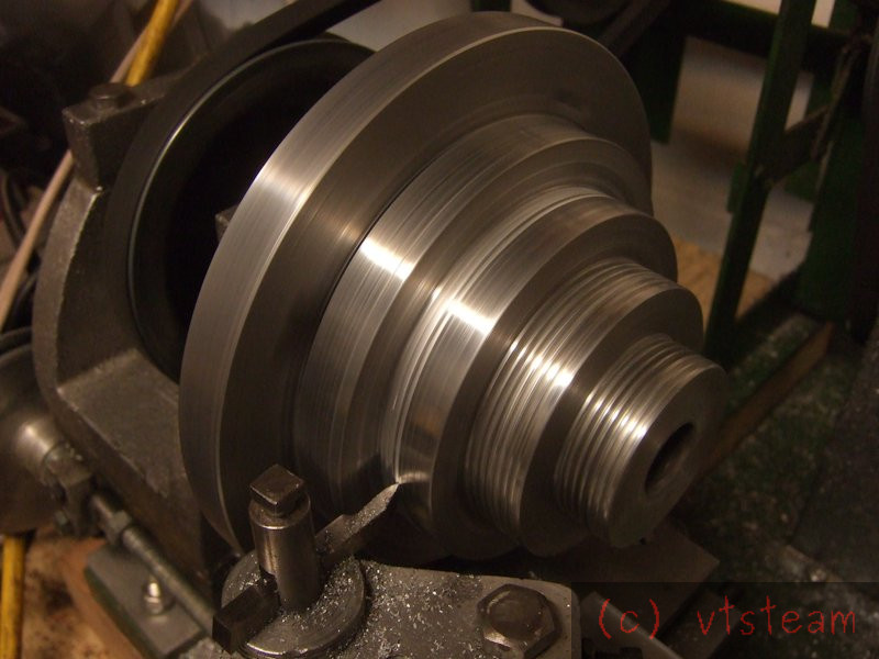

I started turning the grooves in the smallest sheave -- getting chatter even though this is a single point tool, and I took apart and cleaned and adjusted all of the lathe slides, and tightened down on the split spindle bearings. It just won't behave. Basically I need what I'm trying to make -- a more robust spindle and bearings.
Though the speed is the slowest, and the sheave the smallest, I think the chatter is a result of the distance from the faceplate, and it may be less of a problem with the other sheaves which are closer.
I dunno, I was thinking of boring it insted, and then putting the pulley on an arbor and then doing the grooving between centers. But I don't know if that would help or make things worse for this particular piece. :scratch:
I guess I could wait a few weeks for warmer weather and then just turn it on the Craftsman 12". But a Gingery should build itself, without help, seems like.

Animals with tools   :dremel: , My favourite is the Sea otter using a stone as an anvil  :med: .
Could you bring your tail stock up to give the outer end a bit support  . Also mounting the tool upside down and running in reverse can do the trick . or make a spring tool  :dremel:  :)

Rob, that's a very nice holder!
re. bringing up tailstock center -- the bore is still just the raw cored hole not centered, I could bore it out now, but the hole would be bigger than my tailstock center (MT1).
Maybe I should make a pipe center. Or maybe plug the hole with hardwood -- that might work and I wouldn't need to bore yet.
re. boring -- I should have put spacers behind the pulley -- the spindle is solid, so boring will mean removing the pulley, and re-centering it to get the spacers in. Otherwise everything could have been turned at one go.
I could try to make a spring tool like yours (I'd like to), but there are some complications -- I'm at the limit of my cross carriage back travel on the larger sheave. Maybe I can do it though if I substitute my boring table and make a tool holder to fit on that, since it is much longer and has more travel.
Running in reverse with upside down tool -- I don't think I have reversing capability with this washing machine motor -- haven't tried figuring out if the wiring would allow it -- I'm still confused on that subject for mystery motors. One thing that would work well though: no worries about chuck or faceplte unscrewing in reverse -- all fixtures/backplates are cast on their arbors. I change arbors to change fixtures.
But I might be able to make a rear toolpost for the boring table. So maybe I wouldn't need reverse to do that, and gain  parting ability, too?

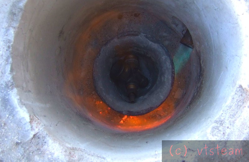

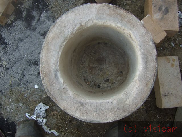

Today I cast a base for the new lathe I'm building in the furnace, and after 10 heats in winter, no functional problems with the plaster lining so far, despite the extreme cooling after a melt. There is some cracking, due to expansion and contraction of the lining -- but they seem quite stable. I've noticed that they disappear when the furnace is hot, and reappear when it cools down. Basically expansion joints. And no worse than my old fireclay and sand furnace refractory, which lasted ten years. In fact, better so far -- no patching has been necessary with the plaster furnace.
There are a few small chunks broken off around the top of the lining, but these occurred when the furnace fell over (long after a melt) because the warmth gradually metled a layer of ice under the soil. The furnace gradually leaned over and toppled with the lid on and an empty crucible inside. I was eating dinner at the time. A few linilng dings were the result, but nothing needing repair.

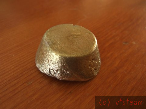

After the melt today, the furnace was hot. Spying on a shelf the old brass POV valve removed from the propane tank I had made the furnace from, I thought maybe I should try to melt that. If the lining is going to fail, that should do it -- temps are a lot higher and a lot longer heats needed for brass.
And curious to see whether my small atmospheric propane torch was man enough to melt brass, and if it did, what kind of brass would I get out of an old valve? Lots of interesting questions to explore! If the lining gave out, it wouldn't owe me anything -- the whole furnace cost me $22, I think, and I'd had a good number of heats already.
So I popped the valve into a small clay lined crucible and turned on the propane at partial throttle and 10 psi.
« Last Edit: April 30, 2018, 10:07:21 PM by vtsteam »
  • Posts: 6941
Re: Foundry Furnace for the Tiny Shop
« Reply #96 on: March 24, 2015, 01:28:36 PM »
And the results after about 20 minutes:
Yes indeed, an atmospheric burner made from 1/2" EMT can melt brass in this furnace.  :thumbup:
Nope, the lining showed no change after melting brass.  :thumbup:
Yup, the brass looks halfway decent (Vermont expression, meaning "good")  :thumbup:

The furnace lining, 11 heats incl. 1 brass melt:

Looks like you've hit on a useful formulation there Steve with your Plaster of Paris and sand - certainly seems to hold up well. Realistically it's only the first few mm that take the full heat I suppose. The temperature gradient from 'flame facing' outwards must be quite steep I expect.
  • Posts: 6941
« Reply #98 on: March 24, 2015, 08:15:59 PM »
Well I'd been thinking about using plaster for quite some time Andrew, after some references to sprue pouring liners (for insulation), and a reference to using gypsum blocks in a bronze furnace, and plaster in statuary practice. The sand part was in a video posted on the forum, and I used a sand and clay liner before, so it seemed reasonable -- I just wasn't sure how well it would hold up and if calcining would be a problem. It's working so far. And the insulation value seems very good. 2" is fairly thin, but the outside of the furnace doesn't get very warm after an aluminum pour.
