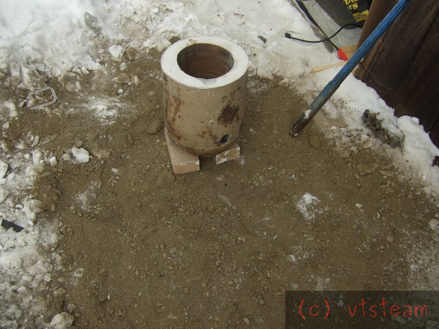

I hadn't planned on doing a thread on this little furnace, because it's not much different than many others online. But it's come up a couple times, so I'll just show what I'm trying.
I've run a charcoal briquet aluminum furnace since 2002 using the recipe set out by Dave Gingery in his book (highly recommended) and built my lathe with it back then, a complex milling attachment, many accessories, and a disk turbine (whose blades were actually cast from aluminum melted in a ordinary campfire -- no furnace at all). The furnace was of sand and fireclay construction, but finally deteriorated after ten years when rain leaked through a metal cover over a winter and the shell rusted out.
Then a couple years ago I tired building a sawed off single charge cupola as an experiment. That failed (with wood charcoal, at least -- didn't have coke, which might have worked). That was re-fitted with an oil burner and I was able to successfully cast with iron after much trial and error.
So now with my new tiny shop, I find i need to cast an aluminum pulley to upgrade my Gingery lathe spindle to 1" dia. And I want something less massive and involved than the oil burner -- which is overkill for that purpose. Also located by my distant and unheated big shop, and outside, under snow.
Anyway, those were the reasons for a new furnace. I also hoped to have alternate metal capability -- small capacity iron would have even been possible if I was able to follow Ironman's small furnace design. But I wasn't able to find the very expensive rigidizer he uses, here in the States. So I dropped back in my expectations to maybe being able to melt the red metals.
Instead of fireclay and sand, this time, I wanted to try Plaster of Paris and sand. A recent video post here showed another furnace made from a galvanized bucket using the same refractory, but I'd been thinking about poP for a long time before that. Steve Chastain's books refer to commercil pouring liners of that material, and show data that it has a high insulative ability as well as refractory qualities. Bronze statuary casters have long used it for lost wax molds, flinging it onto the armature to prevent bubbles.
Anyway, wanted to try it and see how refractory, insulative, and long lasting it was. I still want to make Ironman's furnace some day, and will when I can find the right materials. If the plaster doesn't last long, I can always replace it with blanket and rigidizer. So this is a pure experiment, with little to lose.
Materials were sand, a bag of plaster of Paris ($14.95 at the local hardware store), and an expired 30 lb propane tank (a little taller than the 20 lb size) for a  casing.
I had some left over 8" dia. Sonotube (cardboard form used for casting concrete pillars) and I used that for a form inside the furnace. It actually measured 8-5/8" wide so I cut a 1" strip out of it and taped it back together to reach 8".
The seam made it easier to remove when the plaster was cured, too.
The mix was equal parts of sand, plaster, and cold water, and I mixed about 2 quarts at a time. Actually, the first pour was about half that in size, and used a little less water to make a heavier pasty mix which I used to "glue" the outside of the form to the propane cylinder.
This stuff sets off in literally 3 minutes, even with cold water and cold materials (very -- they were stored in a cold shop) so you have to work very fast. DO NOT use warm water!
As soon as that kicked, I ddn't have to hold the cardboard form any more, and could pour the rest of the refractory with no leaks. The proportions I used makes a good pourable mixture that self levels. Within an hour, I peeled out the cardboard form to a nice clean interior. Then I poured the bottom inside the furnace cavity -- about 2" deep.
Finally I found a cardboard mailing tube of exactly 3" diameter and used that to form the lid hole form. in a similar way to the furnace cavity. And then poured the lid.

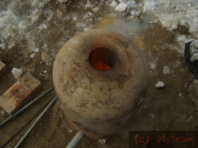

Today, after 3 days of drying, I brought the furnace outside, and put a double layer of charcoa briquets in and lit it off. This applies gentle heat, and will help me drive off the water from the plaster -- it will probably take all day, and I'll be adding charcoal as needed. Moisture is obvious as steam this time of year!

Sorry, I didn't take any pix of the construction. Here it is after running an hour with charcoal. Sorry also -- I couldn't paint the furnace this time of year -- too cold, but plan to make it nicer when things warm -- if they ever do.

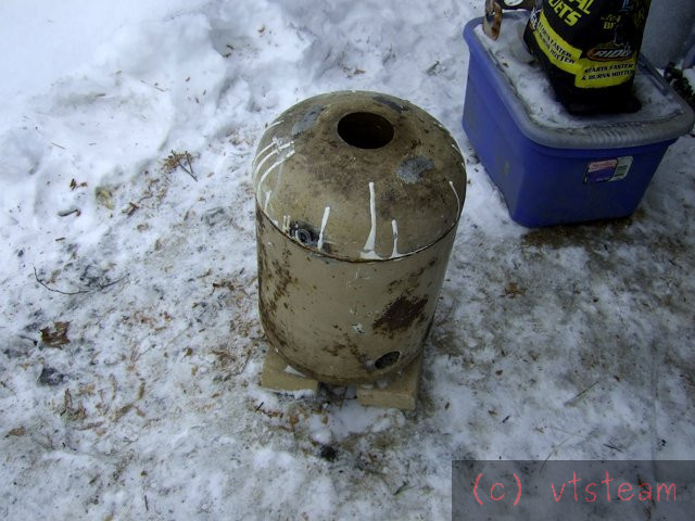

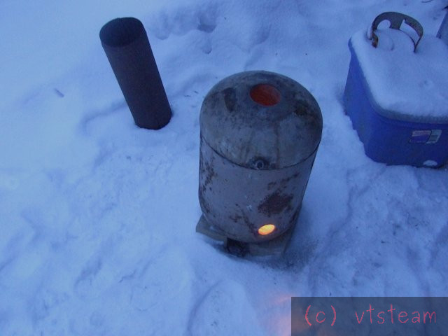

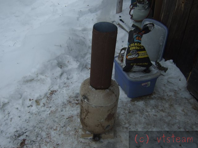

I added more charcoal to about 3 layers deep after three hours and a piece of old stovepipe on top to increase the draft a little. Still way to early to get out the blower. The brown residue inside the barrel and under the cover will burn off once the furnace is in use at high temps. For now, sorry about the Grapes of Wrath appearance here! You can tell I'm suffering from cabin fever to be doing this at this time of year.....

I've debated whether to explain my procedure for cutting up a propane tank. I'll put it down here, but this isn't a recommendation to anyone, just an explanation of what I did, and why I did it that way.
I used to build pulse jet engines, and some of the principles apply, to my way of thinking.
The first principle in avoiding a detonation in a container is to remove all fuel. No fuel, no detonation.
The second is to reduce the volume of potentially combustible mix as much as possible. Reduced volume, reduced energy available.
The third is to provide a relatively large opening in the container. The less containment/restriction the more likely conflagration (rapid combustion) vs detonation (explosion).
Taken all together:
1.) I opened the gas valve on this propane tank and left it outside for 3 years. That still doesn't guarantee no "fuel" since these tanks typically have a tarry residue internally, which if heated will boil and offgas under torch cutting heat and even though it isn't propane itself, it is flammable (and explosive if contained).
2.) Removed the valve entirely with a pipe wrench. This increases the size of the orifice greatly compared to leaving the valve on. This alone reduces the chance of a detonation.
3.) Washed the tank out with hot soap and water. This won't remove most of the tarry residue. So it would be foolish to depend on it. It will remove lighter oils, to some degree.
4.) Filled the tank with water to an inch under the top. This drastically reduces the volume of potential air and fuel mix. The ratio of the current orifice size (about 3/4" diameter) to the contained gas volume (about a pint) has now been increased maybe 1000 times what it was with the open valve attached and the tank empty. There is little volume to burn, and an easy way for hot gasses to exhaust if it does.
5.) With the tank full of water I lit a match and held it over the orifice. No reaction. no pop. Nothing. (Again, I'm not reccomending this to anyone, I'm just repeating what I did and why I did it this way. What I did applies only to this tank, this type of fuel, and this lead-up procedure, not every situation. Make no assumptions about different situations based on this.)
6.) I drained out about a quart of water and repeated. No ignition.
7.) I drained out enough water to lie a little below my cutting line, and repeated. No ignition.
8.) I used a 4-1/2" grinder with a cutting disk in it to score around the tank, still filled with water, and then cut through. The water level was low enough not to wet the disk or grinder, and I wore rubber gloves.
I did NOT use a cutting torch. A cutting torch raises the temperature of the surrounding metal tremendously, and I did not want to vaporize any possible tarry residue in the tank. A torch is in my opinion a bad tool for this kind of thing, and procedures which use inert gasses in the tank are less safe than using water. If the gas isn't right, you can't tell, and the contained volume is way too big for safety. Leaving the valve on the tank really increases the danger.
That's my personal opinion. Many tanks have been cut with torches, and many swear by inert gas fills to do it with. I prefer my way. It makes sense to me, and results are apparent at every step.
Sorry to go on at length here, but I haven't ever seen this explained this way before and thought it might be useful. Nothing in this guarantees safety, and every person must assume personal responsibility if they try to use a propane tank. Other substances and tanks can behave completely differently.

Maybe also a word on cutting the exhaust hole in the tank top:
I took a piece of hardwood and whittled it into a tapered plug, then hammered it into the threaded valve hole. Then sawed it off flush. Marked the center, punched it. Then used that as a guide for the pilot of a 3" bi-metal hole saw in an electric hand drill. Low speed and light pressure cut a perfectly clean hole, centered on the top. I did this before filling with the plaster mix.
The tuyere hole was also cut with a hole saw sized to fit U.S. 1-1/4" steel water pipe (1-38" ID actual, and about 1-5/8" OD) started square radial but after cutting through the outer metal and into the plaster angled to be more or less tangential to the furnace chamber. The bottom of the tuyere is about 1" above the furnace chamber bottom.
The tank and top were wire-brushed to remove the tarry residue in the tank before pouring with plaster, as well.
« Last Edit: February 21, 2015, 06:05:53 PM by vtsteam »

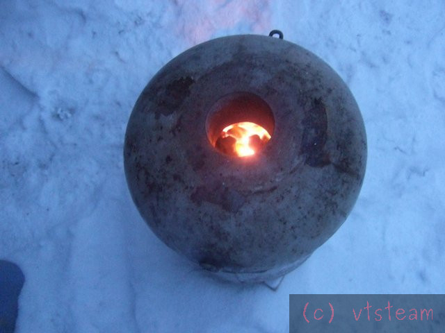

It's started to snow, and get dark out and the furnace has been cooking for 6 hours now, so I added more charcoal and about a minute of soft blast to get the coals all lit. They're carrying on well, now and the heat is definitely up a notch:

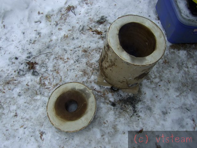

Now, preliminary impressions -- the sand and plaster are much tougher than plaster alone. It was obvious even molding it and cleaning off drips.
Current status of the furnace -- I shut it down after 9 hours of baking the lining, and put it away for the night. We'll do a post mortem in the morning.

I emptied the ash out of the furnace this morning, and the lining is in fine shape. No deterioration. In fact the impressions of the cardboard tube seams are preserved as is the "shiny" areas where I'd used plastic tape on the form. The lining rings when I tap it, so it seems reasonably dry. The lid however still seems slightly soft when scratched -- most of the lid surface is blocked from the heat by the shell, so that will take some more time to fully dry out. There's also probably still bound water in all of the lining --  this bake isn't really a test yet -- that will come with full melting heat. But I should be able to leave the furnace in the shop now -- freezing temps shouldn't hurt it. I did bring the lid back indoors to dry further.

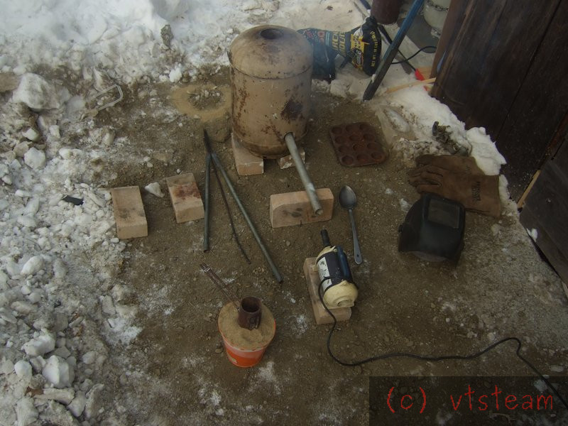

Gear set out, charcoal lit ready to go. No blast yet Lost foam mold setup in the small orange child's bucket lower left :

Blast on, coals coming up to heat....4:10 PM :
