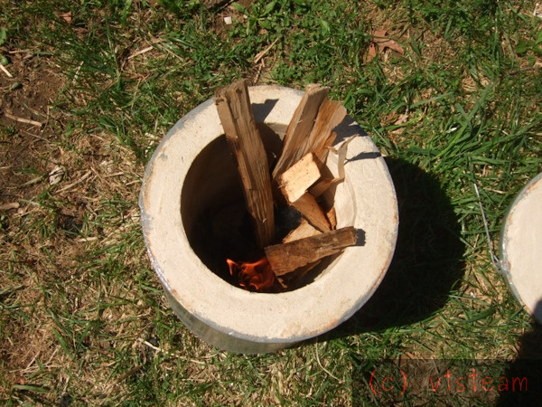

Today I made first heat in the Tiny furnace -- working up gradually to drive the moisture out of the lining. I started out with some wood kindling:

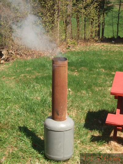

I set a piece of stovepipe on top of the furnace lid for a gentle draw -- a blower would have been too much.
When the wood had burned down, I added a layer of charcoal briquettes, about 2 deep. After half an hour again, I filled the furnace up half way with charcoal, and then let it cook for most of the day.
I also conditioned my greensand, which was dry as the Sahara. All in all a rewarding Spring Saturday, with daffodils in full bloom, and my casting gear coming back into some semblance of working order.  :ddb:
