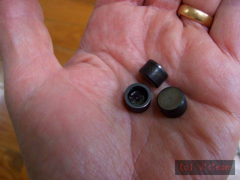

Hi Mattinker:
That's what I was thinking -- I even have some nice new water hardening 1/2" drill rod (silver steel)
Here are the three exhaust valve caps that I have.
I'm starting to wonder if there actually were 4 on this tractor when I got it. I just noticed that one of the valve pushrod ball ends is dirty and varnished over, while the other 7 are shiny. Was that rod even contacting?
The dimensions of these rotators are:
OD .475" (all)
ID   .350" (all)
Length  .311" (2)  .305" (1)  (length gets adjusted per valve when fitting -- probably all started out .3125")
Cap end thickness ~.040" (all)
When fitting, according to the Ford Service Manual the end clearance inside the cap should be .002"-.004" and you shorten the cap to fit the valve.

Oz it was blown in the middle between 2 and 3 cylinders. Of course a bad valve could have been in that area, too. Sorry I didn't note what looked like what when I pulled the head and valve gear. The big gasket break was what caught my attention.
I guess if I do end up tryi ng to make another cap, the trick will be the .350" bore and flat face inside. Might have to actually make a rose cutter or something to cut that.

I'm not surprised Andrew -- I read somewhere that the caps were an after sale addition -- recall style, on some of the earlier engines to prolong exhaust valve life. Mine I believe is one of the earliest 800 series tractors -- serial number is only in the 9000's).
I believe the 800 series (mine's an 850, meaning it has a 5 speed transmission instead of a 4) was the beginning of the 172 Cu in engine -- earlier engines were 134 CI. So anyway, I've heard of engines without them, and others where people took them off for some reason.
Anyway, though that all may be true, I think I'll try to get 4 of those rotators back in the engine one way or another.
I have a lead on a local guy who works on tractors, and might have one. The big tractor dealers have all closed in  this area over the last 5 years.

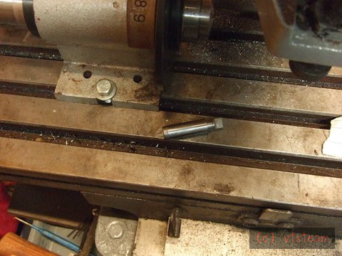

Make a miniature boring bar. The flat bottomed hole, use a modified two flute end mill as a boring bar, face off the bottom of the hole from the centre.
Regards, Matthew.
Maybe just a homemade square ended D-bit would do it, after drilling undersized?
It's raining and will for a couple days, and I've called the traactor guy twice with no answer. Seems like a perfect rainy day project....
Or a drill bit ground straight!

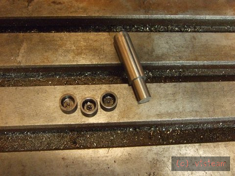

Too late!  I had already headed out to the shop and started to make an olde tyme slot drill.  :dremel:
Now I want to see if it will work!  :zap:
Turned the endd of some half inch drill rod to .350"

« Reply #74 on: May 22, 2014, 06:30:37 PM »
Relieved both sides to leave a .100" thick piece (fake metric) :
