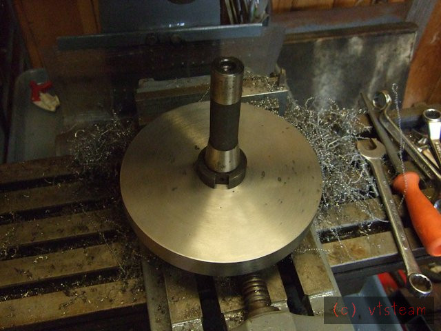

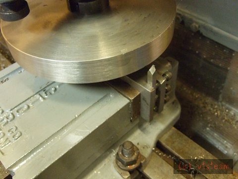

With the blank cleaned up in the lathe, I bored it to fit the R8 shank. Unfortunately I found it was too thin (at 1") to fasten using the system on the older flycutter -- it needed a deep recess to countersink the head of the end fastener and there wouldn't be enough metal left so I went ahead and plug welded the R8 shank to the blank.
Then to make sure the flycutter was running true I mounted it in the mill, and mounted one of my lathe's quick change tool posts in my milling vise and trued the periphery, as if it were a lathe turned vertical.

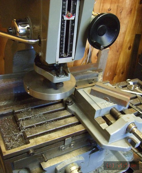

Then I flipped the QCTP upright to face the fly cutter bottom surface:

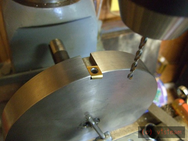

I slotted the rim to take one of my inserts, and then used a tansfer punch to mark the hole location for a retaining screw, drilled and tapped that 8-32:
« Last Edit: July 20, 2017, 10:00:33 PM by vtsteam »

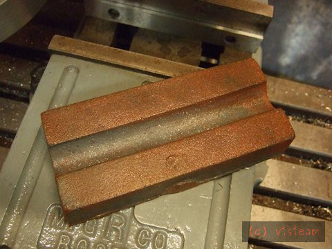

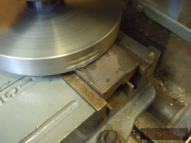

To test it out and give it an interrupted cut on a tough subject to chew, I decided to face this raw CI sand casting I made last summer:
« Last Edit: July 20, 2017, 10:02:20 PM by vtsteam »

I started on the back first to get it roughly parallel to the face:
« Last Edit: July 20, 2017, 10:03:09 PM by vtsteam »

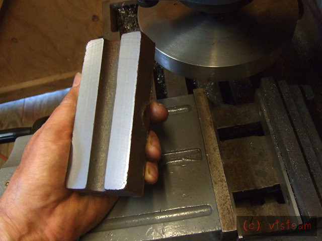

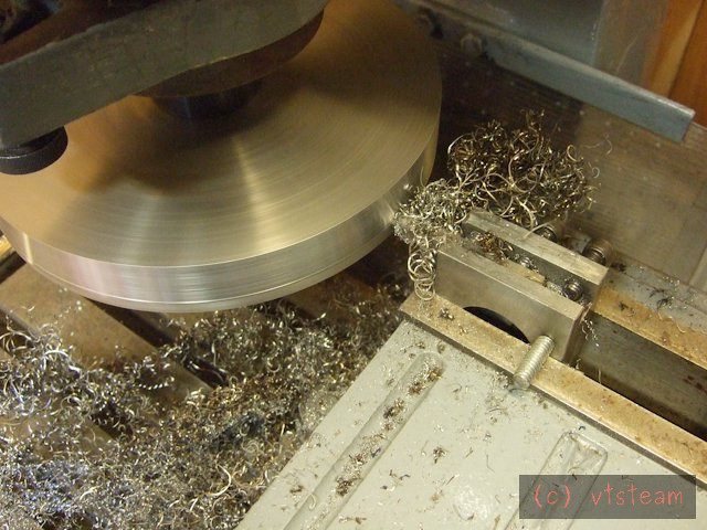

I found I could comfortably cut 5 thousandths at 120 RPM without much strain. Just a light "ting, ting ting..." Sounded like Christmas bells in the shop.
You can see the hardened casting scale as the darker area surrounding the rough sand surface. The insert had no trouble cutting through both.
« Last Edit: July 20, 2017, 10:04:00 PM by vtsteam »

Once I had the back flattened, I flipped the casting over and took the skin off the front.
Andrew what I did wish for, however, was a motorized mill slide! Man that was slow going to get that depth of casting scale off -- I probably did 20 passes total by hand standing there (too dumb or lazy to stop and go get a stool!) And at that slow RPM with a single cutter, I wasn't a ball of fire with the feed.

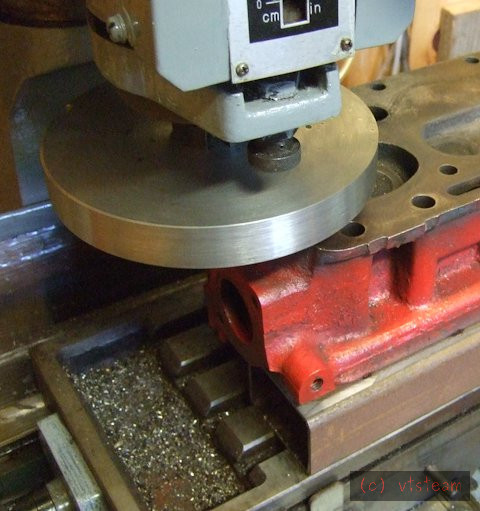

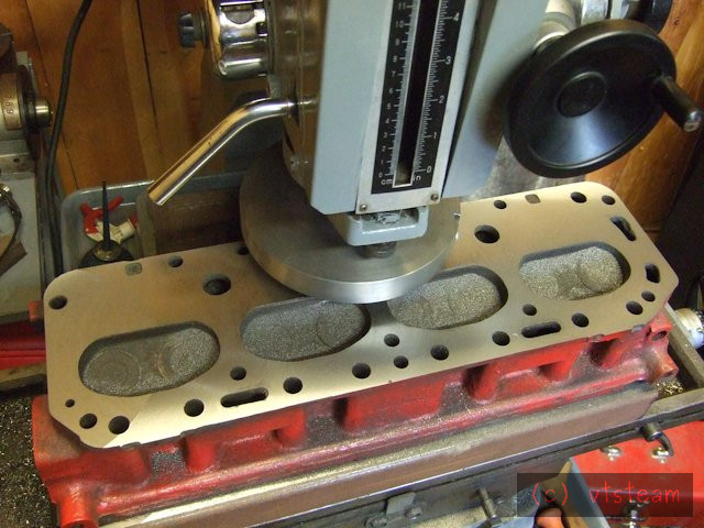

Pekka, that sounds great. And proper! I just wanted to get it done today, and I had purchased some 2" x 3" x 3/16" wall rectangular tube the other day as bearers for the head re-surfacing.
There was no obvious way to hold down the head as it extended the full table width, AND up to the end of the T slots in length. I thought about welding up some brackets to extend over the casting ridges, then doubled back under. But that didn't appeal to me.....
So, uhhhhh, I just uhhhhh, super glued those bearers directly to the table using about 8 "dots" (spot welds) all around for each bearer. Let that cure for a half hour. Then I surfaced the tops of those bearers with the new fly cutter, which made them parallel with the table -- and proved out to my satisfaction that the rig would hold against the interrupted cut, etc. Especially with the much heavier cast iron head on top of the bearers. If things were going to break loose, it would happen at the bearer stage when there was little inertia and weight to prevent movement.
So then after surfacing those lightly, I just placed the head on top and glued that baby down! Here's what it looked like ready to start to cut:
« Last Edit: July 20, 2017, 10:06:26 PM by vtsteam »
Re: 1954 Ford 850 Tractor w/blown Head Gasket (at the very least)
« Reply #46 on: May 21, 2014, 04:17:29 PM »

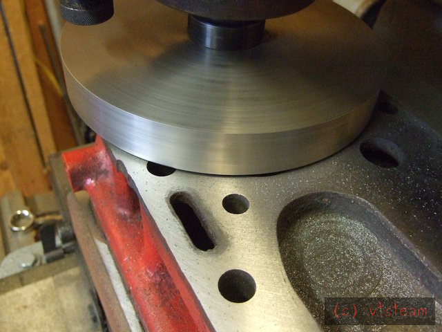

And here we are making a second pass over the head:
« Last Edit: July 20, 2017, 10:09:08 PM by vtsteam »

And finally (after 5 passes) it were done!
« Last Edit: July 20, 2017, 10:10:13 PM by vtsteam »
« Reply #49 on: May 21, 2014, 04:27:33 PM »
Nope Andrew, as they used to say on the Bonomo Turkish Taffy commercials, "Just smack it and crack it!"
A few good taps on the side of those bearers released them from both the table and the head.
I don't particularly like CA glue for most things, not even model planes, but its brittleness does have an advantage here. If you hit it from the right direction with a sharp blow it's wimpy stuff.
But if force is coming from a proper direction (and absorbed by the mass of the head and its inertia) it will hold.
