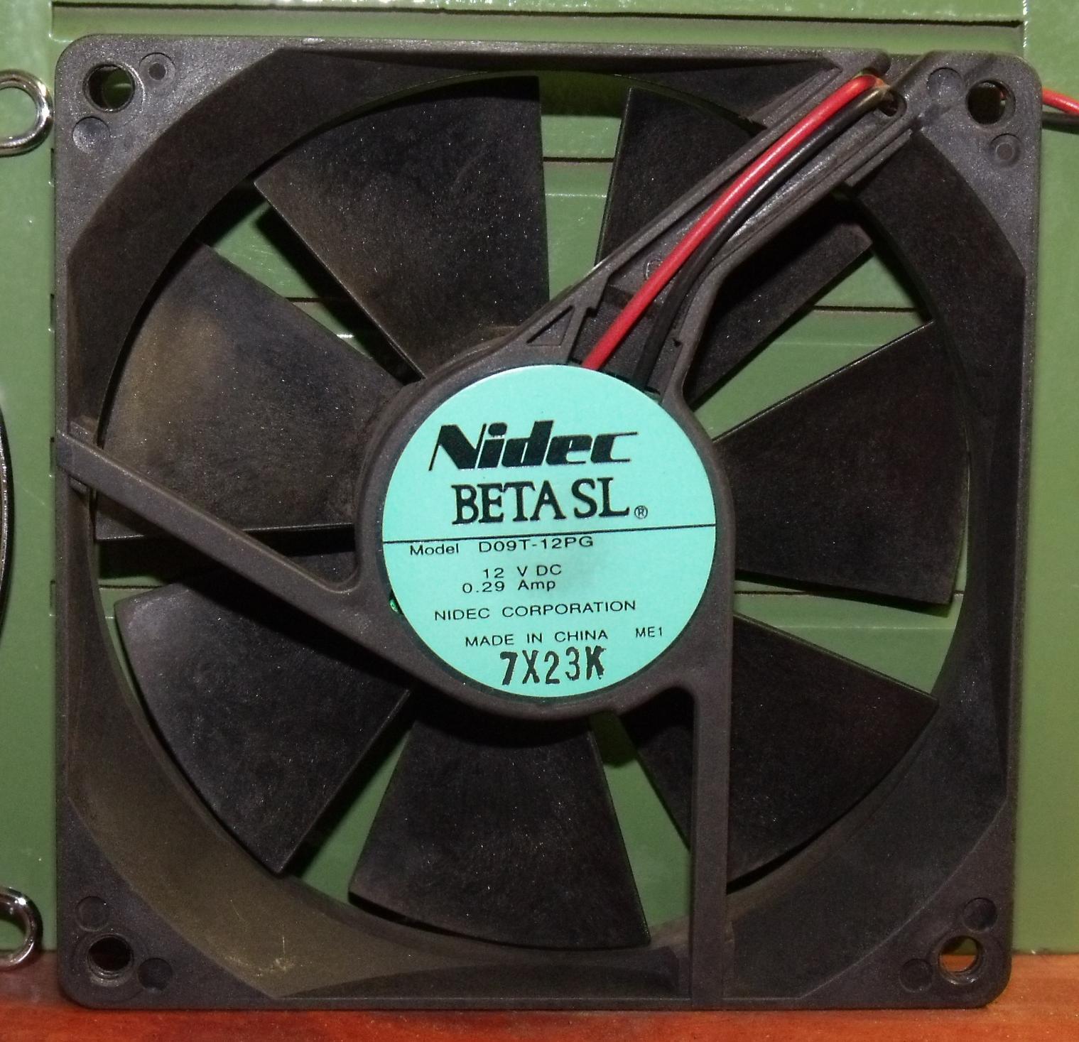

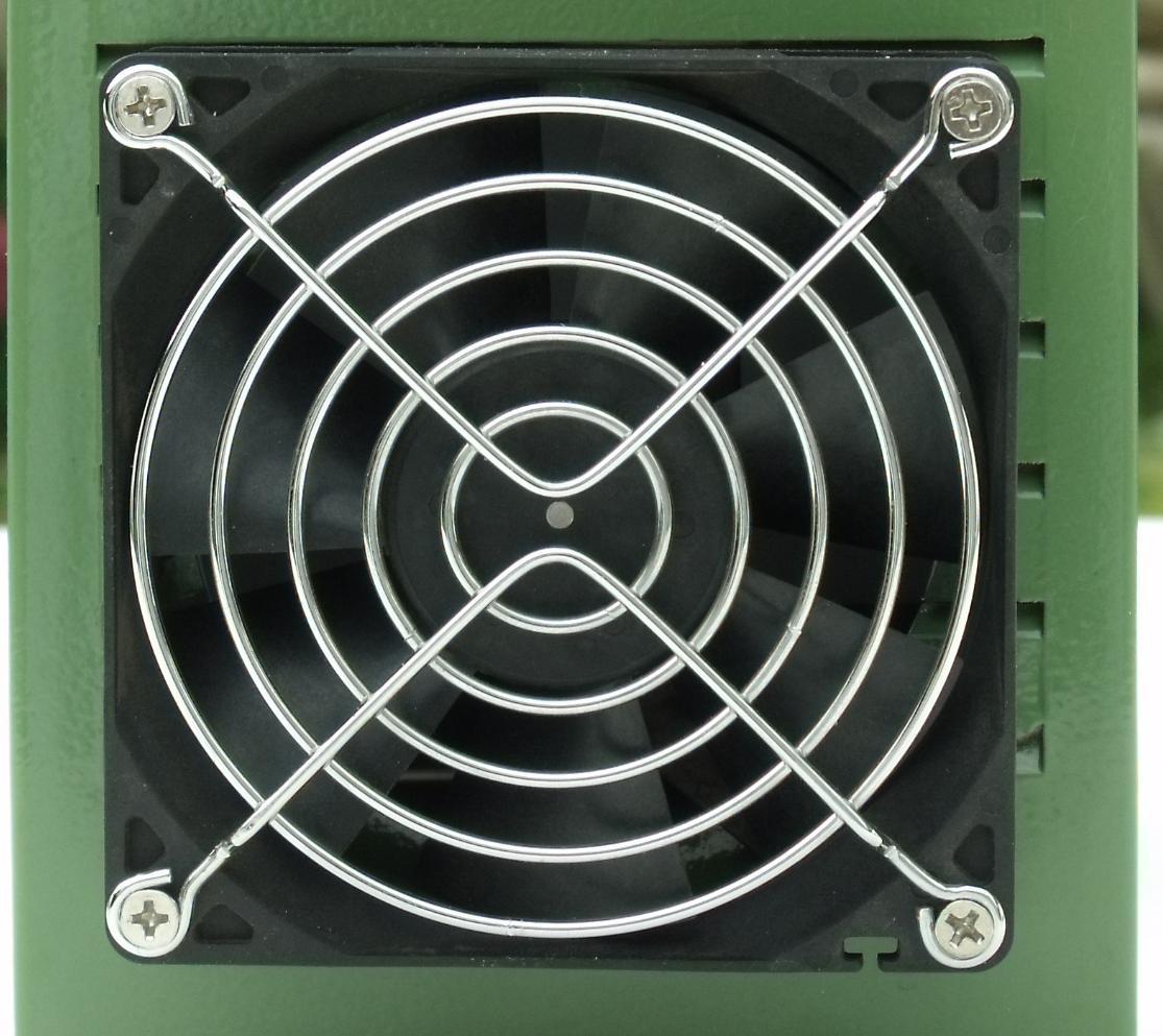

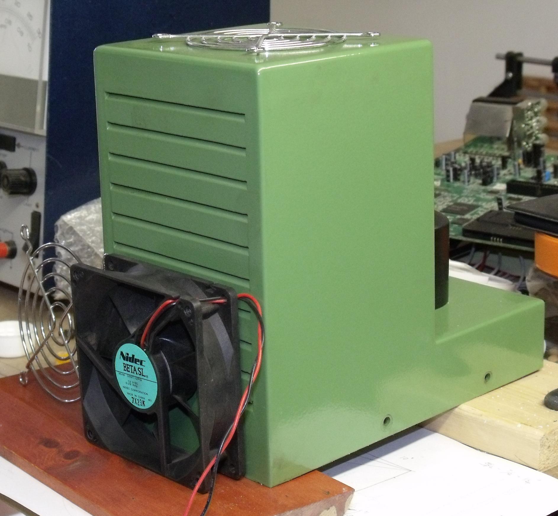

After the original motor went up in smoke I fitted a fan to keep the replacement cool.  Now the fan is no longer in use, though I am going to fit a thermistor at some point so that the fan will only start up if the motor gets too hot.
