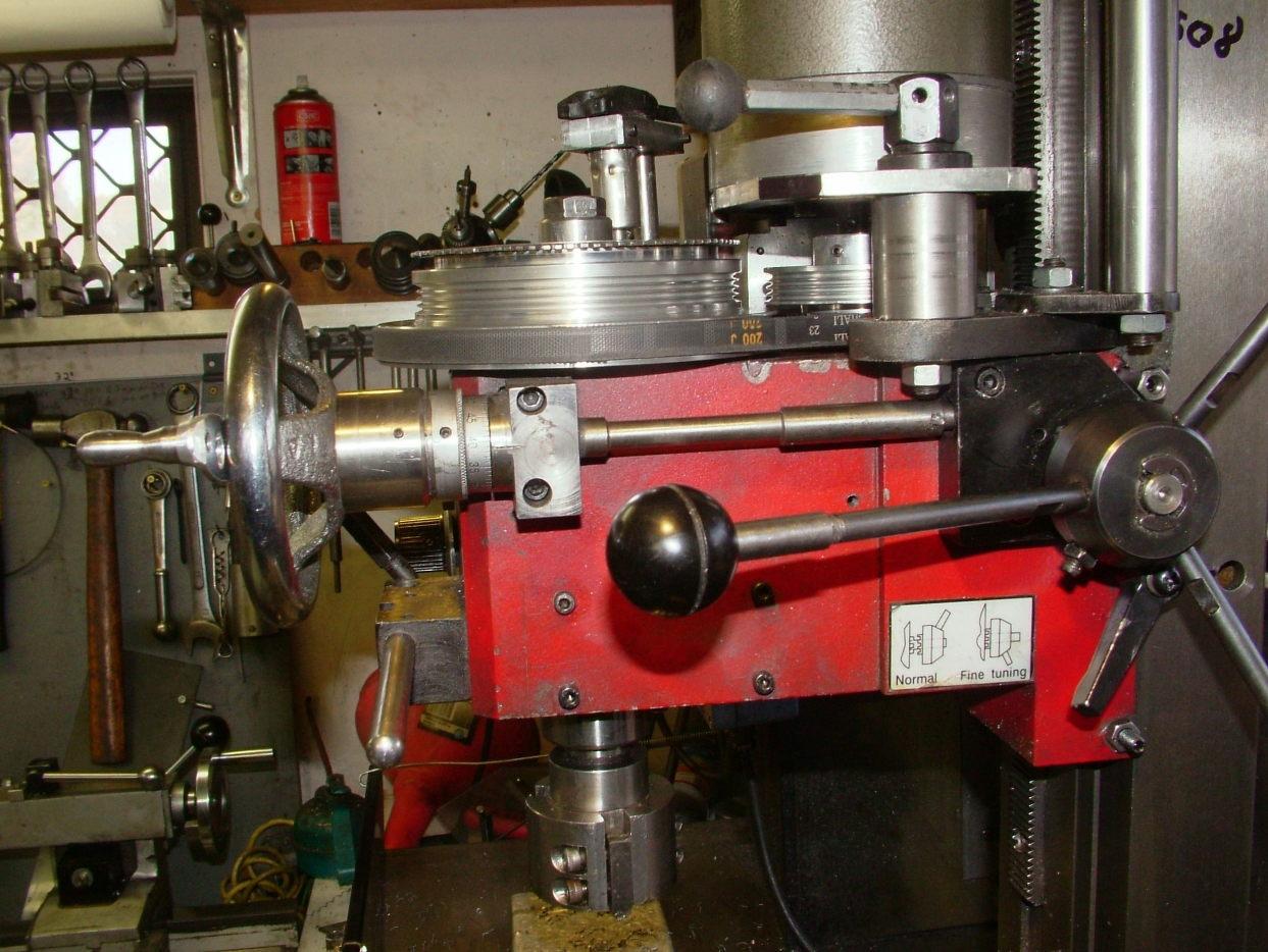

Offline velocette
  • Posts: 152
  • Country: nz
Re: Mill Drill problems
« Reply #32 on: May 26, 2014, 05:06:36 PM »
Hi Peter
Pleased for you that the belt drive is a success and quiet running now prevails.
Modifying an X2 mill to your own preferences is very satisfying part of ownership.
Lots of clever and innovative posts on this forum that I follow with interest as the owner of a very much modified X2 Mill.
The "Z" Axis fine feed Has several problems than can be improved on.
The dog clutch to engage the worm drive play is excessive and a difficult one to remedy only by fabricating a new one.
The worm to the wormwheel has significant backlash again a problem to fix.
The shaft from the adjustment knob with a floppy coupling to the worm shaft can be eliminated and a solid shaft fabricated and fitted.
Make a new housing to support the shaft end behind the adjustment knob with a ball bearing to take the end thrust of the worm and not rely on the the gear box housing.
Have  lots of enjoyment from your mill

Offline PJW
  • Posts: 53
« Reply #33 on: May 28, 2014, 02:59:36 AM »
 thank you for the response on the belts & I will take a close look at your mods Eric, I have made a few adjustments, I also found that the rack on the upright was loose, something I hadn't noticed. Tightening this made quite a differance! but still a lot of play in the spots you said.
Peter

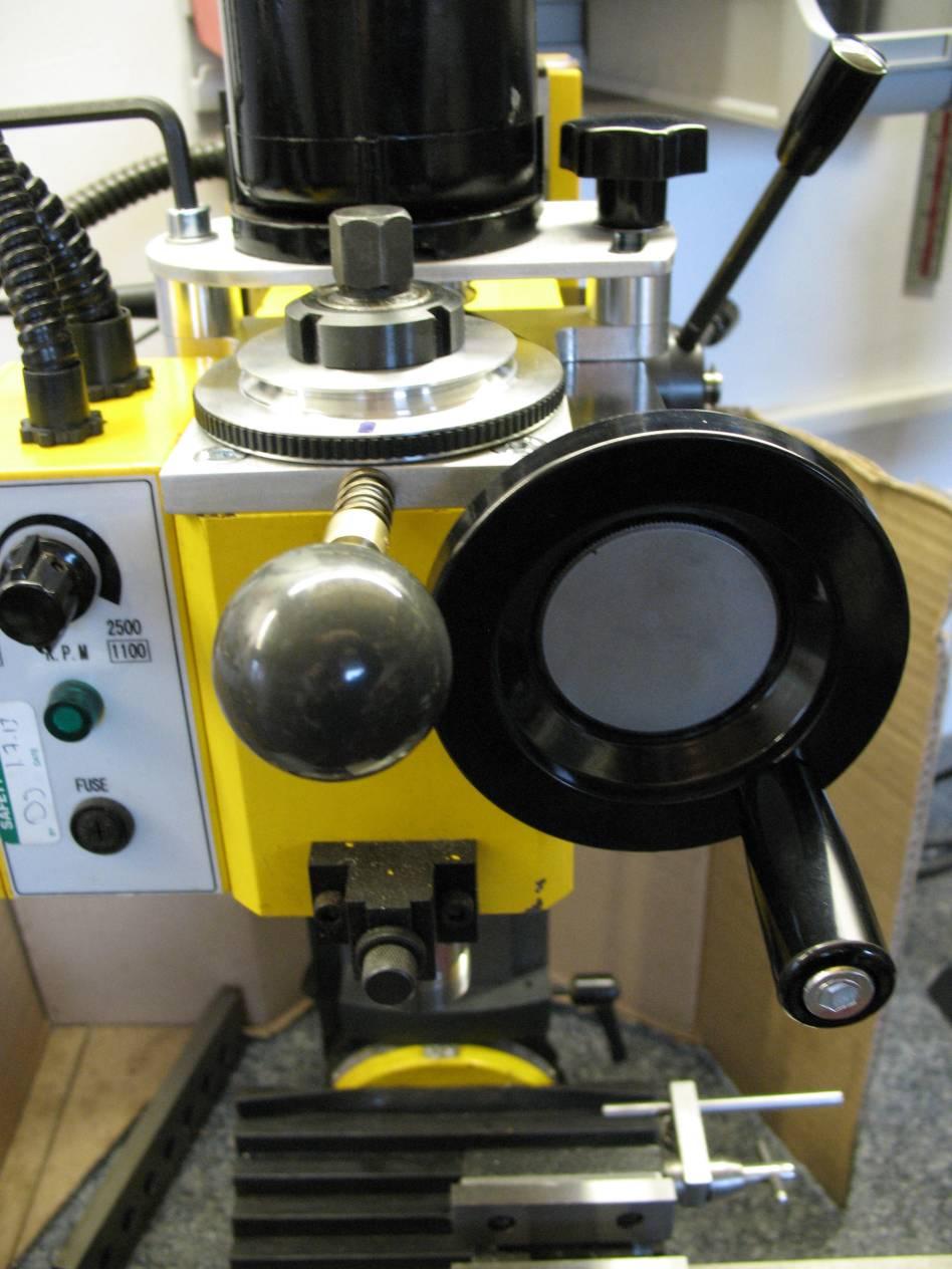

« Reply #35 on: May 28, 2014, 01:31:22 PM »
Polyflex V belt MBL Polymax 5M335
I have fitted the larger handwheel for the quil & this is what it looks like now!
Old Guys Rule the Dark Side of the Shed!
