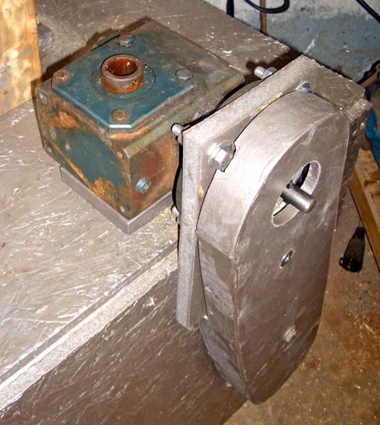

« Reply #53 on: March 20, 2014, 11:15:23 AM »
I like the idea of filling it with sand, I can get all I need for free off the beach!
Today I fitted the motor, I needed a mounting plate so I cast a flat plate 250x150x10mm. I'm getting hooked on casting.
The mechanism for raising and lowering the knee took some thought. I have a worm gearbox that I thought would be good for turning the nut on an Acme thread leadscrew that I can buy. Unfortunately the gearbox ratio is 50:1 which would have entailed many thousands of turns of the handle to go from top to bottom. I decided to motorise it and as I already have a 1/2HP motor that was straight forward, even with the motor it will take three minutes to go from top to bottom. this shouldn't be a problem as I will normally be making relatively small adjustments in height.
I have made it so that I can also use a handle for fine manual adjustment. One turn of the handle raises it 0.1mm which will give me very precise setting.
Does anyone have a leadscrew of 25mm or 1" dia with a thread length of at least 500mm that they want to dispose of?

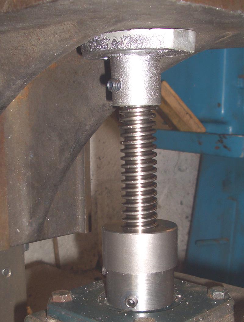

The lead-screw for elevating the table is fitted. I connected it up temporarily and found that it operates very smoothly under power but when I tried to reverse it the motor got a bit smoky. Fortunately I turned it off quickly and now that it has cooled down it is still working, phew! Since that happened I have bought a reversing switch which I still have to sort out the wiring for. When the motor was running the wooden cabinet resonated, it was a bearable noise but I will try to make a resilient mount for the motor to try to quieten it.
The table moves quite slowly under power so setting it accurately in position should be quite easy, I am also able to hand crank it for fine setting. The screw is fixed and the nut rotates around it. The height of the head can also adjusted precisely.

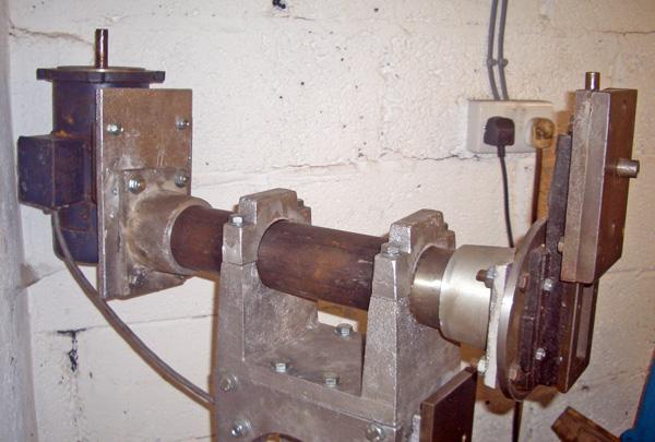

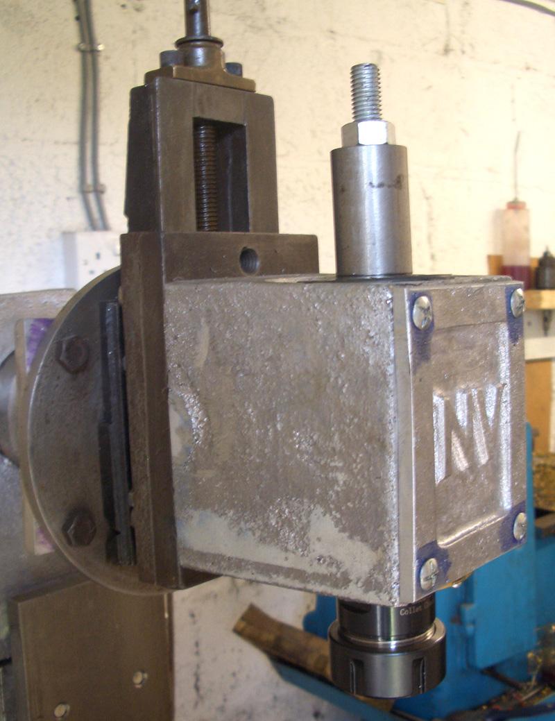

I have obtained the main spindle and bearings and fitted them. It was an interesting piece of machining for the head casting. Firstly I bored it with it mounted on the cross-slide and the made a mandrel and turned the bearing recesses with it mounted between centres. The bearings are taper-roller, I also fitted oils seals top and bottom.

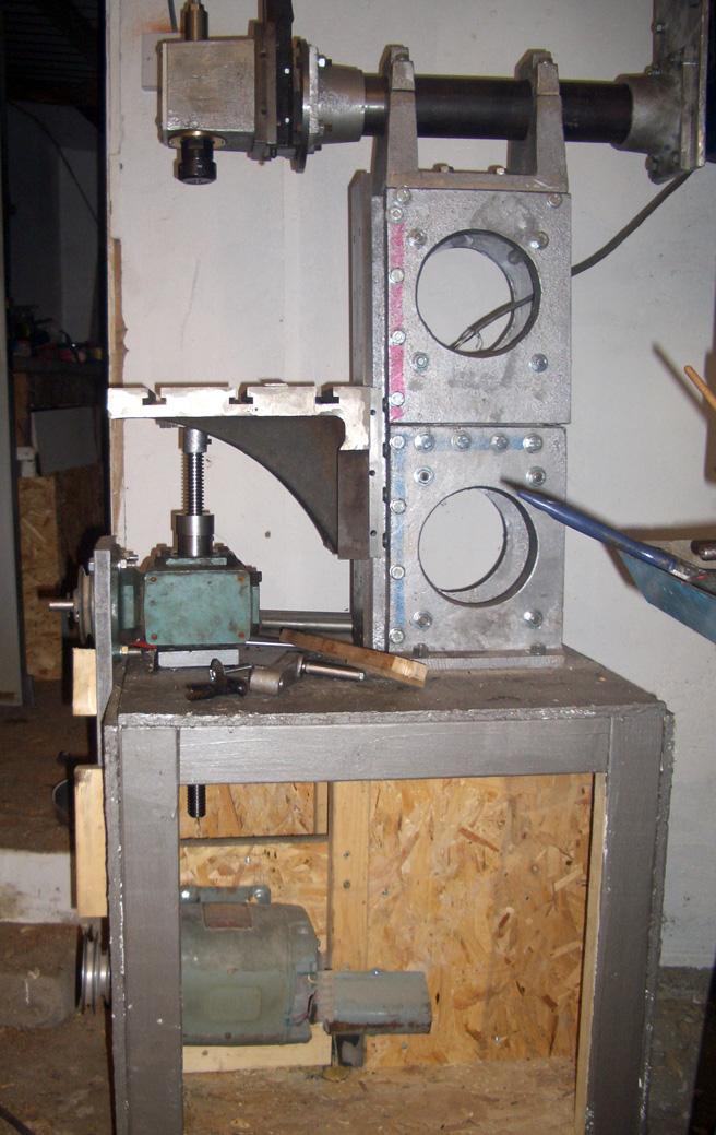

I am getting quite excited by my milling machine. From the beginning I have had doubts about the practicality of what I am trying to do. But, I was looking at it today and feel more confident that I am going to produce a machine that will be capable of producing accurate work. Any comments on what I have done so far?
