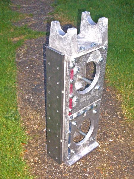

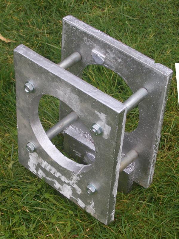

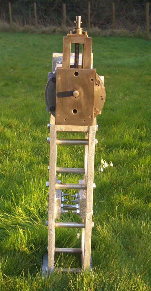

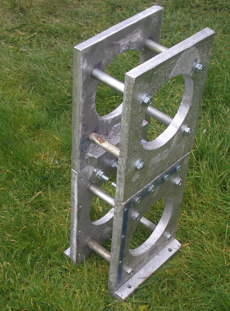

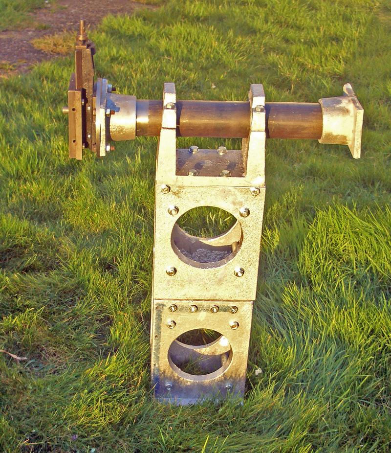

It's been a good day today, the enforced delay due to the weather has given me time to plan the next stages which meant that I was working efficiently and got far more done that I had anticipated.
Firstly I cast the second of the top body sections and after fettling I got them bolted together.
Offline NormanV
  • Posts: 633
  • United Kingdom
Re: Building a milling machine

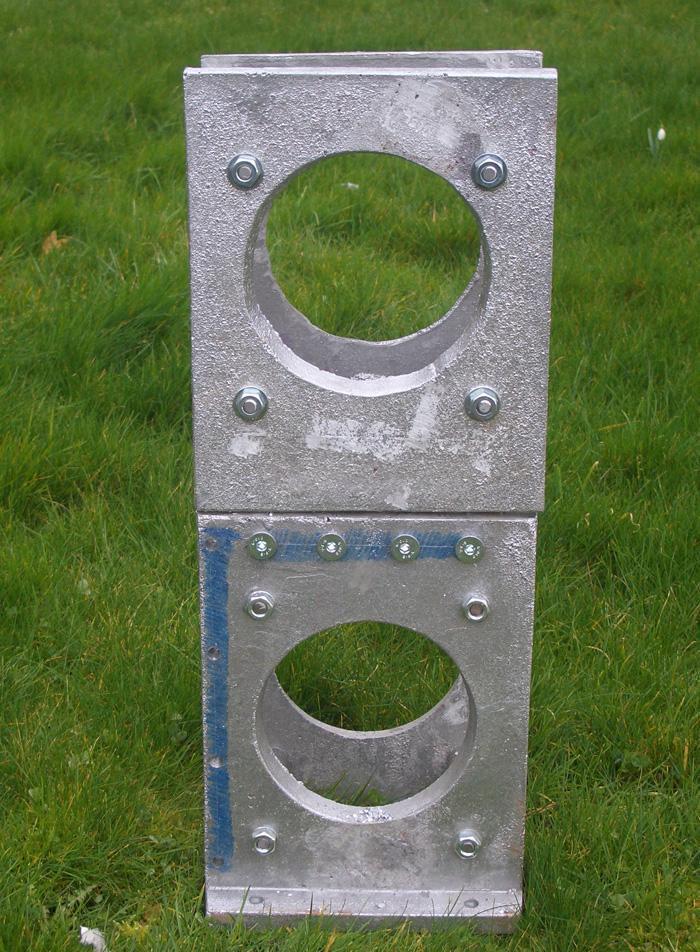

« Reply #26 on: March 04, 2014, 12:24:59 PM »
I then mounted the top section onto the bottom and bolted them together.
Offline NormanV
  • Posts: 633
  • United Kingdom

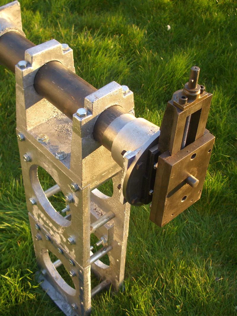

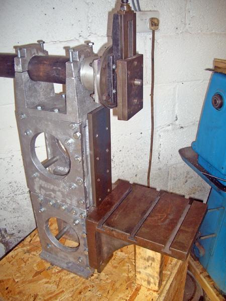

« Reply #27 on: March 04, 2014, 12:29:16 PM »
I then fitted the top casting to the main frame and bolted that into place.
So far none of the assembly has been precision work, an angle grinder and a drill is all I've needed. The next part is to fit the front, this has to be done accurately to ensure that the front is at right angles to the top tube.

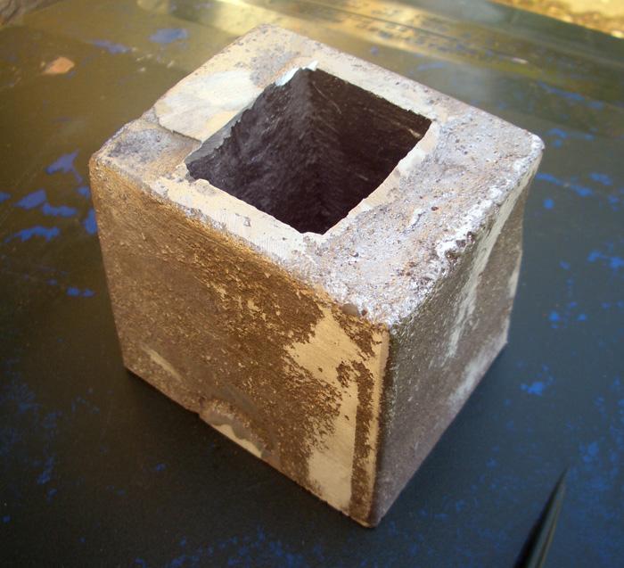

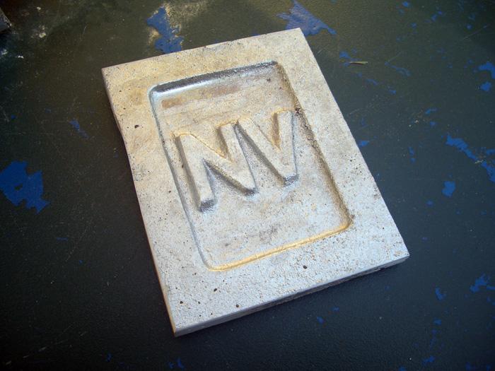

One casting that I have been having trouble with is the spindle mount, it is basically just a 4" hollow cube. I tried twice to mould it in sand but both times the centre broke away. I then made a core box and tried to make a core using sodium silicate. Somehow the CO2 did not penetrate and it was unsuccessful. I then tried a baked sand core but that failed too.
Then I had a "eureka" moment, I had some ceramic fibre insulation board left over from making my furnace and I cut a piece to size to use as a core. I was concerned that as it is so light it would move as I poured the molten metal in so I anchored it in the sand with a couple of woodscrews in the back. It was a successful pour and the fibre board was very easy to remove from the casting.
I also needed a cover for this part to keep the oil in for the bearings, as a bit of fun I cut my initials from thin ply to decorate the front of the cover. I half expected the sand to break up but that cast well also.

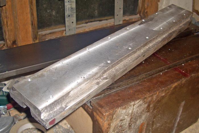

« Reply #43 on: March 10, 2014, 02:08:59 PM »

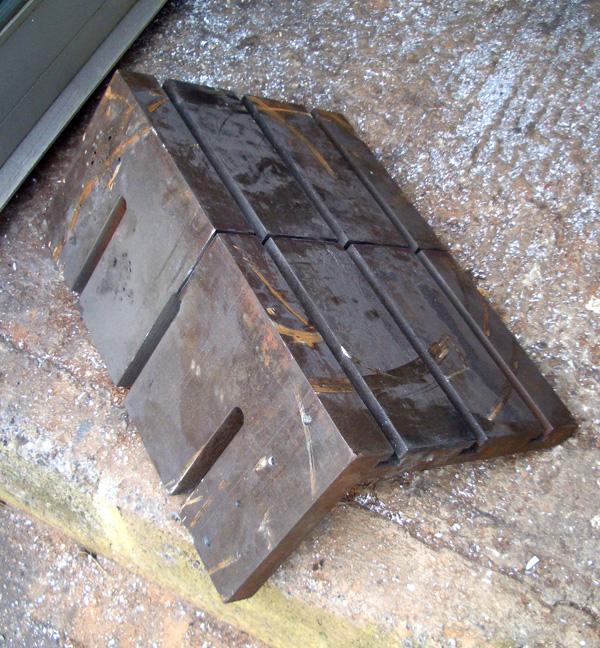

For the platform that supports the x and y axis I had originally planned to make an aluminium casting but I soon realised that would give me two large flat surfaces to level off and to get at 90 degrees to each other. It would also be too big to fit on my lathe to machine it. Instead I bought a large (18" x 12" x 8") angle plate that would give me the built in accuracy without any problems of machining it. All I had to do was to cut it in half. This I did with my rubbish angle grinder which burnt out under the strain (thank heavens for a two year guarantee) and a hacksaw for where I couldn't get the angle grinder to fit.
Here it is before I attacked it with the hacksaw.

This machine is getting quite heavy now and when I fit the table I will not be able to lift it. It is time to build the bench upon which it will live. I had originally planned to make it from metal but that would first mean that I would have to buy a welding machine. The cost of that combined with the cost of the steel made me look at timber construction. I have built this bench using 3" x 2" timber for the frame with 1/2" particle board for the cladding. It seems very stable but time will tell. At least I have got somewhere semi-permanent to keep it for now. I will be giving it a coat of paint to make it look a little better and I'll get some handy storage in the sides.

« Reply #49 on: March 12, 2014, 07:07:25 AM »
I have now fitted the knee (I think that is the right name for it) and am pleasantly surprised how freely it slides up and down the column and lock without any shake. There is a block of wood under it to keep it in position, the next job is the screw that will raise and lower it. I am planning to use a 28mm acme threaded rod that is sold as a screw for a woodwork bench vice. After considering various geared methods of operating it I have settled on a ratchet mechanism to do it. It may be slow but it is within the cost restraints.
Thank you for the advice on concrete, I may do that soon but must be careful not to do it before I am finally certain that I won't need to dismantle anything.
Here's the screw and a pic of the machine as it now stands.
