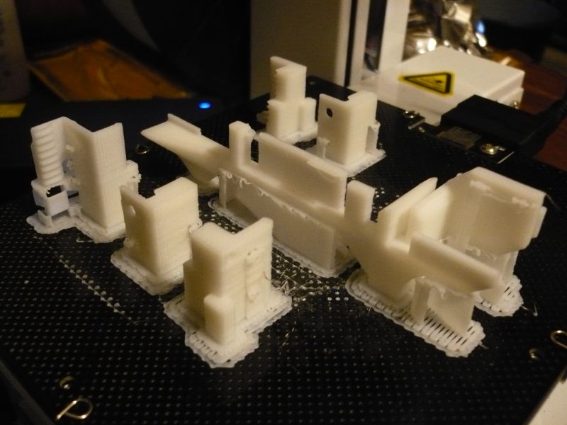

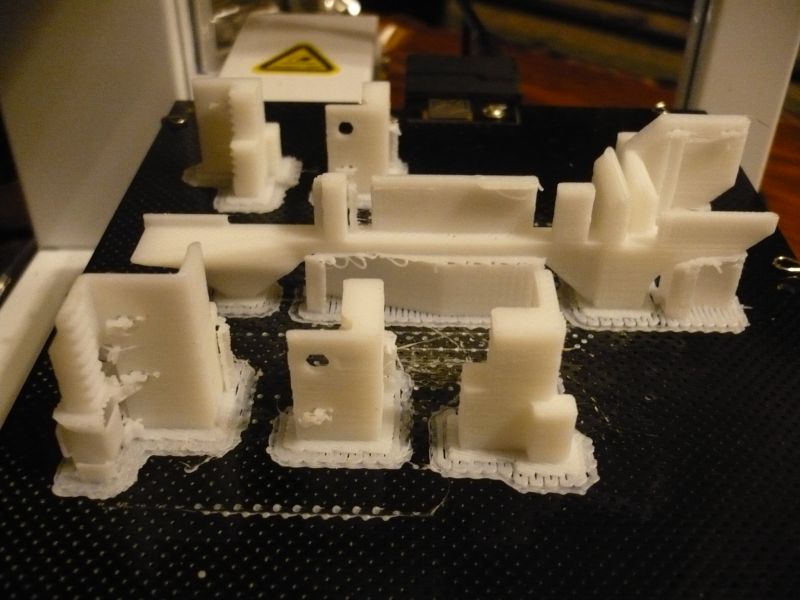

Pics.
Some of the spares for the printer being done, all the small parts are belt clamps that in the event of a major crash, break.
Big bit is something to do with the feed spool.
The raft is clearly shown and the fuzzy bits are where it's changing from solid to support which is printed a lot differently.
The really fuzzy bits on the part bottom left are the supports for the holes so they don't collapse.
Another shot of the same job. this is just after it finished printing and nothing has been touched.

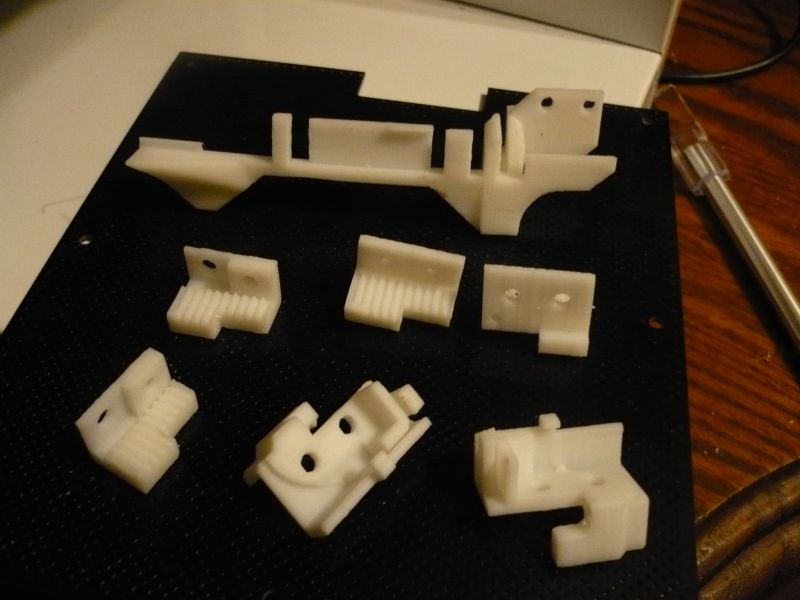

Finished bits with the supports pulled off. Centre piece bottom left had two flat supports like packers either side of that L shaped piece that just needed a bit of help with a craft knife to poke out, not cut as they weren't fastened and stuck to the surface.

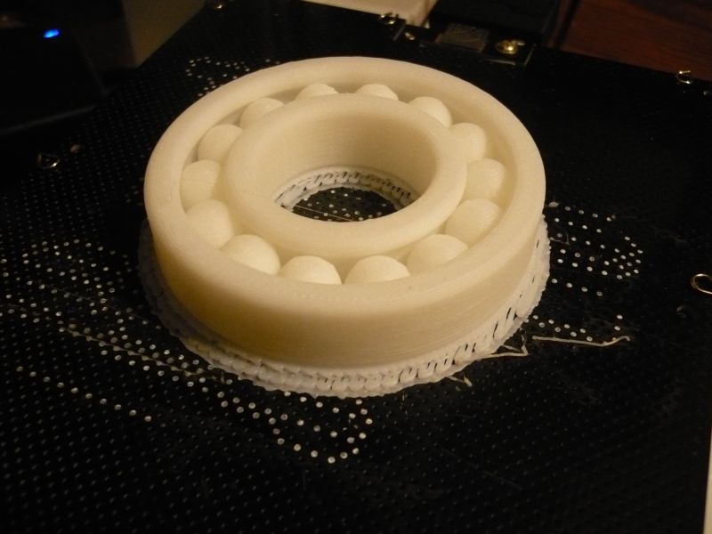

Now the obligatory bearing.

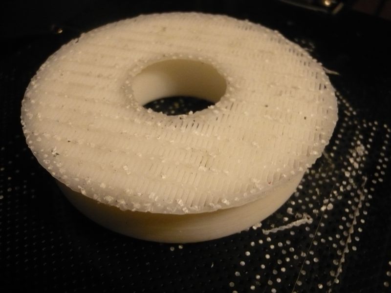

    Upside down shot after scraping off the perf bed.

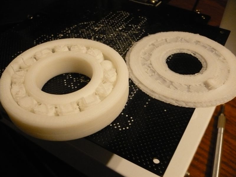

    Shot with the raft snapped off, just pulled this off with my fingers, smaller parts often want a knife to peel them or a finger nail. You can see one ball support has come off with the support raft, just needs the others picking off.

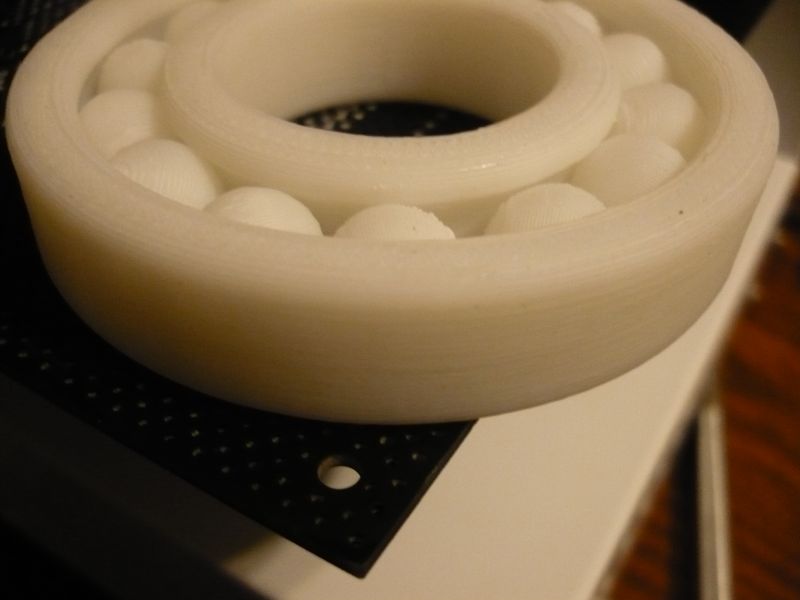

    Finished bearing. Quality is not bad but I sped the process up by selecting 0.3mm hight of layer and hollow fill. this printed in just under the hour.
    If I had gone to 0.15 hight and solid then it would probably
    have taken 3 to 4 hours.
    I printed to spare parts in solid as they need mechanical strength, this is just arty farty although it does spin.
    Quality is about as good as Bridgeport spindle bearings.

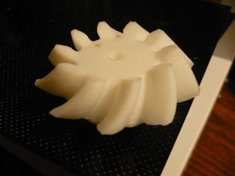

    Last one is a spiral bevel gear from Art Fenerty's Gearotic program.
    Bit disappointed with this picture as in the plastic it's a lot better than it looks, again hollow fill to speed the process up but finish is good. 1 hour 35 minutes to do this.

You can make it even smoother by letting the plastic breathe some acetone fumes as well it will smooth out the wrinkles a bit. check google for that i saw some on tested.com regarding that. =)
And yes most 3D printed plastic part things lookes like shiet. ;/

John, do the parts have any strength?
I love the idea of 3D printing but the awful finish and the fact the parts look like they'll split with the slightest force has kept me back.
Your gear looks better than most other parts I've seen though. How much was the machine?

Printed in ABS in 0.15mm layers and solid, no fill they are very strong. Printed a extra belt joiner tonight, 10mm wide, 30mm long and 2-3mm thick and it took a lot of bending and twisting before it tore as opposed to breaking or snapping.
