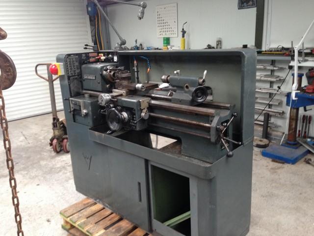

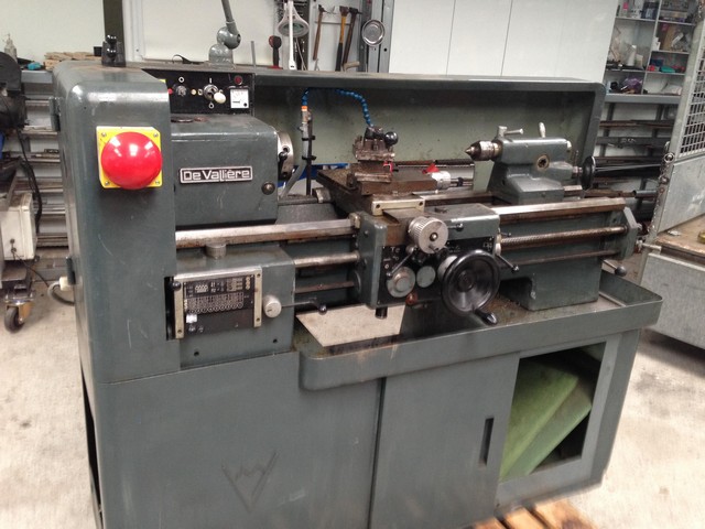

Hopefully here are photos of my French Lathe.

That is a cracking looking machine. I had never heard of it before - where did you find it?
Re: De Valliere H140 Lathe
« Reply #5 on: October 19, 2013, 02:41:03 PM »
Reading the write up on Tony's site it seems that you've got yourself a little gem there, the designers look to have spared nothing to produce a worthy lathe.
« Reply #6 on: October 19, 2013, 04:08:26 PM »
Looks good,  had to smile at the big ass panic button never seen one that size, what are the levers on the end for?
« Reply #7 on: October 19, 2013, 04:17:25 PM »
From Tony's site it seems that the tailstock barrel can be advanced by either a wheel, or by a set up like a turret or capstan  lathe, and those knobs sticking out at the end seem to be the capstan handle.

Thanks I am chuffed with it.
Yes  it has much the same specs as a Colchester Chipmaster, except it has a whole lot more.
I picked it up off an engineering firm in Waterford south east Ireland, he had bought a job lot but he had no need for it as it was way too small for his work.
At the moment I am in the process of fitting 3kw motor 3ph, 220v to 3ph inverter and a resistance brake.
I have 68 'AMALA which is a very light oil like 32, for the headstock and TACHUS 68 (heavy) which is for the gearbox and carriage.
I suppose its trail and error till I get the oil right, any one got  some advise?
 I am still trying to figure out lever controls especially the surfacing/sliding, it might get easier when I get to change the oil and filters.
Tom, the fat ass button is now gone.
levers on the end of the carriage ? the large one is to engage the leedscrew and the small one is for magnetic tension on the leedscrew stops.
there is a flat bar that that runs the length of the bed and it has moveable stops.
yes your right awemawson, I just placed the turret arm into the bed end while I was moving the lathe.
Maybe That was what Tom meant   by the levers?

Nice find there with some useful additions over the Harrison 11"/140 and Colchesters its based on.
Like the capstan idea, really could make use of that along with the screwcutting quick draw.
One thing I couldn't make out, has this got a clutch top of headstock?

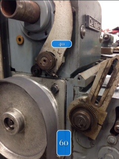

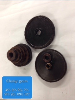

I have an English  manual  although Iam not sure if it is complete the last page shows the bearing sizes/refs.
I 6no change gears + 2no mounted on the gearbox banjo, is that the complete set?
Hi Jonny,  that feature of the quick draw tailstock was what drew to this machine.
I had being thinking along the lines of a lever action tailstock, I had put one on a ML 7 years ago, great addition.
About the clutch, I am not sure, but I don't think so.
I just got it wired up last nite, but it's running at full speed as I need to add a potentiometer to slow down the primary speed, the motor is 2 pole.
I had a quick look at the manual, it ends on lubrication with a supplement for the motor wiring.
Tell me how many teeth there are on the gears or take a smaller photo (change the resolution in your camera to around 600 x 800 ish) and I'll ask on "Usineages"

Hi Matthew,
Thanks for your kind offer!
I took some photos of the change gears and have their sizes as well.
It  does not look like they were used much as the finnish on 120 & 127 gears (which were together on the banjo) was very clean.

not sure if this will work.
« Reply #23 on: October 22, 2013, 04:18:56 AM »
Depaugie,
Yes it worked, I'll post them on "Usinages."
Regards, Matthew.
« Reply #24 on: October 22, 2013, 04:32:57 AM »
Hi again,
here's my post to "Usinages"
http://www.usinages.com/post651178.html#p651178
From what I can see, there compiling a list of De Devalliere owners, a photo of the makers plate and some information about where you are might be appreciated.
